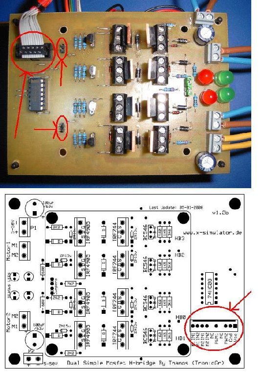

    Slow and steady win the race. Ive almost finished. Ive only got a few more components to complete on Tronic's boards.
    I have just noticed some inconsitencies with the photo im using and the plans im using. there are 2 extra jumpers Also a different type connector.
    (see picture below)

    Don´t care about the connector, there are different possible types you can use. Dependable what your local supplier is able to deliver. For safety reasons, it should be only a connector which is safe for voltage reversal.
    Where did you get that picture from?
    Seems to be another version of the H-Bridge, i assume the jumpers are not necessary actually.
    Btw. i moved your Thread into the proper forum.
    regards
    René

    Yes, that`s the H-Bridge DSMhb1.3b Version, using IDC connector instead of molex connectors. That`s the only different.
    I don`t know the function of the jumpers.

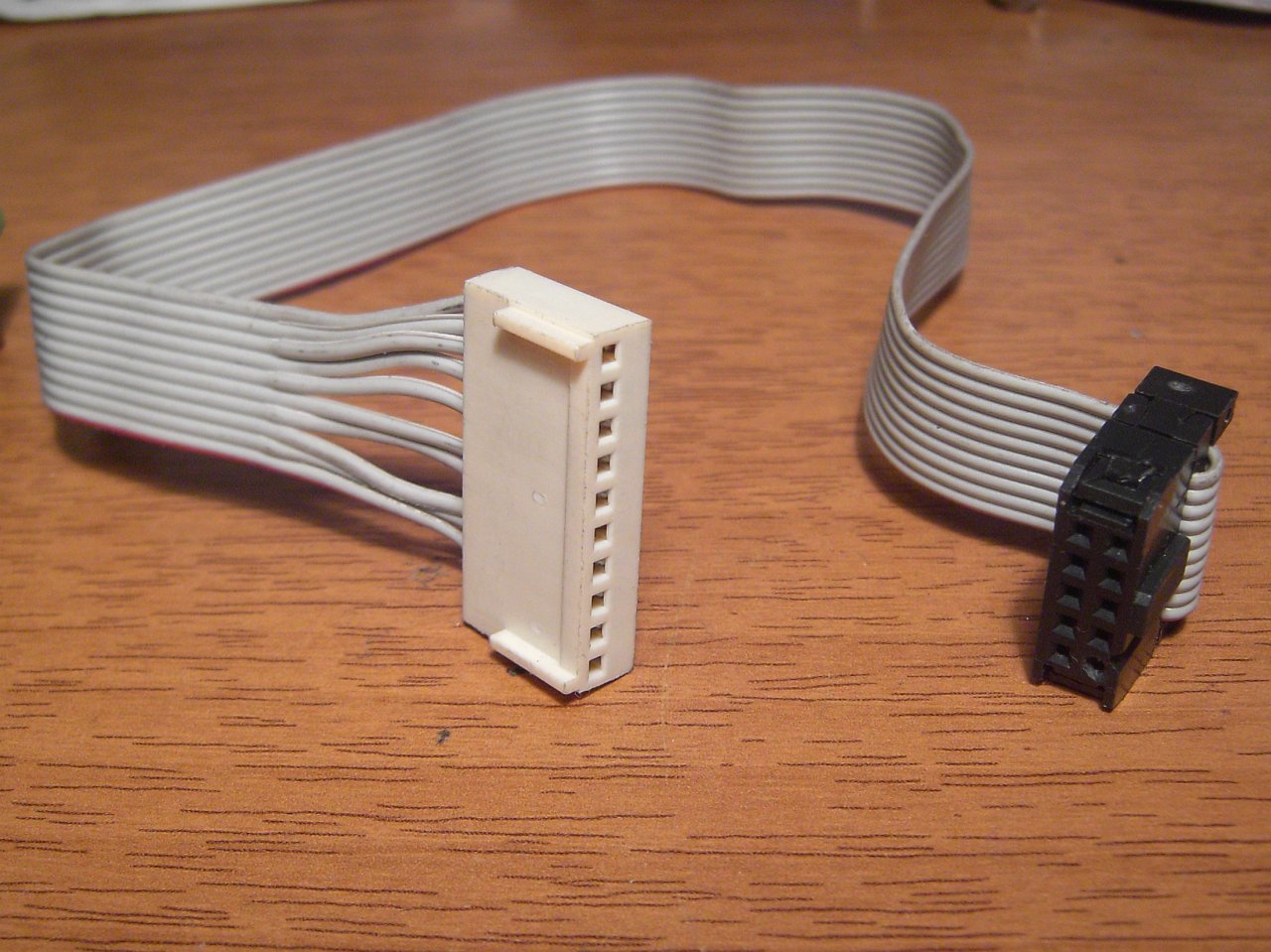

    The IDC connector on your DSMhb1.3b can be adapted easily to the current molex connector of the AMC1.5:
    As for the jumpers... They are not required to make it operate. Actually they are not junpers, but connectors for external h-bridge gate control circuit if some application requires different switching like not sign magnitude PWM, but perhaps locked-antiphase PWM !!!!
    Regards, Thanos
