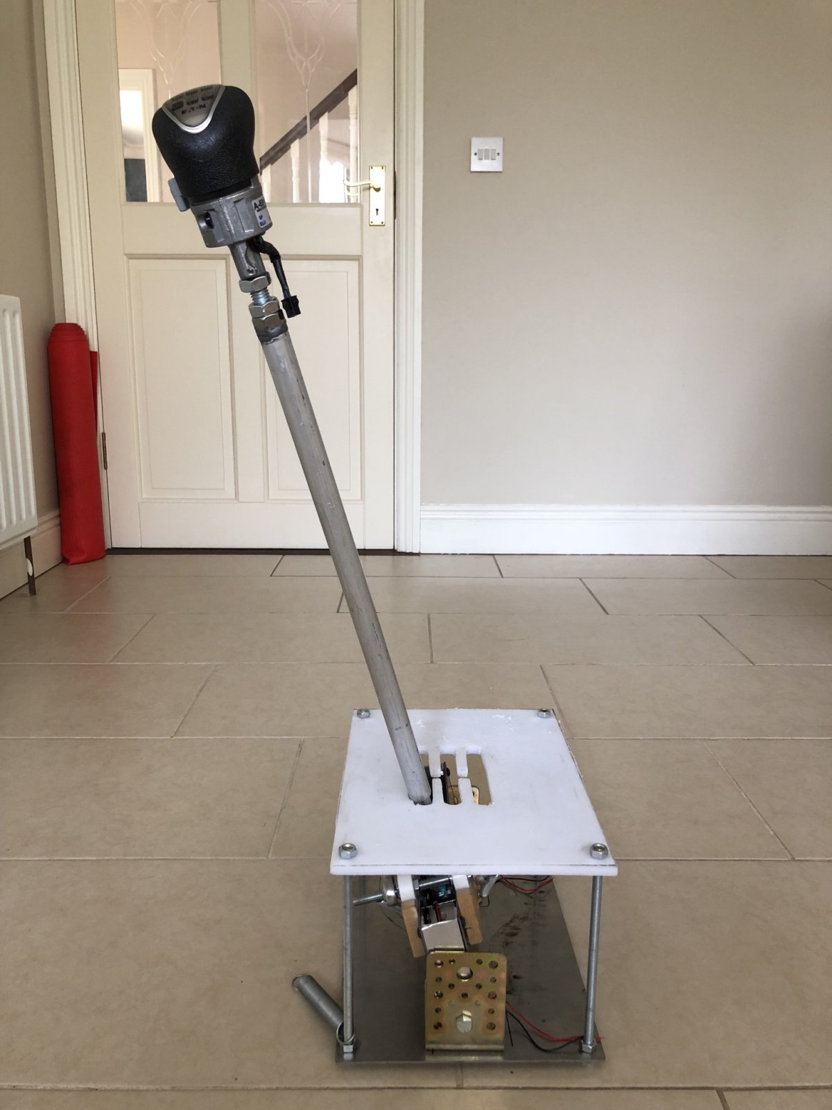

    I’ve had this idea in my head for some time now. One of the biggest draws, for me at least, when driving in ATS is the satisfaction of smooth gear changes when using a non synchronised transmission. The idea is simple. You match the engine speed to the road speed so the gears mesh correctly and the gear changes are smooth. To enable this in the game requires setting: uset g_hshifter_synchronized "0”. The result is floating or double clutching for gear changes is much more realistic as you must manually adjust engine rpm. This provides an entirely new challenge compared to regular racing games and takes a good deal of practice to master. The trucking world has seen a massive decline in the use of these once common transmissions. Fewer and fewer truckers today know how to drive them properly. As a European, I'm unlikely to ever come across one but through ATS it’s possible to imagine driving an old 18 speed Kenworth or Peterbuilt.
    My first solution was to go out and buy an Almar shift knob for my G27 shifter. This gave me the required range and splitter switches for driving an 18speed but, I still felt something was lacking. The problem is that your physical stick will slot into gear irrespective of whether you have matched the rpms correctly. The result is the in game truck coasting in neutral, making a grinding noise, while your physical shifter has slotted home into its gate as if nothing is wrong. This is very unrealistic and really hampers immersion.
    I did my research on 18 speed Eaton Fuller transmissions and non synchronised “crash boxes”. I have come up with a design which I think will offer a good simulation of real world behaviour.
    I’ve kept the idea as simple as I think it can be. Two pieces of information are all that’s needed to achieve the desired results. We need to know:
    1. When the physical shifter is selecting a gear (button pressed).
    2. When the game is reporting the truck is actually in gear.
    I wrote an Arduino sketch for a pro micro to act as a game controller. This will output the gear ‘button’ presses to the sim. I also pass this information by i2c to an Arduino Uno.
    The Uno is receiving the gear state from the game from serial data via game dash. It also receives the button press for gears from the pro micro (via i2c).
    Now that I had the required data there were two scenarios which needed to be simulated.
    1. Physical button pressed but no gear selection reported by the game.
    2. Physical button pressed and gear data received from the game.
    For the first case I needed the gear lever shaft to vibrate to simulate gearbox grinding. This is the result of the rpms not being correctly matched. In addition I needed to make it so the lever would not be able to slot fully forward or back into its gate. The result: we try to find a gear - gearbox says no - gear lever vibrates - maintenance bills go through the roof :-(
    The second case requires the stick to be able to slot into position as the rpms are synchronised. The result: we try to find a gear - rpms are aligned - gear lever slots into position - no maintenance charges :)

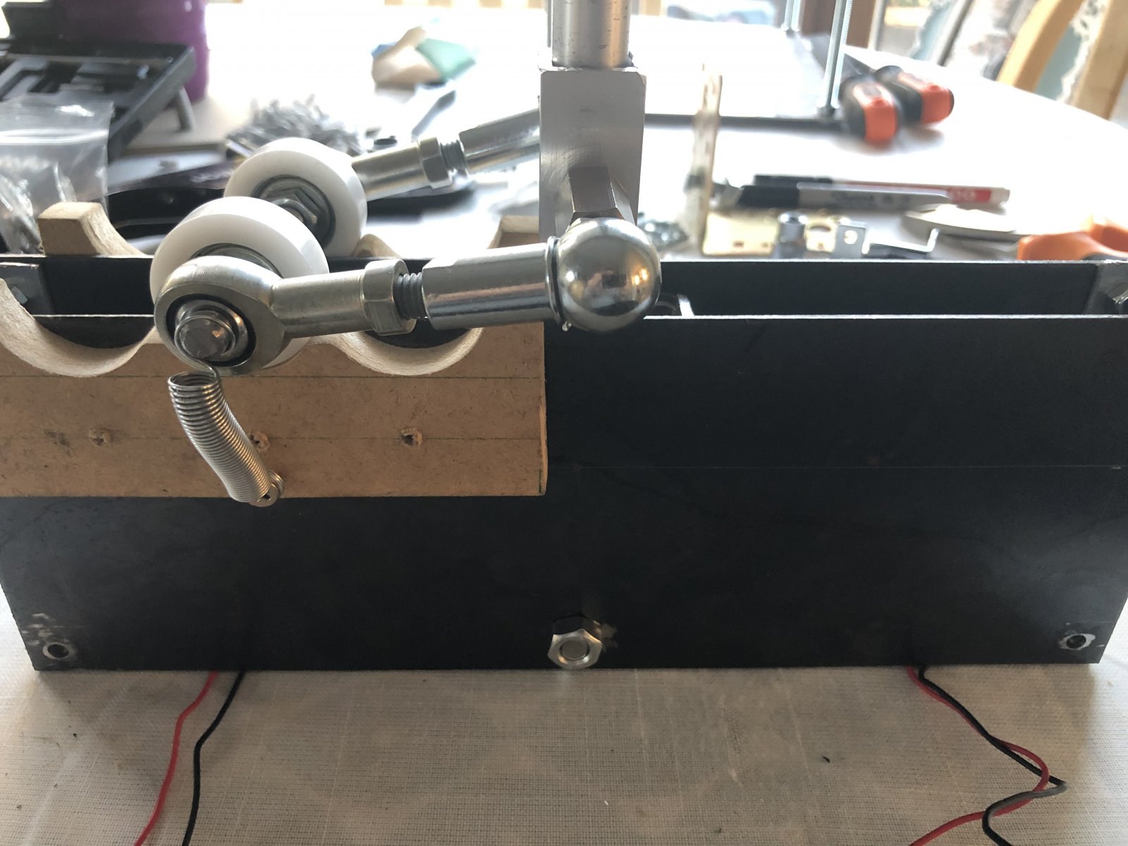

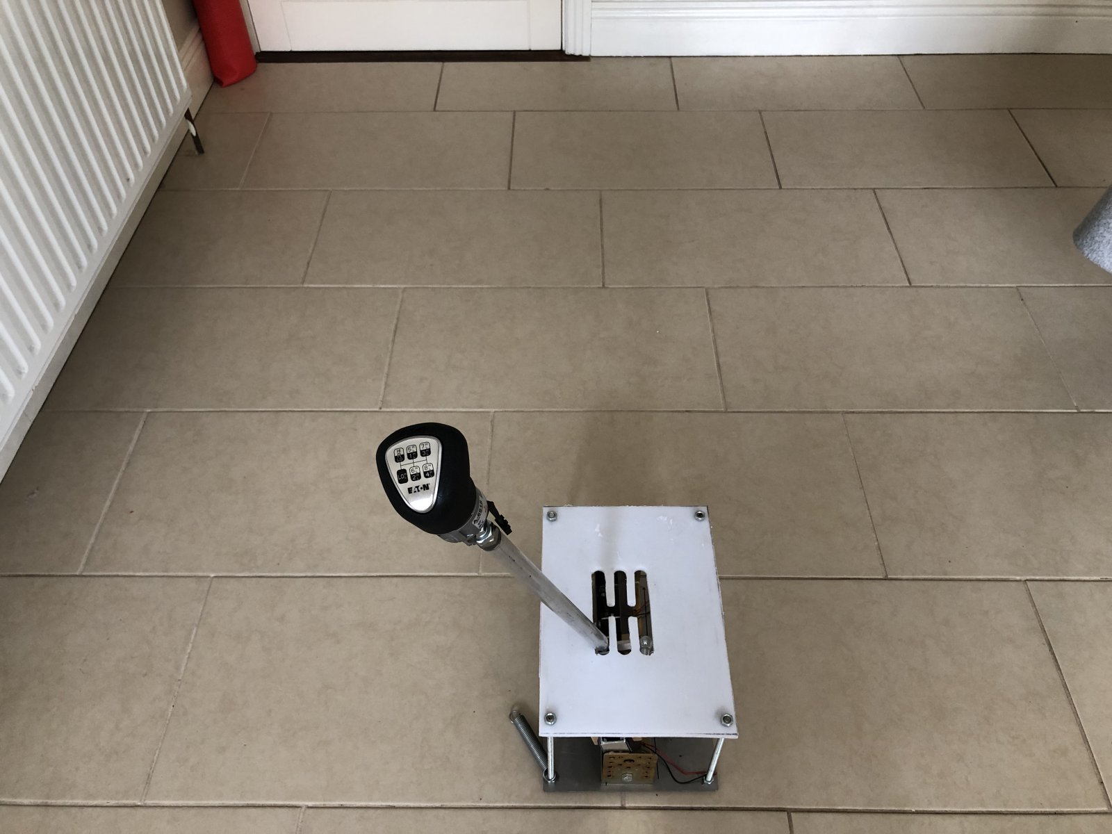

    The build is still ongoing. Here is a picture of some of the components. The fore and aft movement is locked by two electric solenoids controlled by a relay. The vibration is provided by a vibration motor to be mounted on the gear lever also controlled by a relay. Power is from a 12v supply.

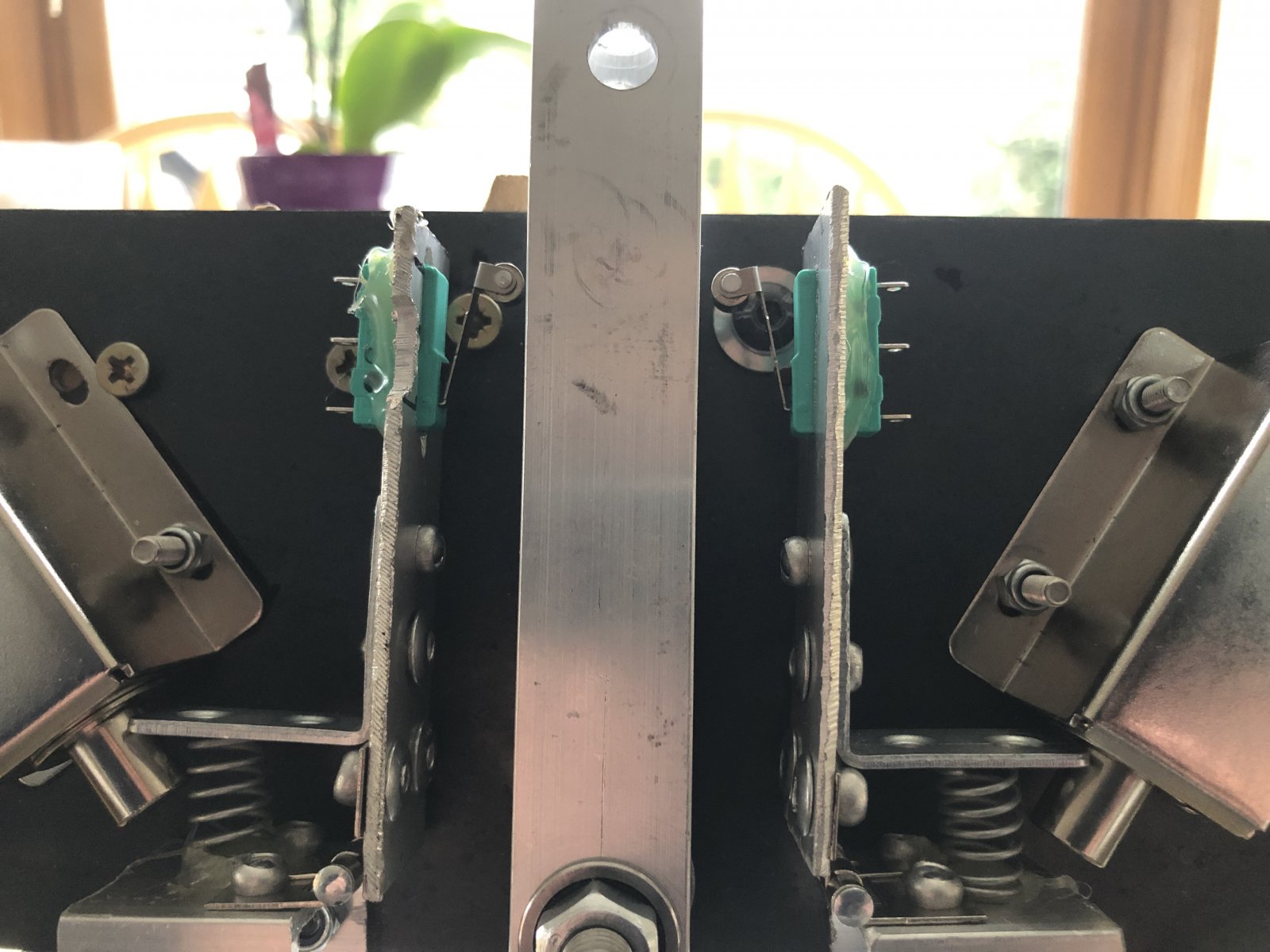

    The next picture shows what I’m calling the syncro mechanics. The limit switches which record forward and rearward movement of the gear stick are mounted on spring loaded hinge arms. The switch can be engaged by the gear stick but the arm is locked in position and prevents the shifter moving fully into its gate or ‘in gear’ position. The solenoids provide the mechanism for blocking the movement. When the solenoid barrel retracts, the hinge arm is free to rotate and in turn, allows the stick to travel into the gate.

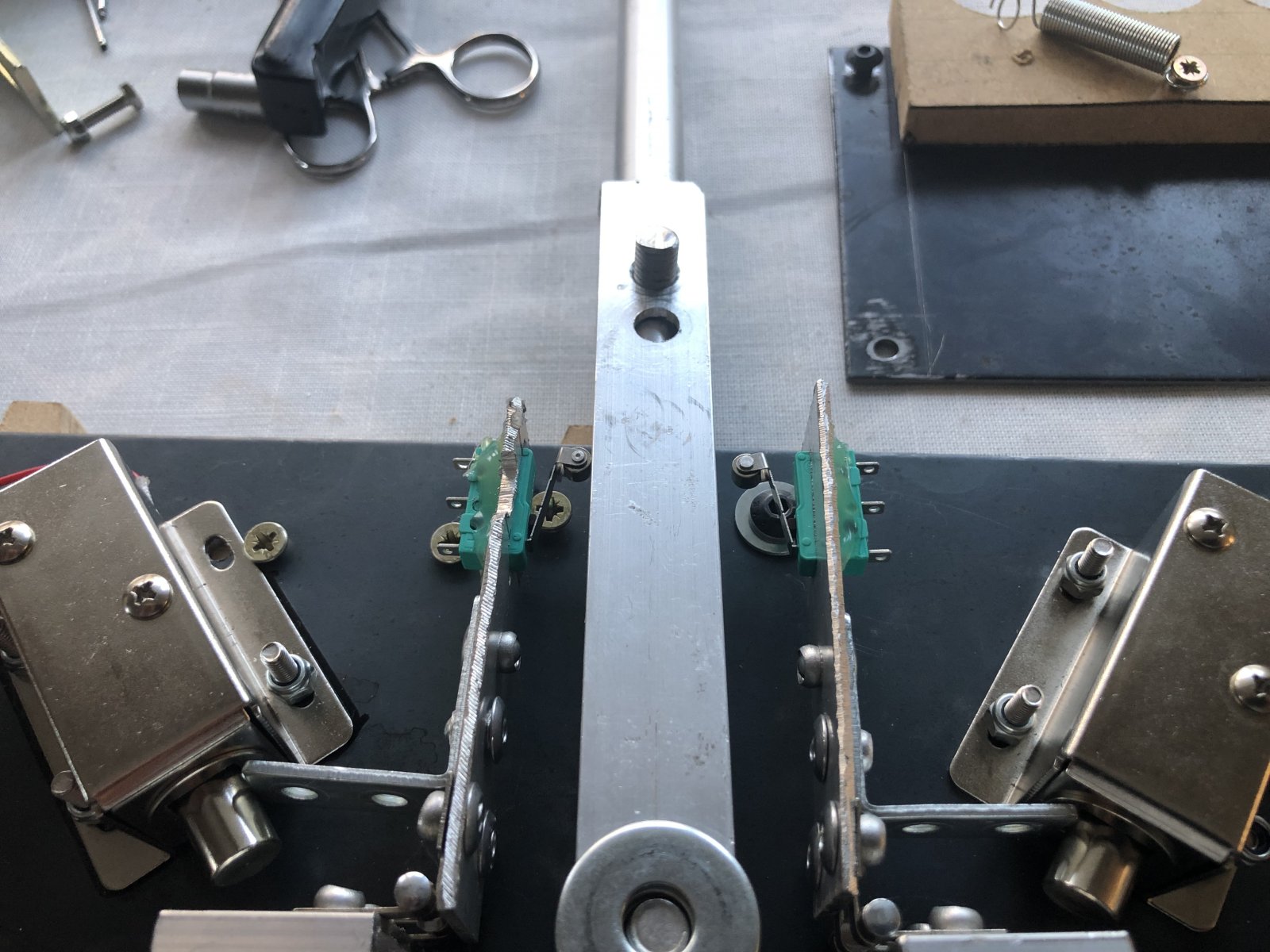

    This picture shows the fore and aft gate mechanics. Two bearing wheels are held against MDF tracks under spring tension. The wheels are in turn connected to the gear stick with rose joints. Once the barrels of the solenoids in the internal synchro mechanics have retracted the stick is free to drive the wheels over the track (either forward or backward). The shape of the MDF track provides that familiar ‘clunk’ as the stick slots into gear and it also serves to hold the stick in position.
    What about the other four gear positions? I had originally planned to use six spring loaded limit switches but the mechanics would have been too complex. By using just four switches I am able to output all six gate positions. It requires two additional switches. One to be mounted to the left and one to the right of the main mechanics. They are actuated as the stick is moved to the left or right. A series of 'if' statements in the Arduino micro provides the logic to interpret the switches being pressed and output the six possible positions as game controller button presses. Before mounting the additional switches I decided to first fit the mechanics and mock up the final design. I had received the final component from the States to complete the look and feel of the shifter. A real Eaton Fuller 18 speed shift knob with an EasyJake switch.

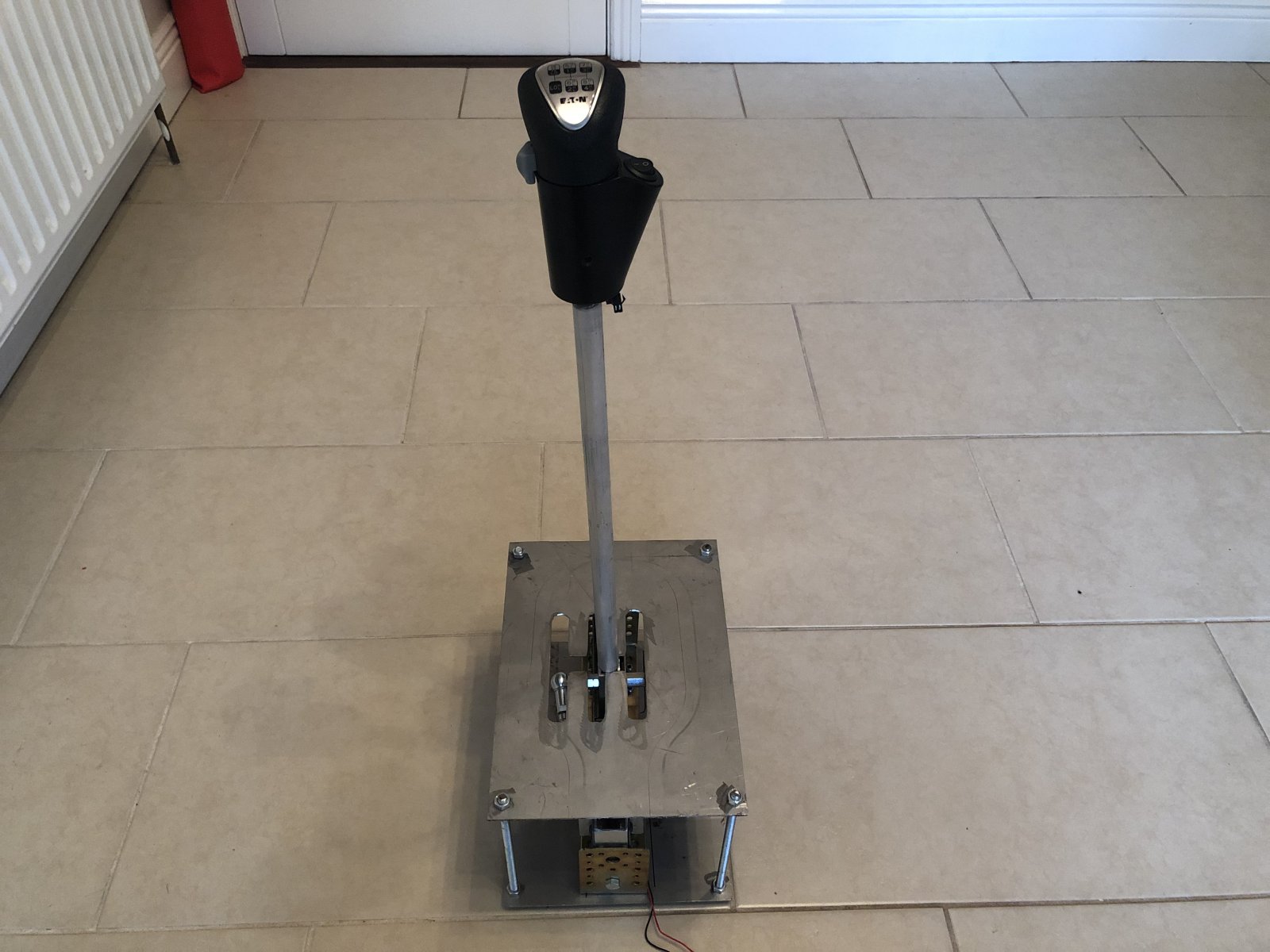

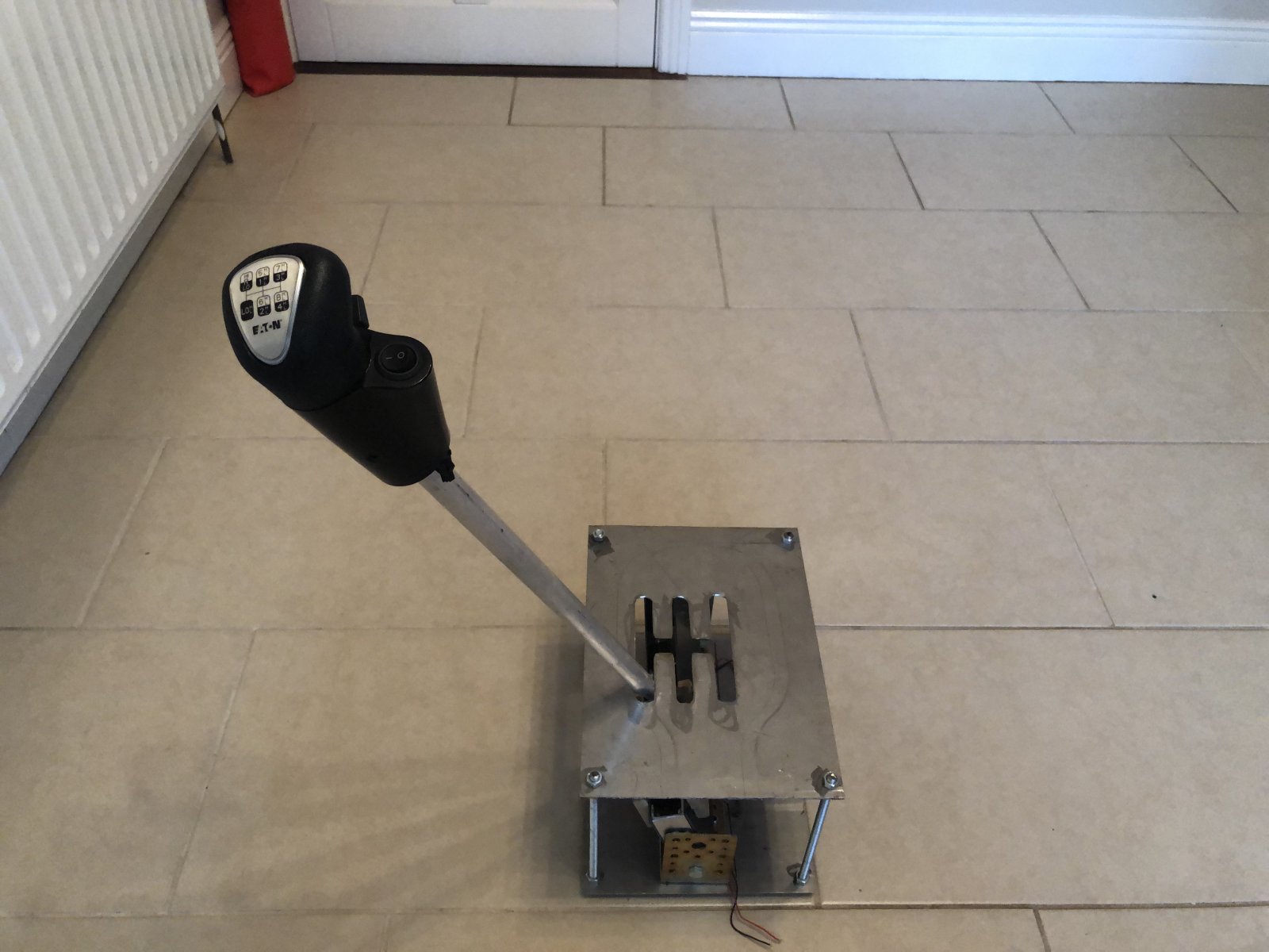

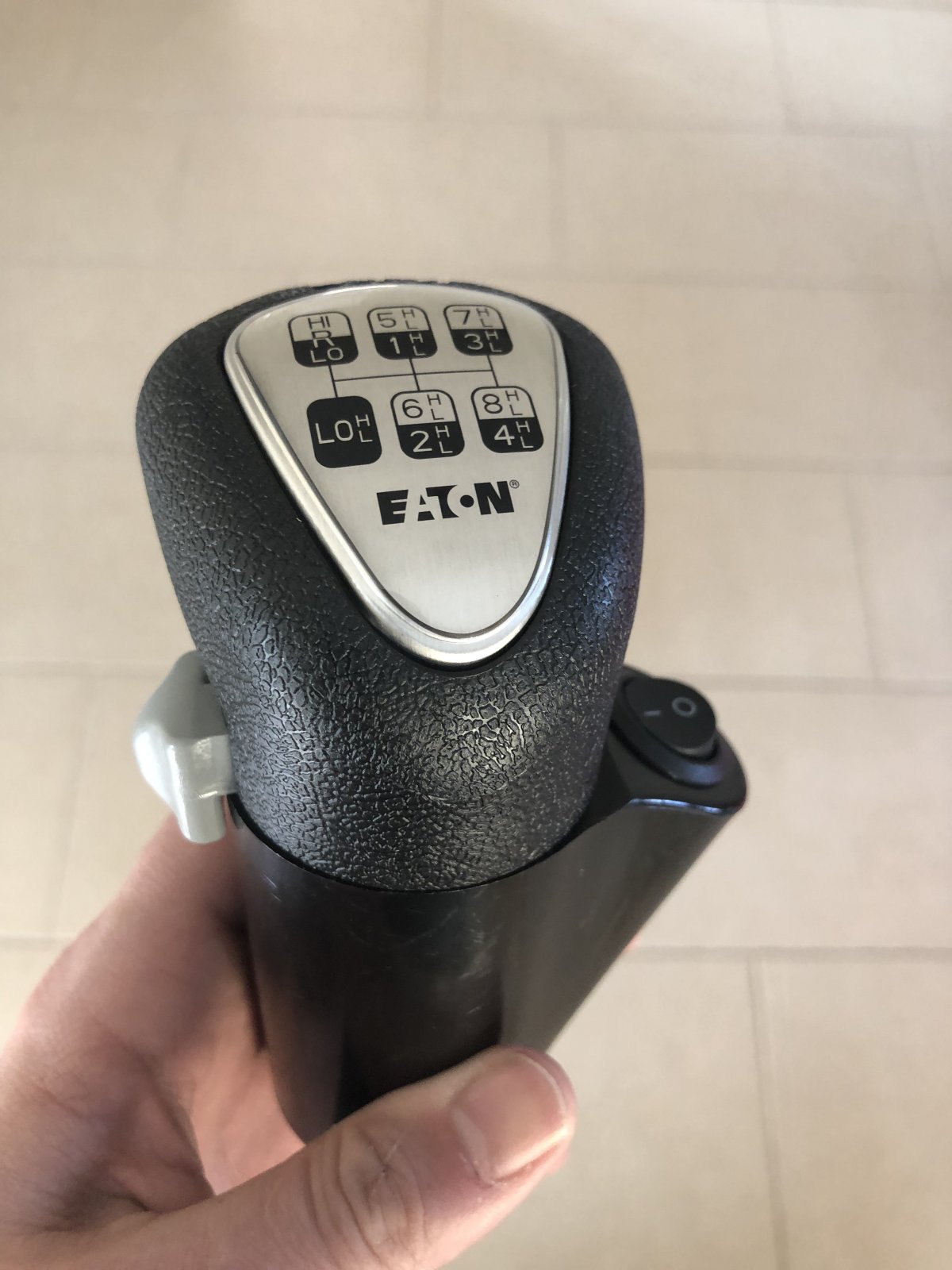

    With the gear knob on the shaft and cut to a comfortable height (the unit will be floor standing) I found that the throw was excessive. The stainless steel construction is also quite loud due to the metal on metal design and it is also going to lead to wear.
    I’m going to re-cut the H pattern on the top plate and this time use a plastic chopping board from a €2 shop in place of metal. Once I finalise the H pattern size I can move on to fitting the vibration motor, additional spring tensioners, additional switches and electronics.
    More to come soon....

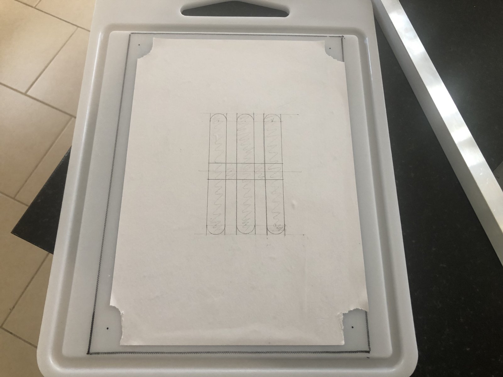

    I got a cheap chopping board to redo the top plate and H pattern.
    I have cut it to shape (still need to sand it). I’m sure there are specialized blades for cutting this stuff. I really struggled to get through it. I used a jigsaw and had a lot of trouble with the blade getting caught up and melting the plastic. I think it looks ok. I’ll be covering the H pattern with a boot anyway.
    Hopefully the plastic will be strong enough to stand up to the abuse. Judging by how hard it was to cut I think it should be ok. I might make a steel plate slightly smaller than the existing lugs to sit over the top and reinforce them.
    You can see the throw has been greatly reduced. I think this will be a lot more comfortable. Now I can proceed with the remaining two limit switches and mount the vibration motor. By that point I will be on the home stretch.

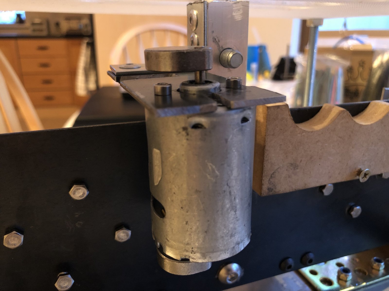

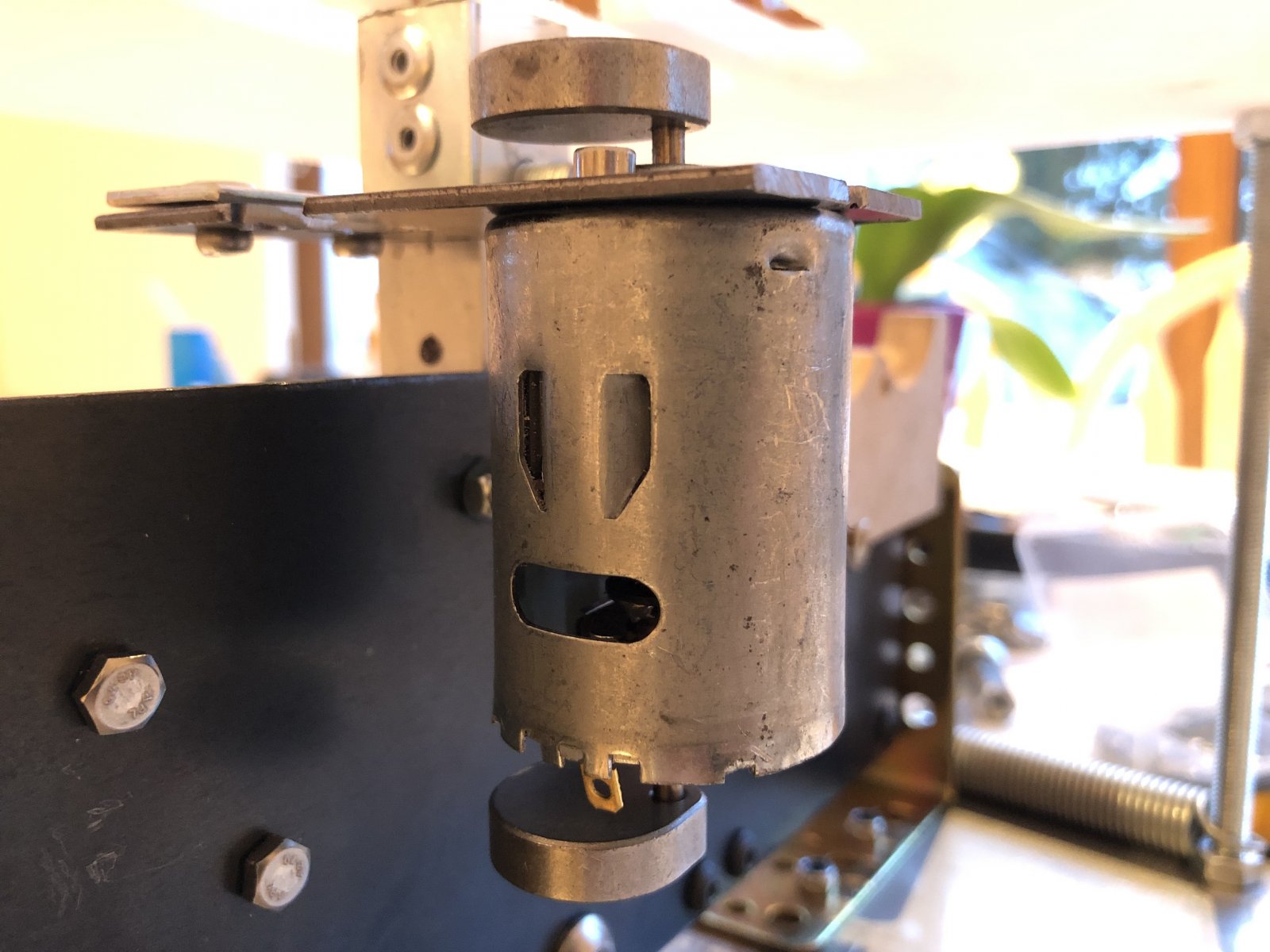

    Another little alteration had to be made to the spring arms in the synchro mechanism. I had done some reading up on electric solenoids. It seems it’s not a good idea to leave the coils energized for more than a few seconds as they are prone to burning out. I had factored this into the initial design. The Arduino code only fires the solenoid for 1.5seconds (more than enough time to move the gear stick into its gate). I had counted on the spring hinge having enough force to drive the solenoid barrel back up into its housing when pulling the stick back out of gear. The spring force from the hinges lacks the force to drive the barrels from the solenoids reliably and the arm would some times stay in the ‘in gear’ position. I’ve cut a few more springs to size and secured them in position below the spring arm mechanisms. This now ensures the arms will return to their normal orientation when the gear stick is moved back into neutral.
    In addition I’ve completed a mounting bracket for the vibration motor and secured it to the gear stick shaft.
    I had to come up with a bracket which would offset the motor as it is too large to fit above or between the side plates of the main mechanics. I will have to see how this offset weight plays out once I add a tensioning solution to center the side to side movement of the stick.
