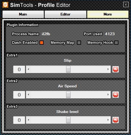

  14. Celk
    Celk New Member
    Aug 18, 2014
    192Coins
    Hi all,
    I cannt take game output. What is the port of plugin? When i try to patch, it add 21000 port to conf. but i can see "Port used:4123" on gamemanager profile editor.
    Bythway, this is first post :cool:

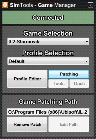

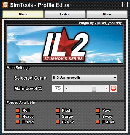

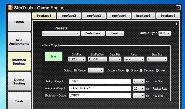

  15. Nathan Older
    Nathan Older Member
    Mar 17, 2014
    36
    211Coins
    I am also struggling to get any output, I have installed plugins on both computers, patched the game on the Game Manager, the simulator works with the likes of rFactor and Race07, but nothing on IL-2
    Here are some pics of my settings, hopefully this can help someone point out how blind and dumb I am currently being.
