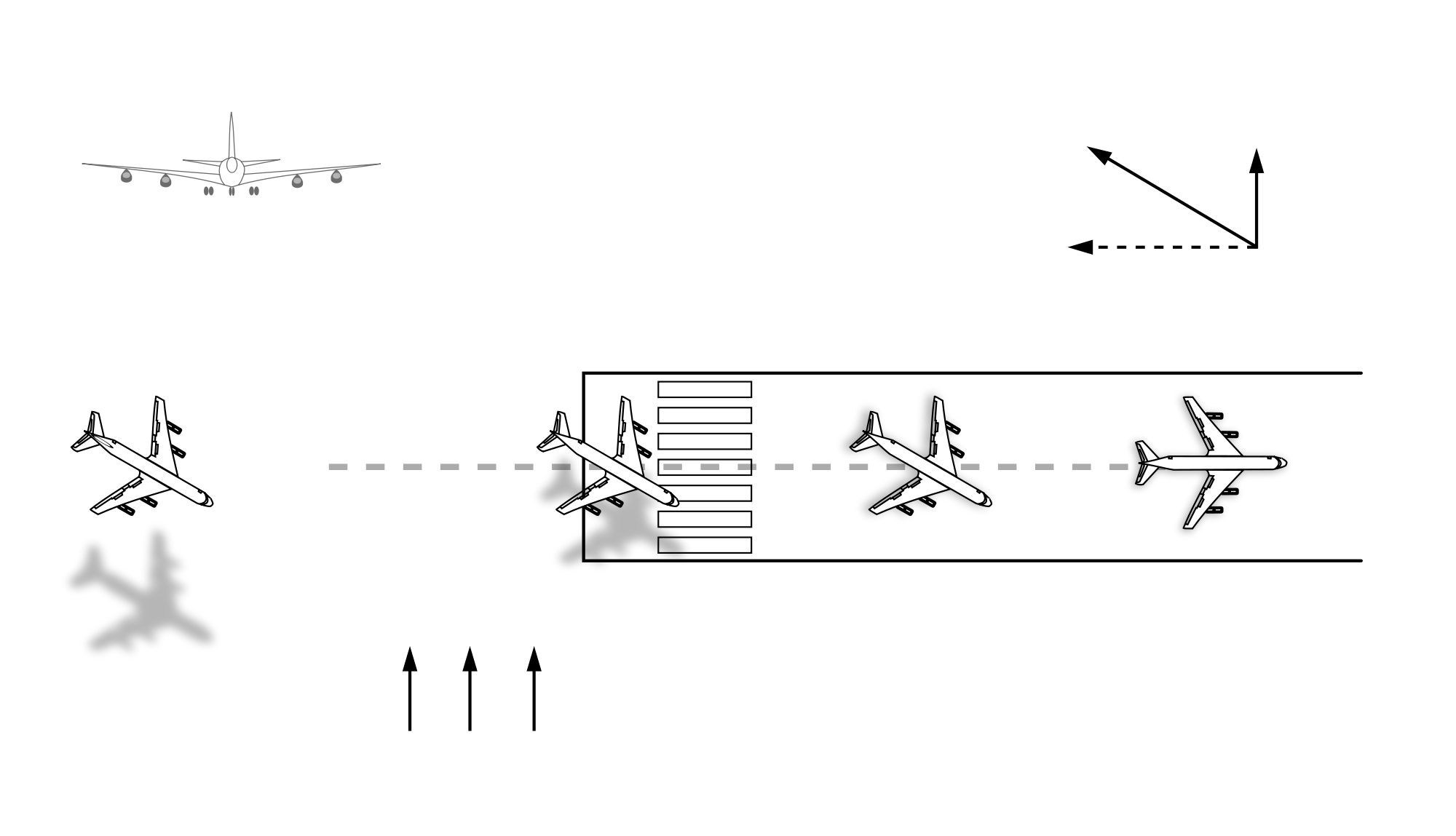

    Hi Alexey, I very much appreciate your work on this plugin, sorry that I did not get back to you sooner yesterday; I was grading papers and only had time for short responses.
    Yaw is not something that you usually want in an aircraft, you want the plane to go in the direction that you point the nose. Unfortunately you have several factors acting on the direction of the aircraft, especially with a big vertical fin on the tail (vertical stabilizer called stab for short). The stab is needed to help keep the plane cutting through the air in a straight line, but if a contrary outside force is introduced (such as a crosswind) the stab can push the plane's tail to the left or right even though the direction of travel remains the same, this is Yaw.
    Other factors that can cause this is the propeller of the plane, which causes a vortex around the plane which could push the tail in the opposite direction of the propeller's rotation. The Messerschmitt 109, a German WW2 fighter plane, suffered from this induced yaw. New 109 pilots could be spotted because the plane flew in a yaw most of the time because they had not yet learned to trim the rudder to compensate.
    Examples of a crosswind yaw can be seen on aircraft pointing their nose left or right to the runway as they come in for a landing. See the image below.
    This is where the rudder is so important. The rudder not only helps to induce a turn in the aircraft, in conjunction with the ailerons, but also helps to compensate for forces acting to turn the tail of the plane. You can induce yaw purpose with the rudder as well. That is why it was so important that I connect my rudder pedals to the platform in order to evaluate a flight sim game plugin.

    The purpose of the values out of SimTools is mimiking the sensations you have during a flight.
    The movements our body can sense is rotation speed [°/sec] and acceleration [m/sec²].
    What we cannot sense is linear speed and direction (migrant birds can).
    We mimic the acceleration by tilting the seat (→ Earth gravitation) and by moving with increasing speed.
    We mimic the rotation speed by rotating the seat.
    Now when flying in a real airplain you can sense the rotation of the airplane when the nose turns from North-East-South-West or similar.
    If the plane is pushed sideways by wind (with linear speed),resulting in a difference bewteen direction of the nose (heading) and direction of travel, you cannot feel this.
    The only thing you can feel is the change of the direction of the nose.
    This is the reason why we must use direction of the nose of the airplane for the SimTools value "yaw".
