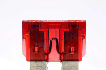

    The emergency switch is required for each simulator. Never drive w/o an emergency mushroom button.
    But what happens when the time is not enough to push the switch? In this case your last chance to save your rig is a car fuse if you have no other "emergency barrier".
    Today by a certain fact there was not enough time to use the emergency switch while the motor began to operate out of its range. As a result of this failure the lever (or crank) hit the case (although it should not, but nobody is perfect...). Due to the sudden high demand of current the fuse was blown immediately. In this way great damage could be avoided.
    @All happy testing... :)

    What size and style of fuse are you using @Pit?

    I am using a simple car fuse 20A or 30A. TL (200W motor) = 20A, seat motor (up to 450W and more) = 30A (each +/- wire got a dedicated fuse). You know there could be some very short current peaks higher than 30A but the fuses are "tolerating" that for a certain time.
    @dontcarefilmer: I do not use circuit breaker, too expensive and not adjustable. But why not?

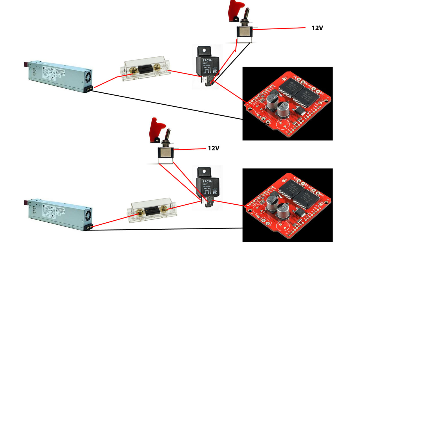

    thanks for the infos. You wrote you put a fuse in each wire + and - to the motors.
    I'm thinking very much about my electronics at the moment. I would like to use 2 fuses on the + power rail to the motorcontroller. Is this the wrong setup and i should fuse it after the controller at the motors like you?
    If i'm correct you use the motion control products motor for tractionloss and fused it with 20A?
    I'll use the same motors but haven'tany experience how much current they draw. The label says 27A. Is this under load or normal?
    I have no tools to meassure amperage over 10A so i don't know what fuses to use. I'll use them in a fullframe design under the frame You think the 30A fuse will be enough?

    Hi tombo I am at work will give you a feedback later, but my fuses are BEFORE the controller

    thanks for your reply i just made simple sketch of how i would like to set it up. Why should i fuse the groung powerline too?

    Sorry for the confusion, at work is at work and not at "rig" ;). I use two different wiring and they both work great. The first one the fuses are between controller and motors. Due to the switching polarity all 4 wires are "fused". For TL I use a fuse before the controller, only the + polarity is protected by a fuse.
    yes, 20A, but that would be too weak for the winches which are moving the seat.
    27A seems to be realistic for me under current load. peak will be more.
    Buy the very cheap car fuses described above and try out, f.e. you begin with a 30A, than reduce to 25A etc. The first which will blow shows your needed current.
    50A? Your rig will burn down before this fuse begins to blow off! ;)

    thanks for your detailed reply. Sorry for asking that stupid questions but i don't have any experience with such big motors. So if 30A will be the max for the motors, without some peaks, i can use other fuseholders like this http://www.ebay.de/itm/4-Fach-Siche...316377812?pt=DE_Autoteile&hash=item1e9310e8d4
