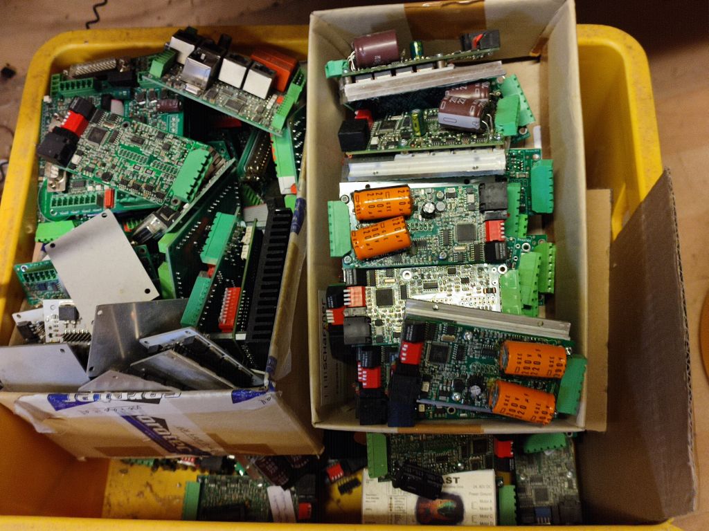

    If you are a skilled programmer you can create lots of fancy stuff with Arduinos and motor controllers like the BTS7960. But if somebody with less knowledge of electronics and software is trying to replicate something somebody else has build there is so much that can go wrong. Especially for a force feedback controller the cheap motor drivers kind of suck. If any at all exists the current measurement is used as overcurrent protection and there is no way of measuring the actual motor current with the CPU. So the software has to guess the current based on speed, BEMF and PWM duty cycle.
    For force feedback it would be much better to have a current mode amplifier instead of a simple PWM H-bridge that basically controls voltage to the motor. Why not take some hardware that has all that already on board: a stepper motor drive. A modern digital drive (google MD556) already has built in:
    • a powerful CPU
    • two H-bridges
    • current control
    • full protection (overcurrent, short, overtemperature, overvoltage)
    • serial port to connect to PC
    All we'd need to do is to "hijack" the hardware and flash it with a new software. Well, writing the software would still be a challenging task. But once it works it would be "foolproof". No matter what motor used force is always proportional to the commanded value. No spaghetty wiring...

    The MD556 or similar controllers are made to drive a stepper motor. Stepper motors are driven with a constant current at standstill. There are two coils and therefore two H-bridges in the drive. The current through each of the windings can be controlled seperately.
    When the motor moves the two currents form a vector that rotates in the coordinate system. 90° is a full step. With microsteps the vector steps around a circle.
    The Idea is to replace the stepper motor with one or two DC motors. With a modified (non-existent, at the moment) software the two currents can be modulated completely independently. Torque is proportional to the current which provides the "force" to the wheel, yoke, joystick or whatever.

    Again, the idea is to use the stepper driver boards to drive a DC motor, not a stepper.
    And yes, hacking the MD556 wouldn't be easy. I think it uses some TI DSP which is quite different from the Arduinos most poeople are used to. I myself don't have the time for reverse engineering that device. But I have another idea.
    I have that crate full of old stepper motor drives. I have developped and produced them (that's actually part of what I make for a living) so I know how they work. They are capable of driving two windings with 10A each or 20A in parallel. It would be no big deal to modify the firmware to output current directly according to input commands over a serial port. It's almopst impossible to damage them as long as you don't connect the supply in reverse. They have full overvoltage, short and overheat protection.
    My only problem is that I have no clue at all how that FFB stuff works in the PC software. We'd need some software that can read the variable values from the sim software and output it to a serial port, just the same like FlyPT Mover does for the motion actuators.

    Ok, the Rhino stuff looks quite professional. I keep that in mind for the case I need some and have the money to buy their boards. That totally makes sense if you want high quality but don't want to spend $5000 for a commercial FFB solution.
    But some people here want a dirt cheap and simple solution. As I already said, I don't have the time to provide a complete solution with driver hardware and software. But what I could do....
    I could modify my own stepper drivers to convert them to a simple "current amplifier". The don't have an USB interface to connect directly< to the PC and the sim software. But I could implement a simple PWM input just like for H-bridge motor drivers but for current instead of voltage. So 50% duty means no current, 0% duty means full backward torque and 100% duty means full forward torque.
    This way we could control the current for two DC motors with one board. The former step&direction inputs would become two PWM inputs. Would that be useful to anybody? We would still need some Arduino to implement the USB to PWM interfacing and somebody has to write the software.
