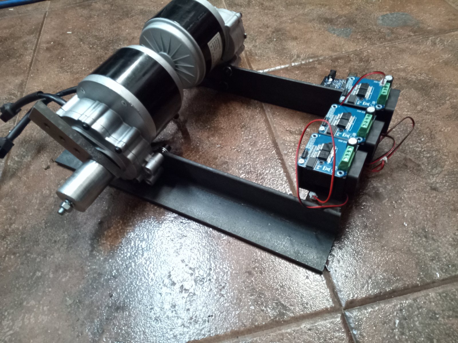

    Just got two 24v 250w 75rm wheelchair motors in the mail. I pre built a test rig with a 24v 43a 1000w psu, arduino uno, and ibt2 BTS 7960. Both motors work great with SMC3Utils!
    But now I’m seeing posts that the ibt2s burn up at anything over 19v.
    Am I going to burn these up? Should I go with a different motor controller? If so, what controller, and will it be a similar experience setting them up as the ibt2s?
    Side note: tried to adjust voltage on psu, only lowers to about 23 volts.

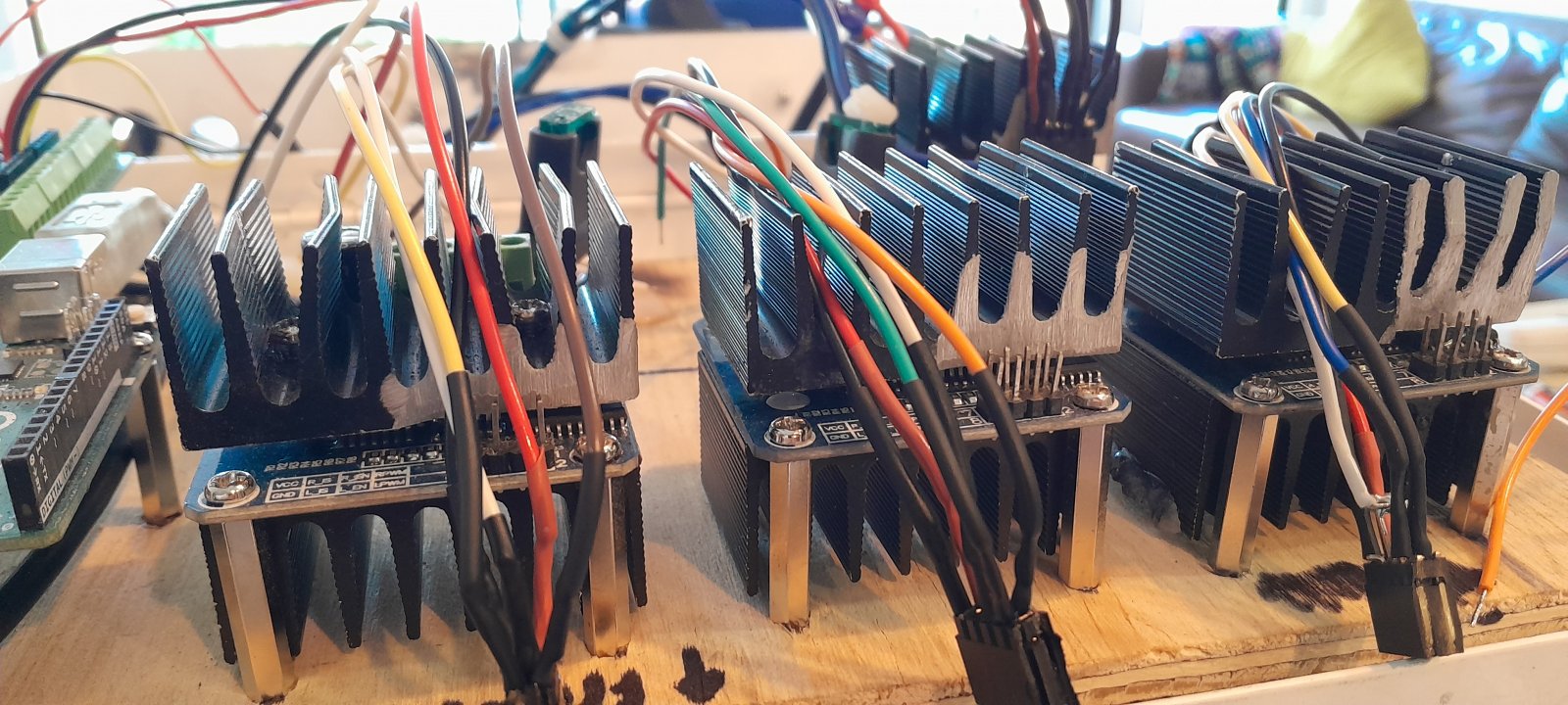

    the datasheet of mine specify 5,5 V to 27 V, the more important thing is the amps, according to the product page 43a.
    however, i would highly suggest you run them with a active fan, i've read that you will burn them up if not cooled.
    i printed myself standoffs that have mounting points for fans, and got myself 40mm fan's that run on 24v, directly connected to the power in on the h-bridge, see the pic attached, you'll find the stl's on thingyverse for 3d printing.
    i would make sure the cables are sized corectly (like the same diameter as those that come with the motor), make sure the connections have good contact, active cooling, and you'll be fine.

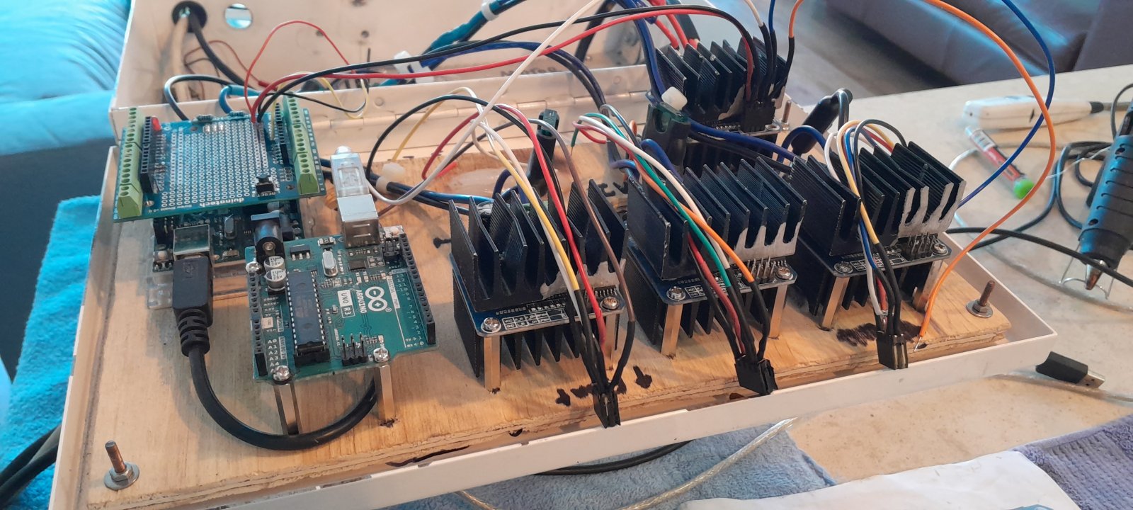

    20240106_165543[1].jpg 20240106_165602[1].jpg I have found thermal pasting them and double heat sinking them (one top and one bottom) so the one heat sink is actually on the chips from above, works great for a passive cooling option. Just be careful not to run your IBT-2's above 20 Fpwm!
    They are rated for 25khz max, so select 20khz for safety buffer. You should also only ever run your PWM main power 20% under the maximum PWM available. So in SMC3 that's 255, so take 20% off that and don't exceed that with IBT-2's and you won't cook them. If you have noticed them getting warm to hot (apart from a possible flawed platform design stressing them) check those parameters and adjust accordingly.
