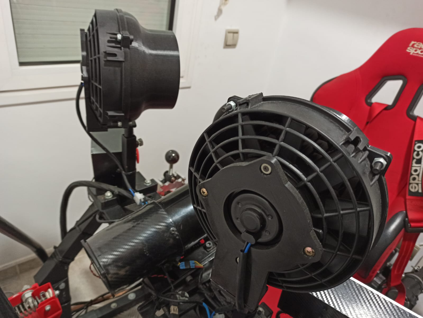

    I use IBT2 but at 12v, with it I move 2 20cm car radiator fans that I bought on Aliexpress, each one moves 1300CFM.
    I made the air ducts in 3D with honeycomb so that the air comes out straighter and more concentrated, I have a video but I don't see how to upload it to the forum.

    interesting. but how can you calculate cfm?

    I have not measured it, it is what it says in the specifications, it says 1400cfm, it may be less but the amount of air is large, if you do not use a VR headset or glasses it bothers your eyes and you cannot keep them open completely.
