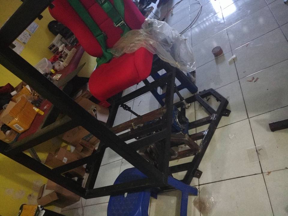

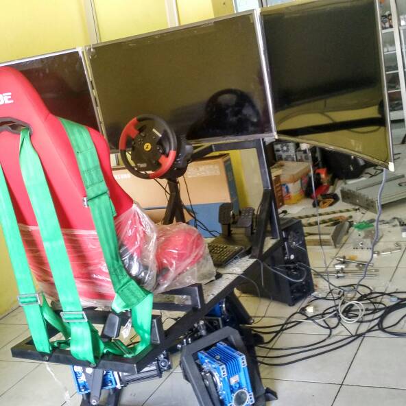

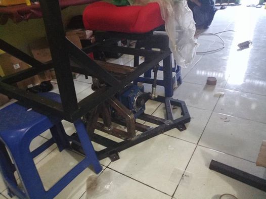

    This is all picture my simulation with TOyota car . So i am used eclipse for programing this , but i cant use for game , so why i need X simulator for create game, because i am ise new with this i want share for the first
    this is my construction use cross joint and AC servo 1.5Kw with 6nm with gearbox worm gear ..

    I am used AC servo with pulse and feedback pulse from auto encoder
    I am used AC servo 1.5kw with price 310usd

    just buy AC servo and use STM32 microcontroler
