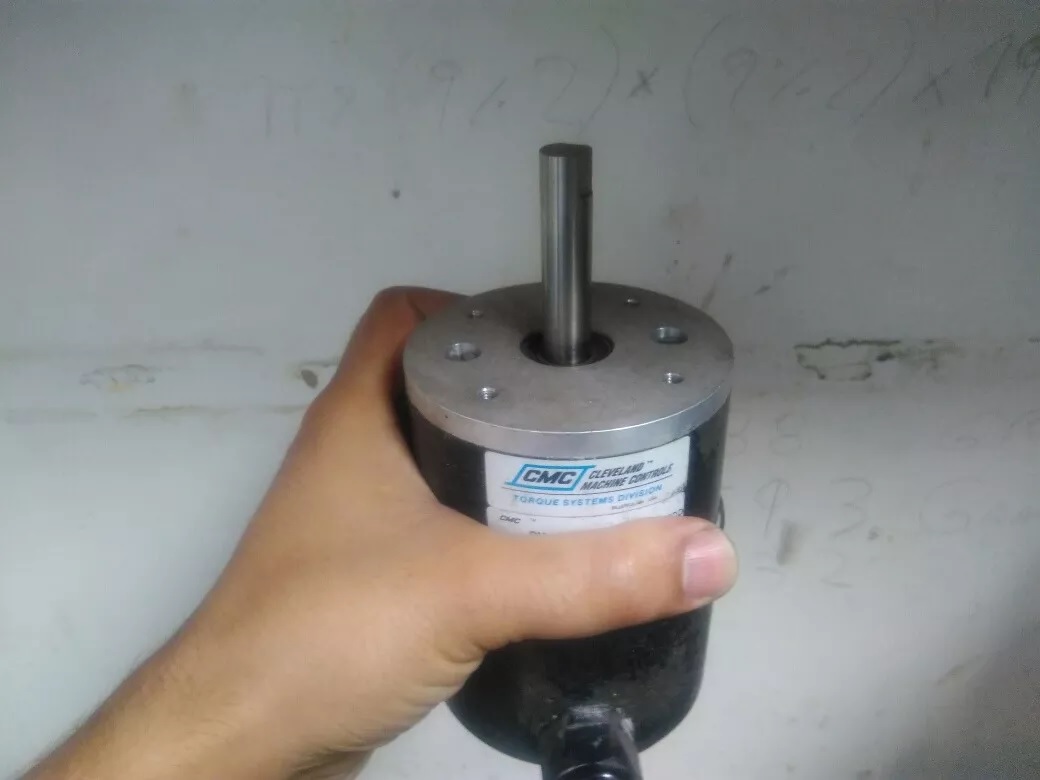

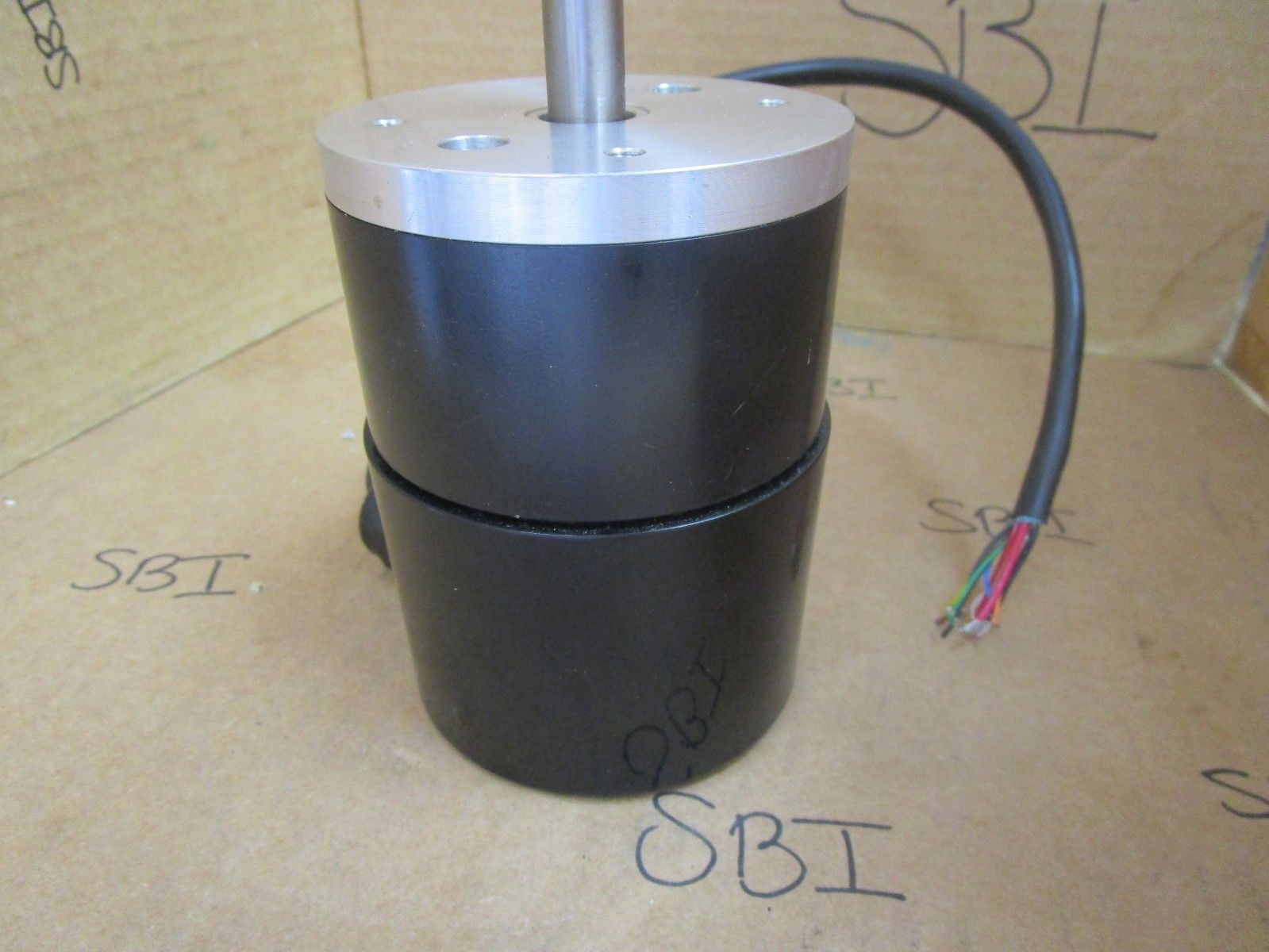

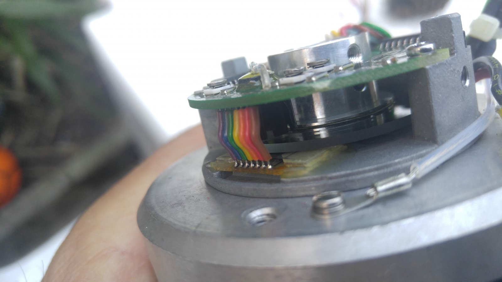

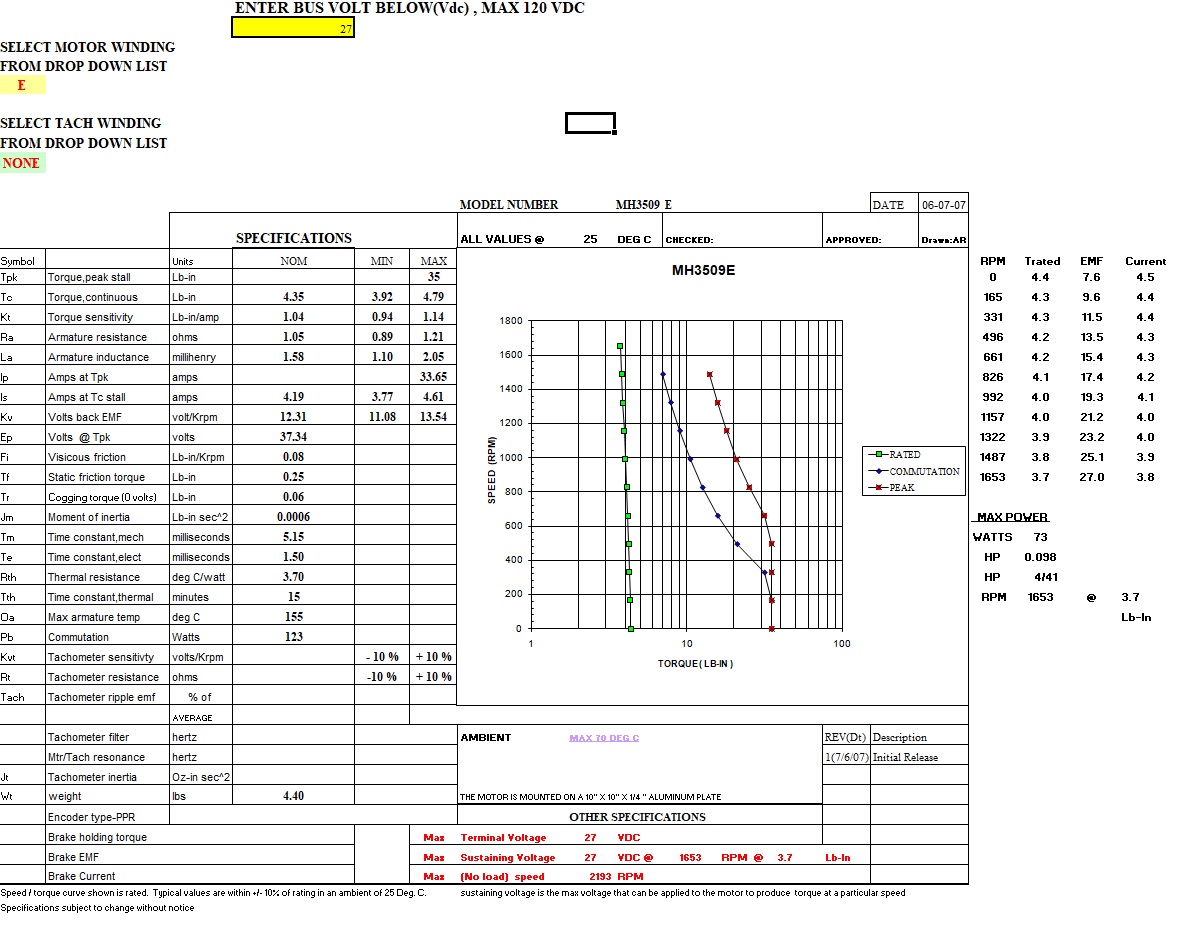

    I got a motor for cheap just to do some test before I get some more for some projects, as a small linear actuator, etc.
    This is the motor and all the info I got:
    The motor has 10 cables, black and red for power, I tested them and got movement in both ways, and another 8 more cables from the encoder I think.
    Is there any way to test this cables to see how can I get the encoder to work either with an arduino, or the @Thanos AMC1280USB I have lying around for sometime?
    I saw a video from the clearpath servo motor and it has the same amount of cables and colors.
    Any help?

    Servos have to have matching servo drive unit with them. The encoder is usually matched in the servo drive parameters, without a matching set of parameters you will have trouble setting this motor on a servo drive.
    Also this motor looks like BLDC, which usually has 3 sensor wires to send feedback about the coils current. Are you sure there is an encoder on the back of the motor? Do you have datasheet of the motor or its encoder?

    On the photos you posted that shows some motor data, it doesn't mention anywhere encoder CPR, just tachometer in herz which is completely different thing. You can open it and see if there is encoder in there, perhaps there is model number on the encoder is there is any.
    Is that DC motor? You have your finger on the motor label...

    Yes, it is a DC motor, I tested it at 24v, runs fine to both sides. It's not my hand but the seller's hand :)

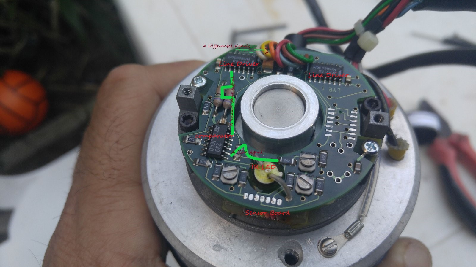

    You probably got a differential incremental encoder.
    signals A A+ B B+ Z Z+ (6 wires) and +ve -ve (2 wires) from the encoder. Motor +ve and -ve (2 wires, red black) makes 10 wires.
    Remove the cover over the encoder end and look at the circuit board.
    Post a detailed pic of the board and wiring and we maybe able to work out the connections for you.
    Even looking at the optical sensor will tell you a lot especially if it is a HP(agilient) one.

  9. mariano68
    mariano68 Active Member
    Nov 15, 2014
    585
    builder contractor
    Argentina
    3,452Coins
    +385 / 2 / -0
    2DOF, Arduino, 4DOF
    Thank you very much!
  10. mariano68
    Nov 15, 2014
    585
    builder contractor
    Argentina
    3,452Coins
    +385 / 2 / -0
    2DOF, Arduino, 4DOF

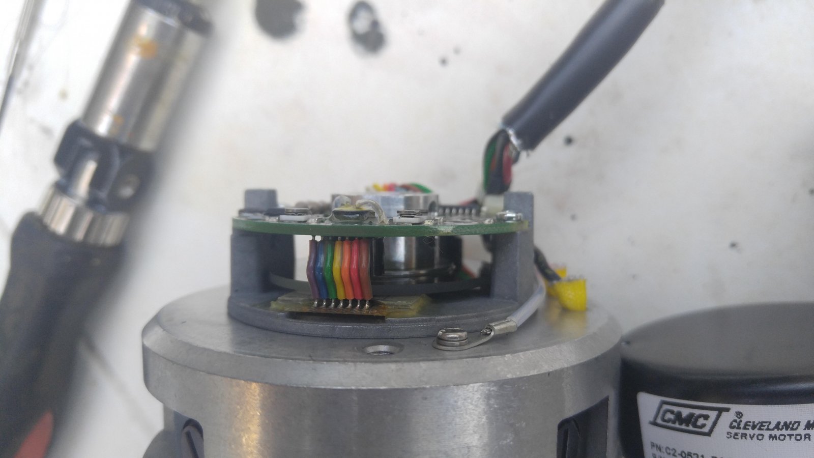

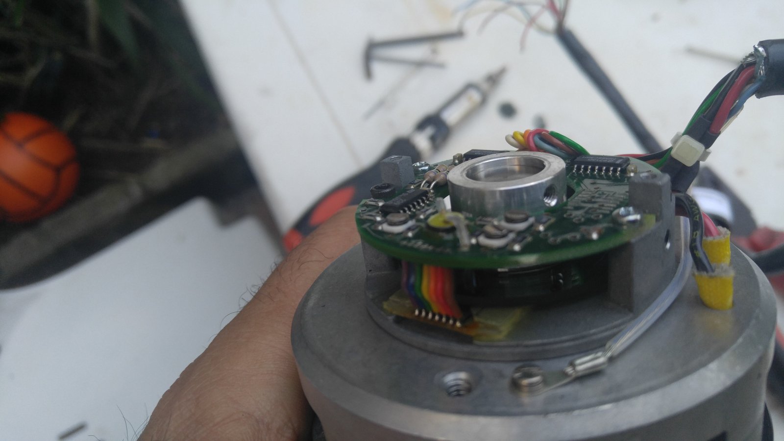

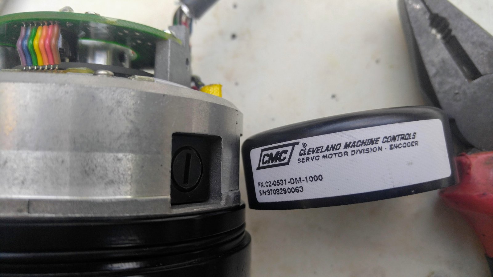

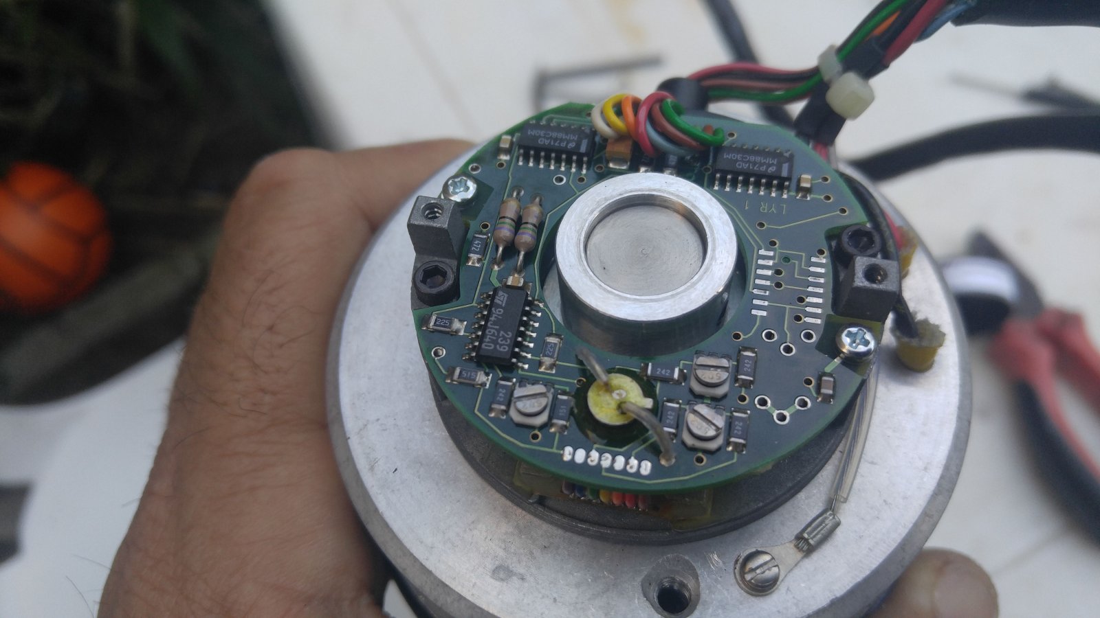

    Here we go!
    20180924_173135.jpg 20180924_173152.jpg 20180924_173223.jpg 20180924_173235.jpg 20180924_173258.jpg

    I can't find any information about this encoder by part number, but the single diode used for sensor looking at the wheel disk, indicates that this is only a tachometer...

    Are you sure? 5 pair of cables just for a tachometer?
    Anyway, I can take it out and put a real encoder in the same place, do I need something more than the AMC1280usb to use an encoder?
    @OZHEAT you're my last hope :sos

    Without datasheet its impossible to tell. It could be just tachometer with decade counter chips that convert the pulses to 8bit speed value...
  15. OZHEAT
    OZHEAT Member
    Oct 26, 2015
    146
    Australia
    1,800Coins
    +78 / 6 / -0
    3DOF, DC motor
    I'd have to disagree with you @Thanos .
    Looking at the encoder pic I would say it is an optical encoder with its glass encoder disc, a tacho is usually a coil which generates voltage proportionally to speed.
    While the encoder board uses proprietary maybe custom chips it isn't too hard to sus out what their probable functions are
    ppp.jpg A signal only shown.
    @mariano68 I don't know what kind of test equipment you have but a CRO would be very helpful in finding out what wires do what. If you don't have one then a dozen LEDs and resistors could be rigged up to indicate a sorta logic probe.
    Due to the woeful pictures, I can't trace any wires but what little I can see Red= +ve supply to encoder Black= -ve supply.
    +ve voltage could be +5v +9v +10v try 5v first and look at the IR LED with a camera to see if it lights up.
    My first guess would be White= A Yellow= B Orange= Z Blue= A+ Brown= B+ Green= Z+
    The A and A+ signals are differential signals, what that means is when A is high A+ is low and vice versa. You will probably use the encoder as single ended signals, so just choose the 3 same type of wires to use.
    Z or index signal is easiest to find as it will either be high or low all of the time except for one position per rev.
    A & B will alternate between A high B low, A high B high, A low B high, A high B high..... A+ B+ will be the opposite.
    The hard part is turning the motor shaft slow enough to see the changes as I suspect you have a 1000cpr encoder.

    @mariano68
    As you don't have a great deal of equipment, hopefully you have a multimeter and an ardinuio.
    I think it would be easiest for you to work out the connections from the motor...
    You have 8 wires from the encoder
    Red & Black (I think I can see a black wire) - power to the encoder, check by following where wire go to on board.
    A & B - Encoder Output signal, see quadrature encoding.
    Z - Index signal, only has 1 pulse per revolution.
    A,B & Z have complimentary signals as well, you have a proper optical encoder albeit an older one so they use differential signals for long distance to mitigate EMI. A bit like rs-422.
    Using this pic for reference....
    The red & black wire will be the only 2 connections that don't just go to the line drivers
    Apply +5v to red wire. -5v to black. Look at the area between the IR led and sensor board with a digital camera, it should glow. This will confirm that it is powered up.
    Write on a piece of paper the wire colors. Measure each wire and note the results.
    Now move the motor shaft and note results. Each time there should be 3 low an 3 high signals.
    The 2 signals Z or index shouldn't be hard to find as they don't change except for at one position.
    A & B will be last 4 wires. Complement signal will always be opposite to each other while A or B will lead or lag depending on direction.
    Get an Arduino and google rotary encoder sketch maybe a Leonardo with the ffb code and use that to test motor and the encoder.

    @OZHEAT , you nailed it! Thanks!
    Got an old friend to jump up into my project, he is doing the electronics now, already got the encoder (2000cpi) to work with arduino, but arduino and also the sabertooth will get out of the ecuation soon... I want my little 48v servo motor to work at that 48v!
