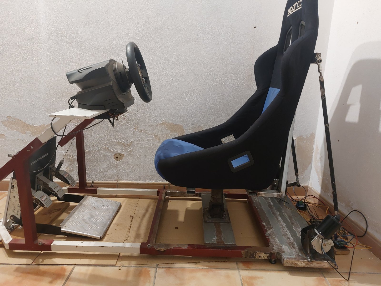

    I am Raúl, a Spanish mechanic who has gasoline running through his veins and at this point I need help or advice so as not to waste money on components that will not work for me.
    This is my project today, I took my cockpit and four things that I collected in the workshop and here you have it

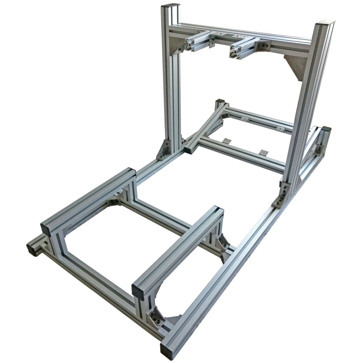

    Now I'm looking to make it in aluminum to do something similar to this

    Hello good. I have already ordered the aluminum profiles and when I have it assembled, I will try simcalc since I still do not have the measurements. But I would like to know which configuration is more suitable to move the entire structure, push from the base of the structure or a higher point like the shoulders? Where do you exert more force on the motor? Does it affect movement speed?
    21,513
    150,698Coins
    +11,018 / 55 / -2
    Yes the design configuration makes a difference to the motion and potential load on the motors.
    What is 'more suitable' depends on the design goals, a shoulder mount seat shaker design has a lot of inherent design leverage so is better for weaker motors, a compact design takes less physical space but because of the more limited design leverage needs more motor torque to drive it.
