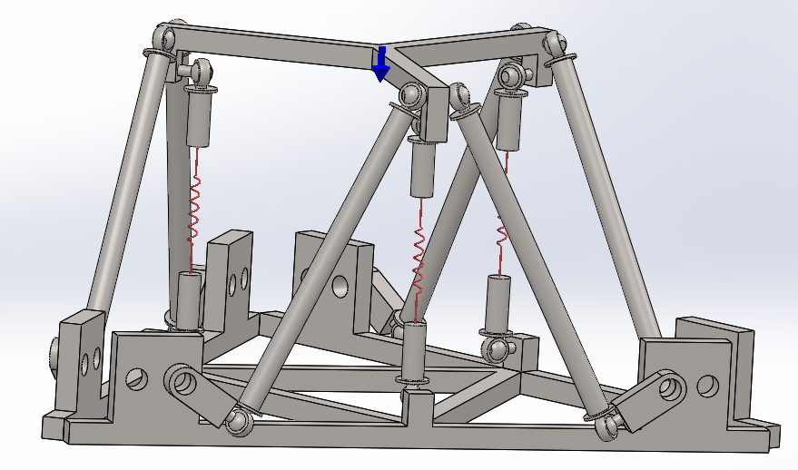

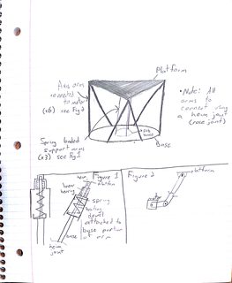

    I had the idea to use springs to support the chair, much like the center pivot spring in a 2dof. I noticed that a lot of people didn't think they would work, but the more I crunched the math the more I hoped it would work (and the more I hoped I wasn't just forcing the equations to show me what I wanted to see). I came up with a simple sketch of this idea, shown here (click image to see the full size.)
    As you can see, there are three shafts with the same heim joints (rose joints) connected to a sub-base (just a part of the base) which support the platform. This shafts are split by a spring, and use a locating dowel and a linear bearing to stay co-linear.

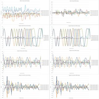

    I modelled a very simplistic version of this sketch. I applied a 300 lb (1340 N)force to approximate the weight of the chair and me and probably 70 extra lbs to the platform, and simulated a motor rotating at a max speed of close to 120 rpm. There is a video of the simulation (8 seconds) here
    I simulated this motion with and without the springs, and plotted the results of the torque, displacement, velocity, and acceleration of the motors. The results are here [​IMG] .
    As you can see, the use of springs greatly reduces the amount of torque needed by the motors. I did this all as a simple proof of concept, to make sure the equations I was getting on paper were correct, and to make sure I wasn't wasting time on this thought process. With these results, I now have the information needed to tighten up my model and make it much more realistic, include interference detection (some components were hitting each other in that simulation; this didn't affect the torque but it will when I run the accurate simulation), and include a mass/gravity combination instead of just a force.

    Edit: Here is a picture showing the springs and the 300 lb force: [​IMG]

    man thanks for sharing... but in the animation you posted (nice animation by the way) i did not understood where the springs comes... where are they?
    best regards
    fer
  13. insanegr
    insanegr !N$@n€
    Jan 14, 2014
    503
    Athens
    16,723Coins
    +499 / 1 / -0
    @fer as i can see from the middle of lower frame to the middle upper frame its like a "suspension" helping the upper frame to lift with free moves. taylor will say for sure nice thought btw

    @ferslash, @insanegr is correct. Here is a picture that shows the springs and the force: [​IMG]
