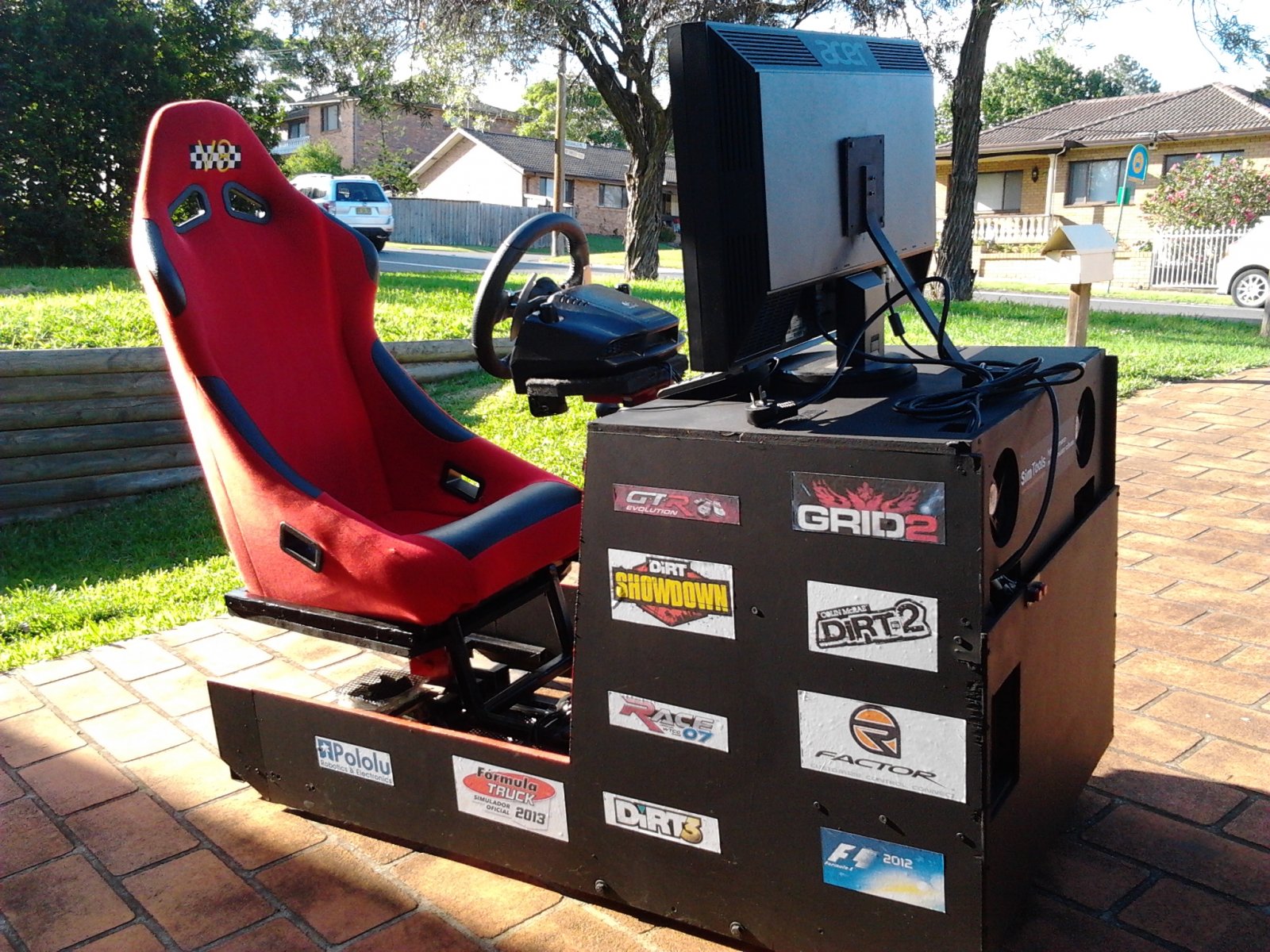

  9. bsft
    I dressed up the "foot motor" mount sim
    Cannot see anything really
