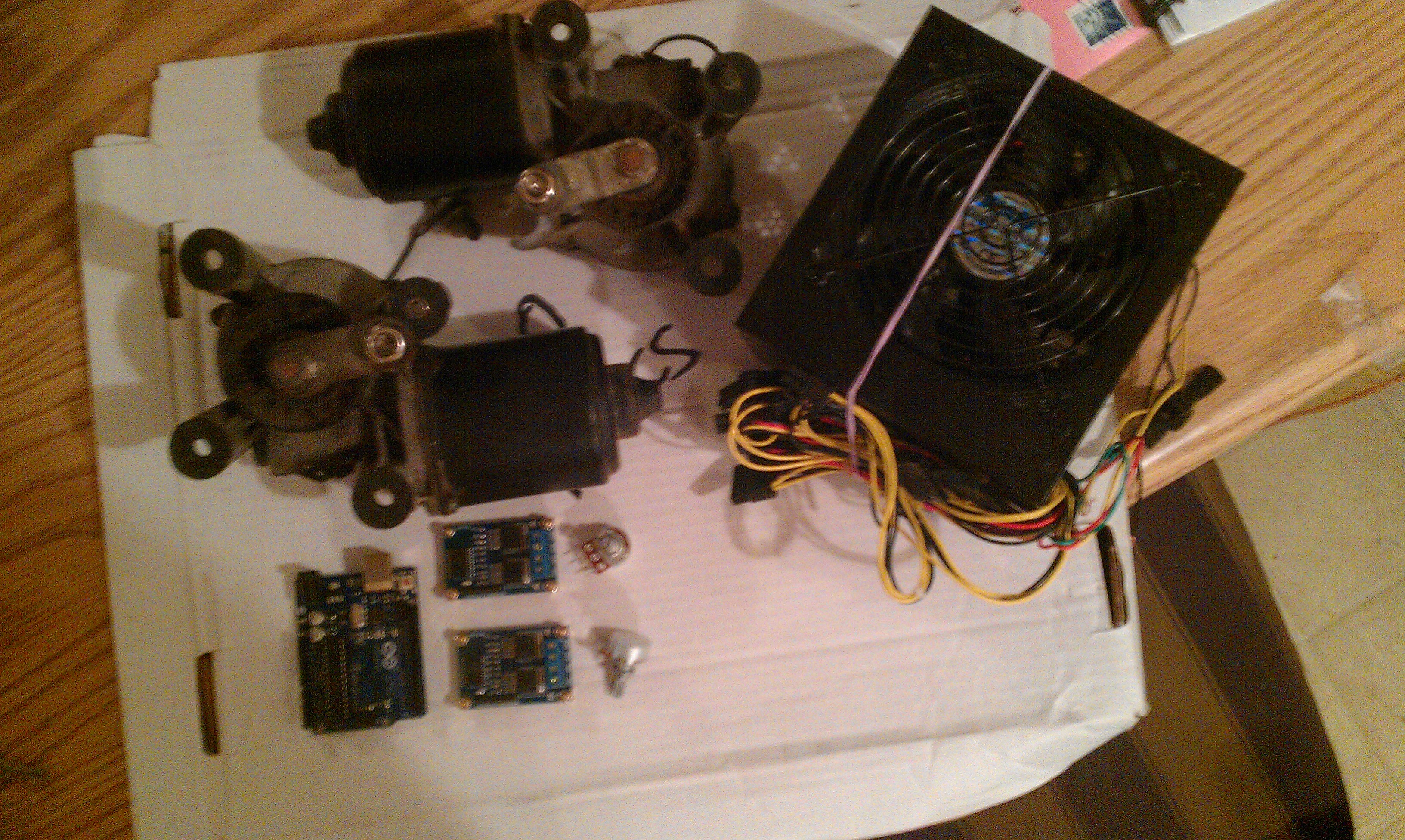

    I built a static sim from 2 pvc with 3 x 24 monitors, buttkickers, race seat, Logitech G27 wheel. we loved it but wanted more.
    Did some research, bought these parts - now what?
    How do I connect all these parts together?
    PLEASE Help, beginning to get frustrated.

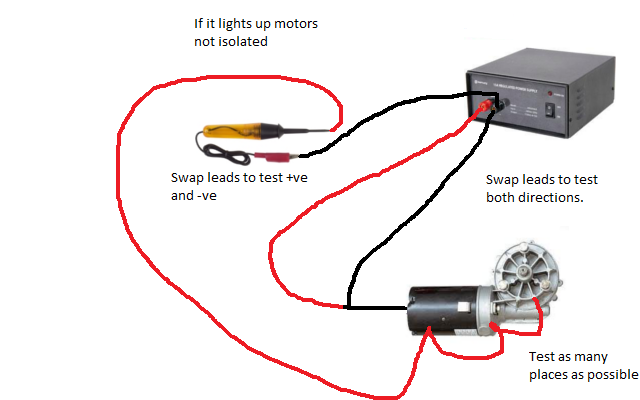

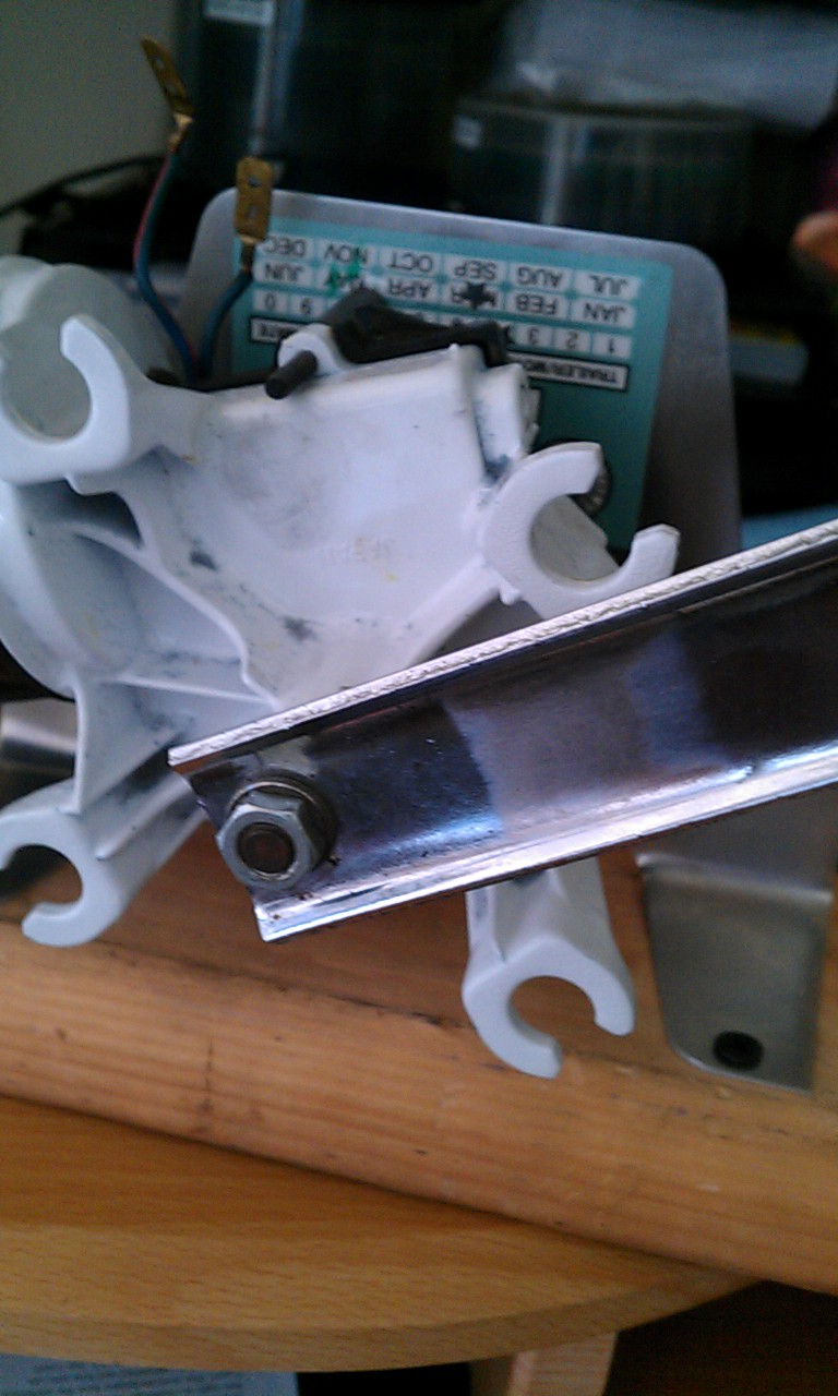

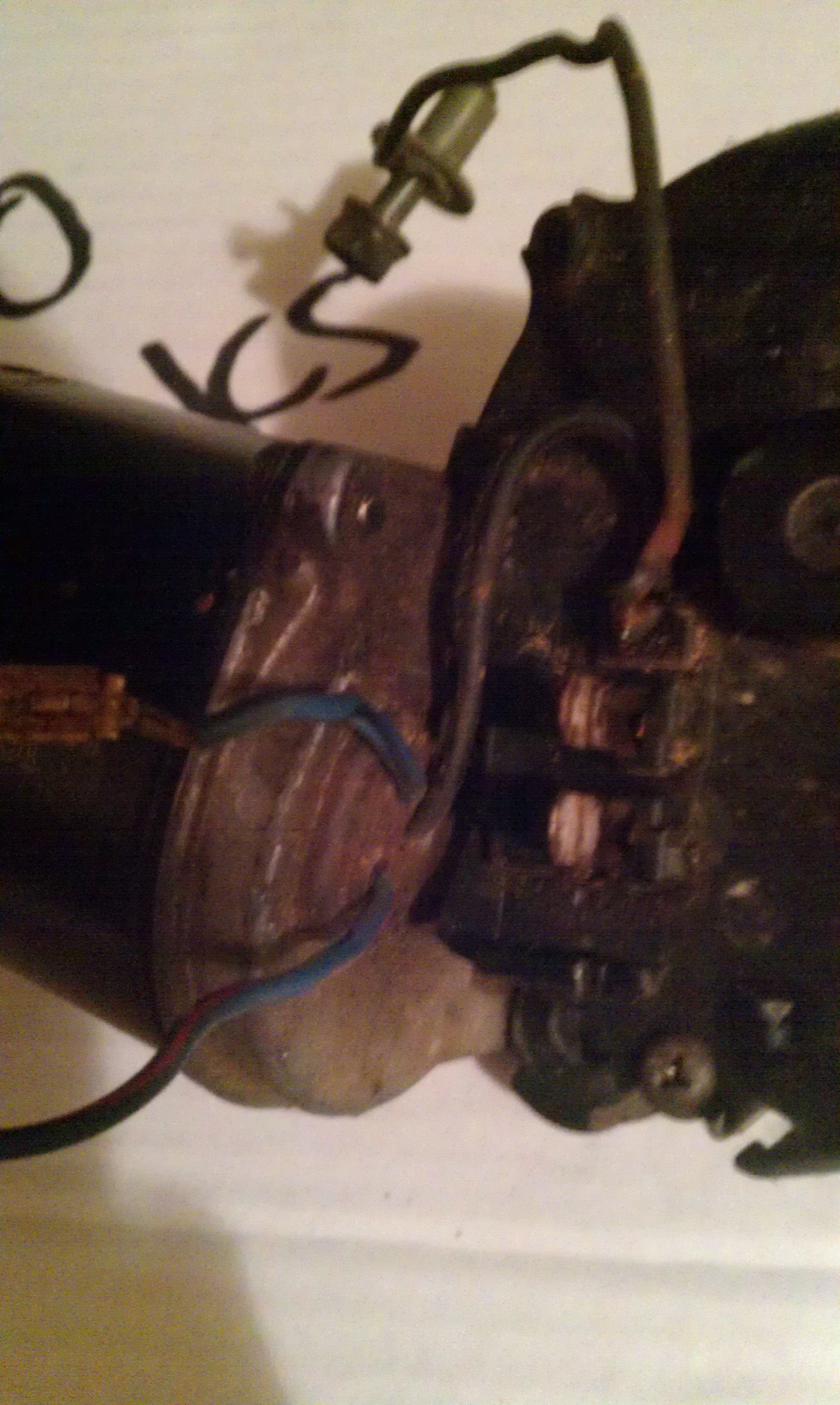

    good ideas, was thinking more along the lines of direct drive from the wiper shaft, would you recommend this as I think it would be more minimalistic.

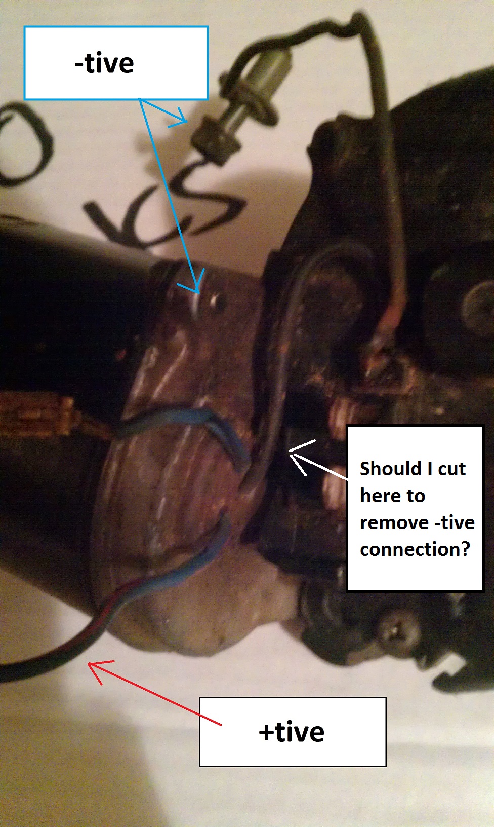

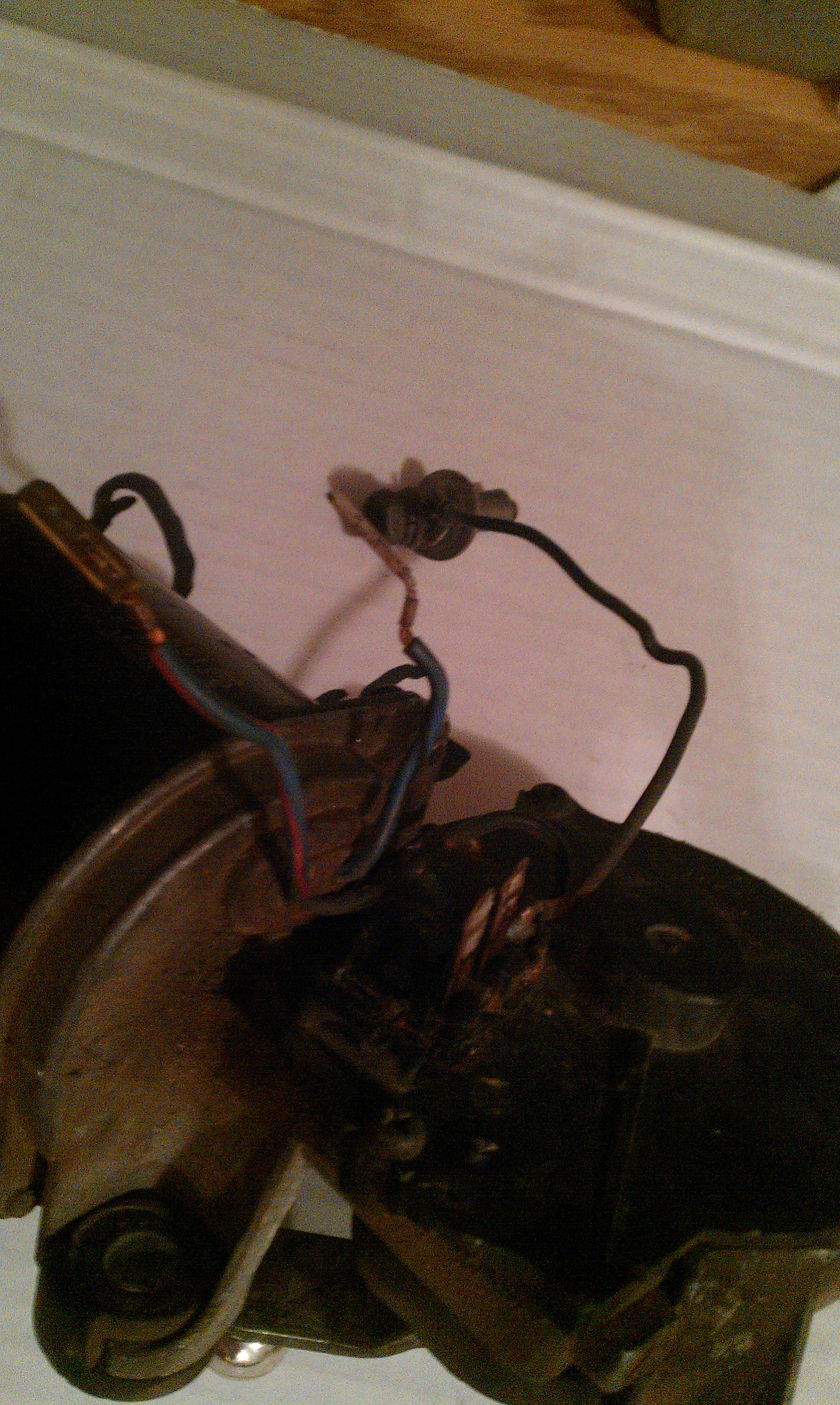

    Here is a close up of the motor connections.
    1 blue/red wire , 1 blue/black wire , 1 black (earth wire) , 2 other connection blades

    tested motor..
    positive on red/blue and blue/black connected makes motor go (switch these 2 over and it goes in reverse) motors work.
    negative ground on all metal parts
  9. eaorobbie
    20,464Coins
    +1,686 / 23 / -2
    Negative grounding on all metal parts need to be fixed mate, can not have a earth leak because when power reverses you motor becomes live with 12v making your sim live with 12v, dangerous to all electrical equipment attached.
    This needs to be changed
  10. bebop33
    bebop33 New Member
    Jun 2, 2013
    14
    - 32Coins
    ok, we are good to go with motors.
    Both tested, no leaks anywhere.

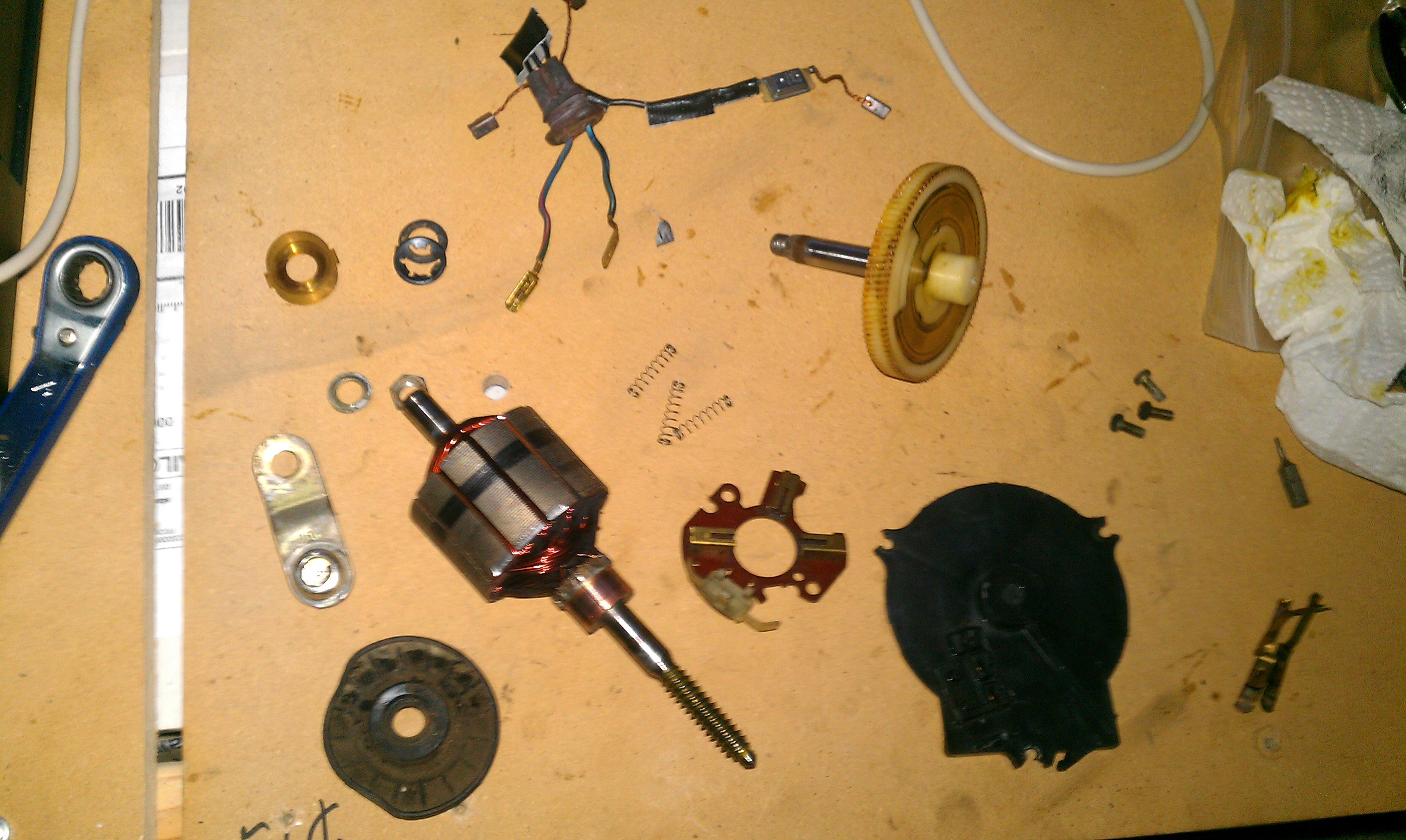

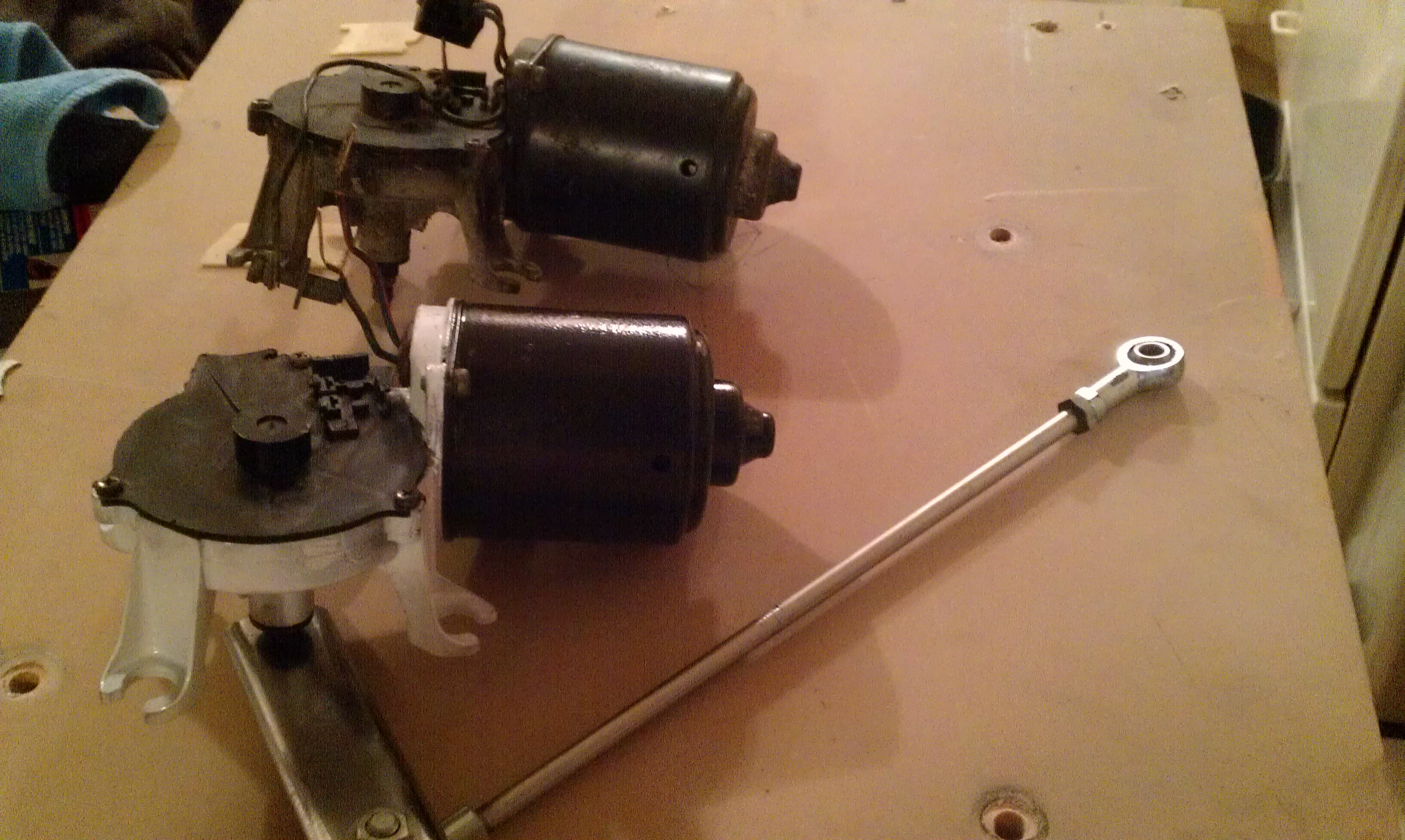

  11. bebop33
    bebop33 New Member
    Jun 2, 2013
    14
    - 32Coins
    Motors - taken apart - ungrounded, painted and modified.

  12. eaorobbie
    20,464Coins
    +1,686 / 23 / -2
    Now you need to set the motors like my examples above the wipers lever needs to connect to the pot, basically the pot is used to feedback a position the motor arm is in.
    From there we can wire it all up and flash the ard UNO with the firmware and start to set it up.

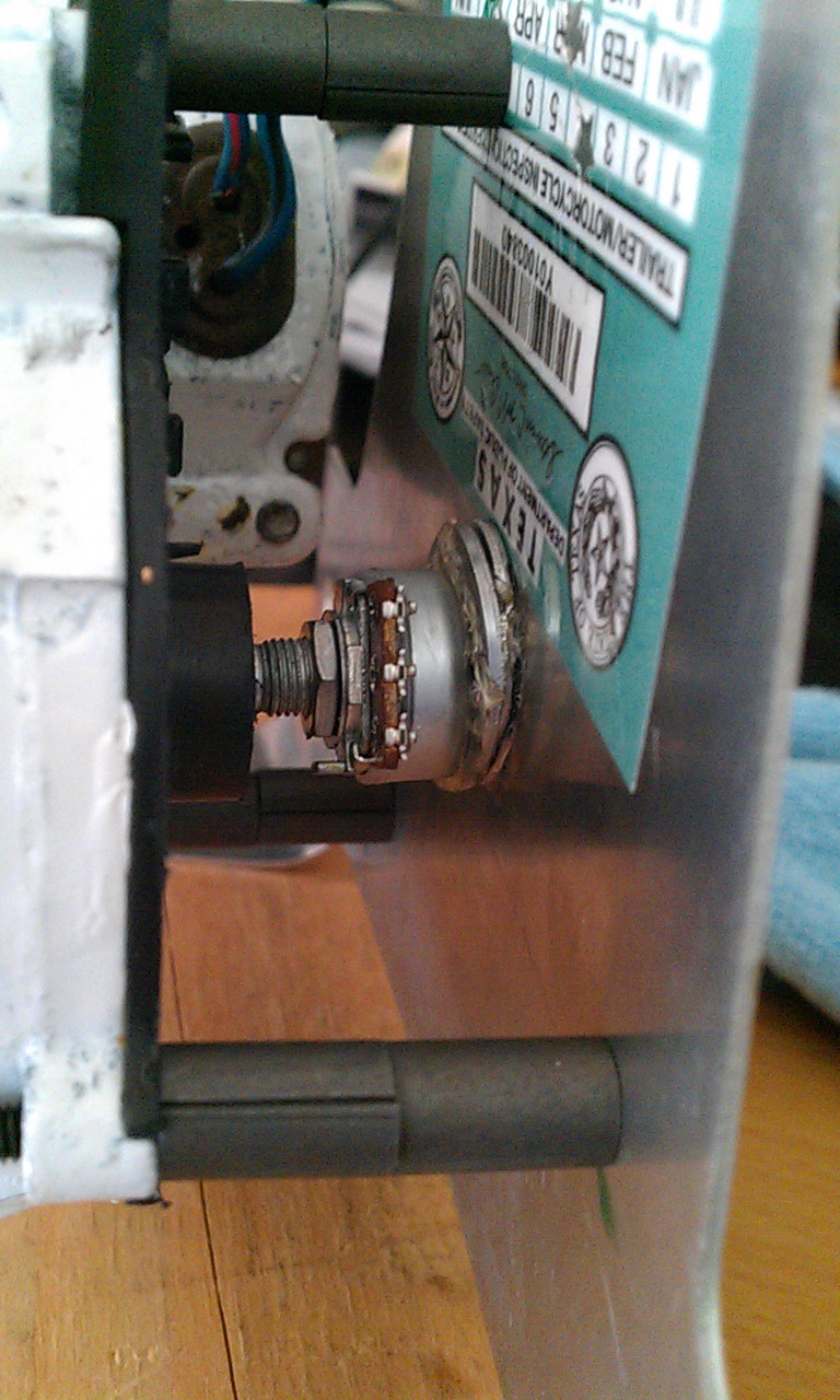

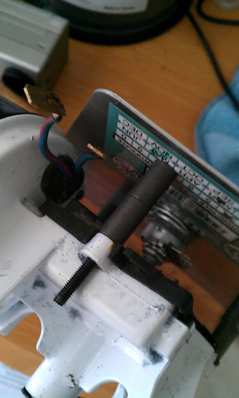

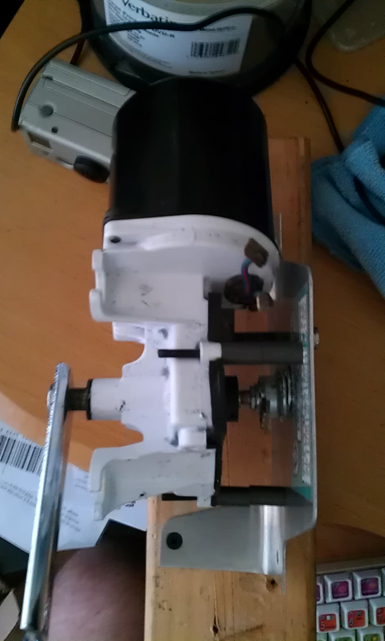

    OK, here is my temporary mock-up for motor until we make sure everything is gonna work.
    You can see that I have attached the pot directly to the motor and clamped it in place, I have not added power to the motor since doing this as I know it will rotate too far and break the pot.
    You can see the positive and negative motor wires at the top.
    Awaiting instructions.

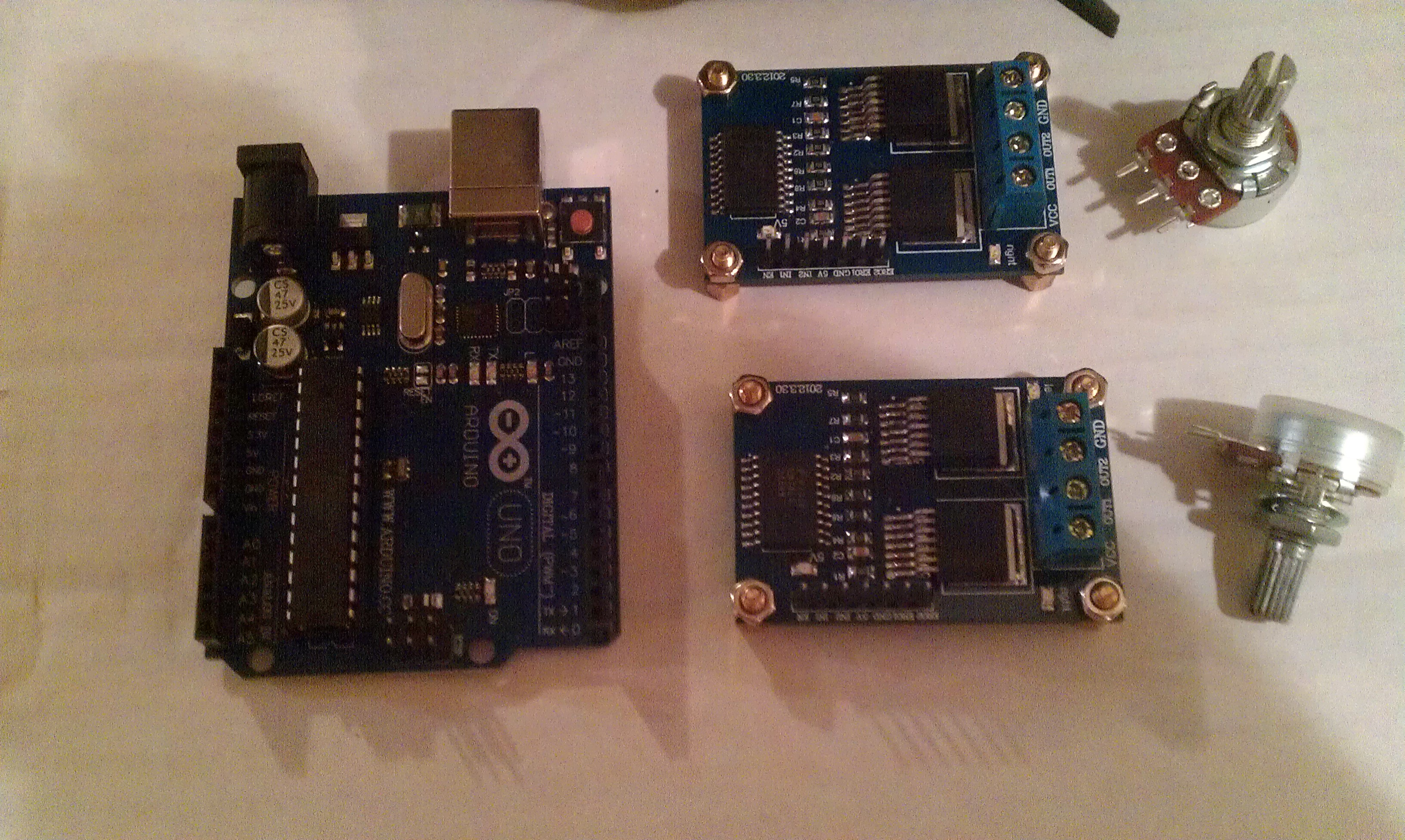

  17. bebop33
    bebop33 New Member
    Jun 2, 2013
    14
    - 32Coins

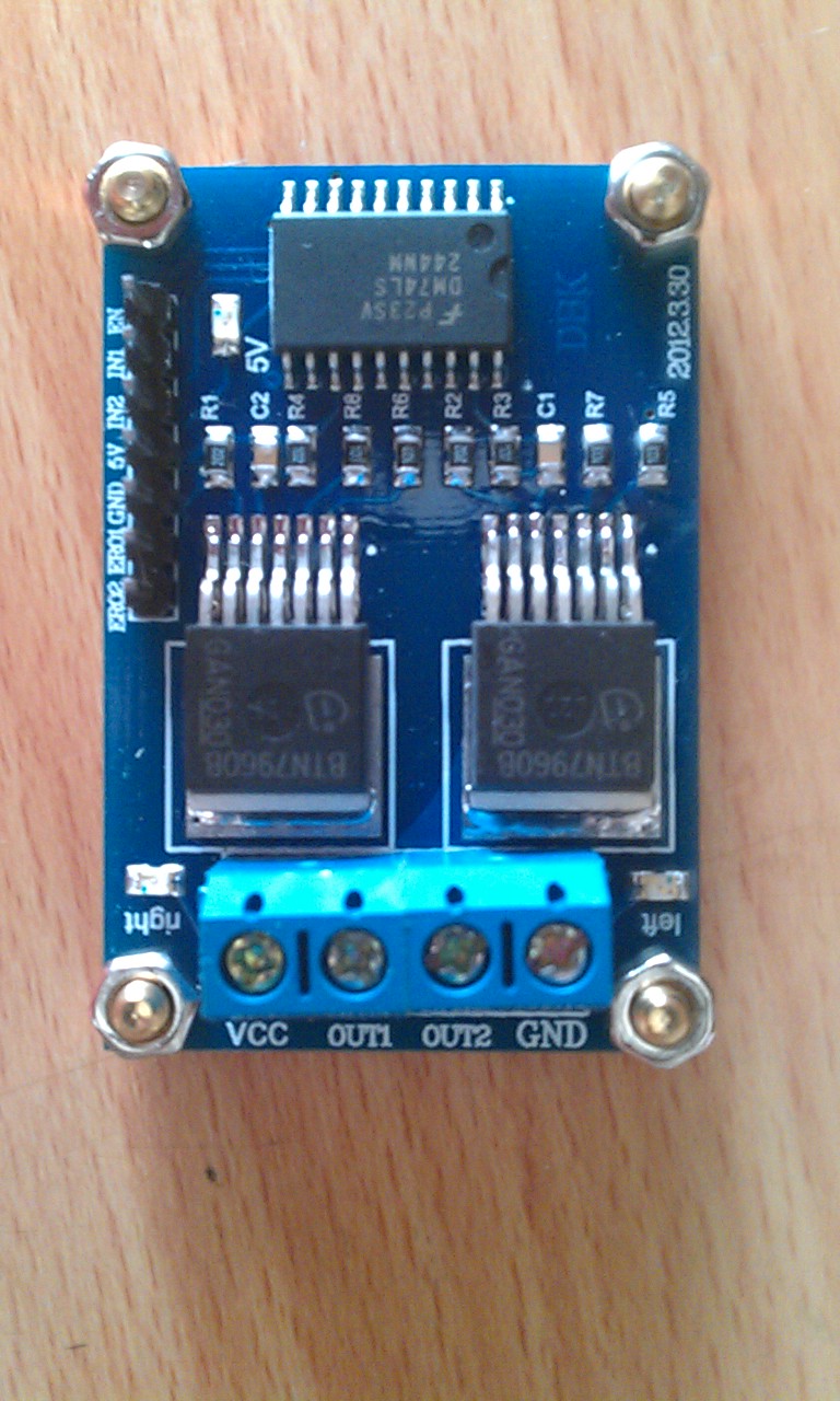

    Here is the bridge.

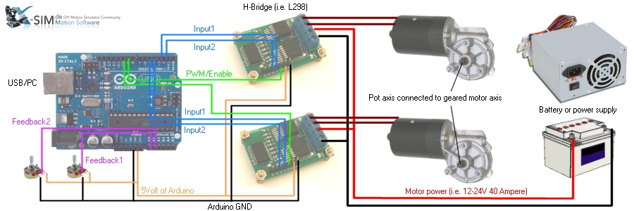

    How do I start with the programming of the Ard?
    I couldn't really follow the instructions by prilad as I'm not using the same hardware.

    This was the pic I tried to follow but it is not very clear on connections and if I've not programmed the Ard, it wouldn't work anyway.
