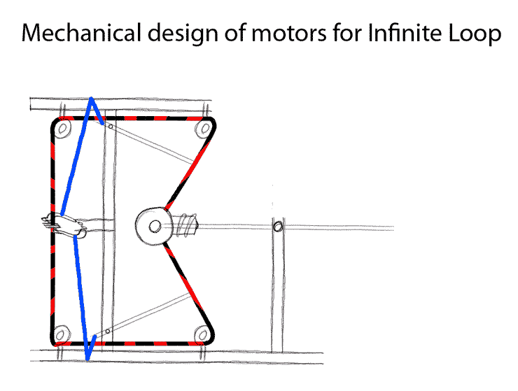

    Hello friends developers, :hi:
    Hello R-eng, :hi: :D
    I thought of a way to solve the problem of moteres exceed the end of the course. The idea is a mechanical way, a safe brake set but if Limet is exceeded the brake is released and the motor spins in the loop.
    projetinho.gif :thbup:
    Regards
    Everton

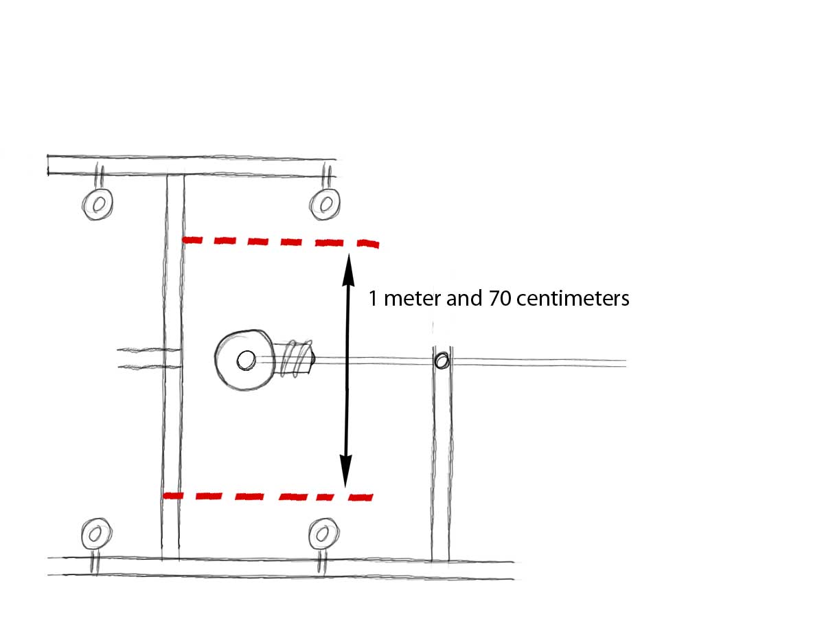

    Hello Friends developers, :hi:
    I will make only one more question, then try not to bother anymore! :blush:
    Based on post Frankk, notice is:
    Taking the limit switches with a height of 1 meter and 70 centimeters, and the time axis to move from bottom to top is 4 seconds, with the axis of the windshield wiper motor giving three turns.
    For the experience you have, is setting is good? That for a x-simulator 130kg complete without the pilot, and windshield wiper motor and the 60Wats 24V/18A.
    Again, many thanks for the tips are very important for me with little experience.

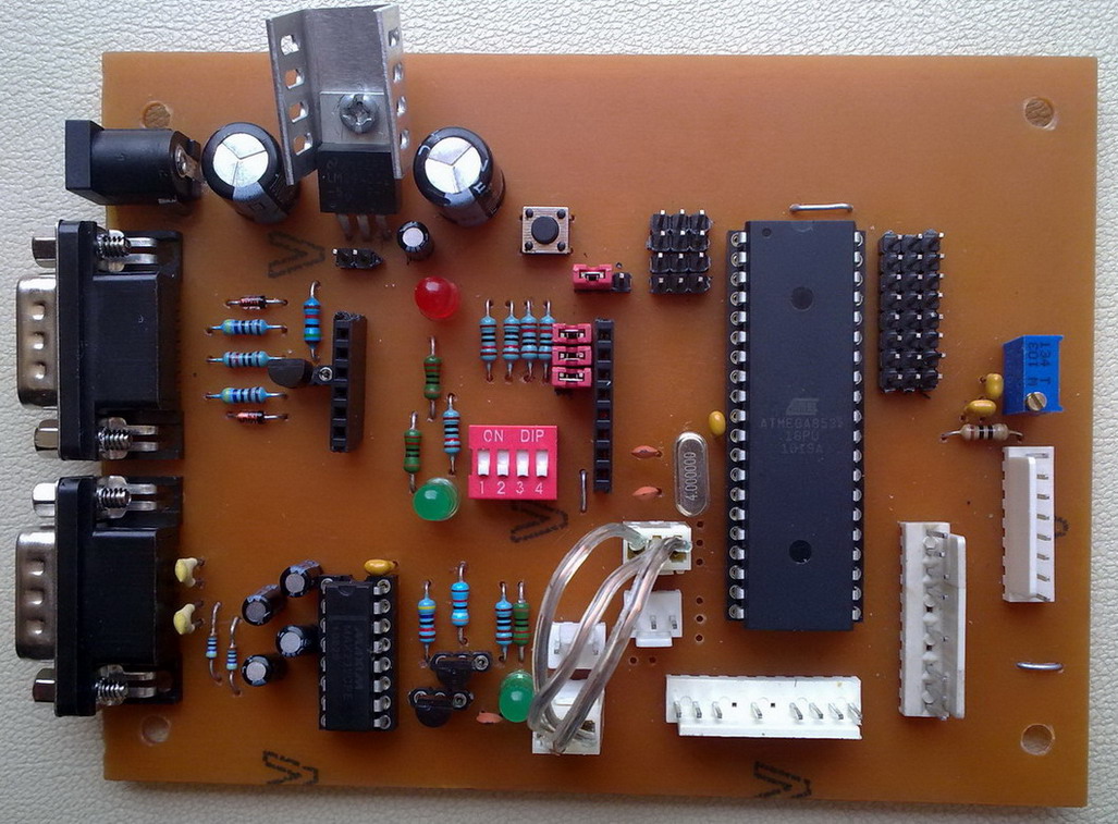

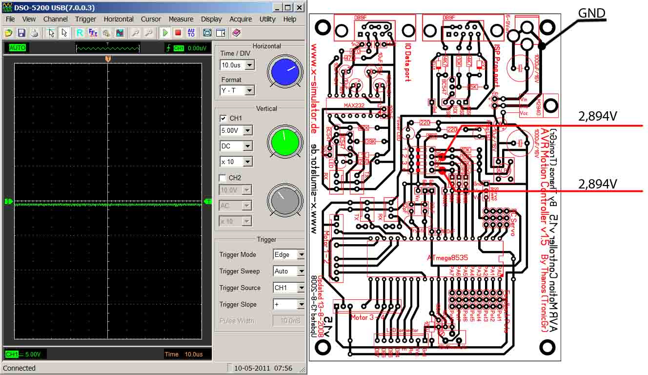

    hi freinds ,
    I can not write the firmware on ATMEGA8535 too . . .
    and i need help too. . .
    as i follow Tonquitos problems so already checked:
    1-checked for all cold soldering
    2-checked all parts and try to chose exactly the same as Thanos one(you can check also)
    3- checked cable and make my own cable pin to pin.
    4-use 4khz crystal for programming
    and
    follow the steps of Thanos_ponyprog_guide1_1.pdf
    but i have still problem,
    one of my question is what is the compelet connection set up at the programming moment
    for example: RX and TX connections,switches and others. . .(sample picture could be the most)
    cause im a beginer,
    and where can i find a comperehensive explanation for programming AMC 1.5 like that Thanose
    did for DSMHB in: tronic-s-diy-dual-mosfet-h-bridge-t820.html
    thank you

  11. hooshang
    hooshang Active Member
    Jul 6, 2011
    265
    248Coins
    +151 / 3 / -0
    hi tonquites
    i got the videos,they were realy useful and they took me
    several steps forward, thank you. . . thank you. . .
    would u please tell me how can i learn that if my ATMEGA8535
    work well or it is damaged,is there any test for this purpose.
    regards
    Hooshang

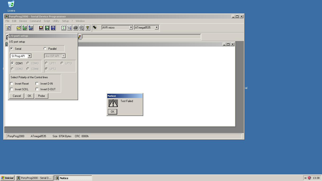

  12. tonquites
    tonquites Member
    Jul 24, 2009
    42
    Joinville, Brasil
    280Coins

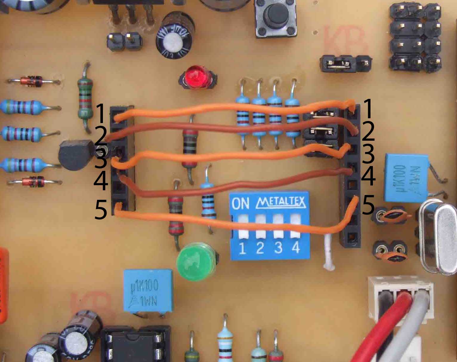

    Hello Hooshang,
    The three questions, A, B and C that you should check:
    A - If there is communication between the PC's serial port and serial port of your AMC.
    My first serial cable was not all the way, and it did not work try programming.
    Test the cable to see if it has all the routes.
    B - If the PonyProg2000 connects to ATMEGA8535
    Make sure that the five wires that connect the serial port to ATMEGA8535 are well connected.
    If A and B there is no connection then the image is this:
    C - If the damaged ATMEGA8535
    If you have the connection but I could not read the ATMEGA8535, he may have been damaged:
    Sorry my low experience
    I hope I have helped
    Regards
    Everton
  13. tronicgr
    tronicgr
    About C ... It may not be actually damaged but just inaccessible by ponyprog due to crystal or timing matters. Ponyprog needs calibration before you can use on very fast computers.
  14. hooshang
    Jul 6, 2011
    265
    248Coins
    +151 / 3 / -0
    thank you freinds for quick reply
    i have changed ATMEGA8535 but i have still that previos problem
    but look at this picture that Tonquites already posted:
    at this picture my voltmeter shows on sw2 : 4.30 instead of 2.894
    and shows on sw4: 4.85 instead of 2.894 with this only difference
    where is the problem?
    thank you again
    best regards
    Hooshang
  15. tonquites
    tonquites Member
    Jul 24, 2009
    42
    Joinville, Brasil
    280Coins

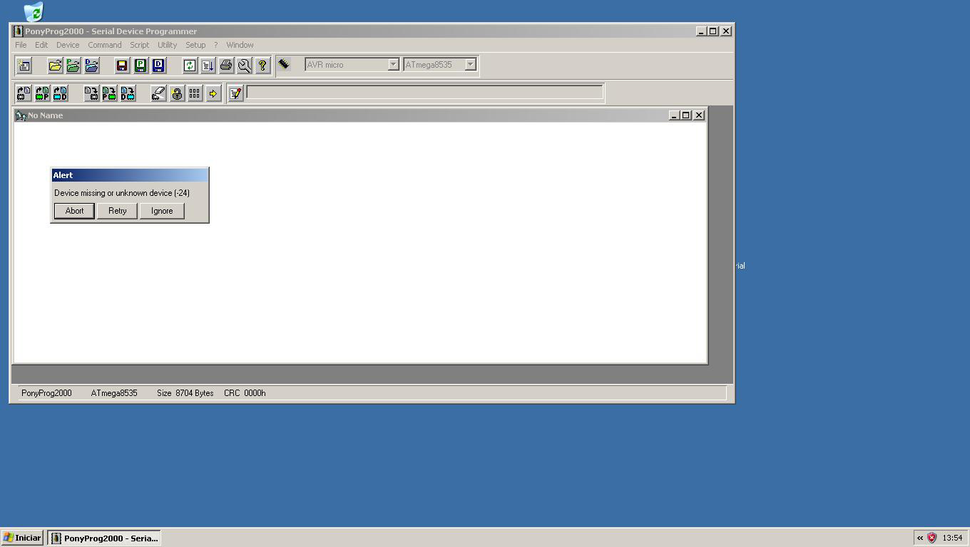

    Following this list what:
    1 - Start up the AMC in force
    2 - Connect the serial port cable programming.
    3 - Run the program PonyProg2000.
    4 - Click on OK. The Following window appears.
    5 - You need to run Calibration from the Options menu before any read / write operations
    Click on OK
    6 - Select 'Setup -> Calibration'
    Calibration OK
    7 - Select Setup -> Interface Setup 'and set up as shown below (Serial SI Prog I / O, COM1) and
    click on Probe.
    What message is reported?
    'Test success' or 'Test Failed'?
  16. hooshang
    Jul 6, 2011
    265
    248Coins
    +151 / 3 / -0
    Teat faild

  18. tonquites
    tonquites Member
    Jul 24, 2009
    42
    Joinville, Brasil
    280Coins
    Your problem is somewhere in the line of communication between PonyProg2000 > serial port > serial cable > AMC tracks > ATMEGA8535
    Your serial cable is all the way?
    Test with a multimeter the continuity of all cable channels.

  20. tonquites
    tonquites Member
    Jul 24, 2009
    42
    Joinville, Brasil
    280Coins
    If all DIP switches are off (as has to be in programming). These voltages are from the serial port connection and ATMEGA8535.
    I do not understand much of the voltages involved in the serial port, so I can not say that this is the problem.
    From my experience your problem is the connection.
