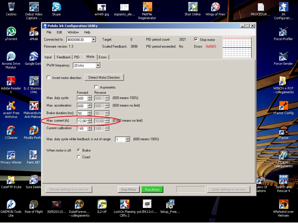

    Hi bsft, please take a look to the attached pic.
    maybe you mean that you set the MAX CURRENT in the jrk config utility at 22.5 A?
    If yes, it's a great thing! I am using it at 12.069 as you can see.
    I had to do some tests about but never get the time to do that!
    If you confirm me so I will can to have more power to my motion system!
    In fact the winches can work with more than 12 Amps (so and so 25) and since now I cut the winches power to 12 Amps obtaining NOT the complete power! (I was thinking that was too dangerous to get up this value considering the jrk work at 12Amps (just peaks to 30Amps)
    So, if you confirm me, have you some issues using 22.5 Amps? too many heat?
    Thx!

  6. bsft
    Hello Aldoz, yes I mean 22.5 amps Max Current. I have heatsinks on the big chips and a fan blowing air into the box they are in, so they barely get warm. No problem what so ever.
    The max current is for BIG movements. I contacted Pololu direct and they say this is fine to run with cooling.
    Cheers, David.

    Ahh great news! Next days I will to try to get up to 22.5 Amps, I am sure I will get a bit more power!
