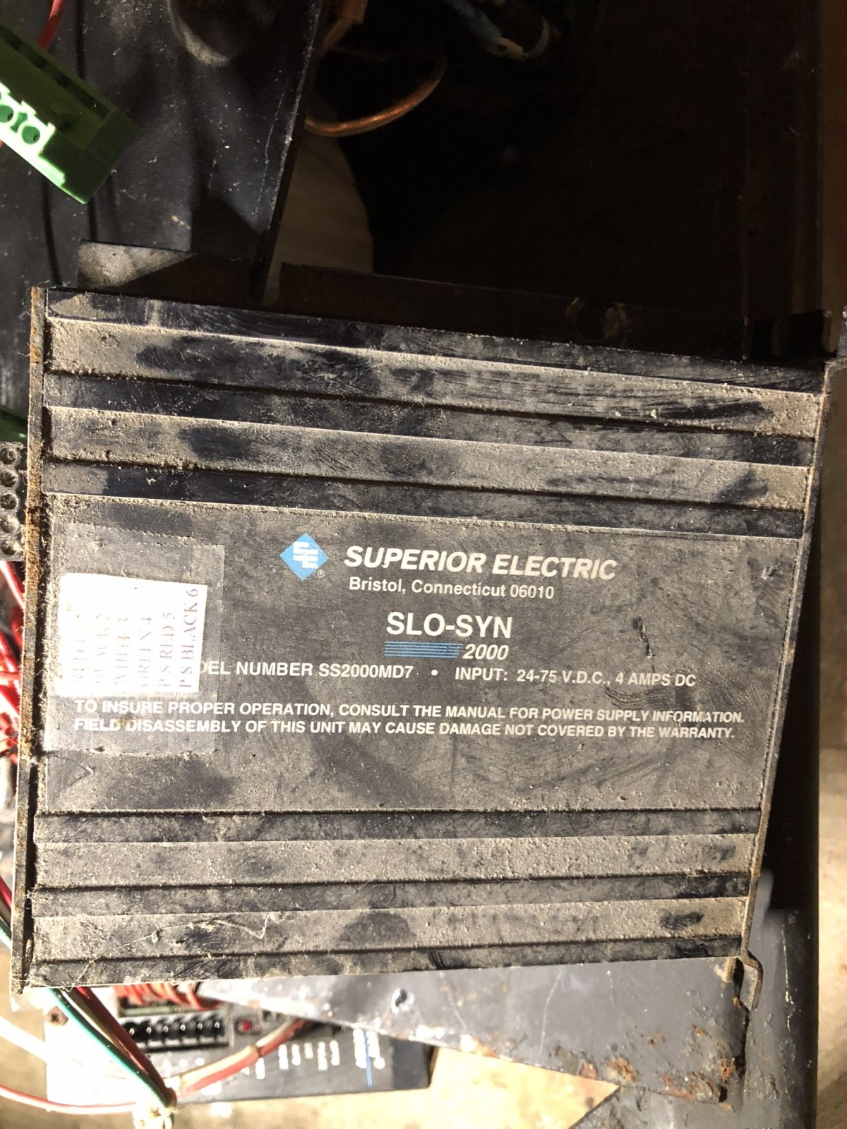

    9C5F65D2-F8D9-4AEA-AA59-8643027FBAC6.jpeg D5668BD0-F074-46B1-8A11-B0DF7AD2AB86.jpeg BFE72D0C-A6BB-4952-A375-4240473BC94D.jpeg Hey guys I think I found the right place! I am a military pilot and build my own simulators, but until now they have been fixed. I am very picky that the aircraft operate and feel like they should and I was researching putting the F-18 simulator I built, to be placed onto a full motion platform, when I discovered these old commercial simulators already on a full motion platform. These simulators have been moving from warehouse to warehouse for years after the previous owner’s passing. They are a really cool “barn find” I have two of them and various spare parts, but as you can see in the pictures they need complete restoration. My plan is to completely restore the f-16 with all new avionics and accurately duplicate an actual f-16 panel with modern software. On the other I will place my already built F-18 as soon as I can get the full motion simulator running from the simulation software. Below are pictures of what I am starting with. I am completely new to full motion simulation so I will need to be guided by the experience here to get this thing up and running. I am really excited about the possibility of a Department of Defense grade simulator when I am finished. So the first thing I need to learn is how to interface my Lockheed Martin P3D software to this simulator to be able to control the pitch and roll axis via the software. Below are photographs of what I am starting with. Any help with this project will be greatly appreciated. Thanks for the help, Lee

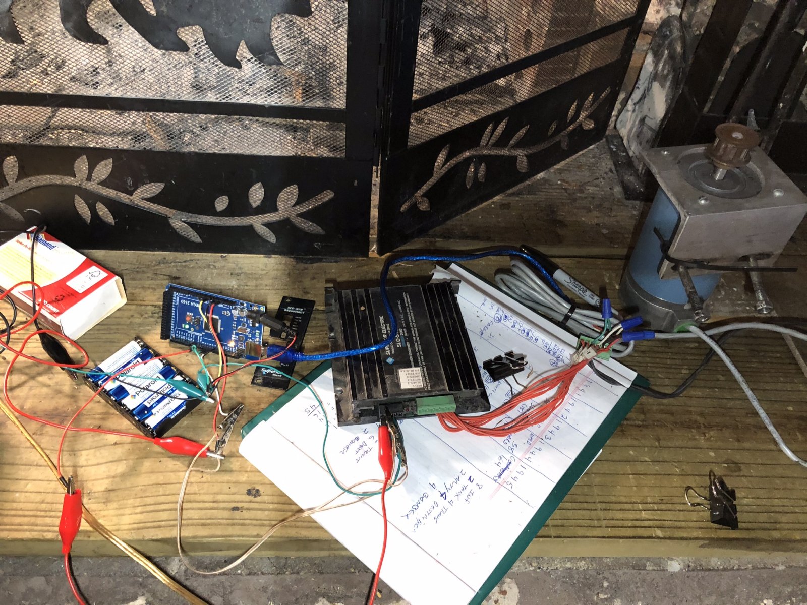

    UPDATE: I figured out how to use an Arduino mega 2560 to send signals to the motor controller and I am able to run the original motor on a test bench with the Arduino and respond to code. Next step is to figure out how to get the motor to respond to the simulator software. Any advice on how to get P3D to drive the motors?

    What type of motors are they ?
    Are they dc motors or stepper motors ?

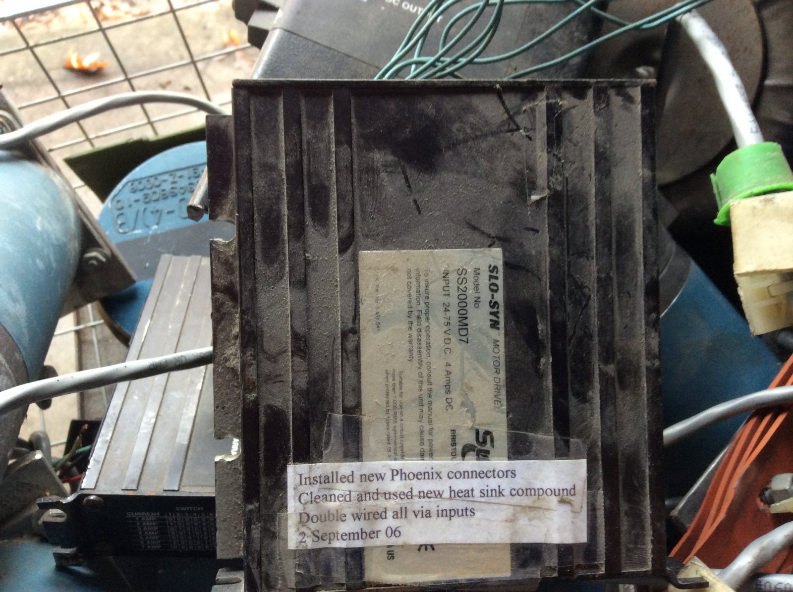

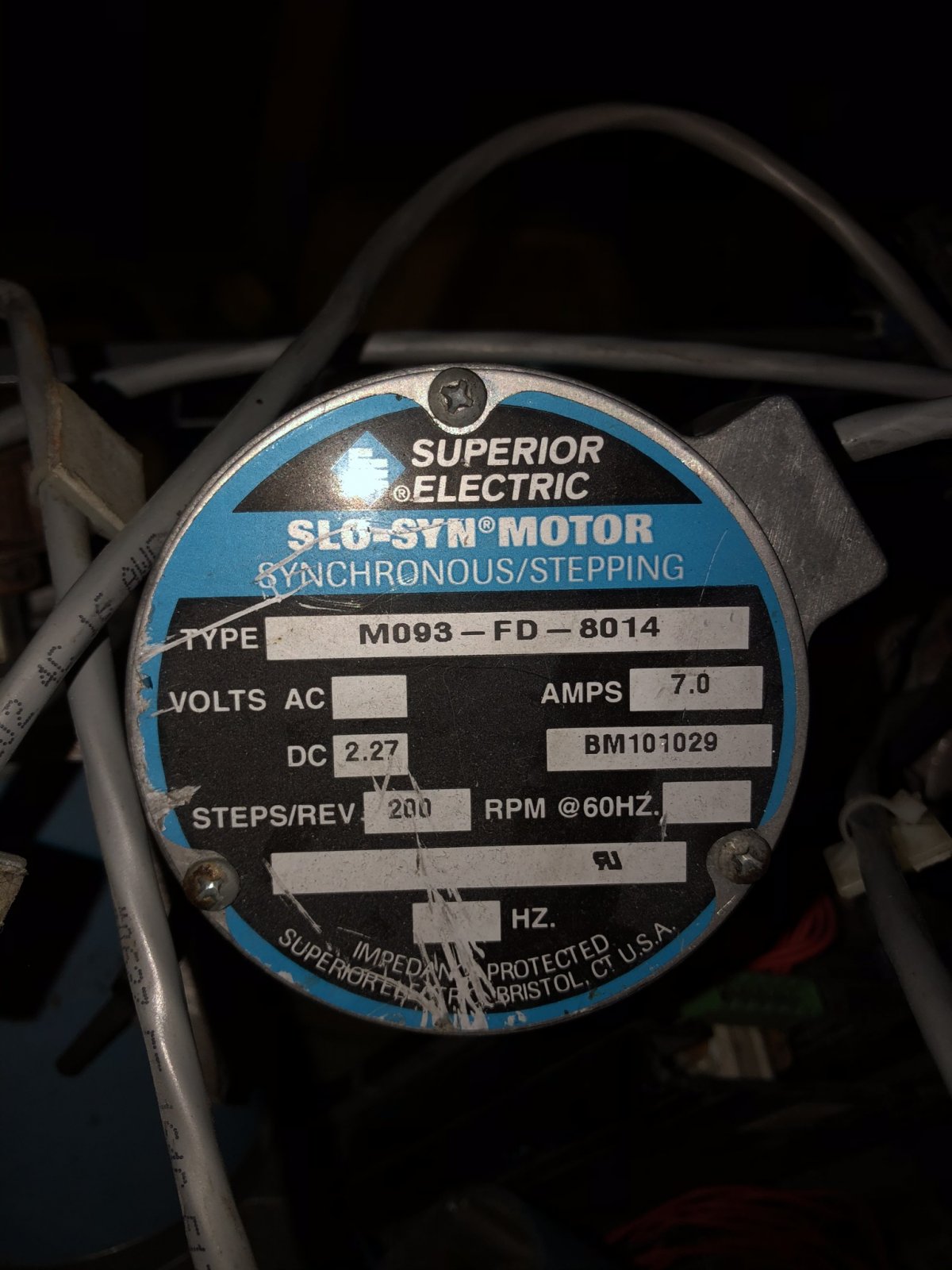

    Hey! Thanks for the interest. They are stepper motors with matching controllers and I have them running with an Arduino circuit so I am thinking that next step is to get Simtools. Am I on the right track?

    See if you can find out what type of signal they use for control
    There may be no position feedback because they are stepper motors and they move in steps

    I am not sure how to answer the question, they are stepper motors and i have them responding to the Arduino Mega so I assume that the motors are DC based on the cover plate on the motor above and they respond to a digital signal, thus the response to the Arduino circuit. Is that the question you are asking? Thanks again, Lee

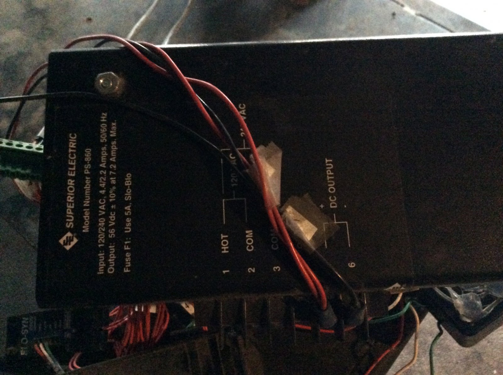

    @Lawwolf7567 - I could be wrong so please double check, but it could be that you might want to just scrap the entire motor drive and controllers and rebuild with more modern and more powerful parts.
    Reason I say is those are steppers and don’t appear to have feedback like Gadget says. Those rely on reliable driving of the platform to not get out of register with where the platform actually is. The system would need to go through a calibration each time it fires up. That’s no big deal as a number of other approaches also use startup calibration.
    The issue I see is just low power and slow response. Those controllers appear to only be rated at between 100 and 300W depending on input voltage (not bad depending on how many motor outputs each box has), but the real oddball is the motor data plate that looks like those are rated at only about 15W (7A x 2.24v). That’s maybe per phase but it’s still pretty low for good motion use I think. They are also geared down with the belt drive. That increases torque but reduces speed and response speed can be important in sims.
    I’d bet those frames in stock configuration just do gentle sweeping motions to simulate flight but that the system lags and only approximates the movements. I’d rather be wrong but I checked those motor ratings and they are indeed 7A x 2.24V (about $150 on ebay too). Steppers aren’t generally meant to pull high currents and don’t have super high torque.
    If what I am seeing is right, I’d gut the motors and drives and look at beefier motors and controllers and then you may need to reinforce the frames where the drives attach to take the higher stresses. But if that system is designed for only gentle movements, it will probably be disappointing for use with modern sims and SimTools. New controllers and motors would also let you skip reworking the Arduino programming to work with that system. You may need to also replace the power supply(ies?) depending on specs. Other approaches are largely canned and setup is much easier.
    But I could be missing something. That’s just what I can see from the ratings on the parts. There may be more to the story. The cool part is you already have frames, shells, and a lot to work with!

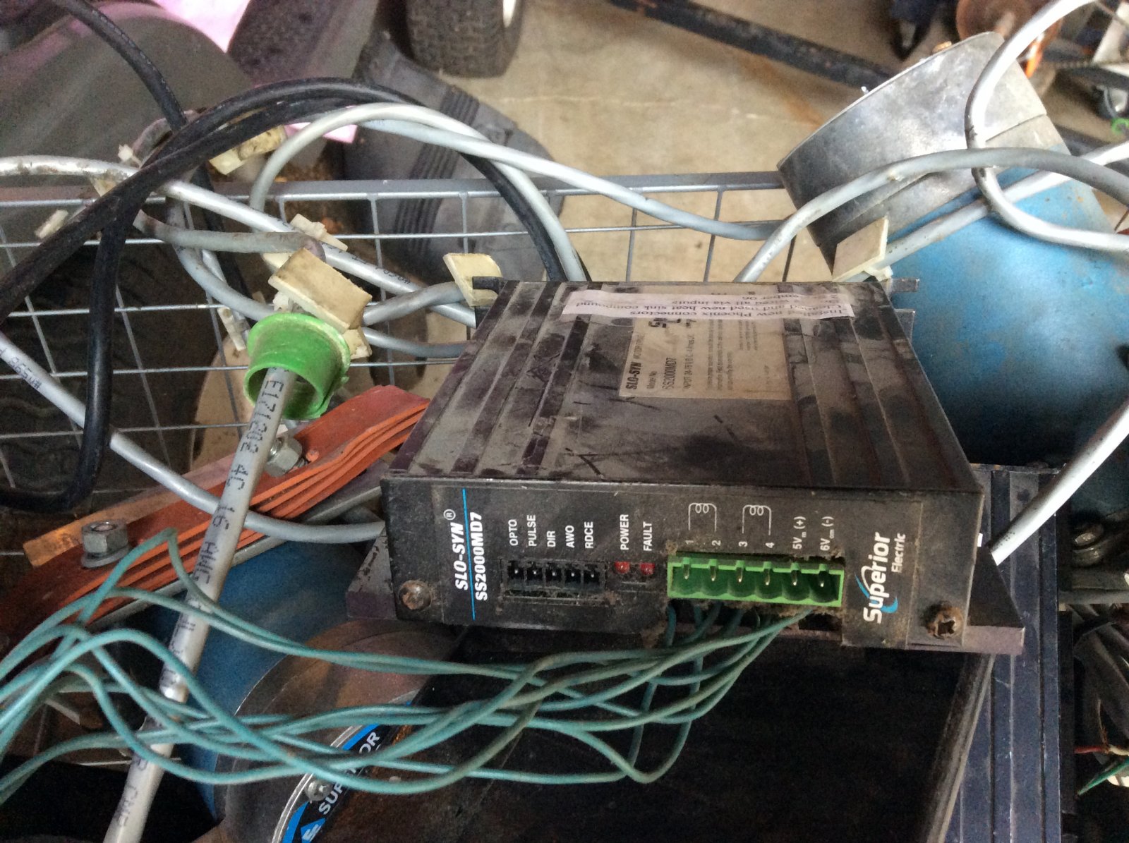

    is your arduino circuit driving the motors them selves or the motor drivers ?

    Thanks, the Arduino is driving the motor controllers.

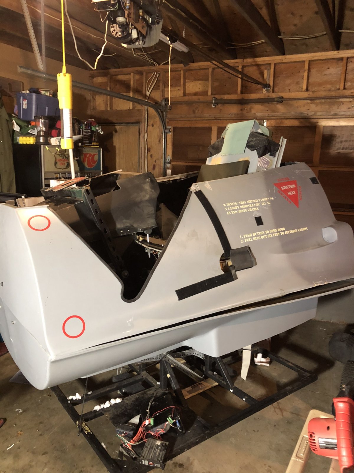

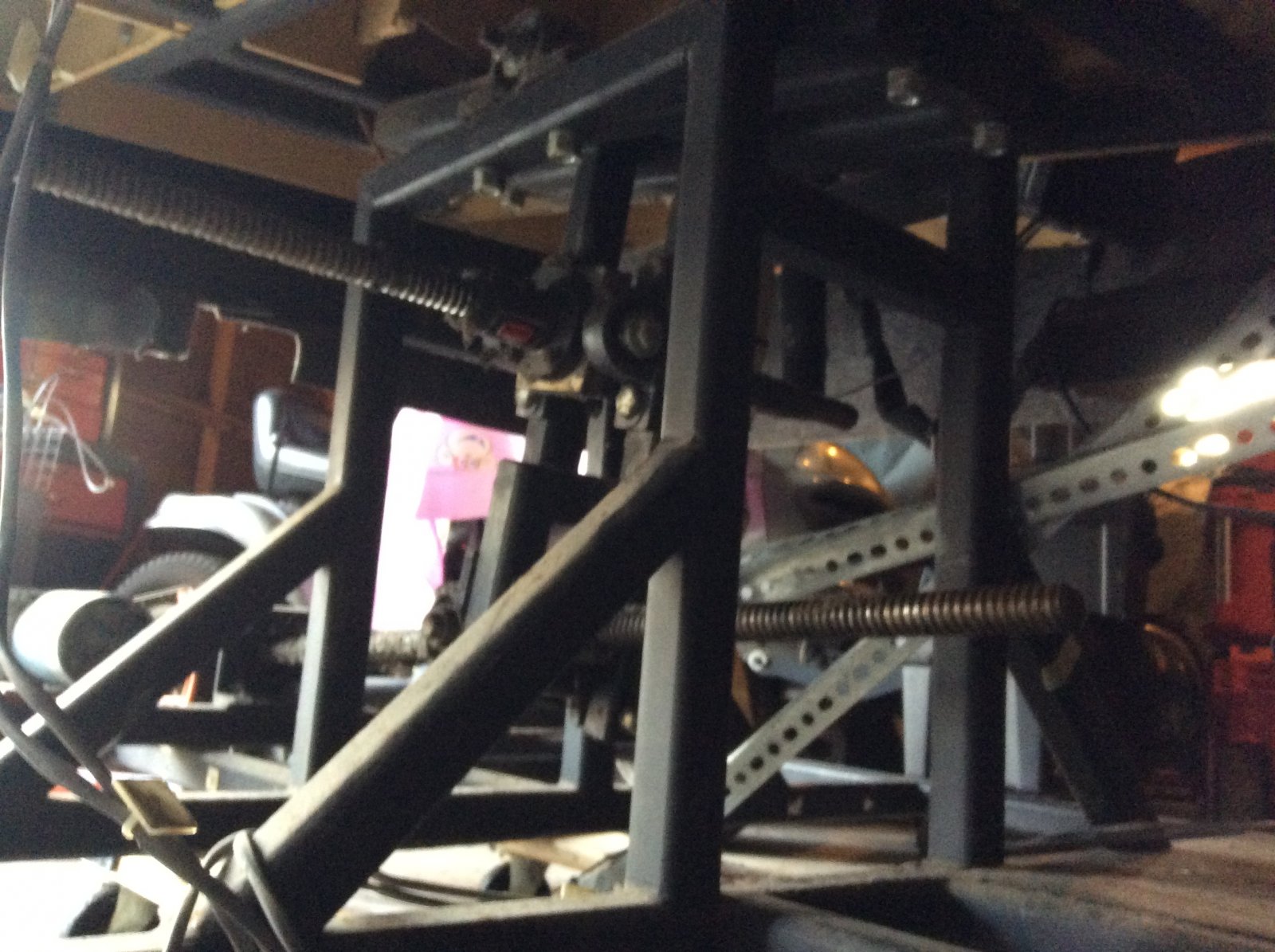

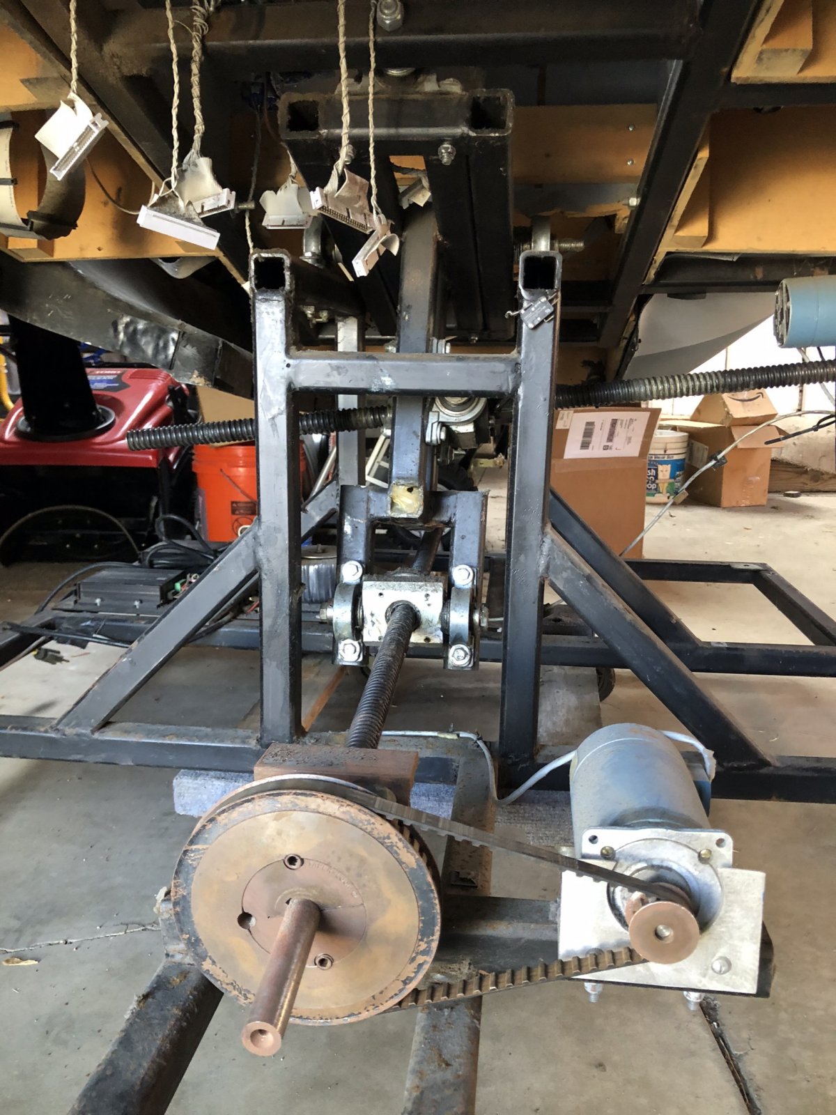

    1A80BA94-2678-4F7E-9F2D-583E8F9410B5.jpeg FE5D0CC0-3C6D-4BF4-A839-C742F78BFD97.jpeg
    As you can see the motors do not actually take much of a load because the weight is on the frame and the motors turn the ball screw/lead screw to tilt it on the fulcrum taking the weight.

    And after the reduction belt drive, they run screw drives so another reduction. I bet stock that runs slow. ;-)
    Are the screw drives part of what holds the rig upright? I can’t see the full bearing setup but is it two sets of pillow blocks at right angles to each other to allow the seat to pivot front to back and side to side? That could still be ok, though.
    It looks like basically a full-frame 2 DOF rig and should be easy to convert over. I can’t really tell you what you need to do but most 2 DOF rigs put a U-joint under the seat and the seat can flop around pivoting about the U-joint. Two servos of some kind then act on the upper frame and are generally mounted in the rear corners of the sim to push and pull on the chair to tilt it.
    That framing doesn’t look too heavy but your total upper frame weight will be a factor in the size motors/electronics you need. So will the geometry/attachment points and the location of the pivot point. Basically, the pivot point is ideally located at the center of gravity. Any offset can impose a static load on the servos and increase the forces required to move the platform. It’s a compromise, though, and any compromises mean bigger motors and more powerful electronics.
    If you read through the various sim builds people have posted here you will see lots of approaches and ideas that can help you on your journey. Just a guess but I bet you will be looking at something bigger and more powerful than the crab pot motors some of us have used and those bigger motors might need Sabertooth drivers. But basically you get to sort what forces and throws you need for your attachment points, then sort what that translates to for motor requirements, and then size power supplies and controllers for those motors.
    But I do think you’re looking at a new drive and control system to get those frames airworthy. Cheers!

    What inputs does your motor controller have ?

    I was thinking about this and you could also just replace those stepper motors depending on how much slop there is in the mechanism. I tend to think in terms of worm or planetary drives and output arms but those long screws are very similar to how linear actuators work. You could use higher performing DC motors and rig feedback to turn them into servos. That’s the more common control method here - servos. You send a desired position and the servo/controller electronics look at the error and move the servo output to minimize that error. Steppers can do the same thing but are a lot more complicated in their internal logic and not as powerful.
    If the slop is little to none with the stock setup, you might just swap motors and add feedback and controllers to turn them into servos. If it does have slop, you may want to look at worm gear output motors with lever arm outputs you can link to the top frame for motion. This would look a lot like other 2 DOF systems here but I do suspect you’ll want slightly bigger motors than many of the rigs here.
    The pivot could be another source of slop. It looks to be made out of two sets of pillow block bearings so the pitch and roll axes aren’t the same. I don’t know if that matters but if there is slop there, you might want to swap for a single sturdy U-joint.
    Also, there is a program available called SimCalc (IIRC) and that can take geometry and motor ratings, etc, to help you get answers to what’s what. (https://www.xsimulator.net/community/marketplace/simcalc.184/)
    Last, keep the CG stuff in mind. If the CG of the top frame (with pilot) isn’t coincident with the pivot point, it can put static loads on your motors and kind of pervert the motions. With standard 2 DOF rigs, the pivot points are under the CG but out of necessity are below the seat. This could be an argument for replacing the pillow block bearings if their axes are lower than they could be. What happens with a low pivot is pitch, for example, becomes pitch plus a translation forward or back. Similarly for roll. It isn’t just a roll but is actually moving you side to side along the arc defined by the pivot point and the distance to the CG, your head, etc. And as your top frame moves away from center where the CG is over the pivot point to where the CG is offset horizontally from the pivot point, then your motors start having to support the mass which increases power demand, heat, etc, and slows moving the top frame back to center.
    Depending on how your seat is mounted, some put their seats on adjustment rails instead of fixed mounting. I set up little ammeters on my motors so can adjust my seat to get that proper balance - minimum current. It also gives flexibility for smaller folks to get closer to pedals or whatever since their mass won’t cause too much trouble if they need to move away from the pivot point.

    As for Zed's comments about your motors being pathetically low wattage, that is a common misunderstanding of stepper motors. The voltage that should be used in your stepper motor power supply is different than the voltage listed on the motors. I read why somewhere on the net a long time ago but I can't remember the details. Something about coil saturation... google if interested.
    Gecko has a good description of what power supply voltage to use with what motor.
    https://www.geckodrive.com/support/step-motor-basics/power-supply-basics.html
