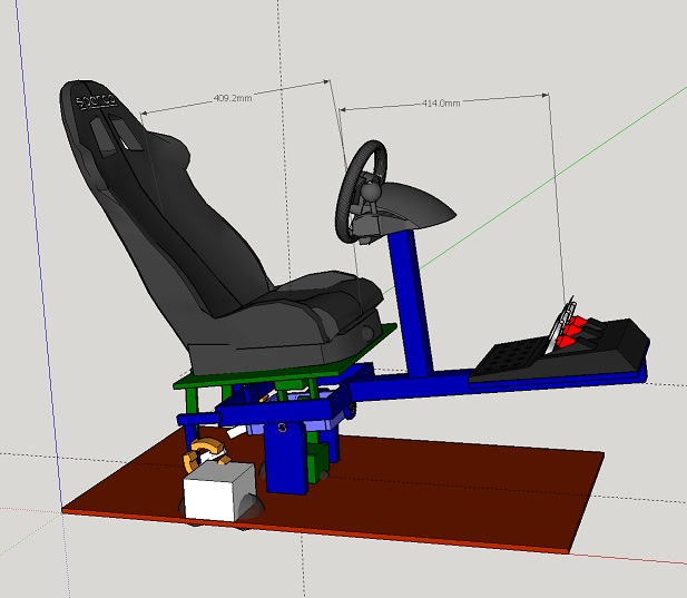

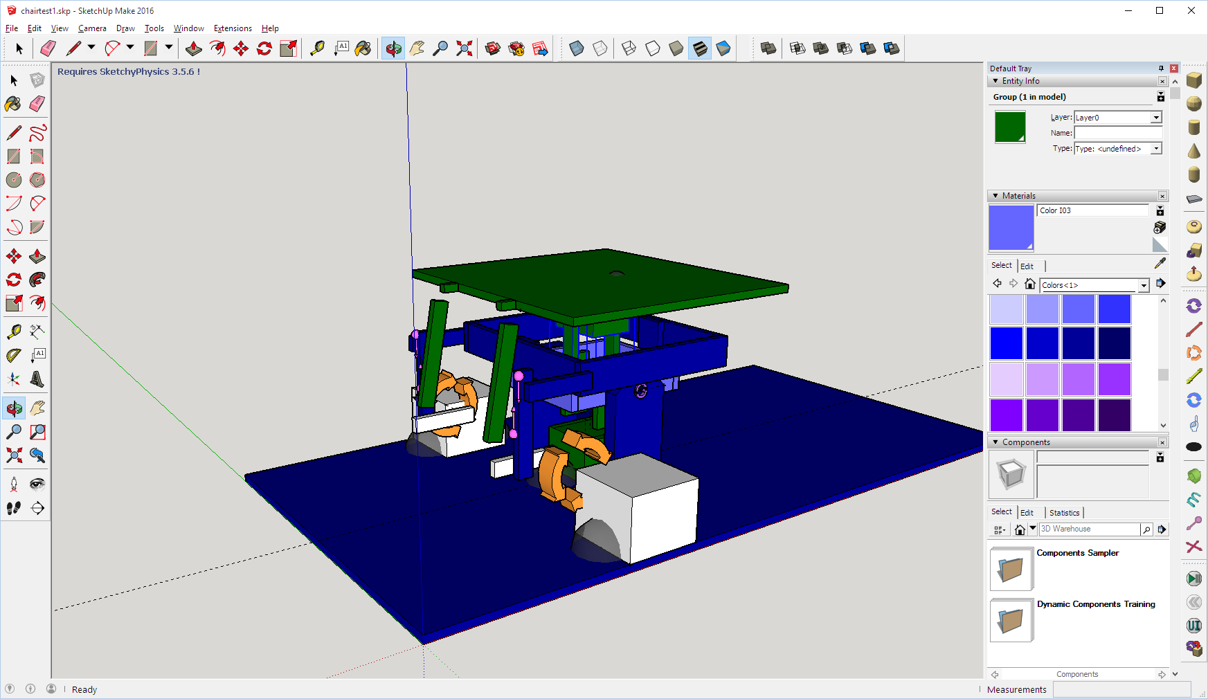

    Ok, went off and learned sketchyphysics and simtools and how to get them both working (which seems ok, though it does also seem to lag a little..), drew up this sketch. Not sure I got the "proper" universal joint (in green) done properly, it seems like it can still twist.. I'm probably not doing that right.
    Basically, the green section is the basis of a "standard" 2DOF seat shaker design.. mounted on a central universal, with connecting rods hooked up to control arms on two motors.
    Where the 'hybrid' bit comes in is the separate subframe for attaching the 'hands and feet' bits, rather than mounting them directly to the seat. There's what amounts to a "ring" universal joint built around the outside of that existing universal (the blue structure), the lighter blue box area in the middle being hinged on opposite sides and connected to base and then the subframe that would hold the pedals and hand controls. The white control arms hanging off the motors have the standard 2DOF connecting rods to the platform which would hold the seat, but then also connected (but closer to the motors, hence with a shorter throw) are a second set which connects the subframe.
    End result is that chair and subframe both move separately, but are tied by the control arms and while they make the same movements, do so at different rates - the subframe moves slightly less (depending on the difference between connection points on the control arms) than the seat.
    I'll also attach the model if anyone wants to check it out - should work on the same basic settings that the sample "Wackelstuhl" model does (though without the 3rd axis)

    Hrm.. ok, it's only subtle, and I still haven't got some of the joints right since there's some rotation in there that shouldn't be, but this should be enough to give you the idea.. I think.

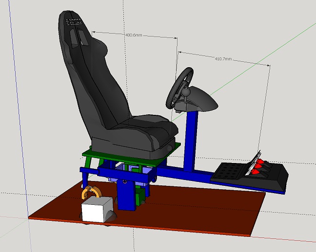

    Did a bit more work on it, fleshing the model out a little. Have also saved it in sketchup 6 format for anyone using older software builds who wants a peek.
    With the seat pitched back, distance from the seat back to wheel, as well as seat base to pedals is extended. This should further emphasize the 'pushed back in the seat' feel as the controls move away from you. Coming forward, the effect is reversed, 'pushing you forward' into the wheel and pedals under brakes or diving..
    [​IMG] [​IMG]
    I haven't really 'dimensioned' anything properly as such, it's all just eyeballing in there, (including rescaling the downloaded seat/wheel/pedals), so don't get too caught up in things not sitting right, it's really just proof-of-concept, there.
    Oh, I should also note that things get a bit screwy at the extremes of movement. Again, I think it's down to that main universal not working right as far as sketchyphysics is concerned.. No matter how I try to mess with that and re-do things, it's not behaving as I figure it should..
