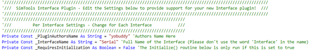

    Step 1) Basic settings for the new Interface Plugin
    _PluginAuthorsName - The name, or names of people that have worked on the plugin.
    If someone sends you a plugin to edit/add-on too, please just add your name with a coma like this “Original Author, Your Name”.
    _InterfaceName – The Name of the Interface (Please don't use the word 'Interface' in the name)
    _RequiresInitialization- Does this plugin require a startup routine, or a restart with new or removed settings? For example: To run a startup routine on the actuator (with an optical encoder usually) in order to find home.

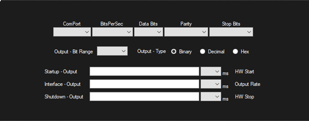

    A) Double Click on “UserControl_Settings.vb” in solution explorer.
    We are now going to build our form for this Interface Plugin. Place the needed controls on the form for your Interface plugin. (The back color of the form should be transparent)
    (Here is a pic of the Example plugins GUI.)

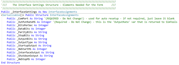

    B) Now let’s setup our structure for this form. (Right Click on “UserControl_Settings.vb” in solution explore and select View Code)
    We need to add ‘1’ variable to the structure for settings we want to save on the form.
    Notice there are ‘15’ controls on the form, but we only need one variable for the 3 radio buttons. So, I’m going to need 13 variables in my structure.
    This is what I did.

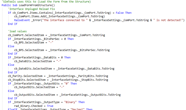

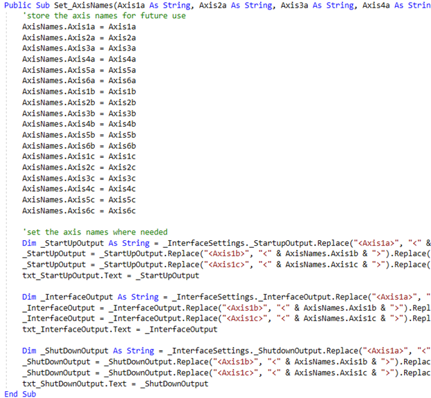

    C) Now let’s teach the form a few tricks! – (Right Click on “UserControl_Settings.vb” in solution explore and select View Code).
    Set_AxisNames
    Let’s teach the plugin how to set the axis names
    LoadFormFromStructure
    Teach the Form how to fill itself from the Structure data.
    (See example plugin for more detail)
    Example
    txt_Name_interface.txt = _InterfaceSettings._Name
    And so on for all controls on the form…

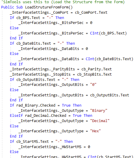

    LoadStrutureFromForm
    Teach the Structure how to read the Form data.
    (Just the opposite from the sub above) (See example plugin for more detail)
    Example
    _InterfaceSettings._Name = txt_Name_interface.txt
    And so on for all variables in the Structure…

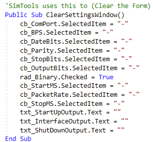

    ClearSettingsWindow
    Teach the Form how to reset itself.
    (Resetting the structure is not needed – just the form)
    Example
    txt_Name_interface.txt = “”

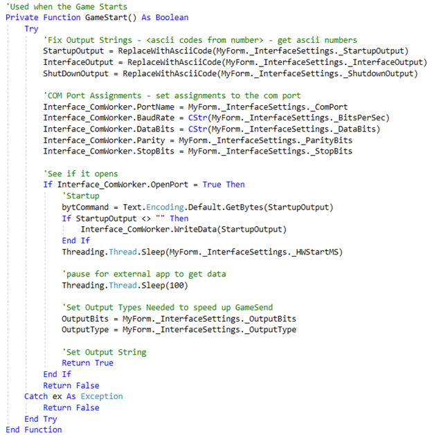

    GameStart - This tells game engine what to do when the game starts up. Here I am making sure that all values are set to default values and setting it into a memory space.
    I also load the user’s settings for the engine to run.

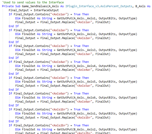

    Game_SendValues -
    Here you get access to the SimTools RAW values. You will receive a number between -1 and 1 (with 0 being the center). This makes scaling the output values to whatever you need very easy! That’s all I’m doing here, re-formatting the RAW output values from Game Engine to the selected output type & bit-range. And then I send the values to the memory mapped file.
    Game Engine automatically throttles the output rate the mandatory _OutputRateMs in the structure you built earlier. We have these values tied to a control on the form. If you didn’t want this to be user editable, you could set the value of the output rate with GameStart() above. (Like this “MyForm._InterfaceSettings._OutPutRateMS = 10”)

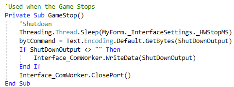

    GameStop -
    Here you can teach Game Engine how to shut down your Interface Plugin. In this example I am essentially sending a centering command to the interface, waiting to make sure the external device gets the data, and then disposing of the memory mapped file.

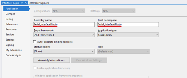

    Double Click on “My Project”
    With the “application” tab is selected, name the Interface DLL as follows: InterfaceName (without spaces) + _ InterfacePlugin.
    So then for this example we get ‘Serial_InterfacePlugin. Use this name for both the ‘Assembly Name’ and the ‘Root Namespace’ as in the picture below.

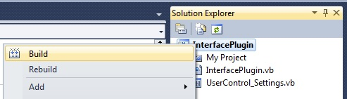

    Right click on InterfacePlugin in the solution explorer and select Build!
    Your new Interface plugin can now be found in the folder;
    ExamplePluginFolder\InterfacePlugin\InterfacePlugin\bin\Release\MyPlugin_InterfacePlugin.dll

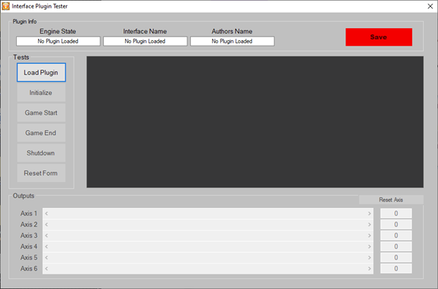

    Use can use the Interface Plugin Tester to verify that your new plugin is working correctly.​
    Interface_PluginTester.zip

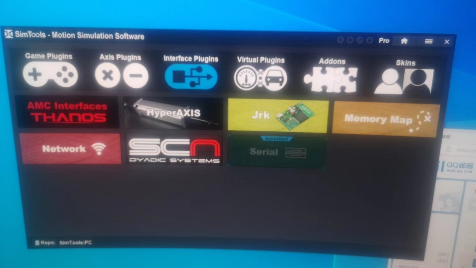

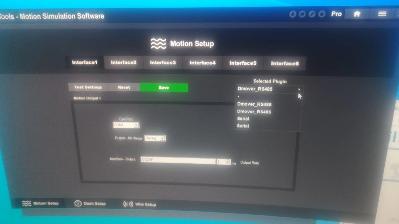

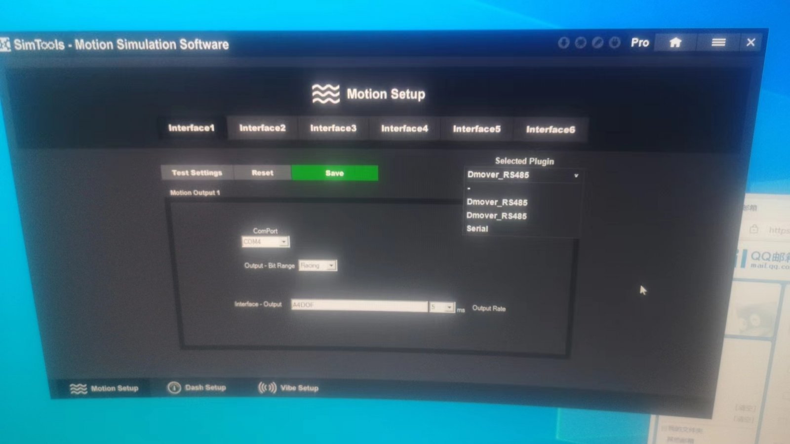

    I'm trying to port my V2 interface plugin to V3, and I'm currently encountering some problems:
    1. Communication should be normal, can start up(all axes move to center point) and shut down (all axes return to origin), but it seems that the motion data is not sent correctly, there is a small vibration of low frequency in all axes. But in the interface setup, there is no response to move the axes.
    2. The plugin is installed offline and cannot be found in the plugin manager, nor deleted on .
    Any ideas? Please help.
  6. yobuddy
    51,760Coins
    +5,206 / 19 / -0
    Looks like you have some doubles loaded, let's fix that problem below in question 2.
    Because your Interface plugin did not come from a repo, it will not show up in a repo (plugin manager).
    But you can simply close v3, open "C:\Users\YourUserFolder\AppData\Local\SimTools3\InterfacePlugins" and simply delete your test plugin. Then restart v3.
    You can also update your test interface plugin this way too, simply replace the dll with a newer one for testing. When your finished testing, you can export your new interface plugin, and then delete it from the folder above. And once your new interface plugin is finished and uploaded to a repo, it will be removable from the repo like normal.
