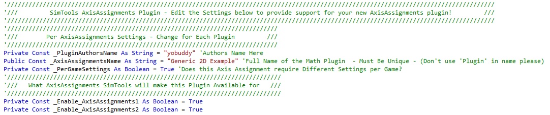

    Step 1) Axis Assignment Settings
    _PluginAuthorsName - The name, or names, of people that have worked on the plugin. If someone sends you a plugin to edit/add-on too, please just add your name with a coma like this “Original Author, Your Name”.
    _AxisAssignmentsName - This is name displayed in Game Engines list of AxisAssignments available.
    _PerGameSettings – Do all games use the same settings? Or separate settings depending on the game selected?
    _Enable_AxisAssignments1 – should this plugin be enabled for Axis Assignments ( a )
    _Enable_AxisAssignments2 – should this plugin be enabled for Axis Assignments ( b )

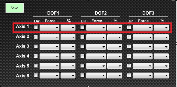

    A) Then double click on “UserControl_Settings.vb” in solution explorer.
    We are now going to build our form for this Axis Assignment plugin.
    Here is a pic of the Example plugins GUI.
    (Should look fairly familiar to most of you)
    Notice this example plugin allows for mixing 3 DOF’s per Axis and has no filters for the easy of explaining how the api works.

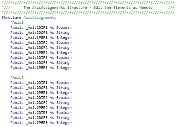

    B) Now let’s setup our Structure for this form.
    We need to add ‘1’ variable to the structure for each control on the form.
    Notice there are ‘9’ controls per Axis (3 per DOF). And we have ‘6’ axes available to the user. This should give us a total of ‘54’ variables to add to the structure.
    This is what I did.
    And so on for all 6 Axis…

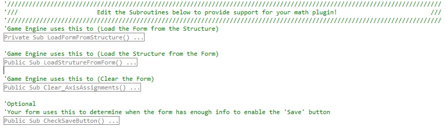

    C) Now let’s teach the form a few tricks!
    LoadFormFromStructure()
    Teach the Form how to fill itself from the Structure data.
    (See example plugin for more detail)
    Example
    btn_Axis1_B1.Checked = _AxisAssignments._Axis1DIR1
    And so on for all controls on the form…
    LoadStrutureFromForm()
    Teach the Structure how to fill itself from the Form data.
    (Just the opposite from the sub above) (See example plugin for more detail)
    Example
    _AxisAssignments._Axis1DIR1 = btn_Axis1_B1.Checked
    And so on for all variables in the Structure…
    Clear_AxisAssignments()
    Teach the Form how to reset itself.
    (Resetting the structure is not needed – just the form)
    Example
    btn_Axis1_B1.Checked = False
    CheckSaveButton()
    This is an optional subroutine. (Not used in this example)

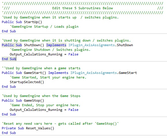

    Step 3) 5 subroutines to control the engine.
    (Double click on “AxisAssignmentsPlugin.vb”)
    StartUp()
    If your plugin needs to do anything as it gets loaded, you can do so here.
    ShutDown()
    If your plugin needs to do anything as it gets unloaded, you can do so here.
    (For this Example plugin, I added Output_Calculations_Running to False just to be sure all threads are stopped)

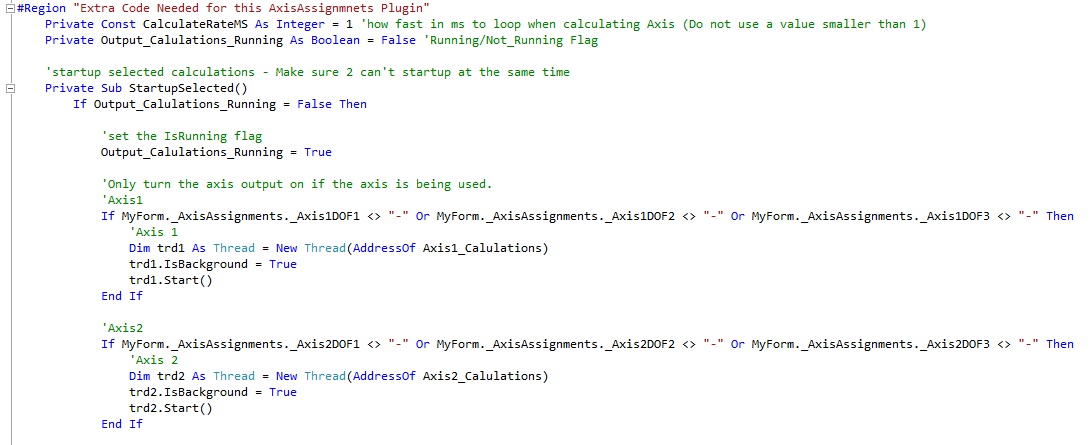

    GameStart()
    Start your engine here when a game starts.
    In my example plugin I use “StartupSelected()” to only start up the math calculations for the axis that the user is actually using. (2 of the 6 axis shown below)
    (See the example Plugin for more detailed info)
    You could just start them all up, but I wanted to show you that you can create a faster engine by only starting what is actually needed.
    Notice that “StartupSelected()” starts the axis calculations in background threads for the needed axis. These threads will continue to loop until Output_Calculations_Running = False.
    GameStop()
    Stop your engine here when a game ends.
    (For this Example plugin, you can end all your threads by setting Output_Calculations_Running to False. Easy!)
    ResetValues()
    You can reset any extra needed variables here.
    (SimTools automatically resets its internal DOF inputs and Axis Output variables)
    (You only need to reset any added variables need for your engine)
    (Btw, this example did not have anything extra to reset.)

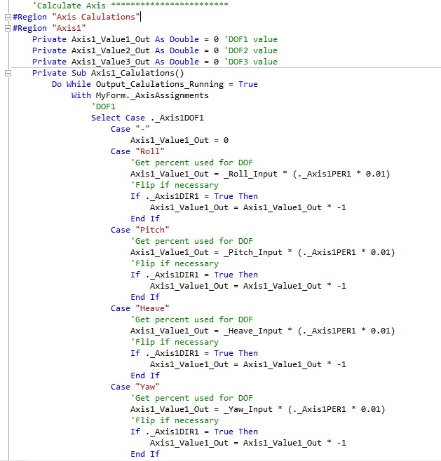

    Let’s take a look at ‘Axis Calculations’ for Axis 1
    (All calculations should be done using the structure; accessing any form controls in the loop will destroy the speed of your plugins engine)
    You will see that all I am doing is simply looping and building the output the user has selected. Remember that each Axis has 3 Force’s that can be used in the mixing of the axis output (for this example plugin). So what we need to do, is figure out the value of each of the 3 Force’s that can be part of the particular Axis output. And then add them together for the final output for that Axis.
    First we look to see what the force is for ._Axis1DOF1.
    Let’s say it’s Roll, we then get the ‘_Roll_Input’ and multiply it by the ‘Percentage’ the user wants to use for DOF1. (Roll at 50% for example)
    We then flip the output if the user has ‘DIR’ checked for DOF1.
    We then do the same for DOF2 and DOF3.
    The final output for this Axis is the combination of DOF1 + DOF2 + DOF3
    (This is all the 6 Axis Calculation Sub’s are doing)

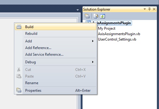

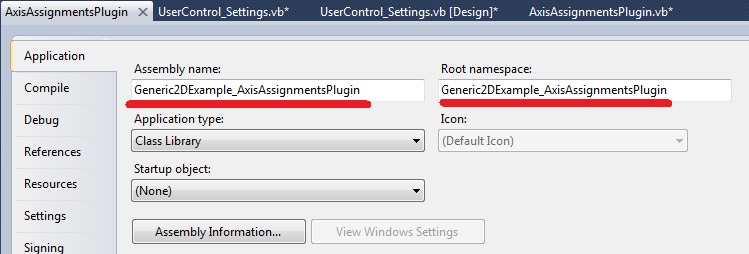

    How to Compile the Plugin
    Click on “My Project”
    Make sure the “application” tab is selected. Now name the AxisAssignments DLL as follows: _AxisAssignmentsName (without spaces) + _AxisAssignmentsPlugin.
    So for this example we get ‘Generic2DExample_AxisAssignmentsPlugin. Use this name for both the ‘Assembly Name’ and the ‘Root Namespace’ as in the picture below
    Right click on AxisAssignmentPlugin in the solution explorer and select Build!
    Your new AxisAssignments plugin can now be found in the folder;
    ExamplePluginFolder\ AxisAssignmentsPlugin\AxisAssignmentsPlugin\bin\Release\MyPlugin_AxisAssignmentsPlugin.dll

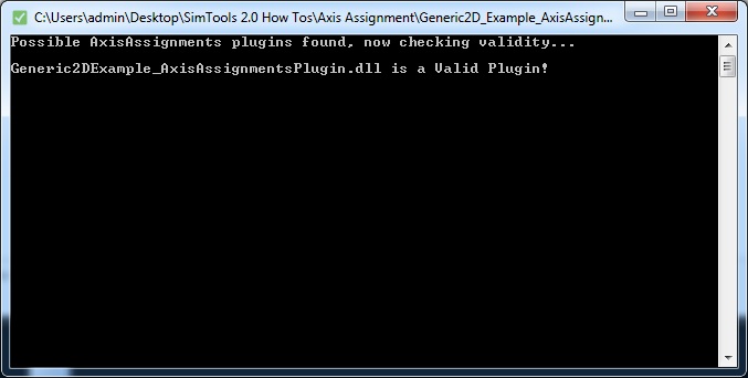

    Run ‘PluginValidator.exe’ in the same folder to validate your new plugin.
    Congratulations!!
    Your new AxisAssignment Plugin is complete!
