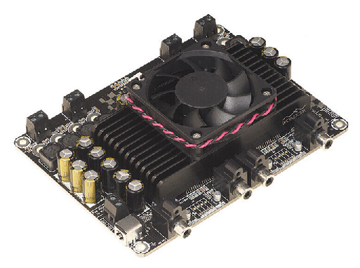

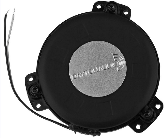

  8. yobuddy
    51,397Coins
    +5,202 / 19 / -0
    Yep
    Pretty much any sound card that can do a 4 channel quadraphonic setup. (for best results)
    (I use a 5.1 card and turn the center and sub channel off.)
    We can do cheep 3d setups like this.
    Ebay 4 channel amp. $55 (last i checked)
    4 x Transducer pucks ~$19 (last i checked)
    Then mount 2 under (or by) the peddles. and 2 behind (or under) the seat.
    Anyway, chat soon!

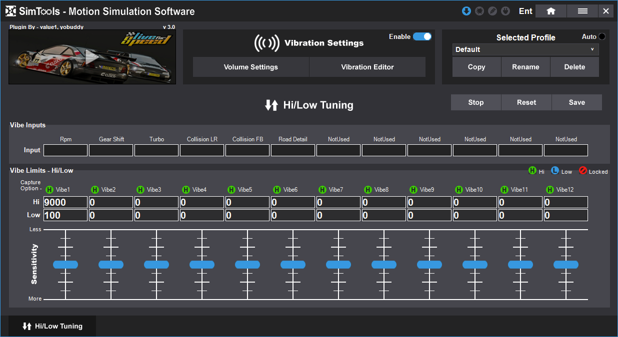

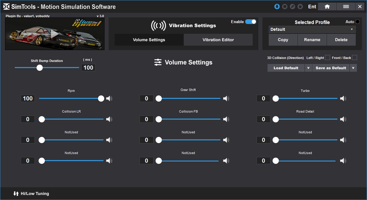

  11. yobuddy
    51,397Coins
    +5,202 / 19 / -0
    Did you set any Hi/Low values for anything?
    See here I set up rpm to run between 100 and 9000 rpm
    Then I need to make sure it has volume.
    Let me know how it goes.
  12. yobuddy
    51,397Coins
    +5,202 / 19 / -0

  14. yobuddy
    51,397Coins
    +5,202 / 19 / -0
    Click Capture, set values and click Save, and then click Stop.
    Take care,
  15. Adi800
    Adi800 New Member
    Jan 12, 2023
    16
    92Coins
    Yeeees,thank You,that was ist.thxxxxxx
