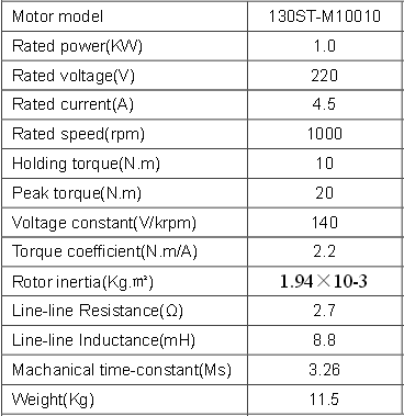

    I'm thinking about these motors people use for direct drive sim wheels:
    Motor / PowerPrice / Peak Torque / Holding Torque / Encoder Resolution / Motor Weight / Motor Inertia / Torque Coefficient (datasheet) / rated speed
    Mige 130ST-M10010 / 1.0 kW / US$ 237 / 20 Nm / 10 Nm / 10000 / 11.5 kg / 19.4 kg cm^2 / 2.2 Nm/A / 1000 rpm
    Mige 130ST-M15015 / 2.3kW / US$ 332 / 30 Nm / 15 Nm / 10000 / 14.4 kg / 27.7 kg cm^2 / 1.58 Nm/A / 1500 rpm

    Have you considered how you are going to control the motor?
    Those motors are PMAC motors which are basically 3phase induction motor but the rotor coils are replaced with permanent magnets.
    You cannot control those motors with the low powered H-bridges or controllers that are being used by the usual motion platforms as your motor runs on 120VAC.
    Three full H-bridges rated >120V @ 3A and a controller that will commulate( power the 3phases in correct order) will be minimium needed for the 1Kw motor.
    You could go down the industrial route and purchase a ready made one eg. granite devices, toshiba etc but that will cost you 2-10x what you are paying for the motors.

    PMAC motors like the ones you list are some of the most effiecient and smoothest(very little cogging) motors available and provide a powerful motor in a compact package which is why they are prerfered motors for direct drive FFB steering wheels. Most automation robots today are using PMAC because of the ease of precision positioning, speed and power.
    One of the best advantages would be the precision positioning given by the 2500cpr incremental encoder compared to the pot used by most motion sims. It would be like comparing 10 bit to 16bits resolution or feeling a small bump on the road compared to nothing at all due to low resolution.
    Direct or belt drive would also be possible due to the power of the motors which would eliminate the backlash of the gearbox during direction changes (worm drive gearboxes are the worst for backlash)
    I cannot see any real drawbacks of using PMAC besides the costs of industrial controller, in which if you use with simtools you will only be using a fraction of the functionality of the controller. You would also need to work out how to get the output of simtools to communicate with the controller which wouldn't be too different to SCNs.
    Maybe that you could make your own simple controller which would involve 3 H-bridges, an incremental decoder and a few microcontrollers or using a hybrid motor controller IC and H-bridges.
    AFIK the difference between a PMAC and a BLDC is in the way the controller powers the coils. BLDC feeds the motor pure DC voltage while the PMAC uses PWM to simulate a sine wave hence the smoother motion and better positional accuracy.

    the ioni is only a 48v drive so the small mige wont spin at its rated 1000rpm it will top out around 350rpm so any gearing to increase torque will reduce that speed advantage it gives over a dc motor. Maybe look at the big mige with an ioni pro hc that from memory is good for nearly 30nm without gearing and doesn't cost much more and may retain that speed advantage.
    Or maybe look at the argon drive its not much more and has a higher output voltage allowing higher speeds and you simplify things by not needing a separate power supply.
