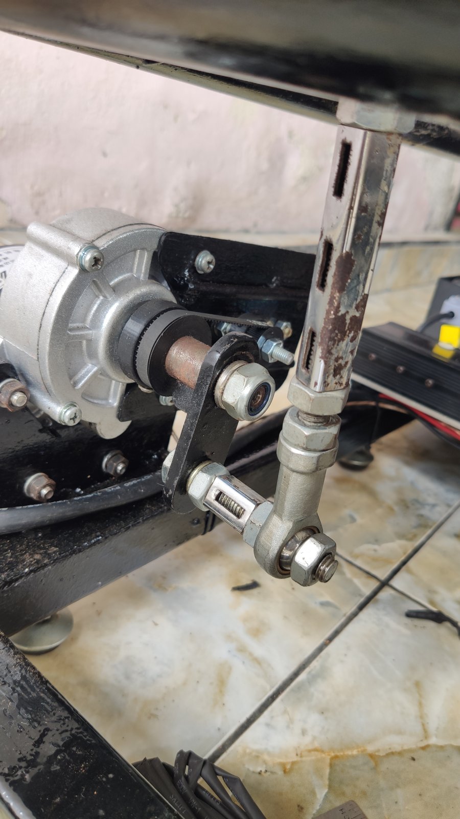

    how to run the motor to the middle when the initial start? so when i disconnect the usb to the arduino the motor will lose power to be in the middle and immediately fall to the bottom. like this picture.[​IMG]

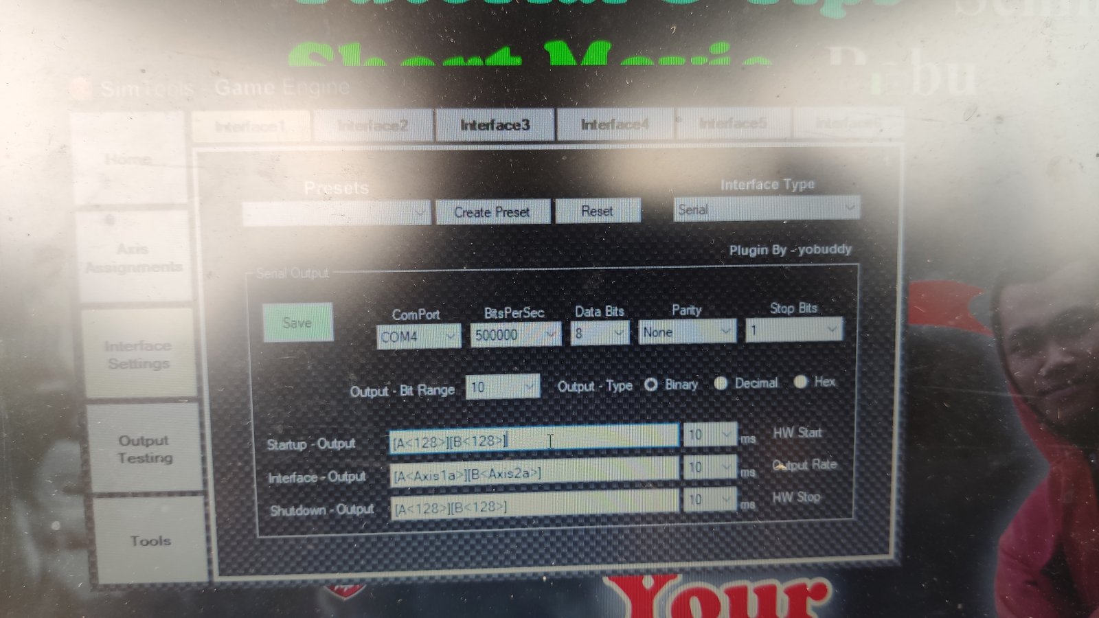

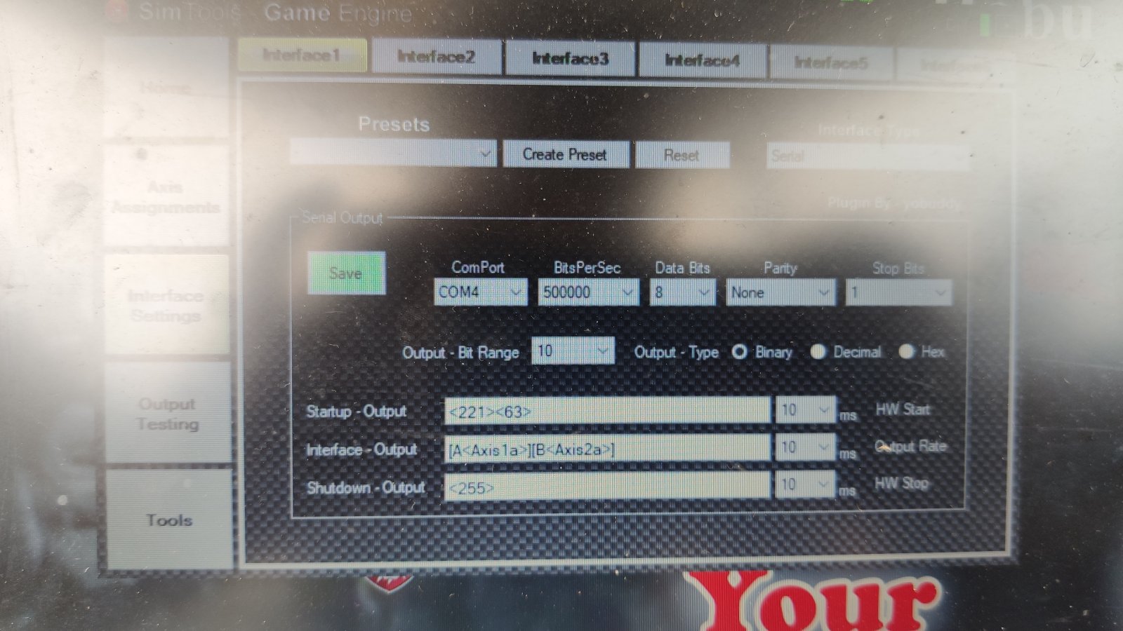

    because at that time, if I opened the smc3 utility, the motor would definitely turn off, and I had to find the middle to turn it on. is there a way when the usb motor connects automatically looking for the middle slowly??? (because my motorbike is not selflock).
    I have tweaked start up and shutdown on smc 3 nothing happens. maybe someone can help??

    No i mean is when i turn off the power supplay and unplug the usb the motow will turn to the bottom canot hold in the midle. Because of that when i turnon psu an plug usb again the motoe is off because out off range ( i checkn on smc3 utility) so how tu turn the motor to the midle when firt time on??

    When an un-powered motor rotates that is called being back driven.
    Perhaps the simplest solution is pivoting blocks to take the load when the rig is un-powered, as used by @Nick Moxley: https://www.xsimulator.net/community/threads/2dof-to-3dof-diy-seat-mover.5271/page-12#post-55552

    This is produced by the relationship between the output shaft and the motor, as @noorbeast says, one of the ways is to mechanically block it, I use ac motors with vdf, in my case it does not happen due to the gear ratio.
