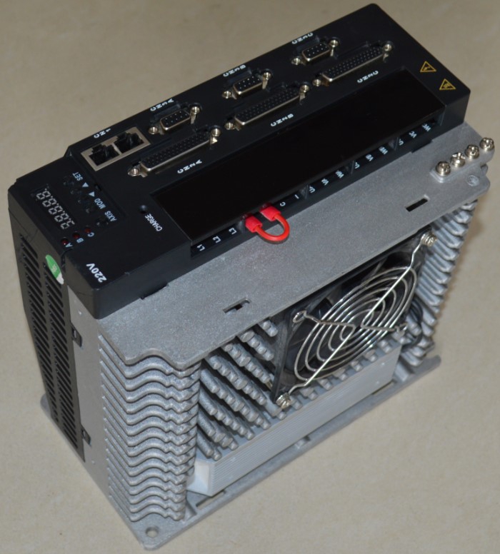

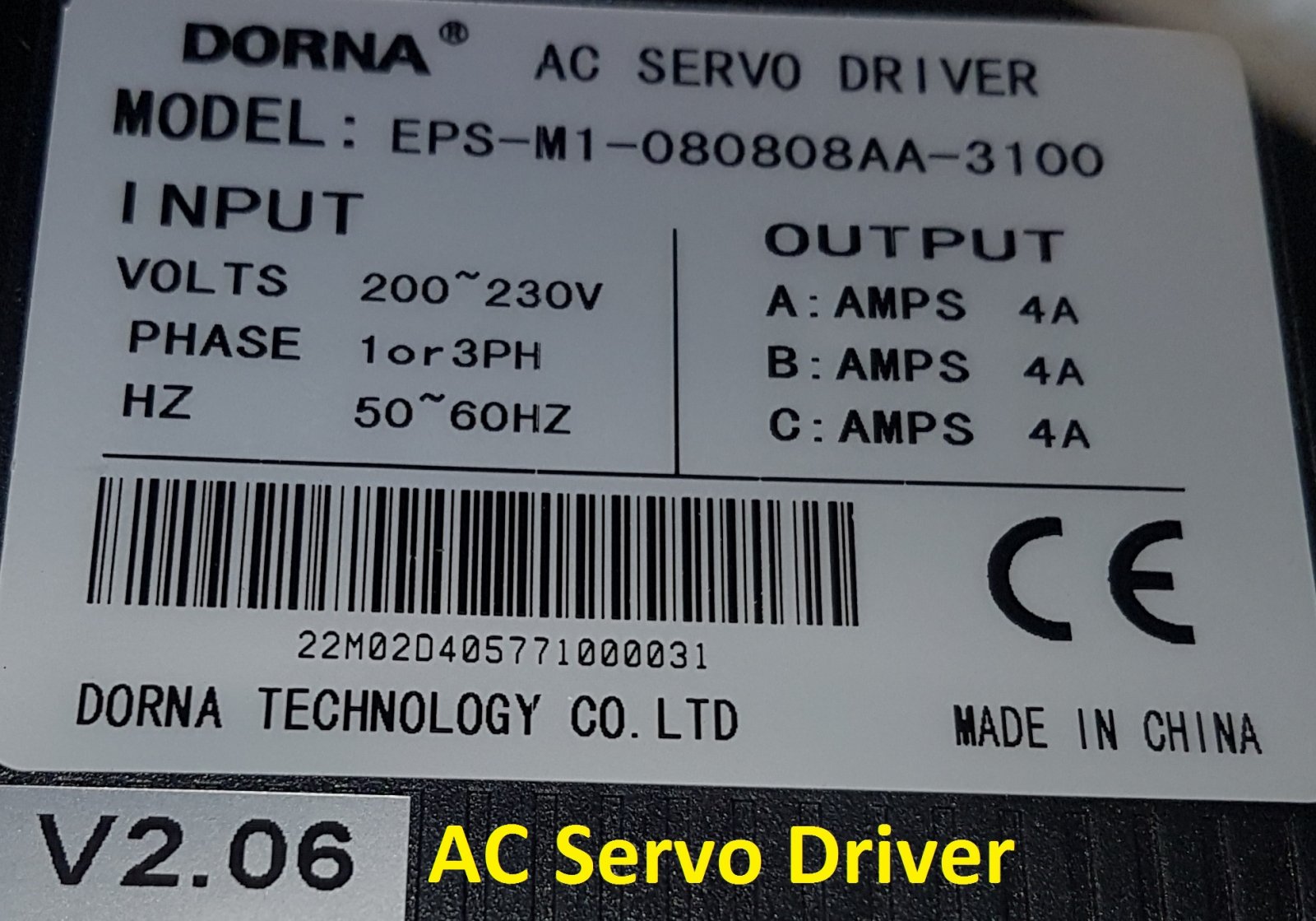

    On the forum I could not find the information how to operate AC Servo-Driver via SimTools ?
    I have three-axis servo driver DORNA EPS - M1 :
    https://www.yoycart.com/Product/537908559744
    This servo driver is controlled by RS485
    Connecting RS485 to computer possible by "USB to RS485" adapter:
    https://www.ebay.co.uk/bhp/usb-to-rs485-converter
    - but the question is how to operate AC Servo-Driver via SimTools ?

    You need a motion controller for these servo drives. A few months ago I made one exactly for these Dorna M1 (3-in-1) servo drives:
    (power-on calibration)
    (running on Ian's BFF motion software motion software, soon on simtools as well)

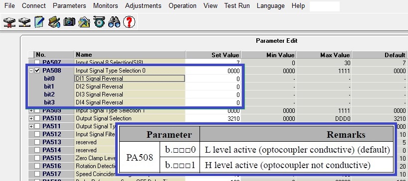

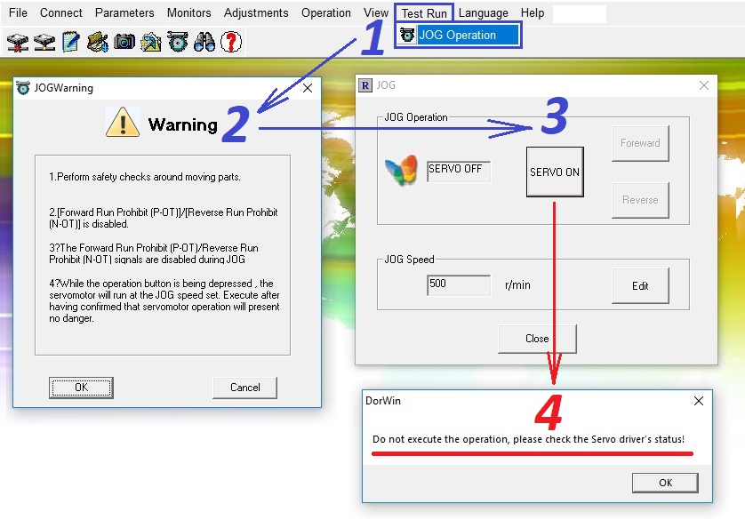

    Do you have a manual for Dorna EPS - M1 (3-in-1) ?
    - please can you tell me what is the problem here?
  9. Thanos
    Jul 6, 2017
    1,346
    Electronics Engineer
    United States
    2,693Coins
    +1,043 / 9 / -0
    I don't have the english version of the Dorna EPS-M1 manual, however I sent you the manual for the EPS-B1 which is the same. The Dorna EPS-M1 contains three EPS-B1 drives...
    I'm not sure what is the problem. Perhaps its trying to detect limit switches when you don't have any attached. Try disabling the limit switches safeguard, but be ready to stop the motor before it reaches the end positions of the actuator... The JOG function keeps running the motor to either direction non stop!
    Thanos

    Probably for safety of the actuator this parameter was blocked (!)
    - changing this parameters removes the motor lock:
    Thank you soooo much :cheers

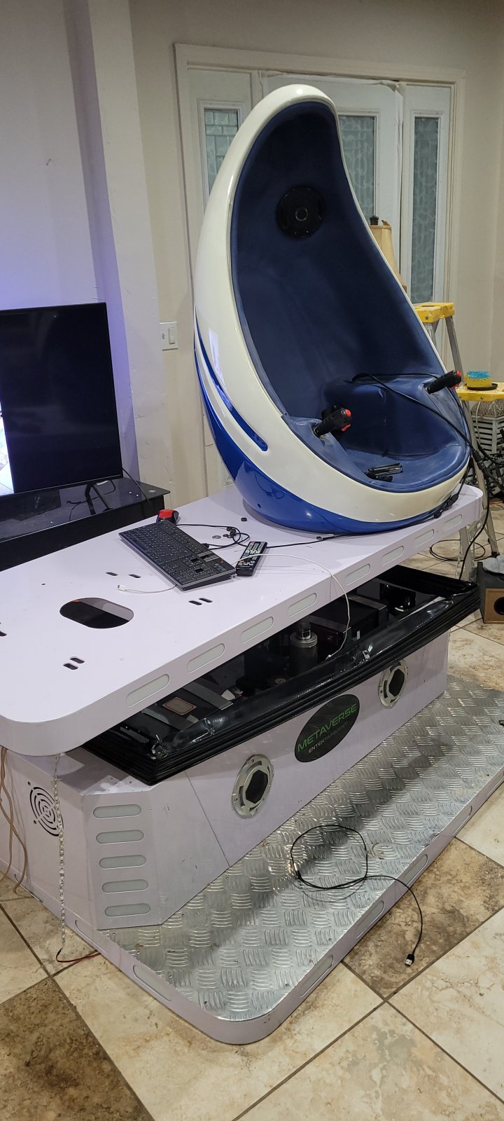

  14. Gadget999
    1,886
    11,543Coins
    +453 / 9 / -0
    what simulator is this ? where did you get it from ?
  15. Thanos
    Jul 6, 2017
    1,346
    United States
    2,693Coins
    +1,043 / 9 / -0
    https://mantgames.en.made-in-china....otion-Platform-3-Dof-Platform-for-F1-Car.html
    Its not mine, a customer has it in Australia, I just made for him a custom AMC1280USB to bypass the Vegafu motion controller on it so he will be able to play other racing games and flight sim, as before was locked for use only with pCars...

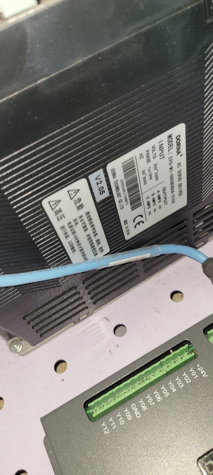

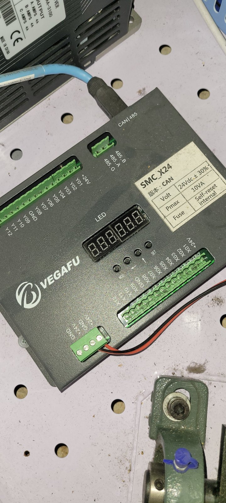

    I CANT SOLVE THIS PROPLEM ERORR 10 ON DRIVE ANDER ON SMC
  17. Jerry Atrick
    May 3, 2017
    141
    Sydney Australia
    1,414Coins
    +44 / 1 / -0
    4DOF
    Hi Mohamed, sorry I can't help, but I hope you get some response to help fix this; as it would be a shame to finish here!
    Jerry
