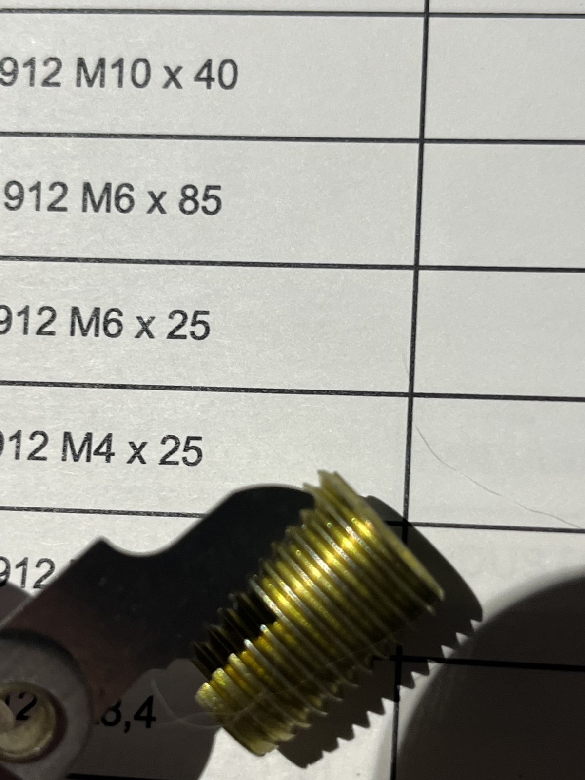

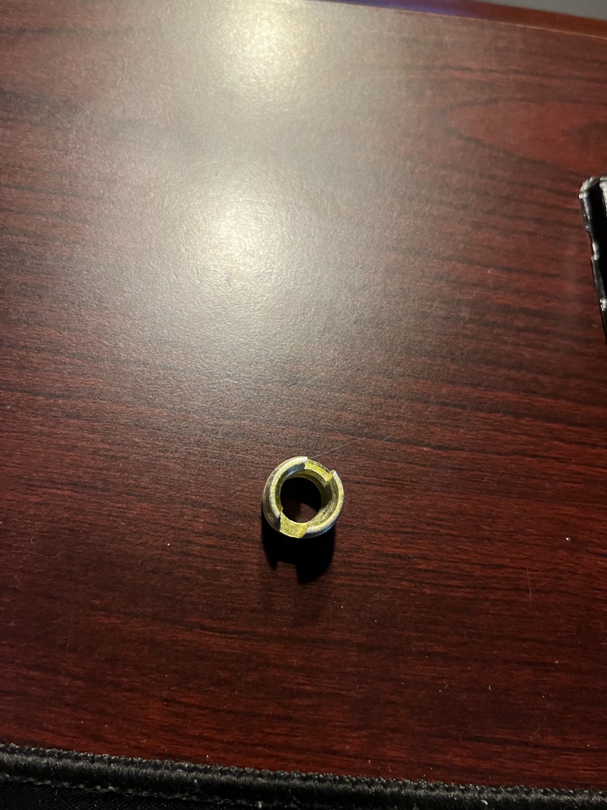

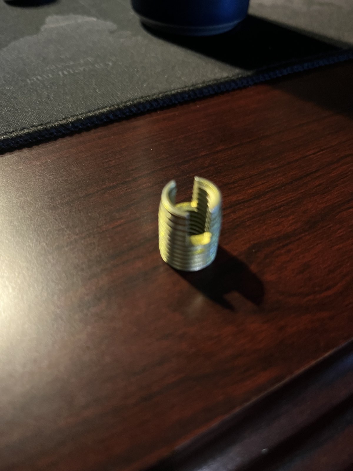

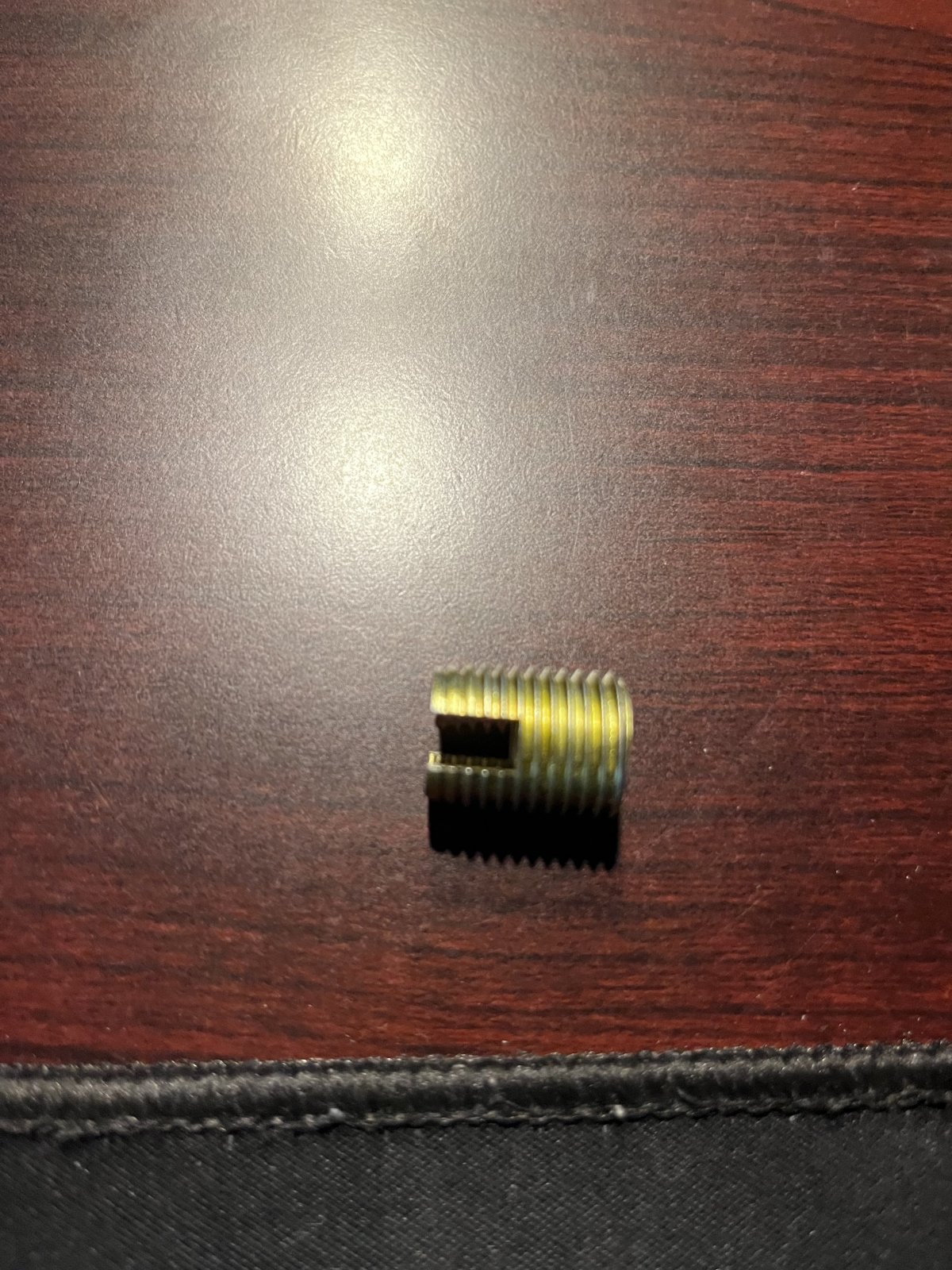

    I seem to have received different thread inserts for my SFX-100 extrusion pieces. From the info on the internet, these are ones I have not seen from other builds and appear to be a pita to install. They appear to be oversized from the extrusion bore holes and do not align at all, nor can you install them based on the extrusion hole diameter or with an allen. Should I drill the holes oversized and if so, what drill bit size is adequate? From my measurements, they're m12x1.5 exterior and m10x1.5 interior. Lastly, based on how the thread insert is sitting in the picture (top with slit) I assume is the correct insert method of installing? Where the slit is, they're tapered smaller vs. the bottom.

    you need to tap a thread into the material and screw it in

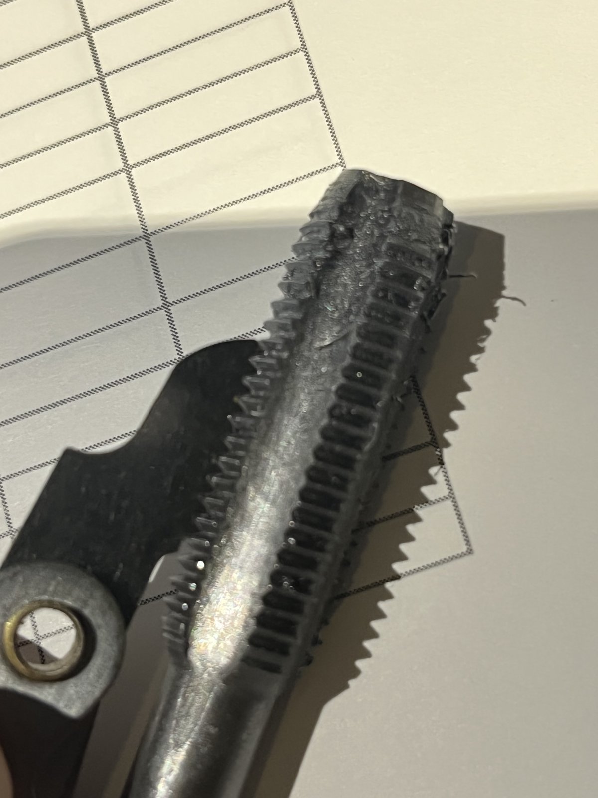

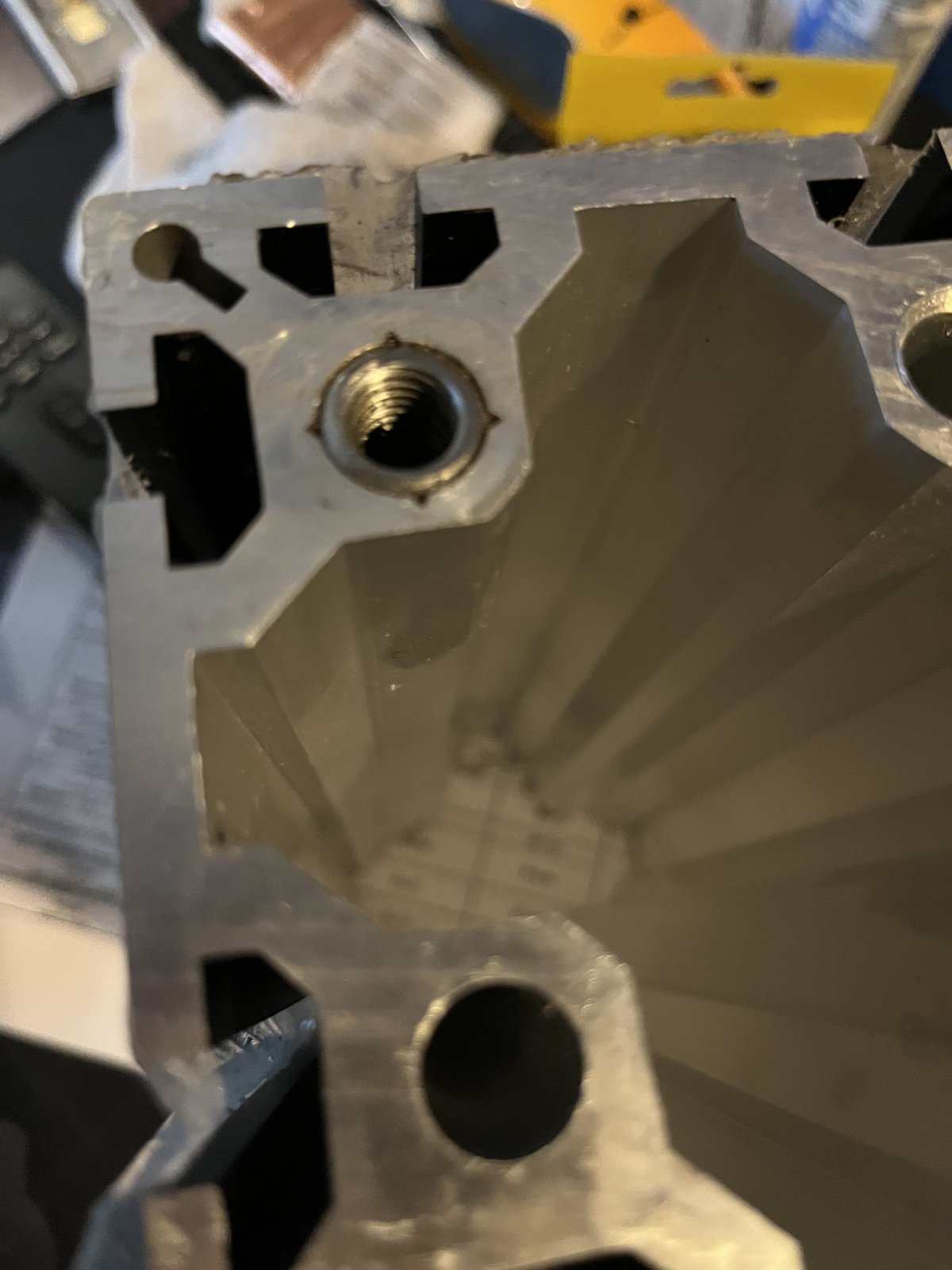

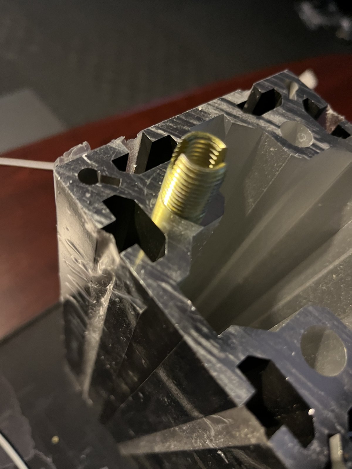

    I used a 12x1.5 tap and chamfered/counter sunk the hole a bit but to hardly much success. I even took a sharp file to all 4 sides and filed in tiny starter marks (not sure how else to do that).
    I was able to get one inserted, but it just didnt seem right and took hours. These thread inserts are not wanting to bite at all and incredibly difficult to start. The one thread insert I got in, I ended up flipping the insert around.
    It seems like I almost need to drill the holes out larger with either a 27/64 or 13/32" drill bit.

    The hole needs to be drilled to a correct size before you can tap it
    What size is the thread size of the bolt that goes in ?

    From the kit AMY sent me are as followed:
    M10x40 bolts - 32 units
    Invoice sheet just says "Thread Inserts"

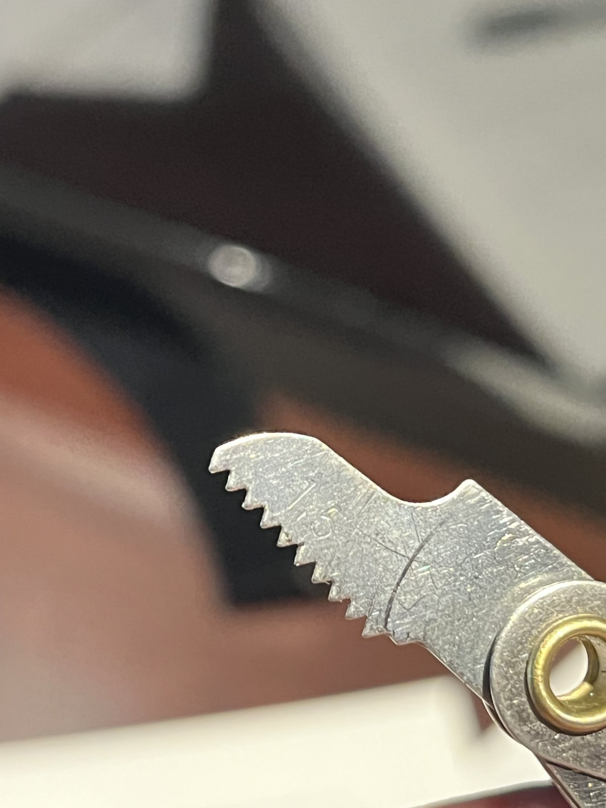

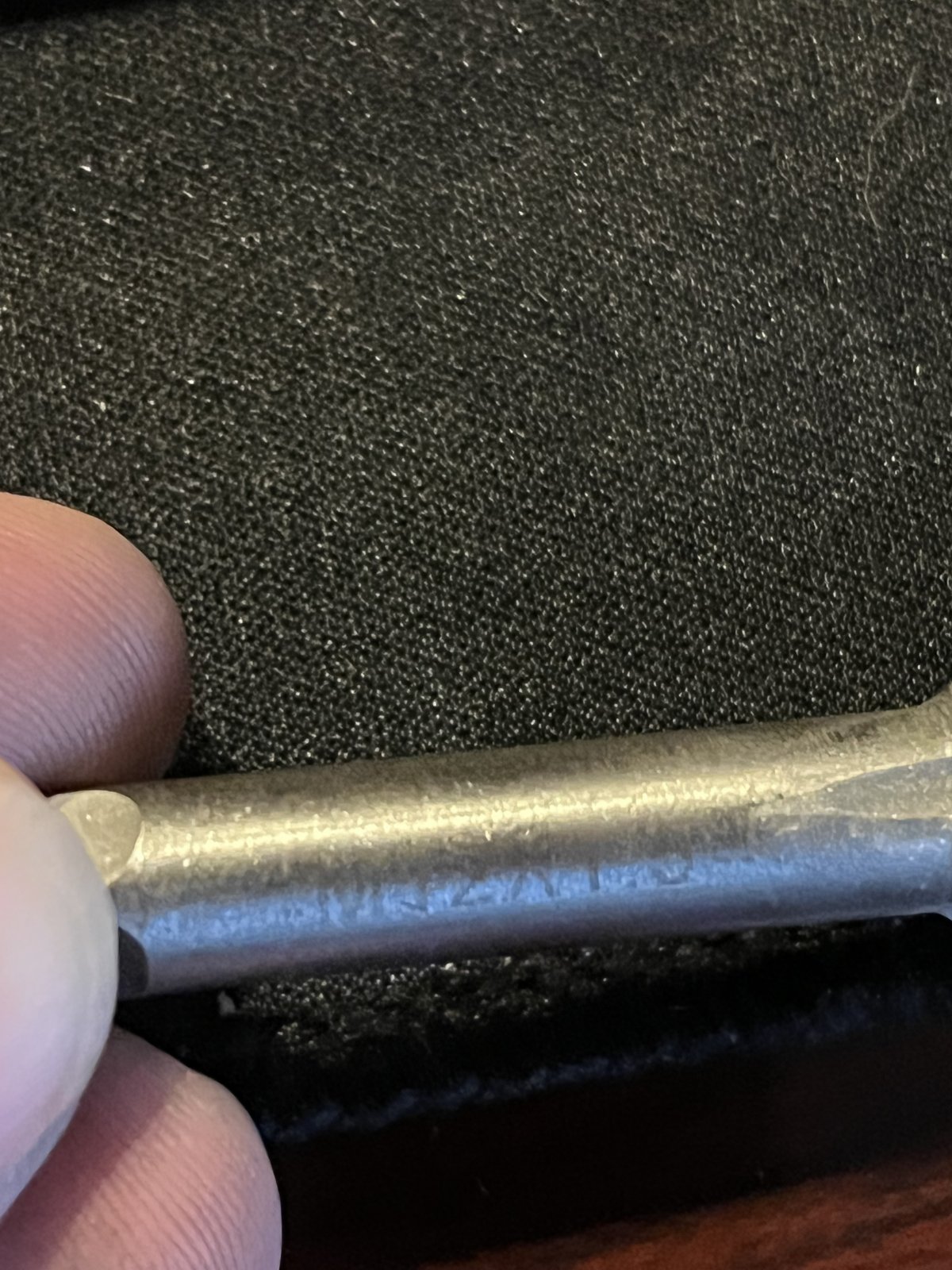

    I am pretty certain the thread inserts are M10 interior and M12x1.5 exterior which is the tap I used. However, after I used a tap, the thread inserts still will not thread in, which is why I counter sunk the holes a bit, but hardly any success with doing so. It is why I suspect I actually just need to oversize the holes without the need to tap them at all, since they are self tapping inserts.

    I came across similar info as well on the net, the charts all have M12x1.25 or M12x1.75, but skip M12x1.5 which is what I have measured. I've triple checked them and the threads are definitely M12x1.5 as is the tap I used. :confused:
