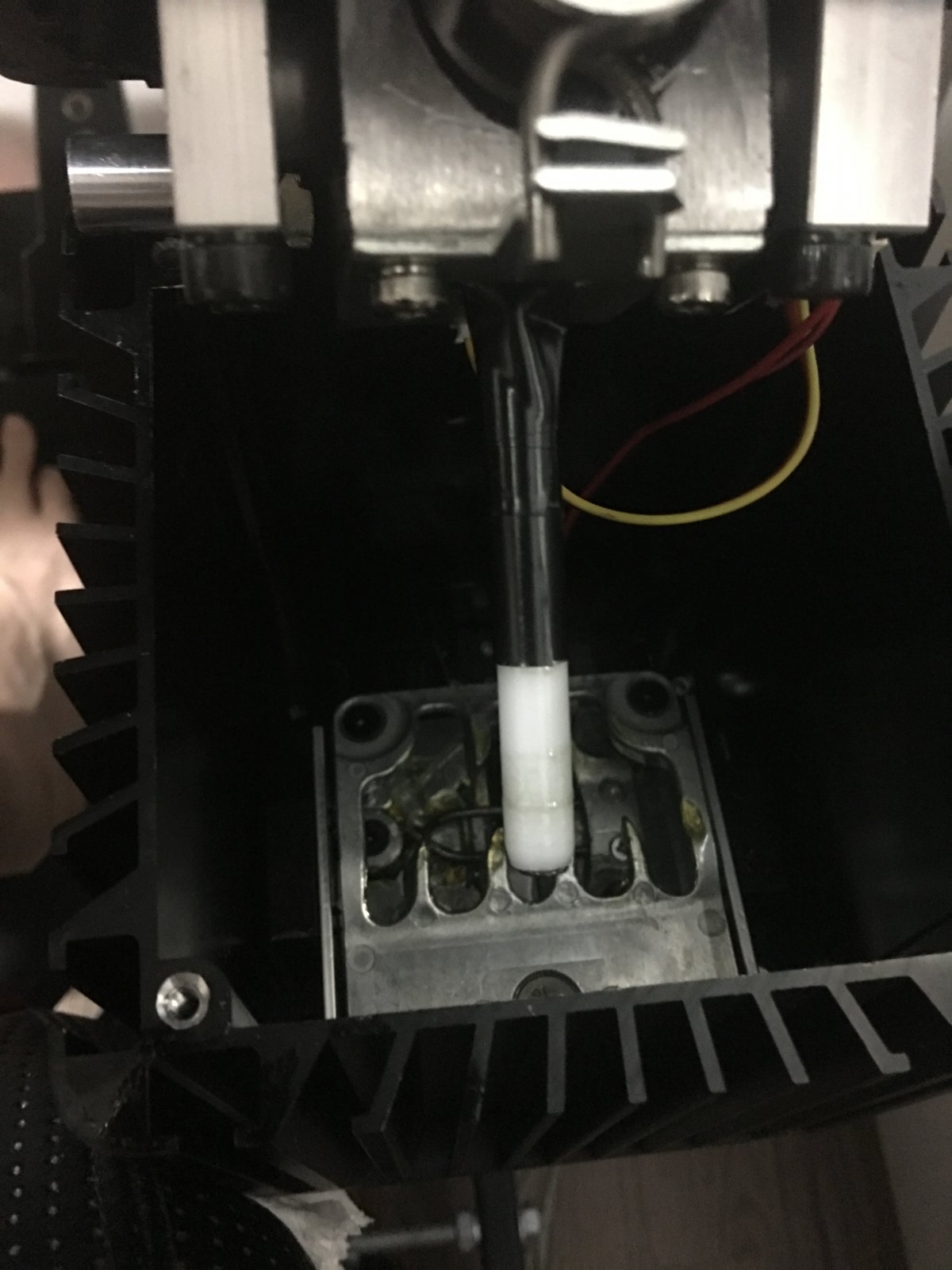

    There maybe guys who are suffering with H shifter positional recognition problem. Especially guys who use motion rig.
    Because we always face to
    static problem. Actually there is no antistatic matter on fanatec css sq 1.5 shifter
    even though it has full metal body while csp v3 itself does
    HAVE.
    So it frequently mis-recognize position of h shifter like below.
    1 -> r
    4 -> 2
    6 -> 4 ....
    It really makes me crazy.
    Anyway i found that how to
    fix it, and i want to share it with you.
    It is very simple.
    Just open up your css shifter.
    And use friction tape like below.
