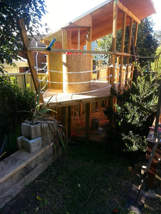

    The idea about building a simulator was sparked by my wife deciding it was time I built my kids a cubby house. The oldest kid was into boats and so he wanted a boat cubby house. The attached picture (apologies, I know it's not a cubby house forum) is what I built over the next few weekends.
    Anyway, after it was finished the kids were delighted for a few hours. Then he announced that he doesn't like boats anymore and is now really into aeroplanes. "Can you turn it into an plane for me". So, yes, I beat him.
