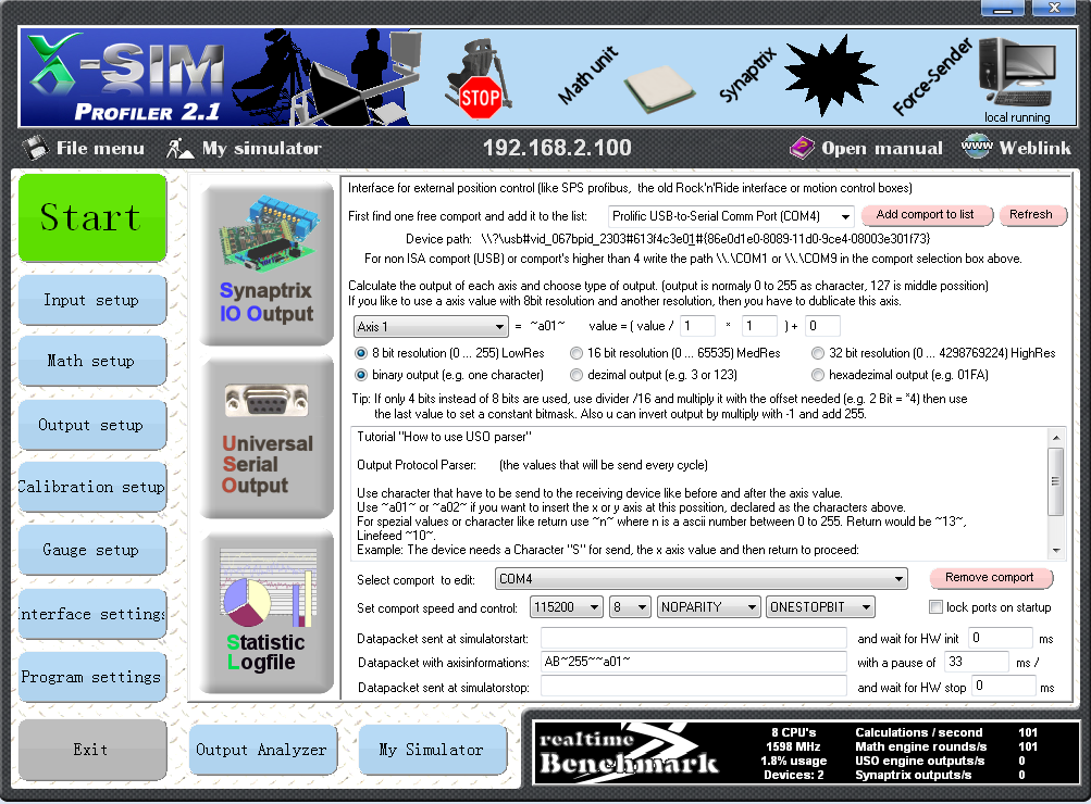

    I am a new user of X-Sim. I'd like to DIY a motion simulator with X-Sim and SCN5 cylinder.
    My SCN5 cylinder connects to PC via USB with RS-485 To USB converter.
    Now, when I click Try send data at X-Sim force-sender, X-Sim profiler will run Start, too. But when I click Disconnect at force-sender, there will appear a dialog box Error opening comport COM4 at profiler.
    How to deal with this problem?
    Thanks.

    Can I get a picture of your interface settings in profiler.
  3. jia
    jia New Member
    Jan 30, 2012
    10
    0Coins
    hi, yobuddy
    Here is the screenshot of my interface settings.
    Thanks.
  4. yobuddy
    5,383
    50,373Coins
    +5,153 / 18 / -0
    nothing there, how about a shot of the scn5 settings page one for each axis

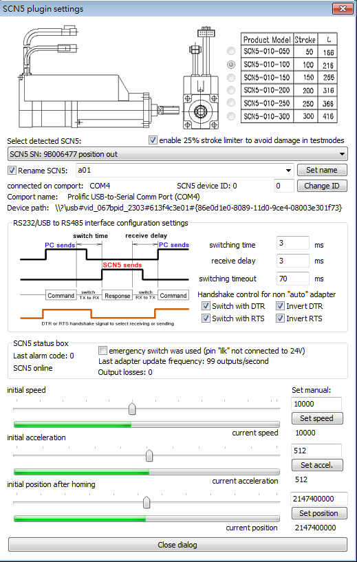

    Here is the screenshot of my SCN5 settings. Now I just have one SCN5 connected to PC.
    Thanks.

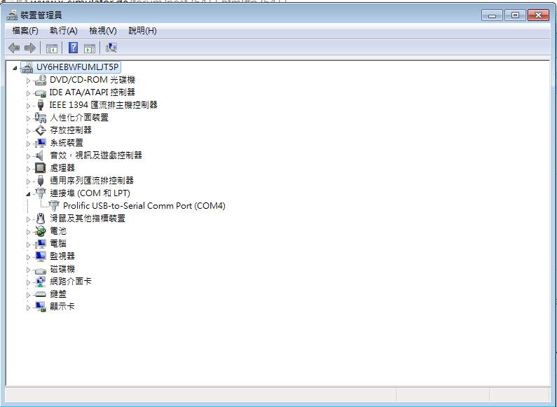

    Can i have one last picture of your Ports (Com & LPT)” in Device manager?

    And here is the screenshot of my device manager.
    Thanks.

    Did you set your adapter setting like this?
    Only other thing I think it could be is the adapter is not based on a FTDI chip.

    I would bet the problem lies in the prolific driver, but its just a guess! :?

    I used the comport for SCN5 plugin and in the USO dialog.
    Here are the screenshots of the two pages.
    [img600px]http://www.mojoimage.com/free-image-hosting-09/507__scn5.png[/img600px]
    If I disable SCN5 plugin and disable the actuator, that error message box will not appear.
    Thanks.

    Please click Remove Comport - it's in the second picture you posted, near the bottom right.
    That should clear the Select comport to edit in USO, you don't need that I believe.
    Then give the program a try, I bet it works.

    Yes!! The problem is solved.
    Thank you.
