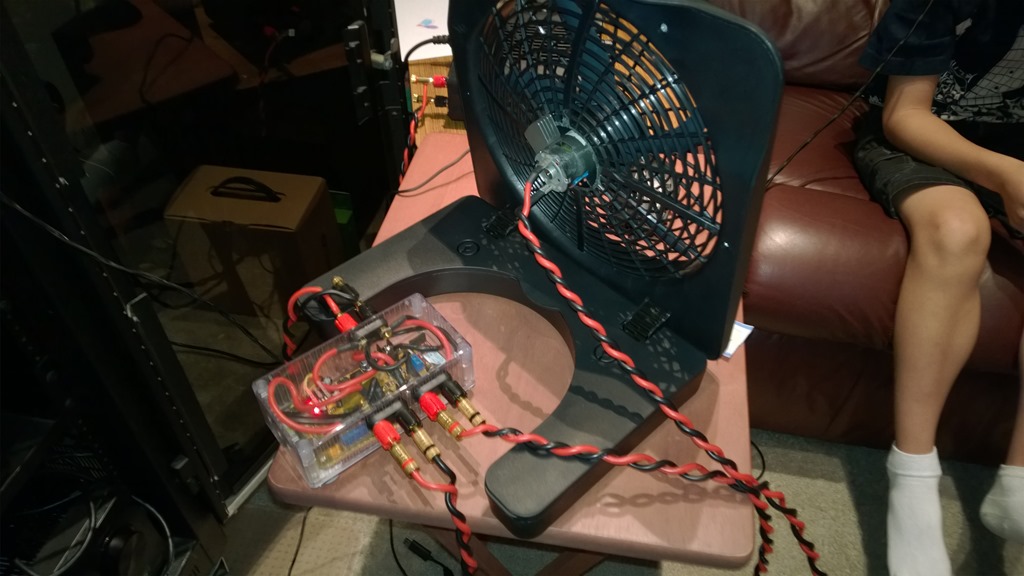

    I've already done a complete write up of this project on my blog, so I'll just post a short introduction and a couple videos here.
    SuperFan is powerful wind generation system created with VR simulations and games in mind. It adds an impressive amount of immersion, especially when combined with rollercoaster and racing simulations.
    The full article with step-by-step instructions and even a parts list can be found here:
    http://jared.bienz.com/2014/12/19/create-your-own-superfan/
    Special thanks to @yobuddy for the awesome SimTools, for working with me on fixing the high DPI issues and for implementing the CLAMP function to make this all work. THANKS!

    I honestly hadn't thought about automotive radiator fans. Interesting idea. I guess my main issue would be finding a housing for them. I needed something safe and something that could be collapsed down small and put away. Also, how many amps would an automotive radiator fan draw? The controller I'm using can handle up to a momentary 40 A but recommends no more than a sustained 18 A.

    Yeah, that's one of the reasons I chose the motors I did. One is from RC cars and the other is from a cordless drill. They both handle variable speed quite well. Unfortunately the RC one, though faster, tends to heat up too much. I need to replace it with another order of the other one. They're both cheap. Only about $10. But then of course you need fan blades on top of them.

    Wow, great questions. Yes the AC demo is loud on the fans. Those fans are a lot louder than I'd like them to be and the sound is almost all from the motors (not the wind). However, all of the games I built the fans for are games I play with the Oculus. And when I'm playing with the Oculus I almost always have surround sound headphones on. So I really can't hear the fans at all.
    Max RPM of the fans using the motors I bought is around 20,000 (the motor that gets much hotter can do 24,000). The RPM of the original stock fan is much much lower. I'd guess around 2,000 RPM max.
    If anyone finds an equivalent motor with low noise please share!

    CLAMP is just a shorthand way of saying "Don't let this number go above X or below Y".
    I needed it for two reasons:
    1: Because I wanted the entire range of values dedicated in one direction on the fans. (There isn't really any value in getting the fans to turn backwards - you don't really feel anything.)
    2: Because I didn't want the fans starting to turn until a certain speed threshold is reached.
    My script in Game Dash formats the value like this:
    PERCENT 2.5 30
    SCALE 0 255
    ROUND 0
    TOCHR
    The line that says PERCENT 2.5 30 means that if the coaster is moving less than 2.5 meters per second, don't turn the fans at all. Unfortunately if SimTools sees a value less than 2.5 it returns a negative percentage. That doesn't do me any good because I don't want the fans turning backwards and because on the next line I need to convert that percentage into a range of 0 to 255.
    Because there isn't currently any CLAMP method, I had to modify my GameDash.exe so that PERCENT would not return negative numbers. But when @nobuddy puts in the CLAMP method my formula will just become:
    PERCENT 2.5 30
    CLAMP 0 100
    SCALE 0 255
    ROUND 0
    TOCHR
    There are other uses for this as I'm sure can imagine.

    I think this is phenomenal. My original idea was to drive a large 30" fan I had here at the house. I live in the US so we're mostly 110v not 220v, but I looked all over the net for example circuits on how to drive a 110v fan from an Ard. I found tons of examples of how to do simple On / Off, but only found a couple ready-made circuits to drive high voltage motors and they were quite expensive.
    In the end I went the route I did because of "ramp time". I noticed that when I turned the 30" fan on it took about 8 seconds to spin up to top speed. When I turned it off it took at least 5 seconds to slow down enough that there was no wind. That's fine for some projects like roller coasters with long sweeping turns driven mostly by inertia, but in racing simulators where you can take off like a rocket or stop on a dime, that ramp time would have been too noticeable. At least in my opinion.
    If you do end up creating a version with this approach I'd be more than happy to work with you on implementing the SuperFan protocol if you need any help (obviously it's pretty simple). Or if you write it yourself, please consider contributing that sketch back to the community here:
    https://github.com/jbienz/SuperFan
