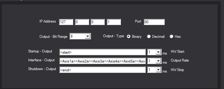

    I am attempting to capture the motion inputs in a network interface. i.e.
    I am currently reading in <Axis1a><Axis2a> etc... Which works fine, however I want to read the values above. Is there a way to do this? Looking for some type of variable which I can pass into my Interface - Output in my network tab, maybe something like <MotionInputRoll><MotionInputPitch>.
    Thanks!

  3. jake_iris
    jake_iris New Member
    Nov 26, 2024
    6
    40Coins
    Hey,
    Yea I want to stream these motion input values out over UDP, in the Network Interface.
    This is what I am currently doing in my Network tab, however I would like the motion input values instead of <Axis1a>...<Axis6a>.
    Thanks!
  4. yobuddy
    51,377Coins
    +5,202 / 19 / -0
    I'm afraid that is not how the system works, as simply sending the games output somewhere won't run a simulator is all. Could you explain a bit more of what your trying to do?

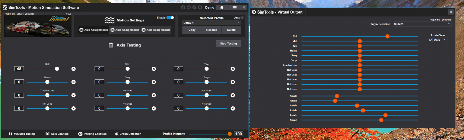

  7. jake_iris
    Nov 26, 2024
    6
    40Coins
    This is what I was doing before, I had one axis assigned to each DoF at 100%.
    However I was noticing that when I was testing the settings, by moving the sliders, along with having the sliders virtual output open. That changing the slider of one DoF, would effect other axis'.
    i.e. When I move the move the roll slider in the testing window, I notice that all my other AxisXa are also moving with it.
    I was under the assumption that if I had assigned each DoF to its own axis, then when I test and alter one DoF I should only see the associated axis moving in the virtual output sliders window, not all other axis too.
    I have attached a photo displaying what I mean. Here roll is assigned to Axis1a, yet we see all other axis' move with roll.
  8. yobuddy
    51,377Coins
    +5,202 / 19 / -0
    What axis plugin are you using buddy?
  9. jake_iris
    Nov 26, 2024
    6
    40Coins
    Generic 3D linear
  10. jake_iris
    Nov 26, 2024
    6
    40Coins
    Ah, I just tried with generic 2d basic and I am getting what I intended.
