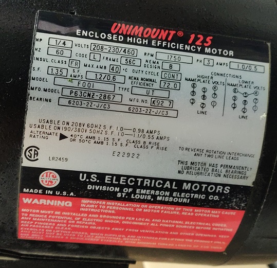

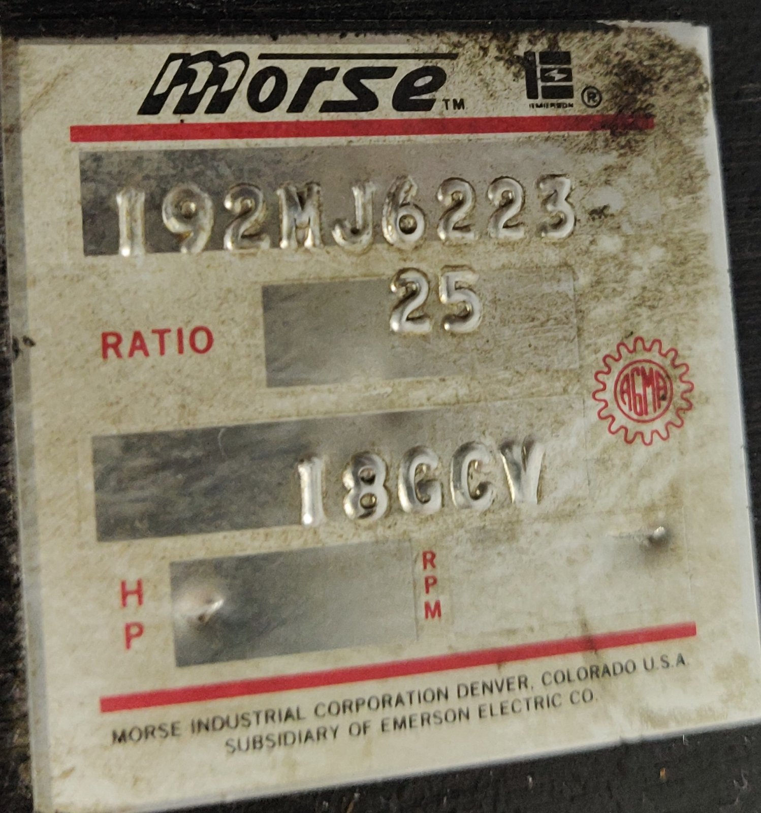

    How to know the Motor Torque output?

    the motor label gives 1/4 HP and 1750 rpm you dont need more

    @adgun Do you confirm the following values?
    [​IMG] [​IMG]
    Motor:
    HP: 1/4
    rpm: 1750 r/min
    η = 72%
    Gear:
    i=25
    ω= rpm.2.π/60
    Pout=Pin.η
    1 hp = 745.699872 W
    1/4= 186,5W
    Pout=Pin.η
    Pout= 186.5*0.72=134.226W
    ω= rpm.2.π/60
    ω= 1750.2.π/60 =183rad/s
    Pout=T.ω
    Tmotor=Pout/ω
    Tmotor=134.226/183 = 0.733Nm
    Tgearmotor= Tmotor. i
    Tgearmotor=0.733*25= 18.33Nm
    Tgearmotor= 18.33Nm

    motor 186.5 watt/rpm 1750 gearbox ratio 25 gearbox eff 70%
    1750/25\=70rpm /60\=1.1666 rounds second
    1.166x2xpi=7.33 meter second
    186.5/7.33\=25.44NMx70%=17.81NM

    Thanks to validate the logic...
    The efficiency is 72%...

    You must have gearbox eff. not motor eff.
    The motor delivers 1/4 hp but ask more current doing that.
    Wormgearboxes with a 25 ratio are about 70% with smal brand differinces
