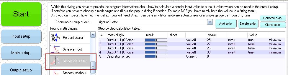

    You could have a controller of 500i/sec, but if your game send at 30i/sec... what else?
    With X-Sim, you could insert a smoothness filter in the math section.
    If you want a 2DOF or 3DOF visit our website.
    Patrick
