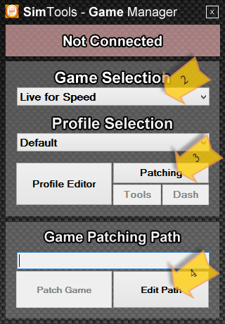

    i dont want to crash my simtools again
    21,589
    151,148Coins
    Make sure Game Engine and Game Manager are not running, then launch the SimTools Game Plugin Updater: http://www.xsimulator.net/simtools-game-plugin-updater/
    Drag the plugin zip file onto the Game Plugin Updater and it will install the plugin for you.
    Once you have the plugin installed you can close the Plugin Updater and patch the game for motion.
    There are some games that need Game Manager running as Admin to patch properly, so start it as Admin.
    Select the Game you installed the plugin for, then click the Patching Button and finally the Edit Path button.
    Most games use there install directory as the Game Patching Path. A few, like 64bit Codemaster games use the Games folder in the My Documents folder.
    You should get a message that the game was successfully patched.

    how find SimTools Game Plugin Updater?

    ok find it in C:\Program Files(x86)\SimTools\SimTools_PluginUpdate.exe
    21,589
    151,148Coins
    Or in your menu under SimTools.
