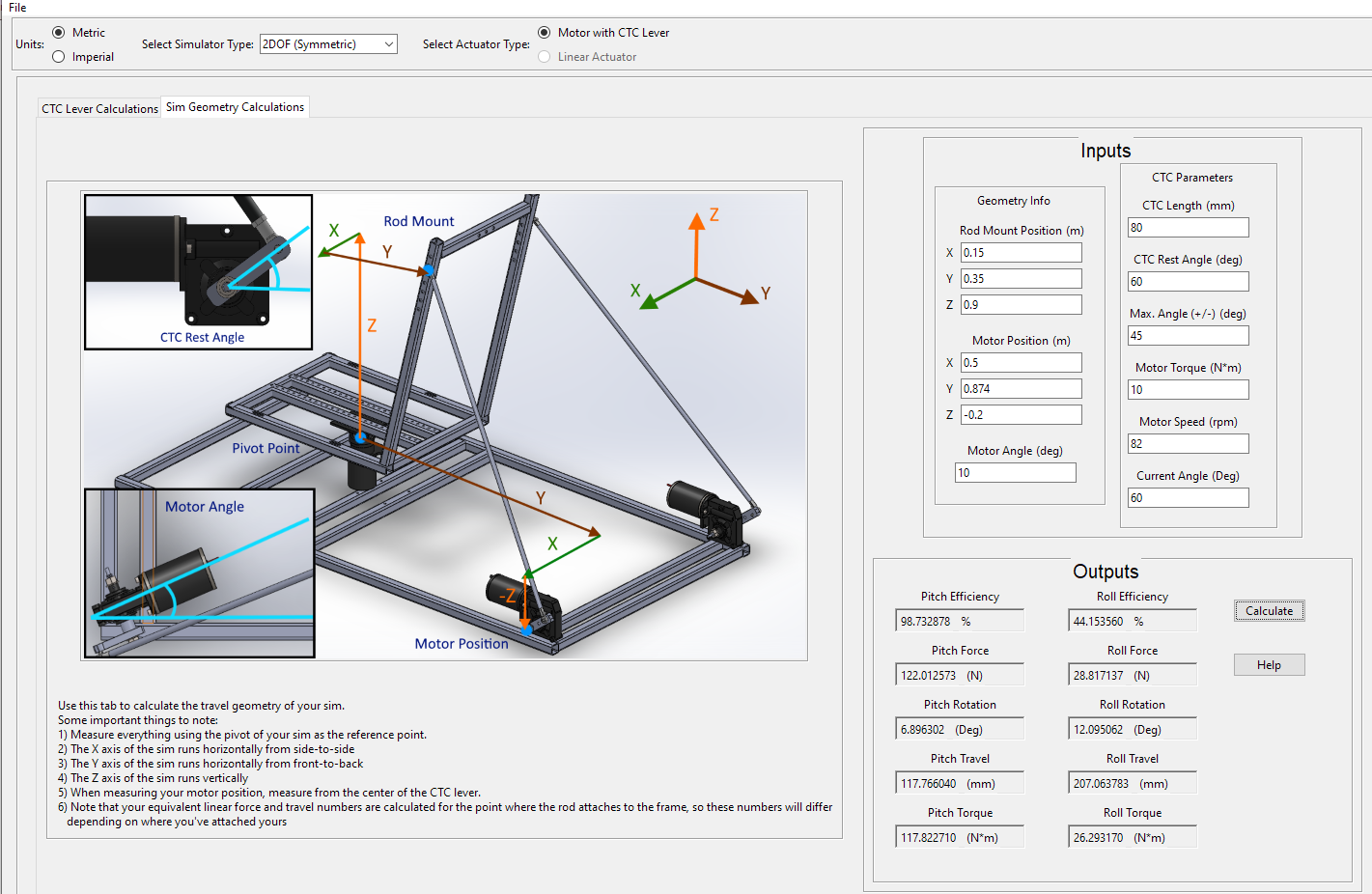

    upload_2021-6-8_15-25-16.png I am on the starting steps for building a sim Rig on my own, i have read the FAQ (you guys have a whole library in there, thanks a lot), and now i am in the experimental phase

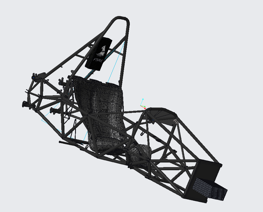

    This is the retired chassi and seat of a Formula Student, that i will be using, it weights around 28kg
    The main question here, as the title says is, wich parameters are ok on my Simcalc Assumptions
    The pivot points distances were measured on the chassi cad, so should be ok, i played with the numbers today and i guess this is a good result, (But at the end of the day i really dont know)
    So i would like to discuss with you guys.
    As far as i know
    - The efficiencies are OK
    - Roll rotation is high compared with pitch rotation (I guess both of these should be around the same value)
    I am unsure on my CLC lenght, and Max angle values. And reaaaally open for more insights from you guys if there are any noob mistakes i am making
    Motor specs:
    - 82 Rpm
    - 35 n*m max torque
    - 12V
    Idk if it is useful info, but i plan to make a 2Dof + traction loss :)
    Tks in advance

    But in the three data that you summarize:
    - 82 Rpm
    - 35 n * m max torque
    - 12V
    the gearmotor power expressed in Watt is missing. (which you will need to determine your electrical system)
    Also I see you consider the frame weight calculation (fantastic) 28Kg. but I don't see the weight of the pilot?

    And yes, by specsheet the gearmotor power is 240W (20A and 12V)
    For driver weight i am oversizing, thinking about around 150kg overall (driver+chassi+stuff), maybe 200kg
    But idk where to take weight in account, i guess "Pitch force" would have to do with it? But since most of the weight in a 2DOF system is taken by the central pivot the motors would be used only for lateral and longitudinal acceleration?

    in my opinion the gear motor you have chosen is fine.
    From personal experience and from what I have been able to learn in this forum and also for logic, the moving part will be pivoted in the center of gravity in such a way that the movements can count on the maximum reaction of your gear motors. In practice, the gearmotors must overcome the moment of inertia. In my case with 200Kg. mass, position and dimension of the pin (joint) in the center of gravity, the upper position and length of the levers resulted in an approximate calculation of 74Kg.m2. (for this calculation I used an online software) The lever length operated by the gearmotor will also affect the final calculation of the suitable motor.
    In all honesty, i enjoyed myself and learned more or less how to determine the correct gearmotor, but the hypothesis thought out without making calculations was the same as the calculation. I had already set out to install i63 gear motors - 230W-12V-16A and so I did. All the movements seem reactive to me.
