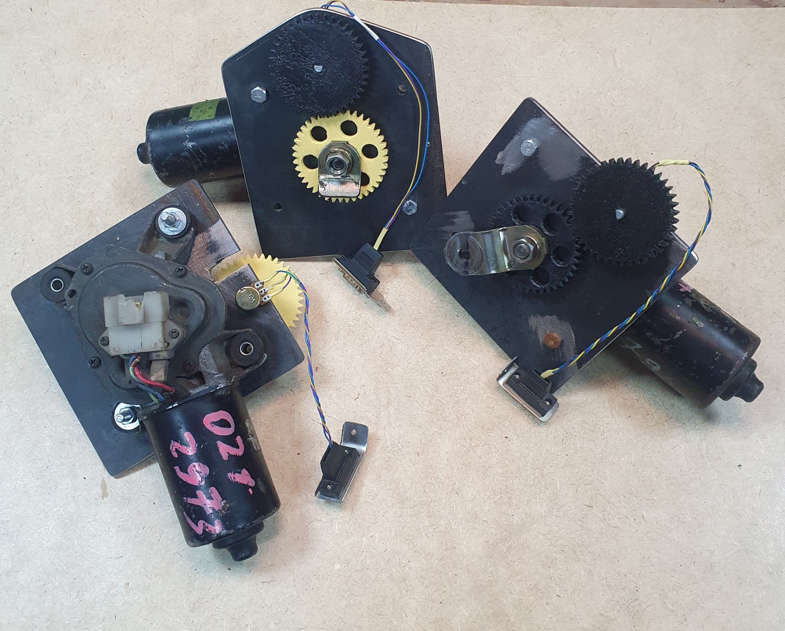

    I have been preparing to start building this project for a long time. At the beginning, I installed the Microsoft Flight Simulator 2020 and learned how to fly a plane a little, I realized that I needed a more natural immersion in the reality of flight. After studying the work of other people, I realized that you can try your hand. First I bought 3 motors from car wipers, installed them on metal plates. I connected the feedback resistors to the motors using gears made on a 3D printer.

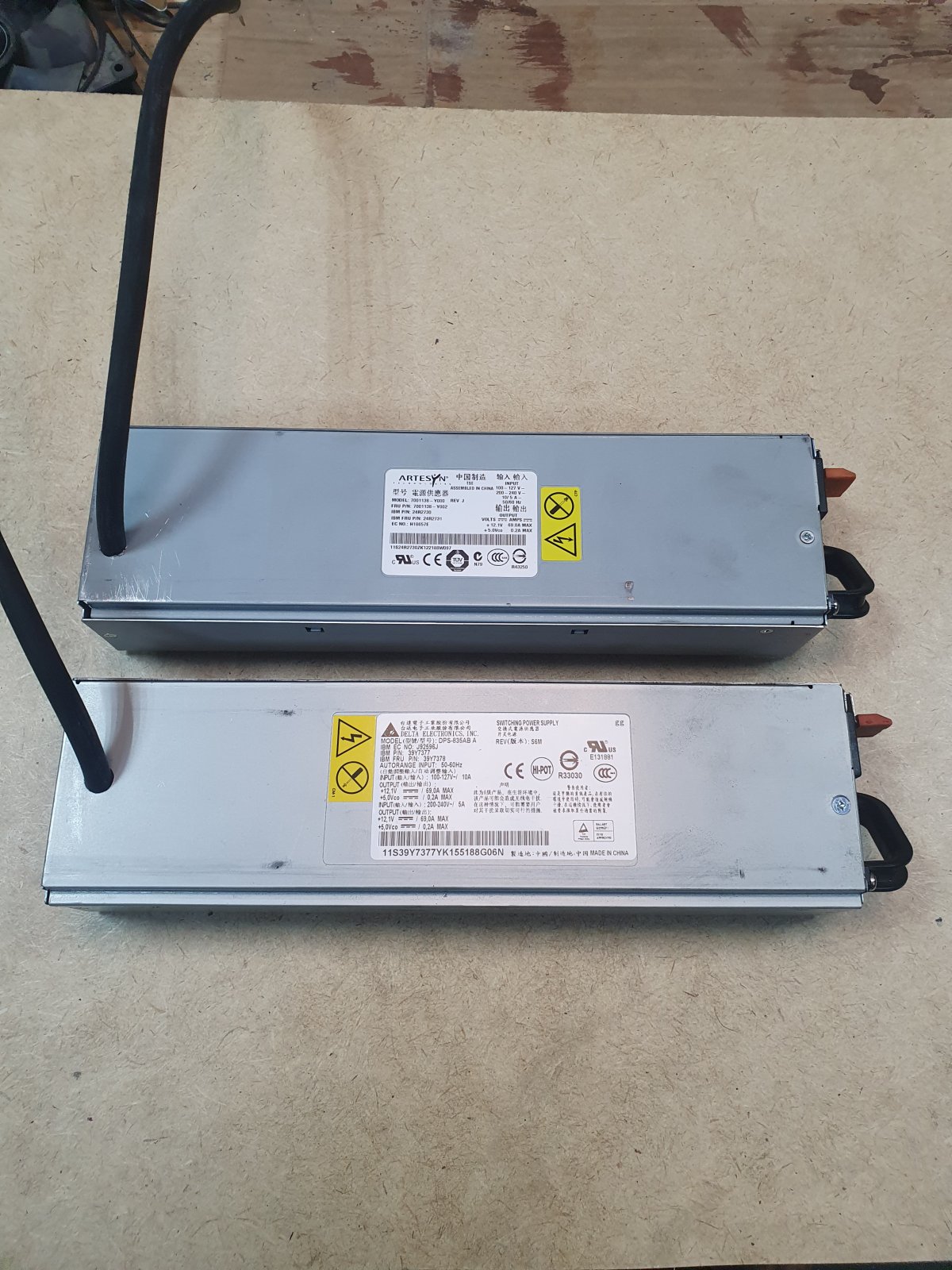

    I want to supply power supplies from the server 12 volts 850 W

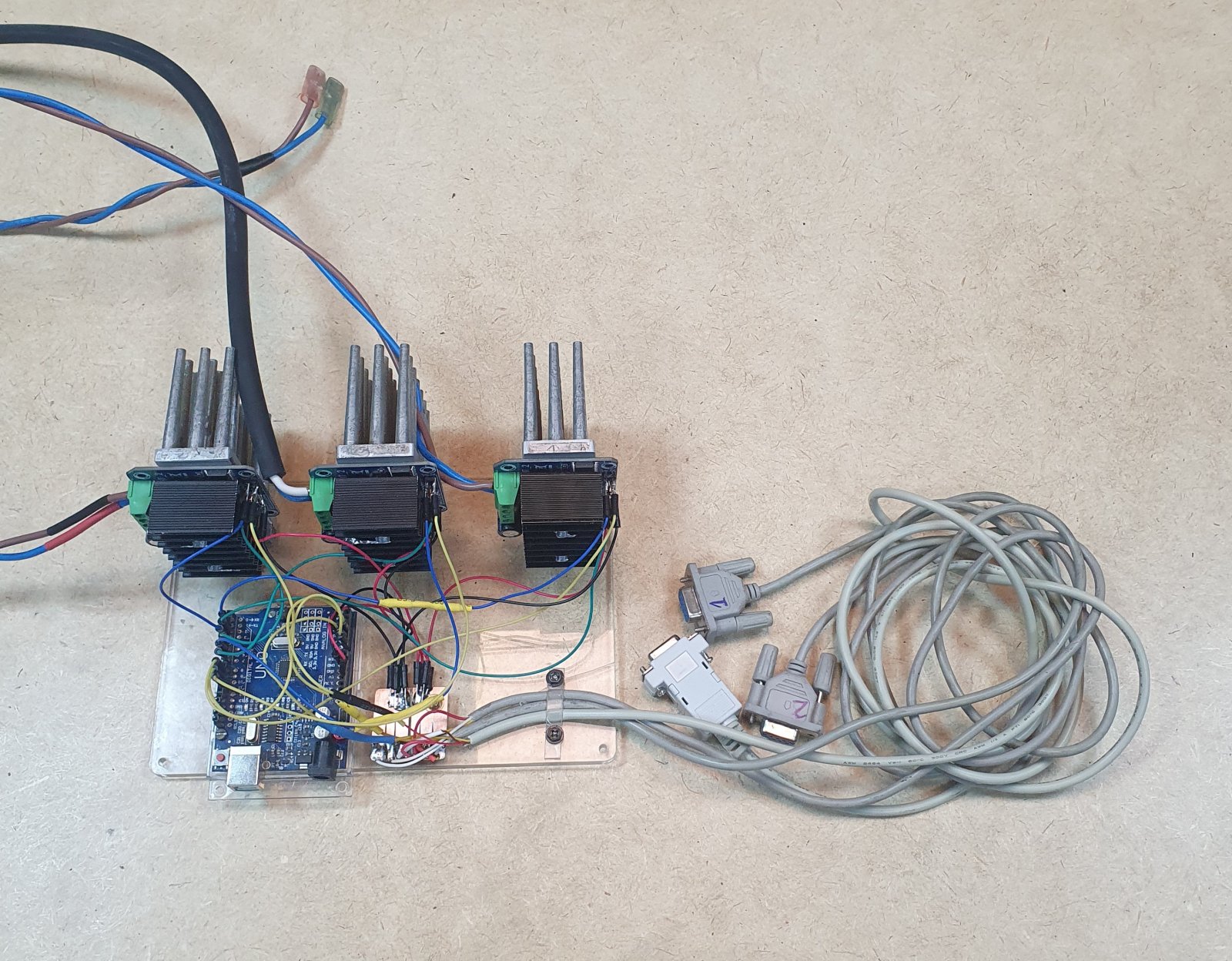

    Now I'm building an arduino and motor control drivers

    Assembled the scheme

    nstalled additional cooling radiators. It is necessary to put an insulator gasket between the radiator and the board,

    I set up the electronics according to the video lesson Thanks to the author for a detailed story!

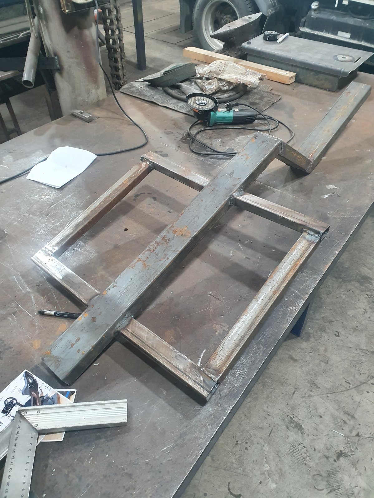

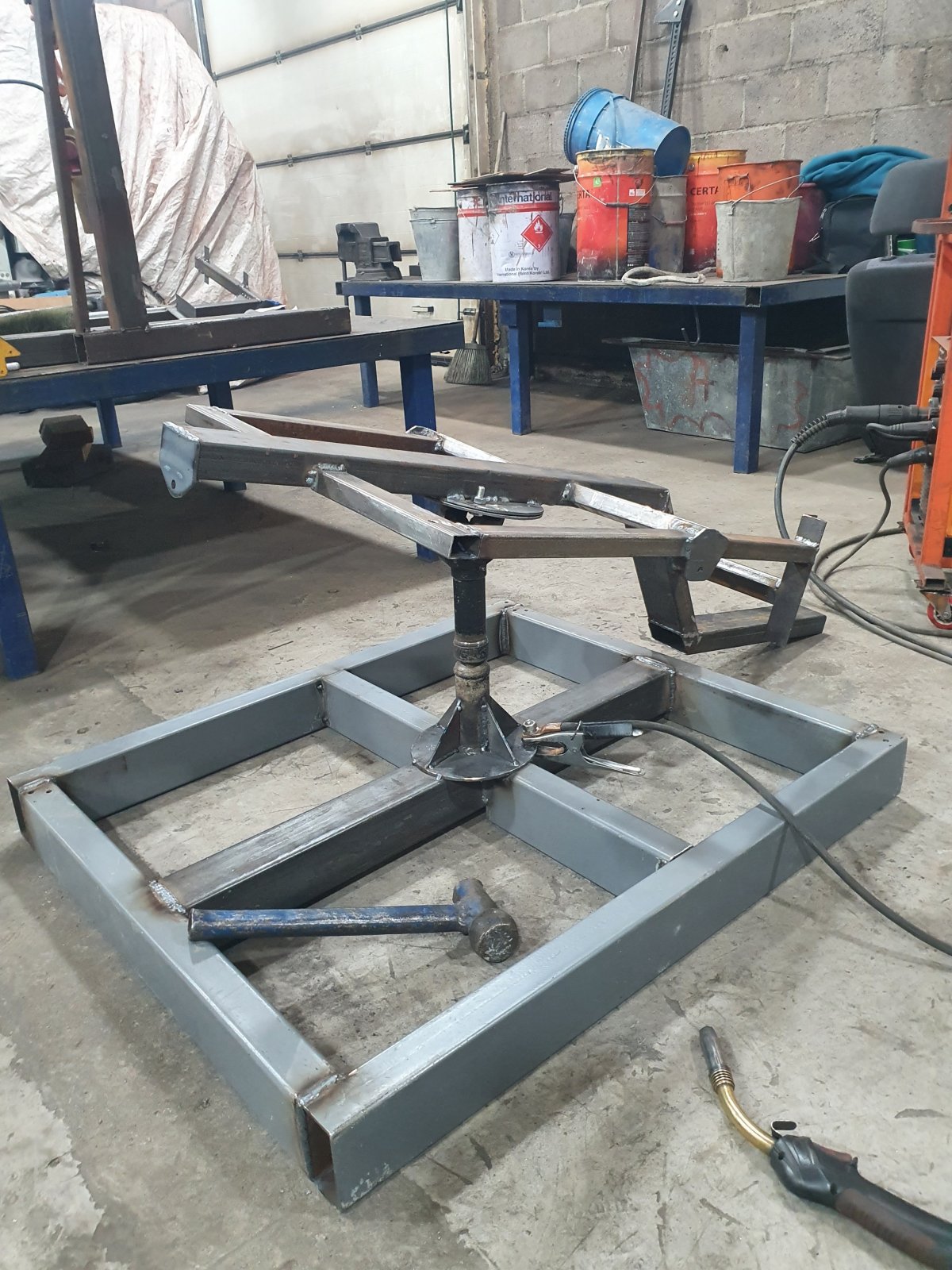

    Making a platform from materials I found in the garage
  8. radist07
    radist07 Valeriy
    Sep 8, 2022
    48
    Учитель
    Россия
    630Coins
    +10 / 0 / -0
    Profile pipe. It was heavy, but I had it

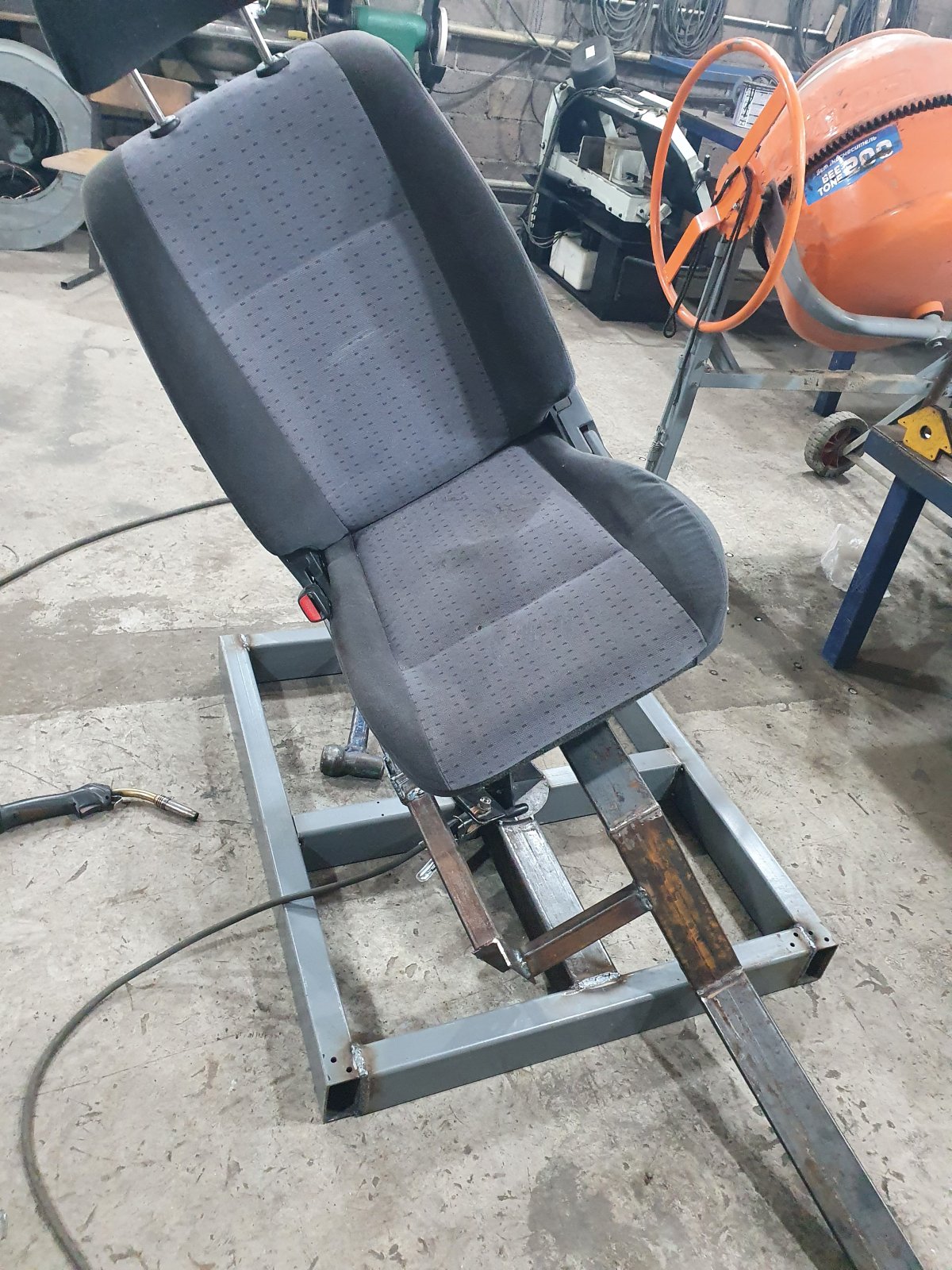

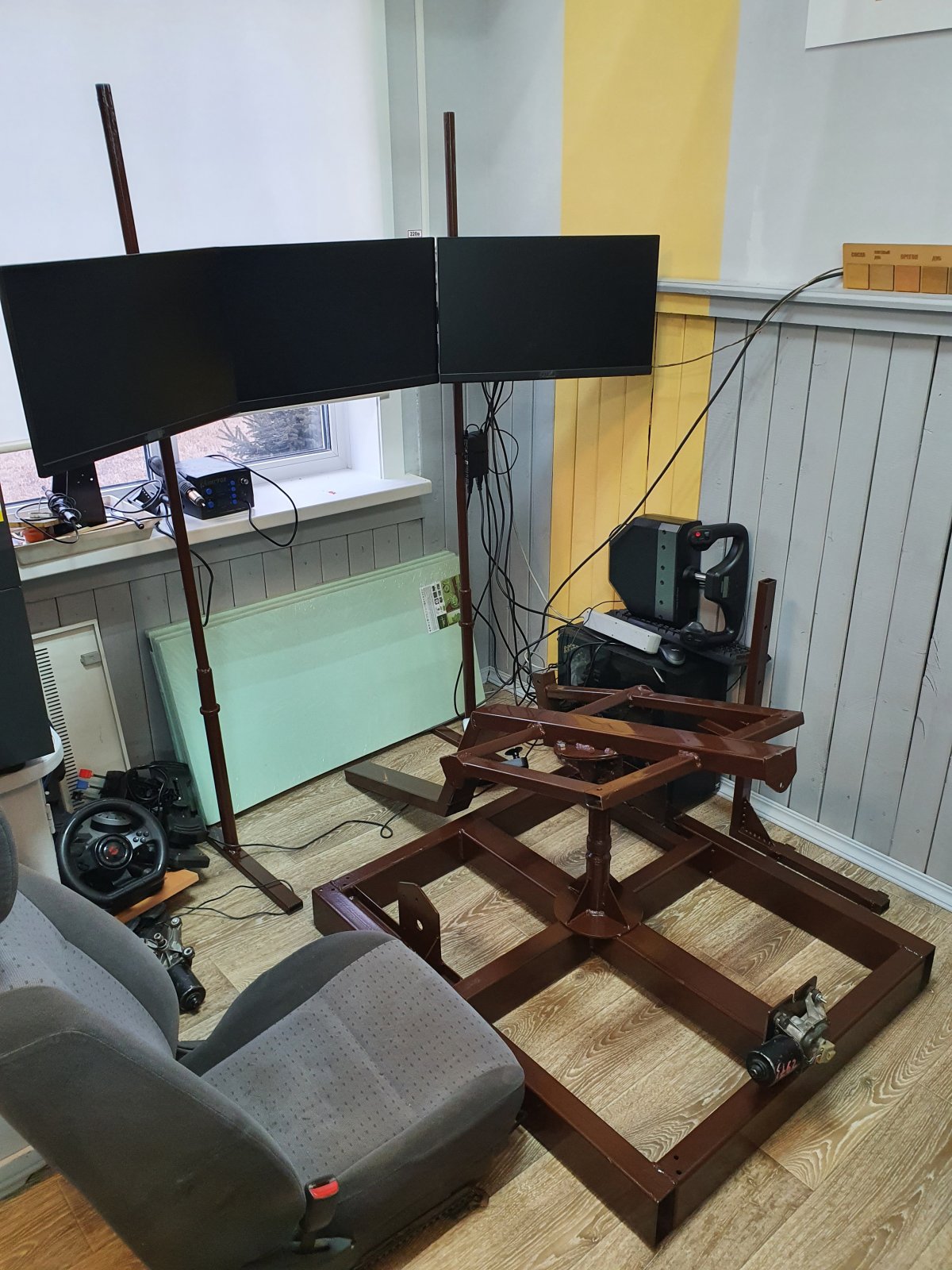

    A seat from a Japanese car
  10. radist07
    radist07 Valeriy
    Sep 8, 2022
    48
    Учитель
    Россия
    630Coins
    +10 / 0 / -0
    It remains to be treated from rust and painted

    partial installation

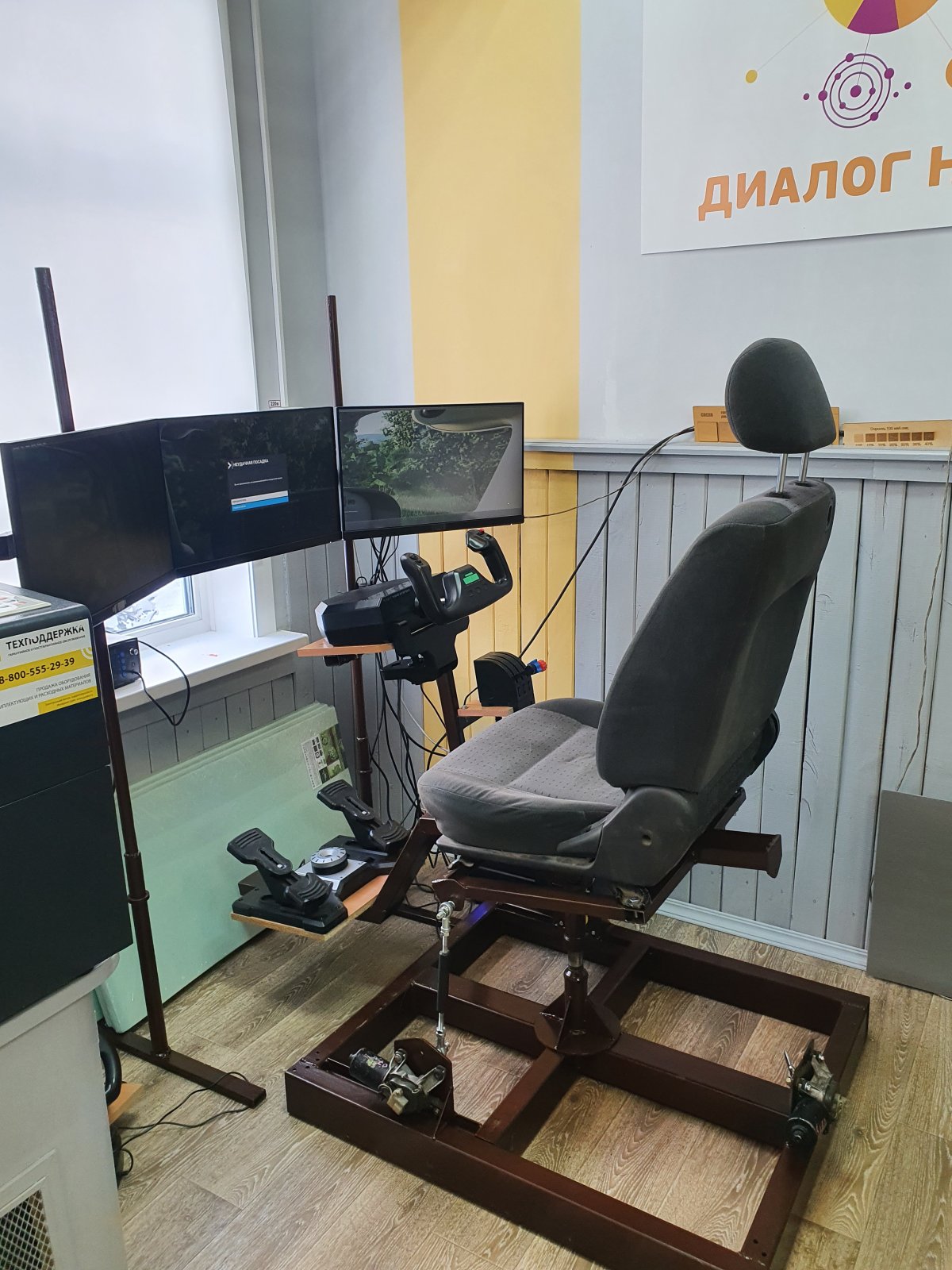

    Assembled the mechanical part. I assume that the motors will need to be installed at the back of the chair because there the lever relative to the hinge is longer and it will be easier for them to move. but first I'll try in this version
  13. noorbeast
    21,723
    152,051Coins
    +11,063 / 56 / -2
    I think you may be right as the wiper motors may not have enough design leverage to drive the rig mass when loaded.

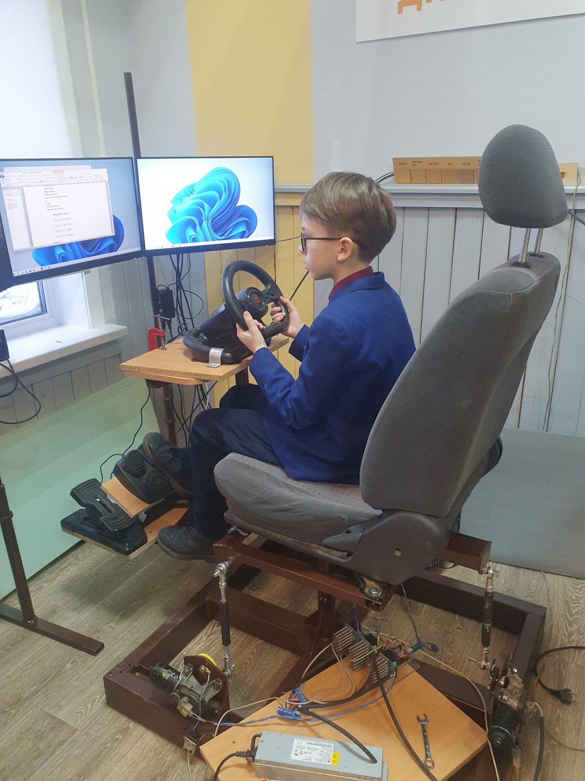

    Today I tested the installation. As expected, the motors turned out to be very weak, they worked only at peak modes, fine motor skills were not felt (((. I will put 250W 24V from the kalyaski
