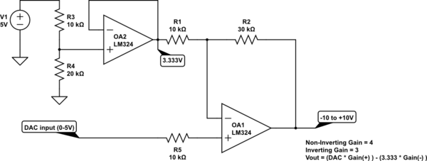

  2. RacingMat
    2,233
    21,087Coins
    Interesting!
    Could you tell us what is your amplification board schematic?

    I 'borrowed' this idea from the web for offset and gain (span).
    text from original article gives a better explanation of operation;
    Quote..
    Since your full scale output from the DAC is 5V, and you want a full scale output from the opamp of 20V (-10 to +10) then you need to have a gain of 4 in the opamp. That gives you 0-20V. So you want (DAC x Gain) - Offset.
    In a non-inverting op-amp, the + input has a gain set by the (feedback resistor/input resistor)+1. However, the negative input has a gain of simply the (feedback resistor/input resistor). So a non-inverting input with a gain of 4 will have a a gain of 3 from the negative input. You can use the negative input to offset the fullscale 20V to -10 to +10. So you want 10/3 = 3.33 volts at the negative input.
    At the point I marked 3.333V, for a standard non-inverting op-amp configuration, that point would be GND. But you want to add the negative input's gain to the output too, so you need 3.333V there.
    Unquote...
    Any 'low offset' or precision type dual op amp should work better than the original LM324, i used OP200 because i have some to hand. OA2 establishes a low impedance reference voltage for OA1 so you can use an adjustable multi turn trimmer for R3/R4 divider to make it adjustable without upsetting the gain structure and OA1 sets the span. Works well and has been very stable with the Hall devices as the input.

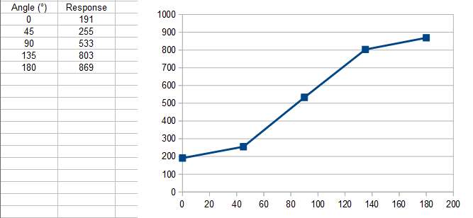

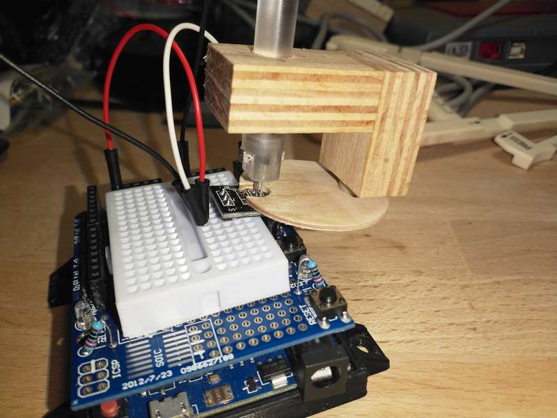

    Nice idea! I built a quick setup to test with a popular SS39ET and an Arduino Uno
    and got almost the same result as you.
    0° -> 180° => 1 - 4V
    180° -> 360° => 4 - 1 V
    The output wave form is sinusoidal:
    This could be used to compensate for the nonlinear movement of crank gears like wiper motors.
