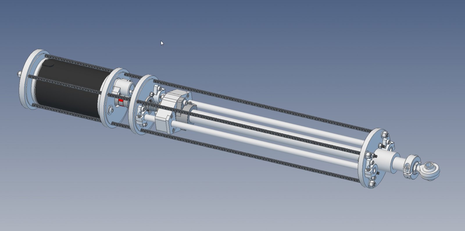

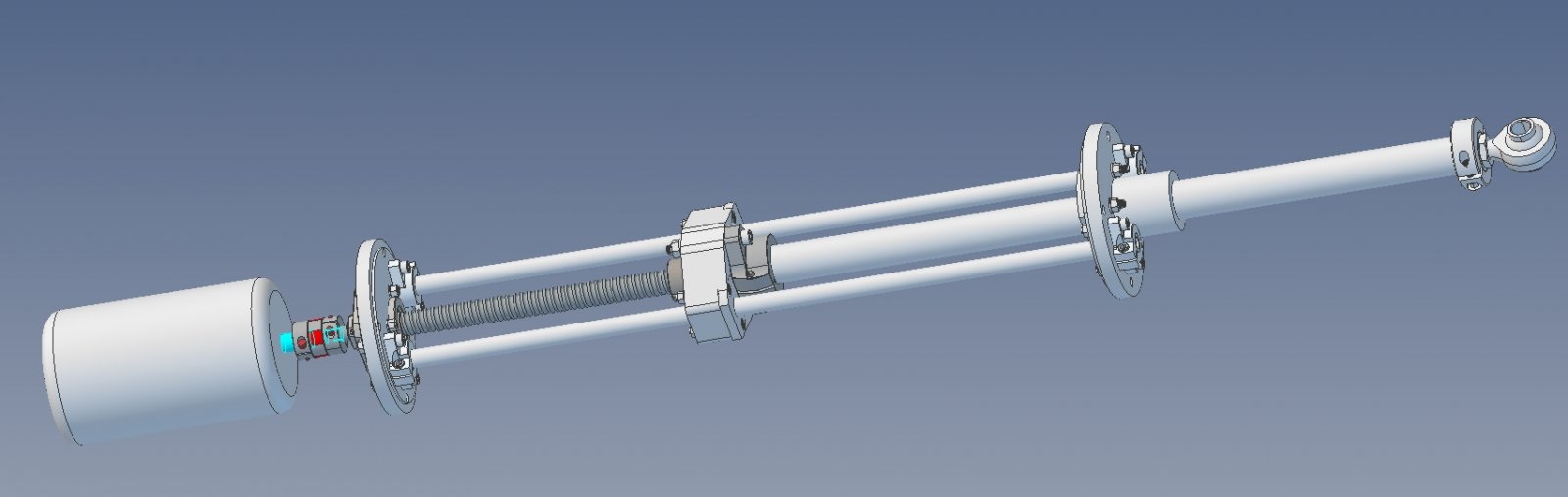

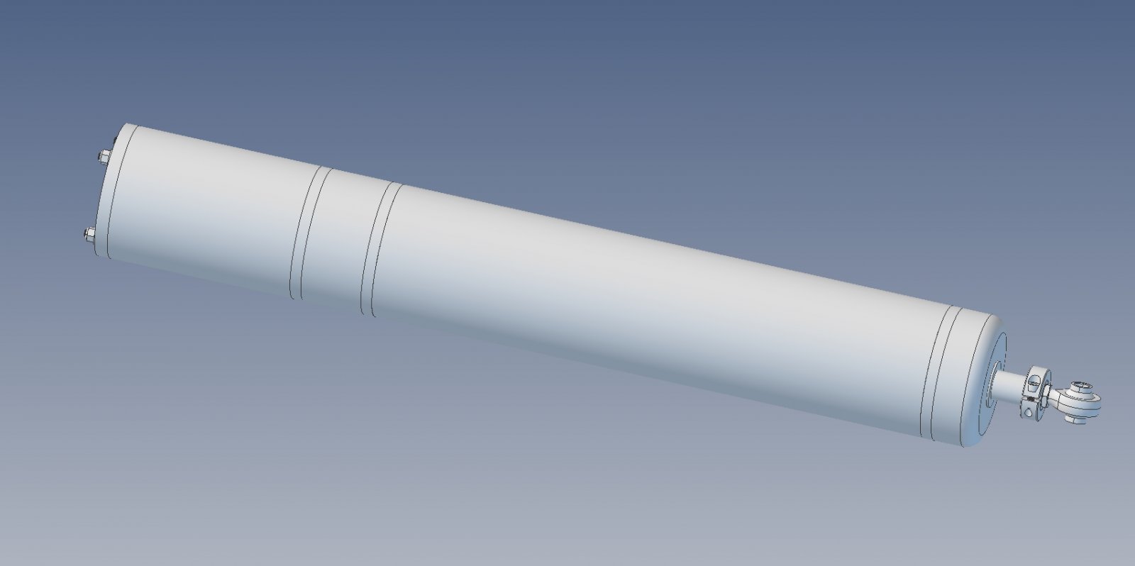

    Here is V1 of the design, Using guesstimates for placeholders for a lot of components.
    And I started working on V2 with actual dimensions and adding detail like screws, its only about half done right now though.
    And because why not, I did a few renderings. The files are too large to post here so you can view them from the link
    https://www.dropbox.com/sh/6z5bhx2myj4muaz/AACm_aAXMw2N9tswby7LtlWOa?dl=0
    This Design has a max stroke of about 15.5" and the overall length is TBD, but right now its about 32" without the u-joint.
    Once I get my design finalized I will share a full BOM including purchase price/location and complete drawings and 3d print files.

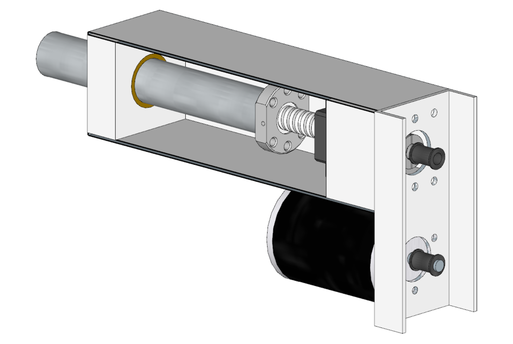

    @Hoddem I'll be following your journey as I too am about to embark on a linear actuator build having been inspired by the likes of @SeatTime , @SilentChill and @wannabeaflyer2 who have kindly shared so much of their work.
    Currently my plan is only for a compact seat mover and just 2 DOF to begin with, but I'd like to think that this could be extended sometime in the future.
    Due to the long lead-time on China ball screws I've already ordered 4 x 1605's complete with end bearings. I too was wondering if maybe 1610's would be preferable for increased speed but figure it would be easy enough to retro fit if required once the actuator is built.
    In my current design I'm looking to use 70mm x 70mm x 2mm aluminium box section with a 70mm x 25mm x 3mm aluminium channel for the drive belt. The estimated total length of the actuator is approx 285mm.
    Here's the preliminary design....
    I've sectioned away the wall of the aluminium box section so that you can view the internals, anti-rotation will be accomplished using a simple wear strip and instead of an Igus flanged linear bearing/bush (which are hellishly expensive!) I plan to use an oilite bush similar to pictured below...
    Not sure exactly what size I'll require but they come in a variety of sizes as standard and are very cheap, for example Ebay have them for a couple of quid...
    http://www.ebay.co.uk/itm/OBF182512...325951?hash=item1e83630e7f:g:b6AAAOSwMmBVyzTi
    I'm sure they won't be as efficient as the Igus bushes but for my needs I think they will be fine. I guess time will tell?
    I'm currently deciding how to proceed with positional feedback, I quite like the idea of a linear transducer such as a linear resistor or magnetic encoder.
    Linear resistors are dirt cheap but probably not up to the job...
    https://www.coolcomponents.co.uk/en/softpot-membrane-potentiometer-200mm.html
    And magnetic encoders look ideal, but whilst the tape is cheap I'm yet to find a reasonably priced reader...
    https://www.machine-dro.co.uk/high-...ar-tape.html?gclid=CK_P7PePh9QCFUq3GwodYb0G8w
    I'm also very limited on machining tools and so my design has to take this into account. :(
    I won't hijack your thread any further and will start my own thread once parts start to arrive and I have finalised the design.
    Good luck with your build, I wish you success and will follow your progress :popcorn

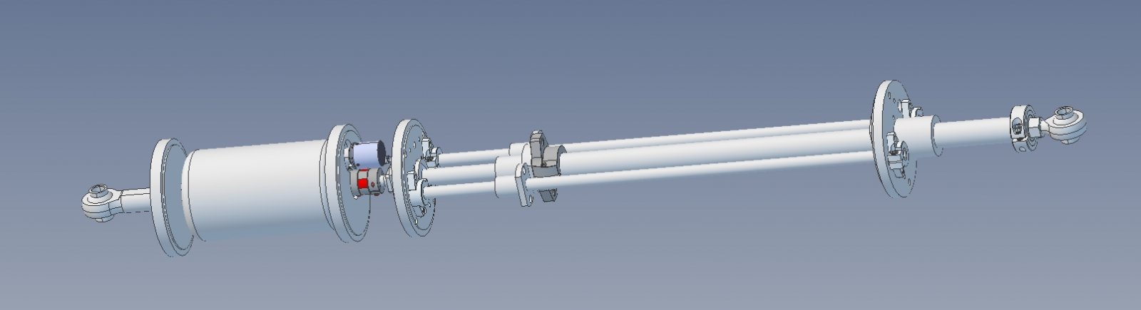

    I got a little further on the design tonight. The encoder is now mounted and more hardware has been installed. I still need to get limit switches figured and I have a u-joint on order so I can model that once its in hand.
    Here is the actuator without the covers
    and here is the actuator with covers
    I have uploaded the progress so far to grabcad, anyone who is interested can view the model in 3d right from your browser in grabcad.
    https://grabcad.com/library/hoddem-s-diy-linear-actuator-1

    Do you think the 4 external rods would be needed? I think that with the 2 carbon guides and the pvc pipe could be more than enough.
    Edit: Man, that exploded 3d view of the actuator is awesome, a picture is worth a thousand words!

    The way I have it setup right now, the threaded rods are holding everything together against the PVC cylinders. If I remove the rods then the whole system will fall apart, If i remove the PVC I could use only the rods by adding a bunch of nuts at each stage.
    I'm still not sold on the PVC idea as is, I think its going to be a real challenge to assemble and troubleshoot. I will probably cut the PVC sections in half to allow removal without fully disassembling, or scrap the PVC idea and change the threaded rod to a larger size like 1/2". I really like the idea of an enclosed and system, I can just imagine someone getting a finger inside one of these while its running.

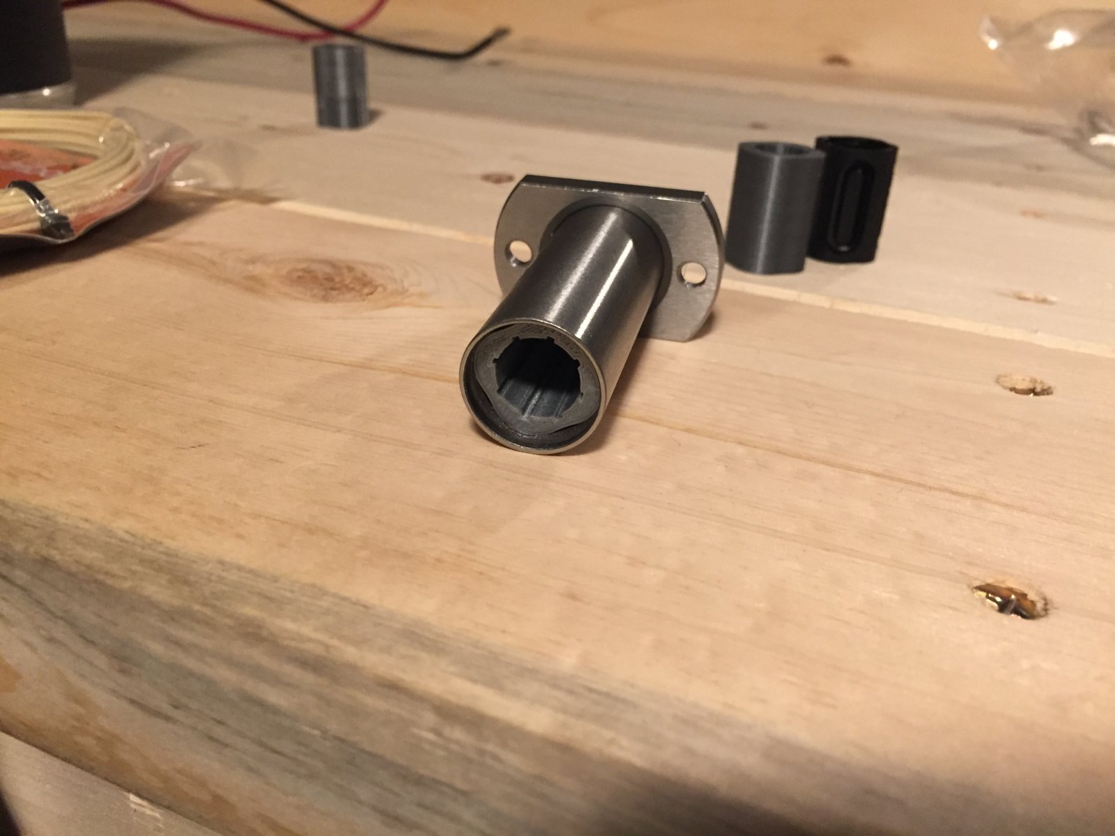

    ok, so here is my theory on how to save a few buck on the IGUS linear bearings.
    I was snooping on the IGUS website looking for anything that referenced carbon fiber shafts and I found this.
    http://www.igus.com/wpck/17114/carbonfibertest
    and they even make the j260 material in 3d printer filament for prototyping.
    http://www.igus.com/product/716
    So I was looking at the 3d print filament and the little chat window pops up and next thing you know I have 3 of these little packages at my doorstep (bad picture, the other side says j260 on it).

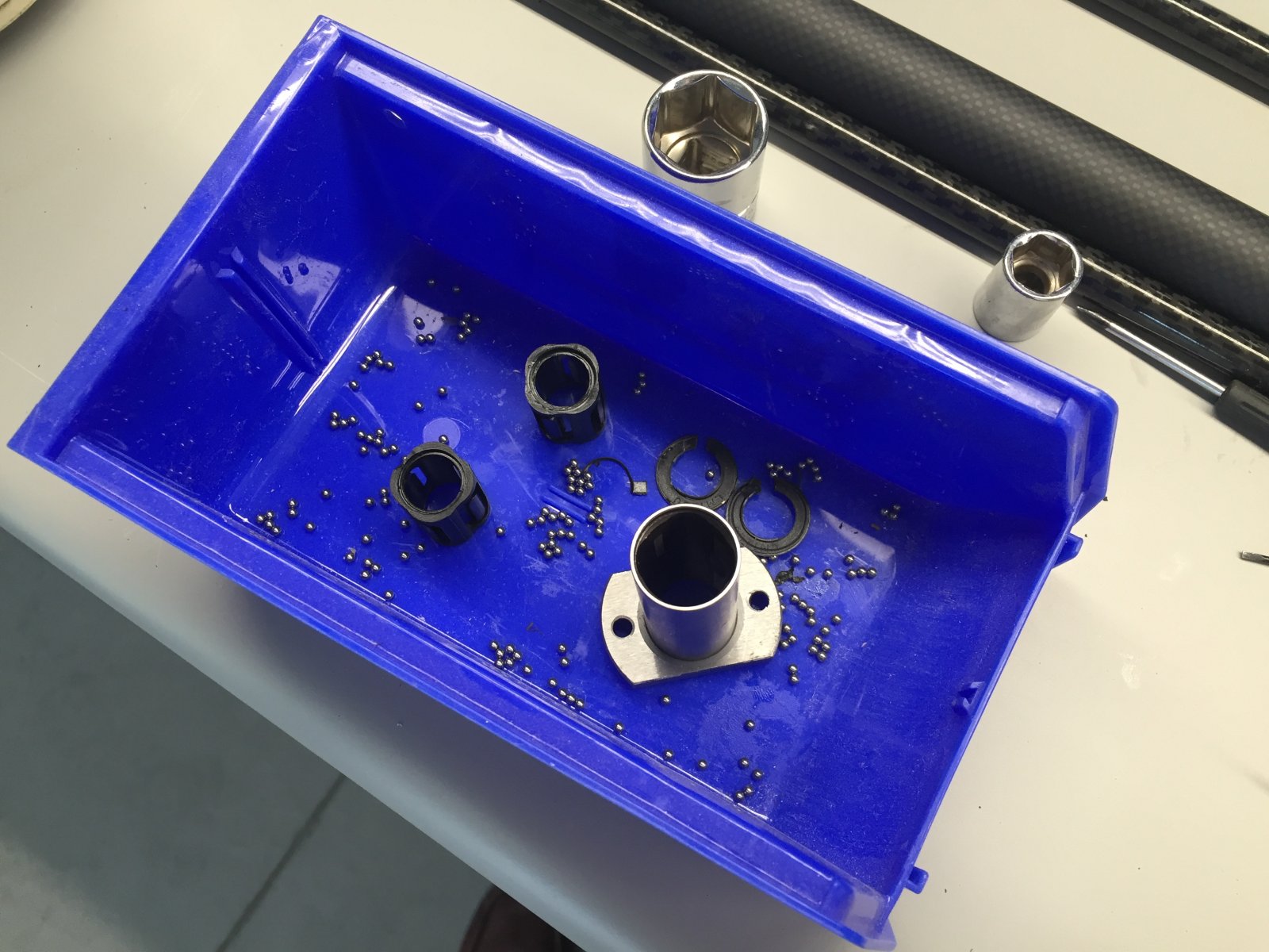

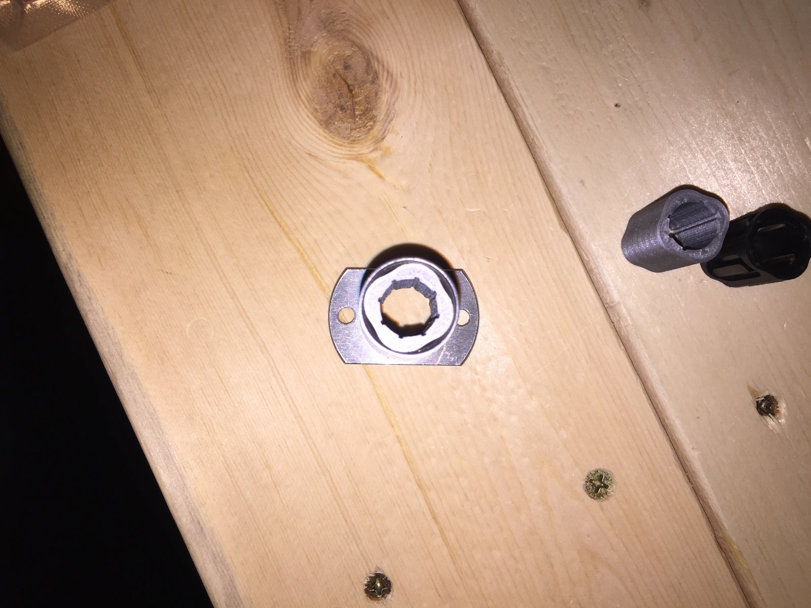

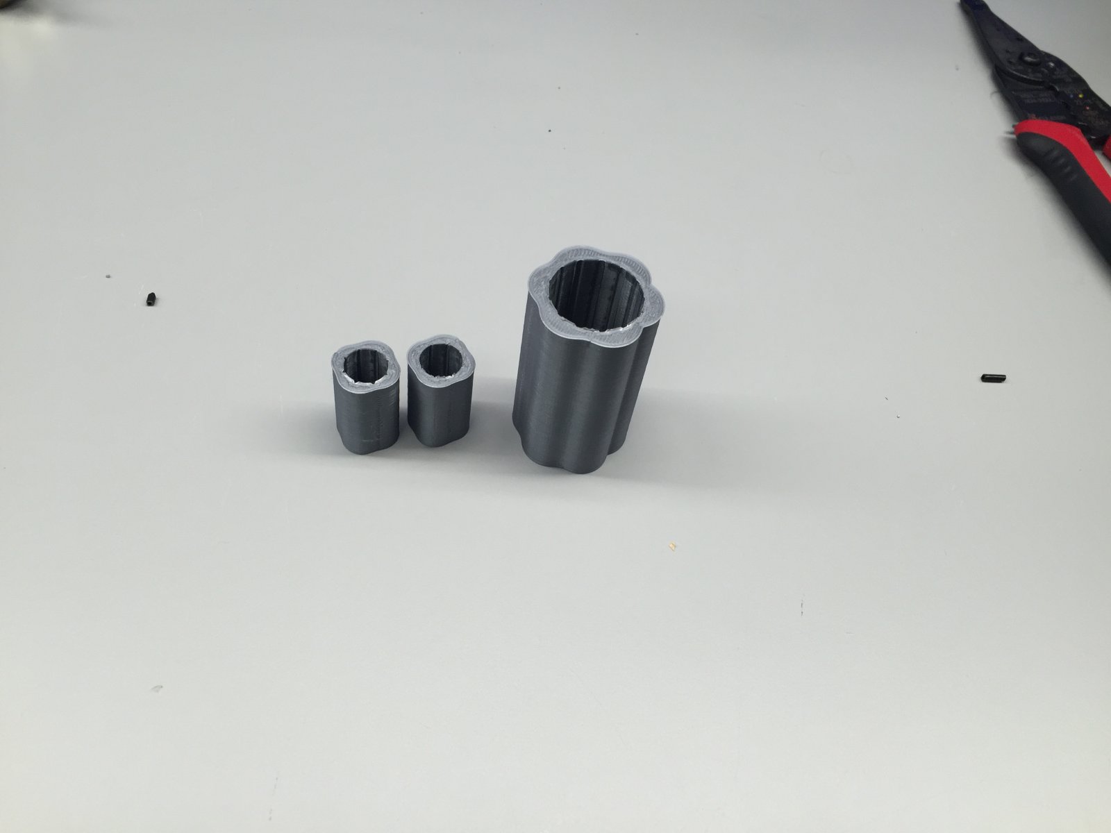

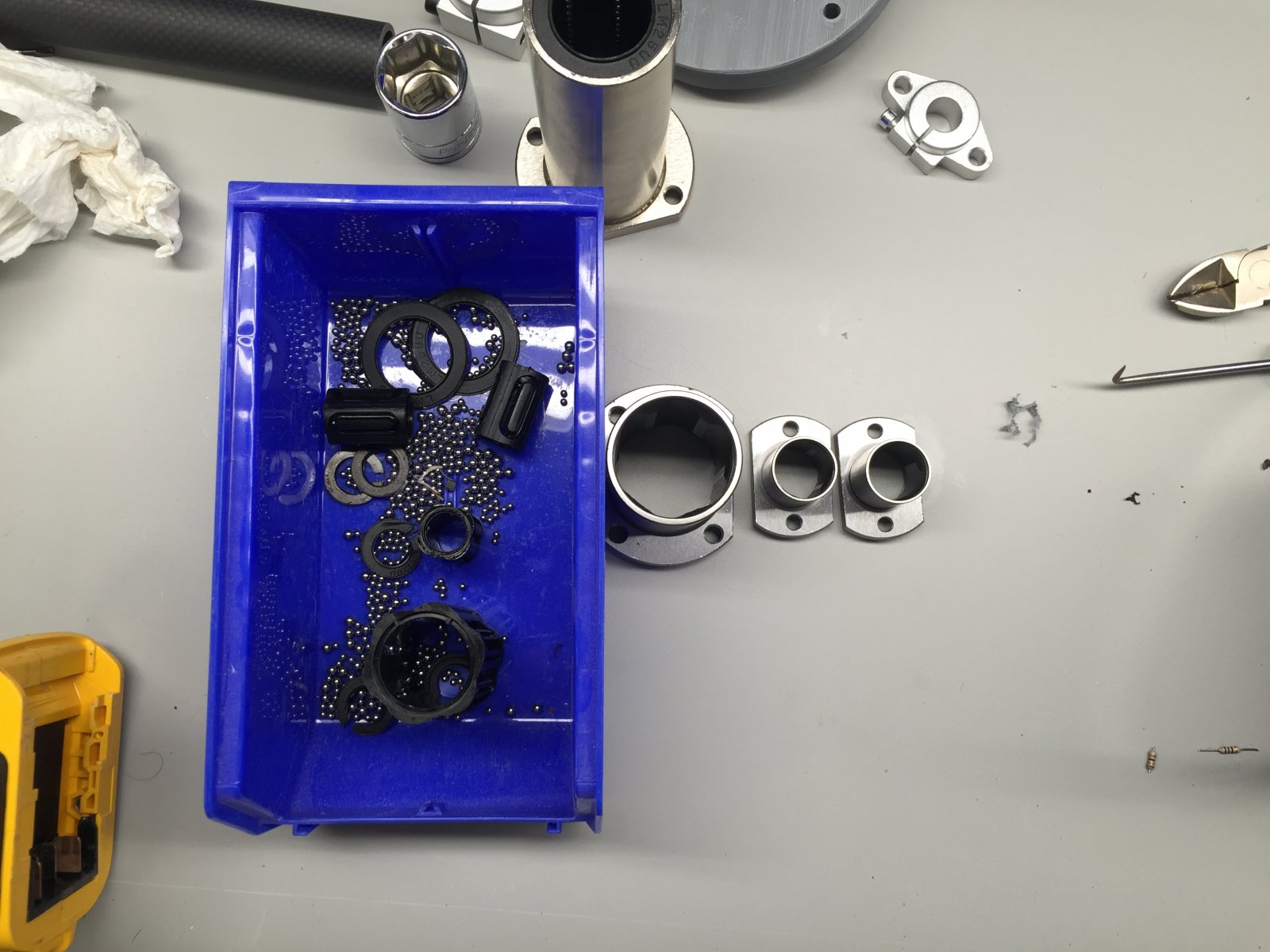

    So here is my theory, I purchased some cheapo Chinese flange linear bearings and I want to replace the guts with a custom printed bushing. That should bring the cost down significantly over the complete flange bearing direct from IGUS, but I still get all the benefits of the IGUS material.

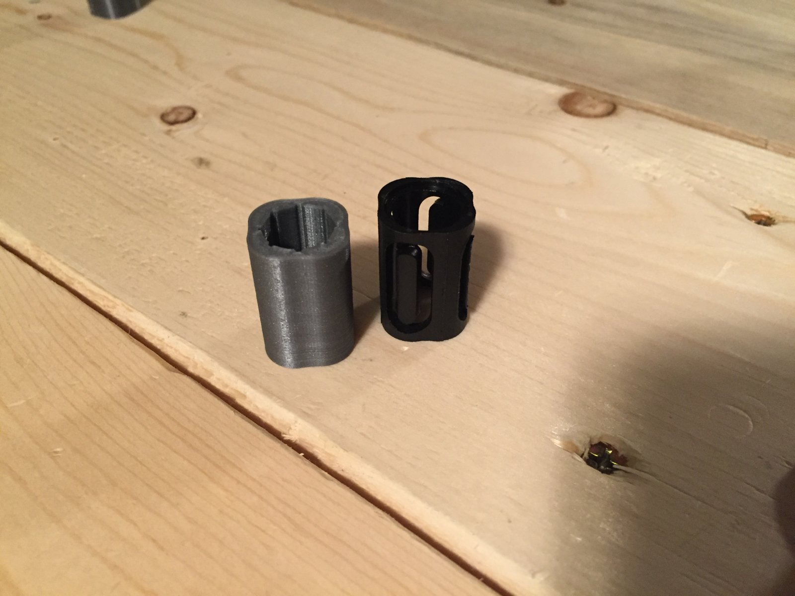

    The first thing I had to do was dissect a Chinese bearing to see what the guts looked like.
    This is a double bearing, notice the wiper seals are actually molded onto a type of snap ring that holds the cage in place. its pretty difficult to disassemble these without destroying the wiper seals.
    I measured the little bearing cage and did a little 3d modeling and printed up a part out of PLA, it took a couple of tries but I was able to get the dimensions pretty close. I actually went on the IGUS website and downloaded the 3d model for the 12 mm linear bearing and copied the inside profile over to my custom part, so now I have the same inside dimensions as the igus bearing.
    Here are the actual bearings that will be used in my actuator disassembled and ready for new bushings.
    And the new bushings ready to be inserted. These are still PLA for now, I want to get the design perfected before I use up my sample material.
    I ran my carbon fiber shafts through each bearing and they were a little snug at first and then loosened up nicely, I suspect that the pla will wear very fast though based on how easy they loosened up. I am using my bench vice to press these into the housings, so no retaining clips are needed. Also the tolerance on the carbon fiber is not nearly as tight as a linear shaft, I can actually feel the high and low spots throughout the shaft when i run the bearings across them.

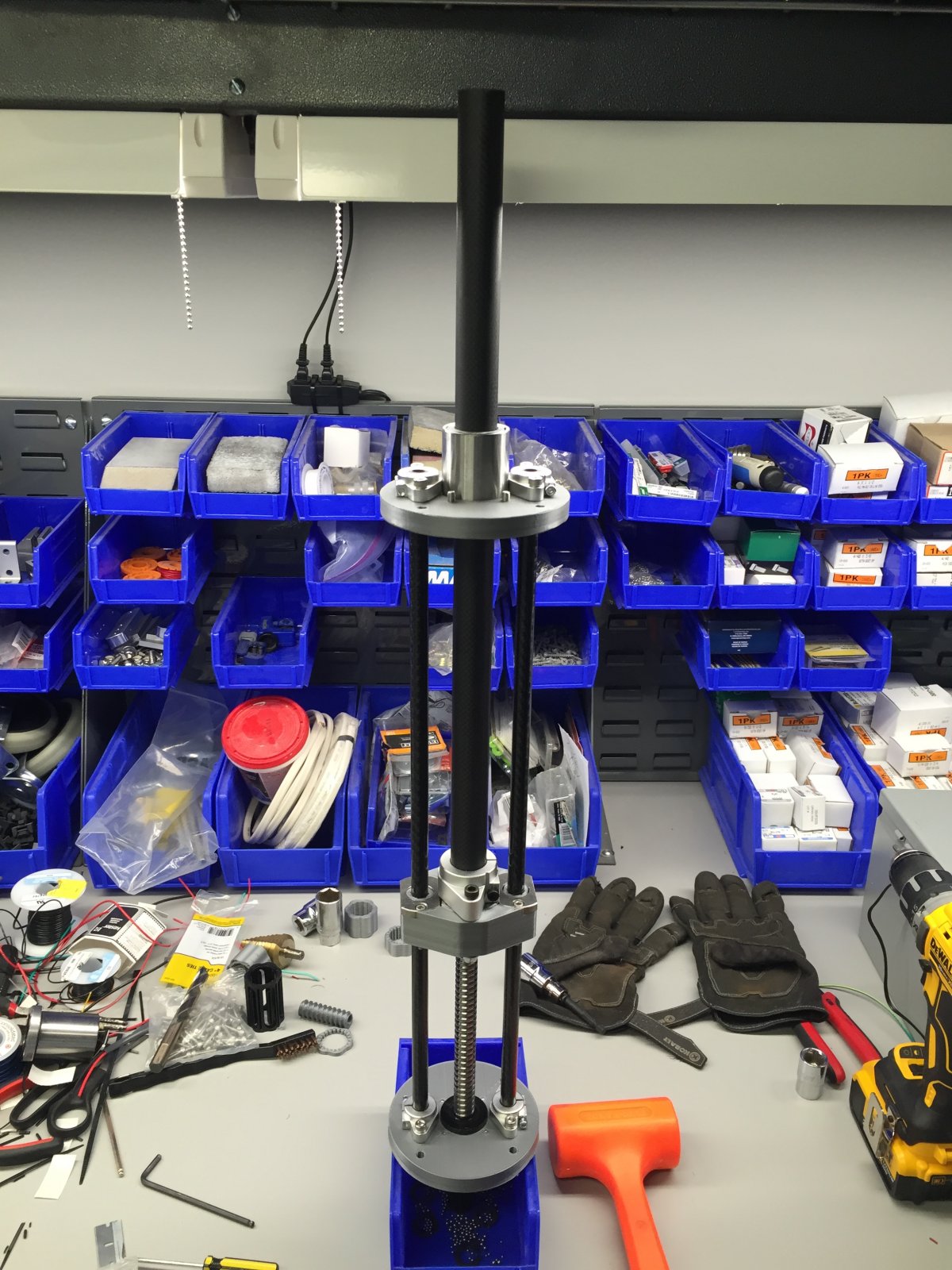

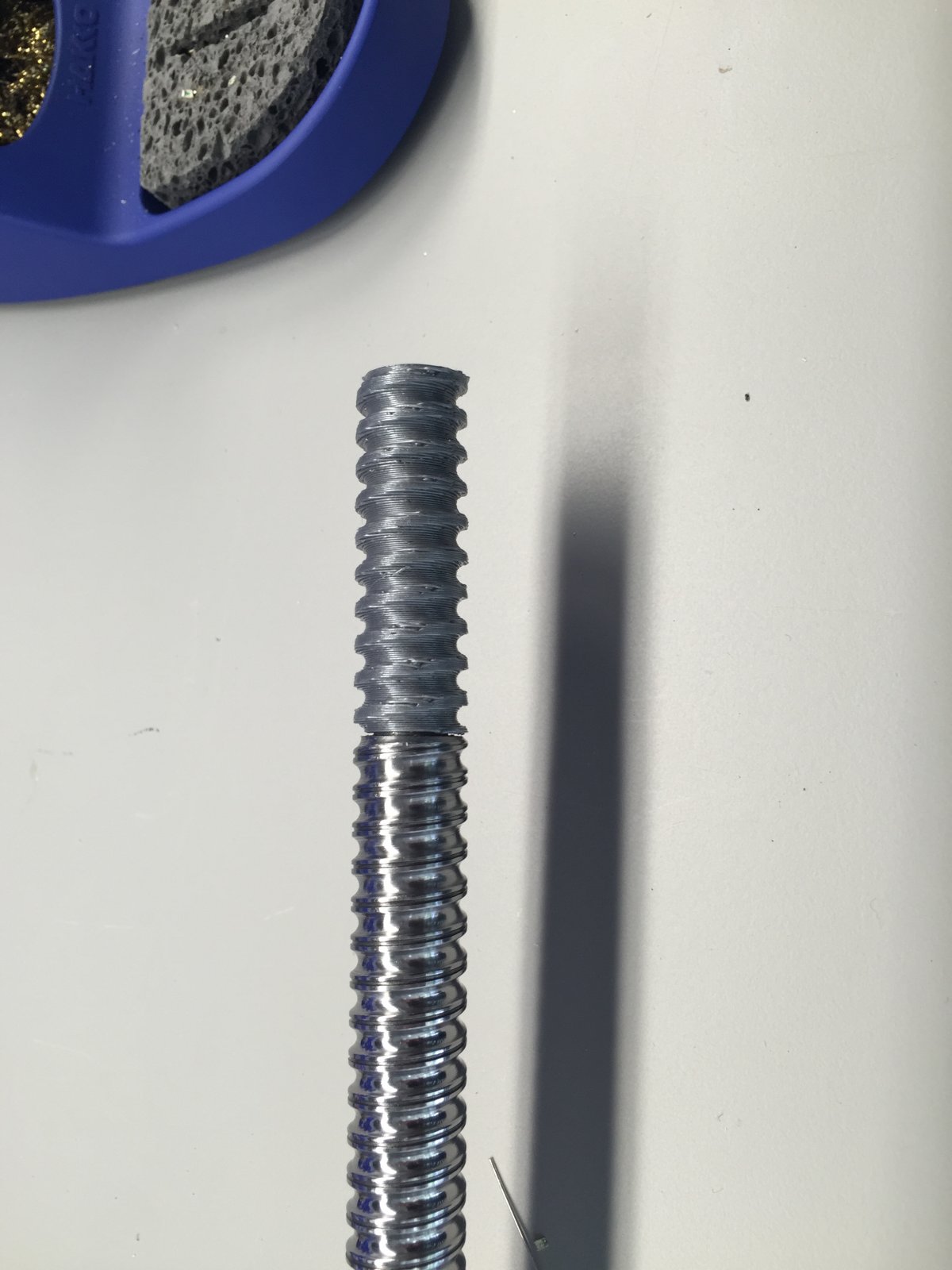

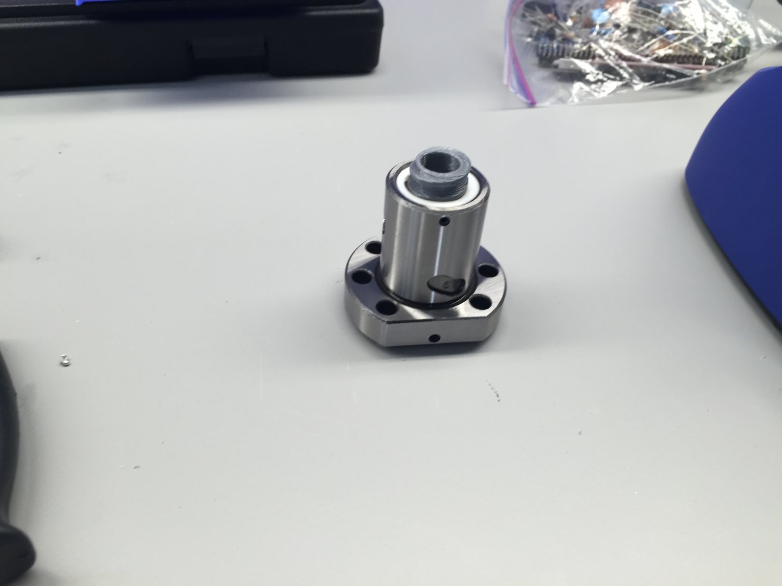

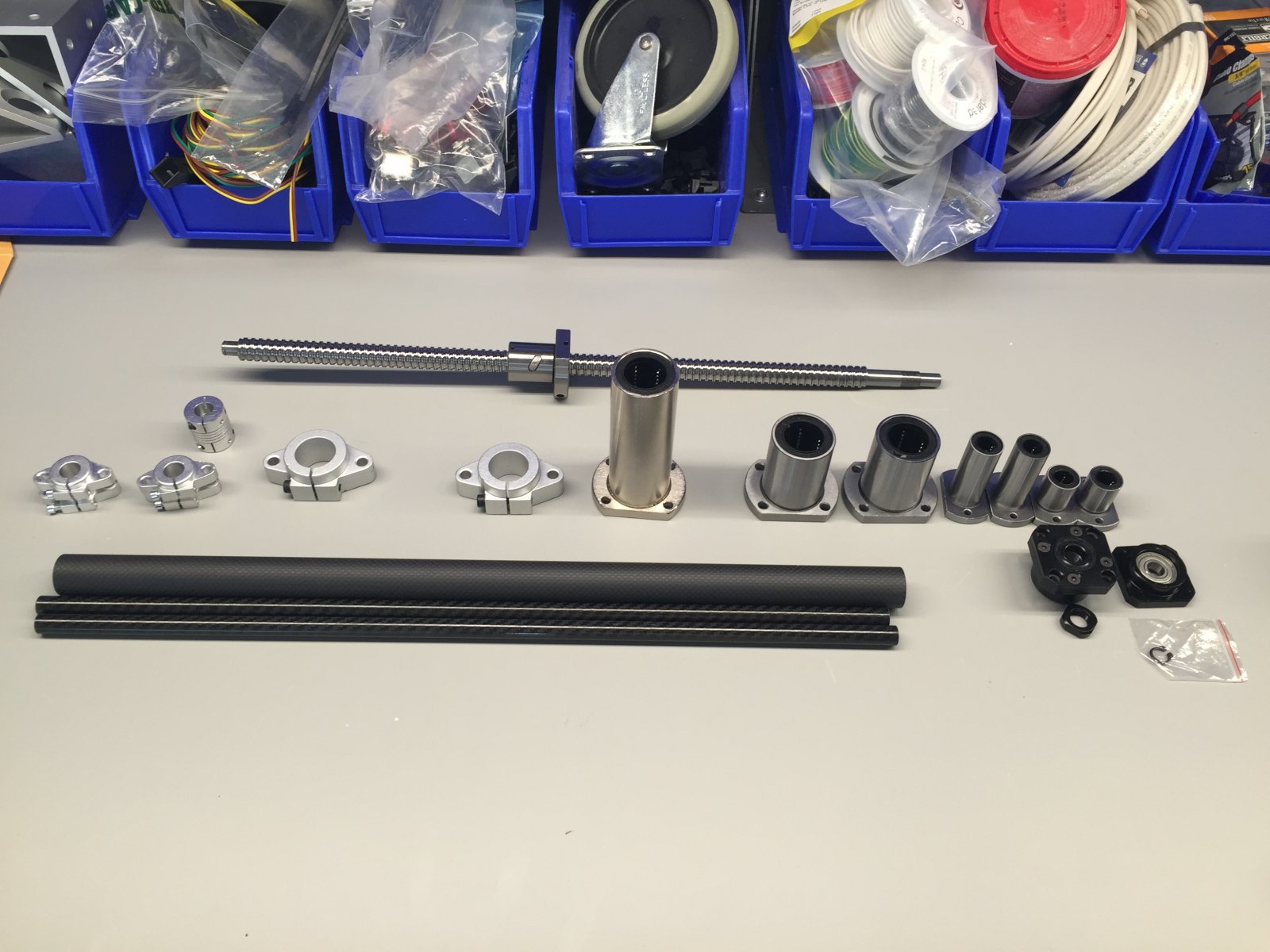

    on my actuator design I need to flip the ball nut around, so I was digging for a piece of tube or something to keep the balls lined up and it hit me. I quick printed off an adapter that matches the ball screw so no more worrying about losing the balls. I printed this at .3 as fast as possible so it looks a little crappy, but it works great.
    I was able to easily remove the nut and re-position it.
  17. Hoddem
    Hoddem Well-Known Member
    Sep 27, 2016
    404
    Engineer
    Minnesota, USA
    3,343Coins
    +717 / 2 / -0

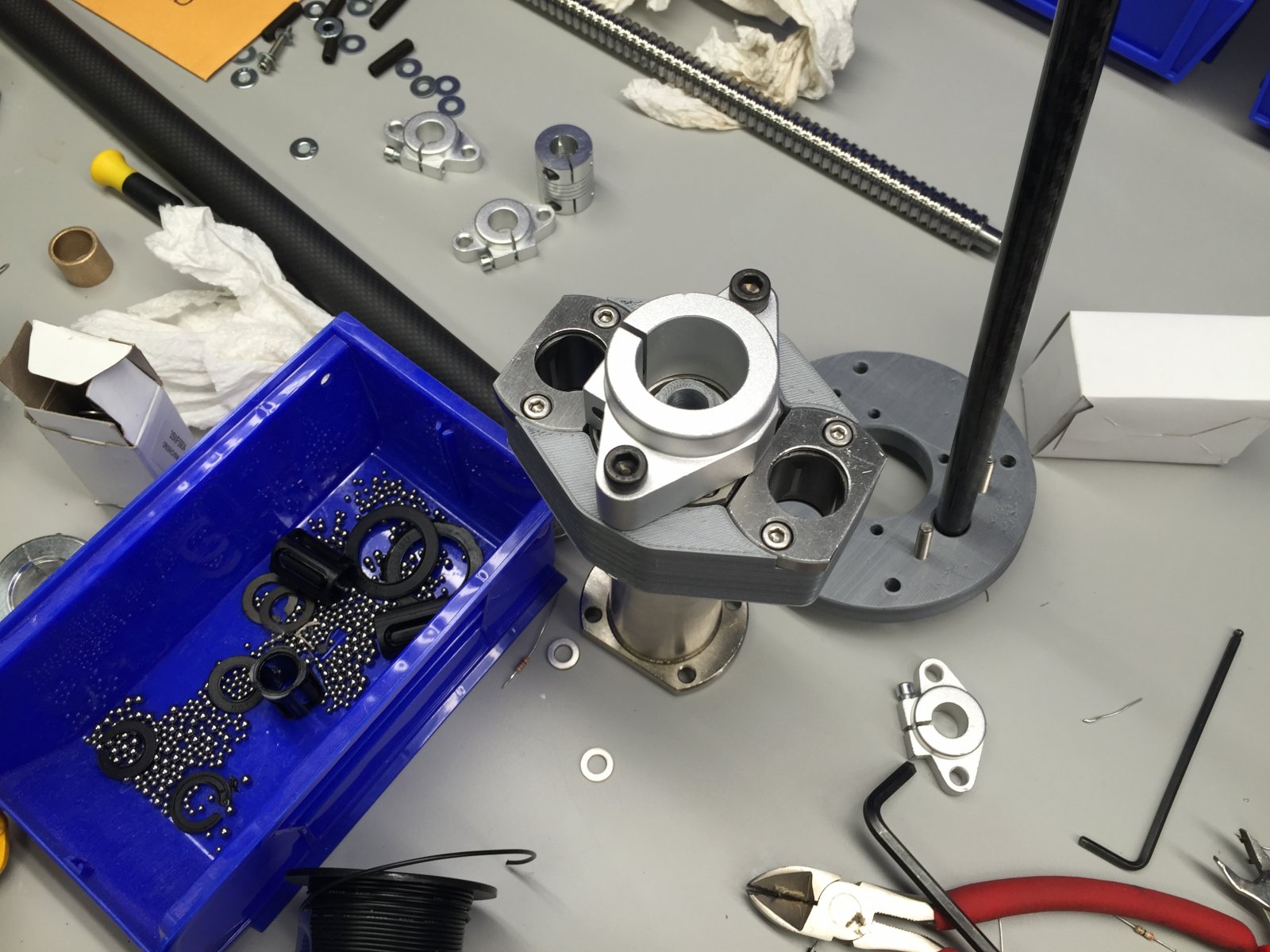

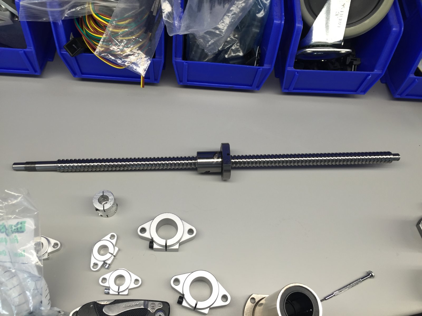

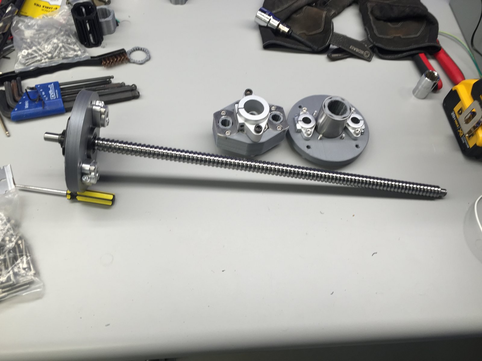

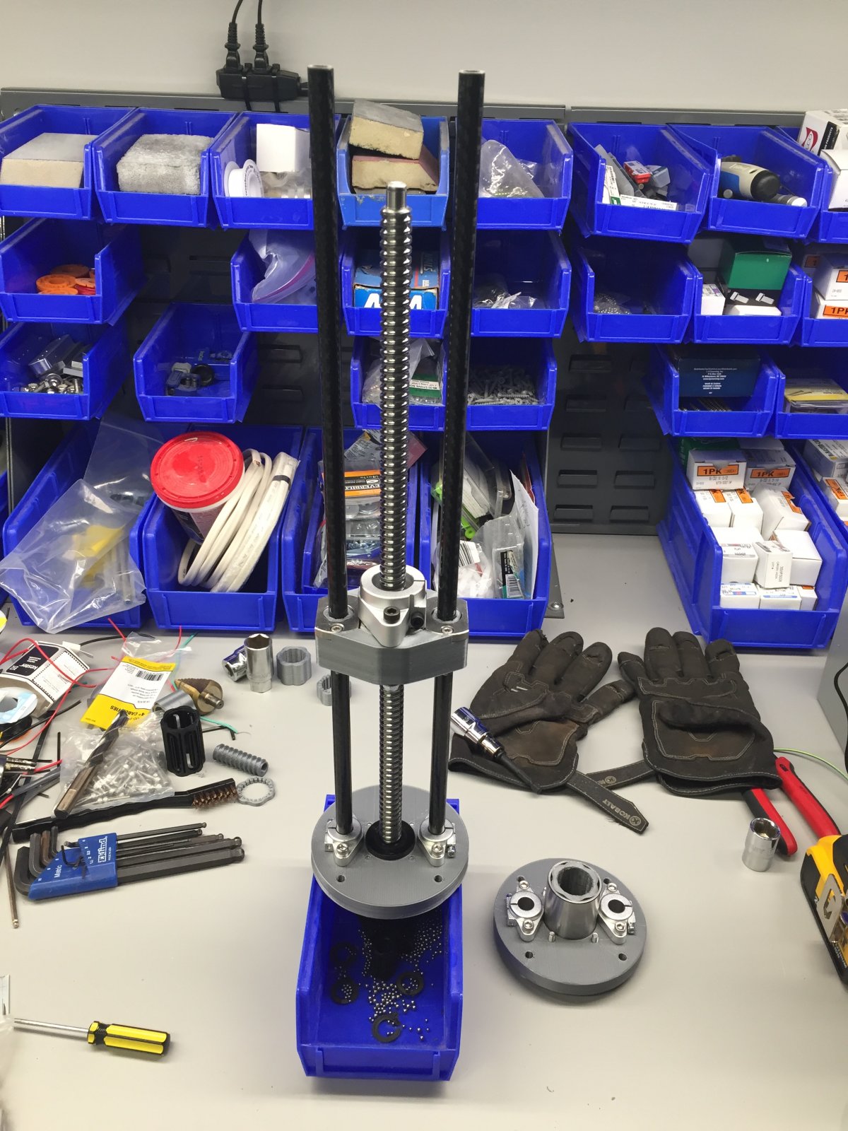

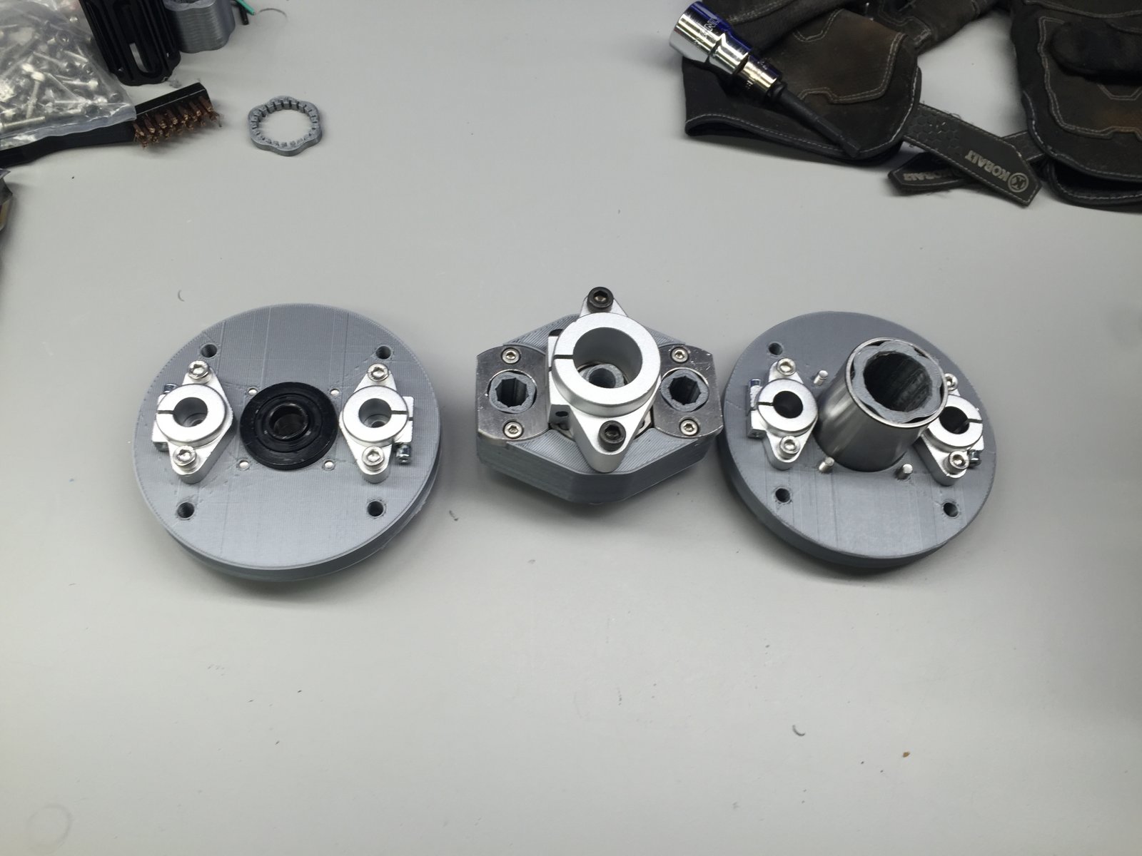

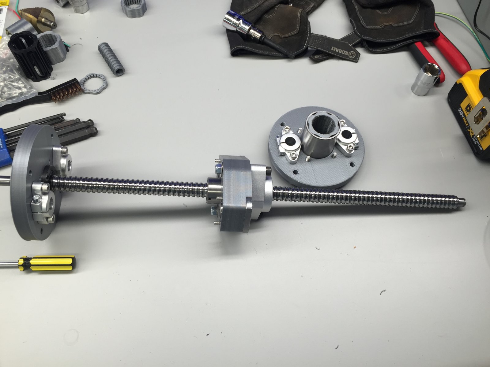

    So I started assembling the guts of the actuator, I had finished the 3d printed parts a couple of weeks ago.
    Here is the ball nut mount with the ballnut and the two 12mm linear bearings (just the housings at this point).
    and the 25mm shaft clamp that the carbon fiber rod will mount into.

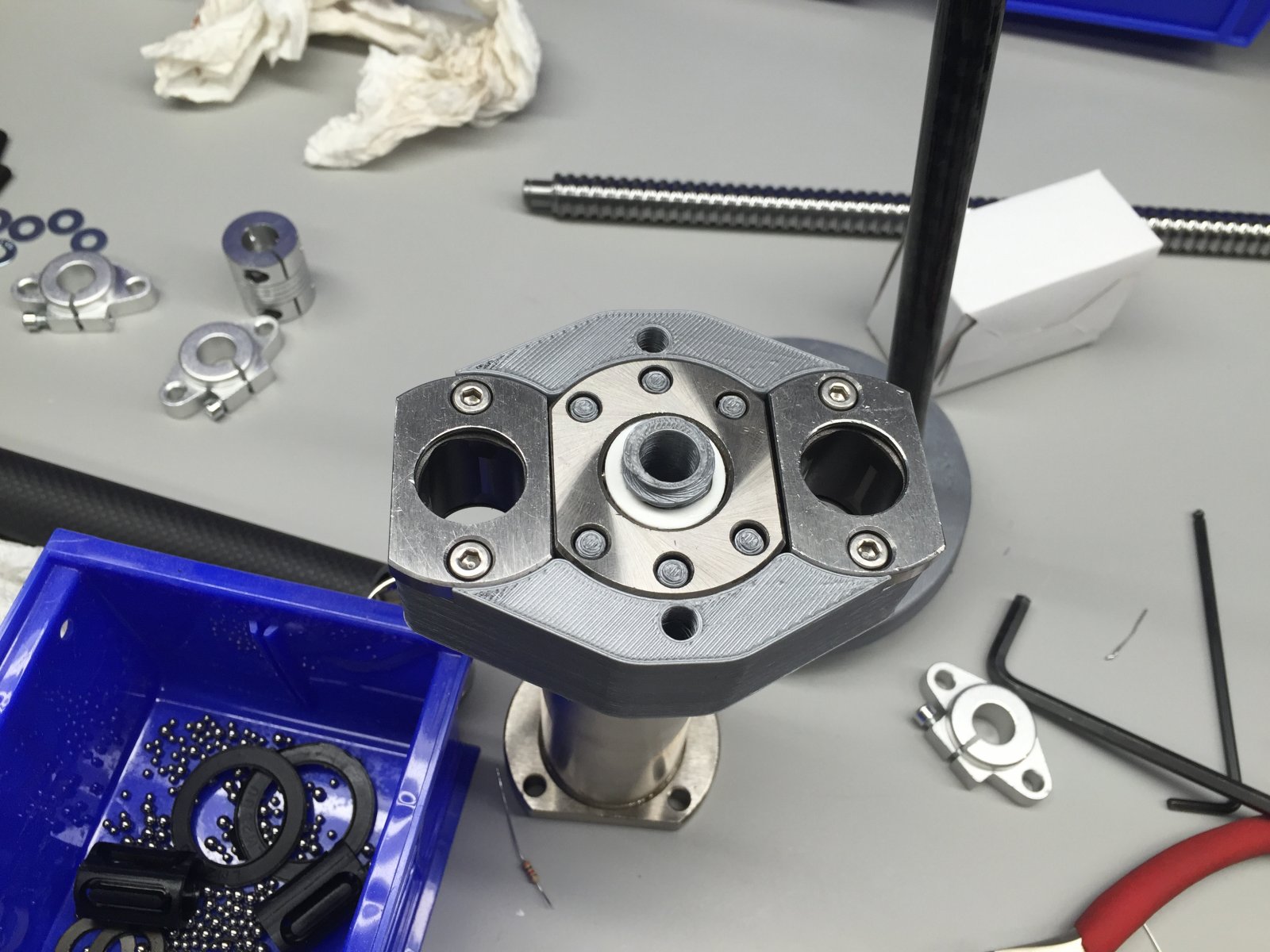

    I mounted up the parts for the upper an lower plates and then began assembly (the bushings have been pressed in at this point).
    2017-06-05 09.22.54.jpg First the ball screw
    then the ball nut
    then the 12mm shafts

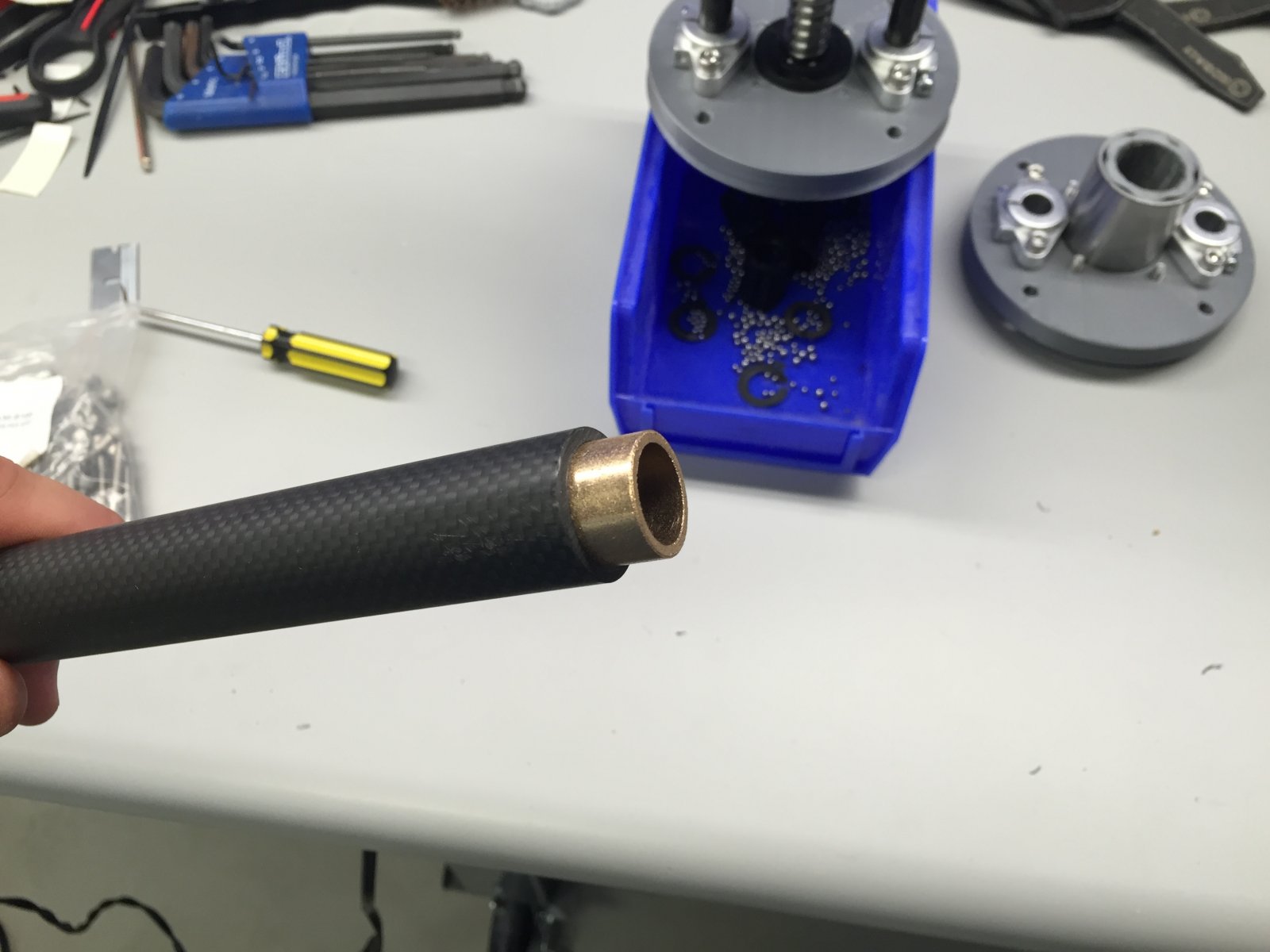

    Then I inserted the 25mm carbon tube, but before I put it in I added a bushing to the end that will be clamped to give a little more rigidity. It was a snug fit, but not overly tight. the ID of the bushing is 16mm so it matches the ball screw, well see if this causes any issues in the future. also I may add a little bushing the the end of the ball screw to prevent any potential whip inside the carbon fiber tube, If so I will print it out of the same J260 material.
    And here is the finished assembly, of course I don't have any pvc pipe on or any of the threaded rods.
    I grabbed my cordless drill and ran a few strokes, everything was very tight the first 2-3 passes and then It loosened up and ran pretty smooth. I am pretty amazed at just how strong the assembly is without the pvc or threaded rods. Of course I still need to get the motor setup, but this will give me enough to do some preliminary testing with my drill. Also I have a pretty cool Idea for how to test this with the pvc installed and still be able to see whats going on inside.
