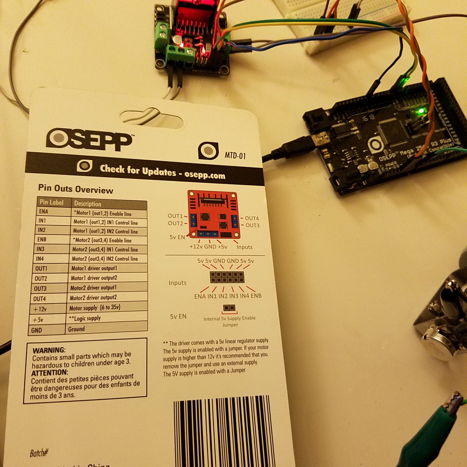

    I made a youtube of my blathering of commentary. I good bit lost on this one. did try 2 other brand new motor drivers, no go on each.

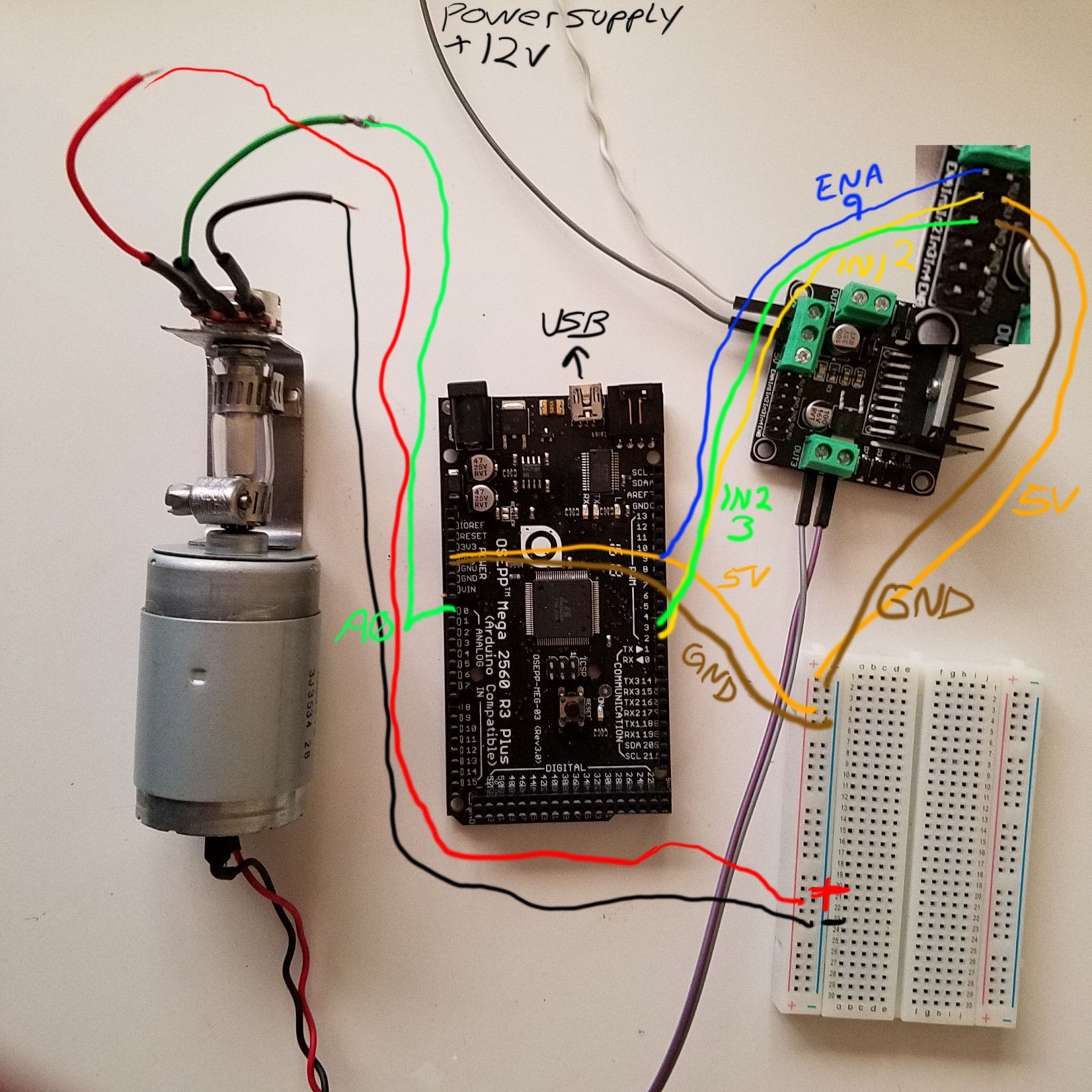

    I suppose the only thing now is if you could supply us with a diagram to exactly how you have the connections going from the arduino to the L298N.
    So not a diagram that you have followed but if you could draw it out, pin to pin exactly how it is shown in the video.

    attached my photochopped bit on the wiring. For the code, I have only commented out Mode 1. Never did try Mode 2.

    I would expect MODE1 is correct if that's an L298 Dual H-Bridge board?
    The arduino is obviously communicating to the PC ok because the feedback line is working.
    The wiring between arduino and h-bridge looks ok (again assuming an L298 h-bridge)
    One thought, given the position of the pins on the h-bridge - should the motor be connected to the other side connector?
    If you can provide details of h-bridge of h-bridge circuit that would help.

    I cant seem to find the exact board that you have in your picture as it has a double row header strip next to the power inputs.
    The only other ones I have found have only had a single row header. If they are basically the same then yes the wiring looks fine except for the motor should be connected to the other side.
    Edit, Also the 5v line going to the bread board from the motor driver is redundant, you have two 5v lines going to the pot, one from the arduino and one from the motor drive.

    its an OPSEPP L298 dual h bridge driver MTD-1 Did just swap motor to corresponding side

    good point! removed that and tested, still not getting feedback to follow sine wave, nor motor to turn though.
