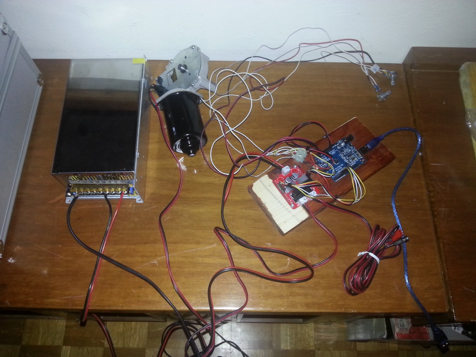

    have been very busy at work and I have not had time to proceed , meanwhile, put photos of electronics and a pic of 3d model of chassis , of course, are always being tested
    21,517
    150,722Coins
    +11,018 / 55 / -2
    Sorting the wiring out is a great start itself. I look forward to following you build when your work settles down a bit.

    I know that the wires are messed up xD
    but it was just a test , soon will build a container dedicated to electronics ! :D

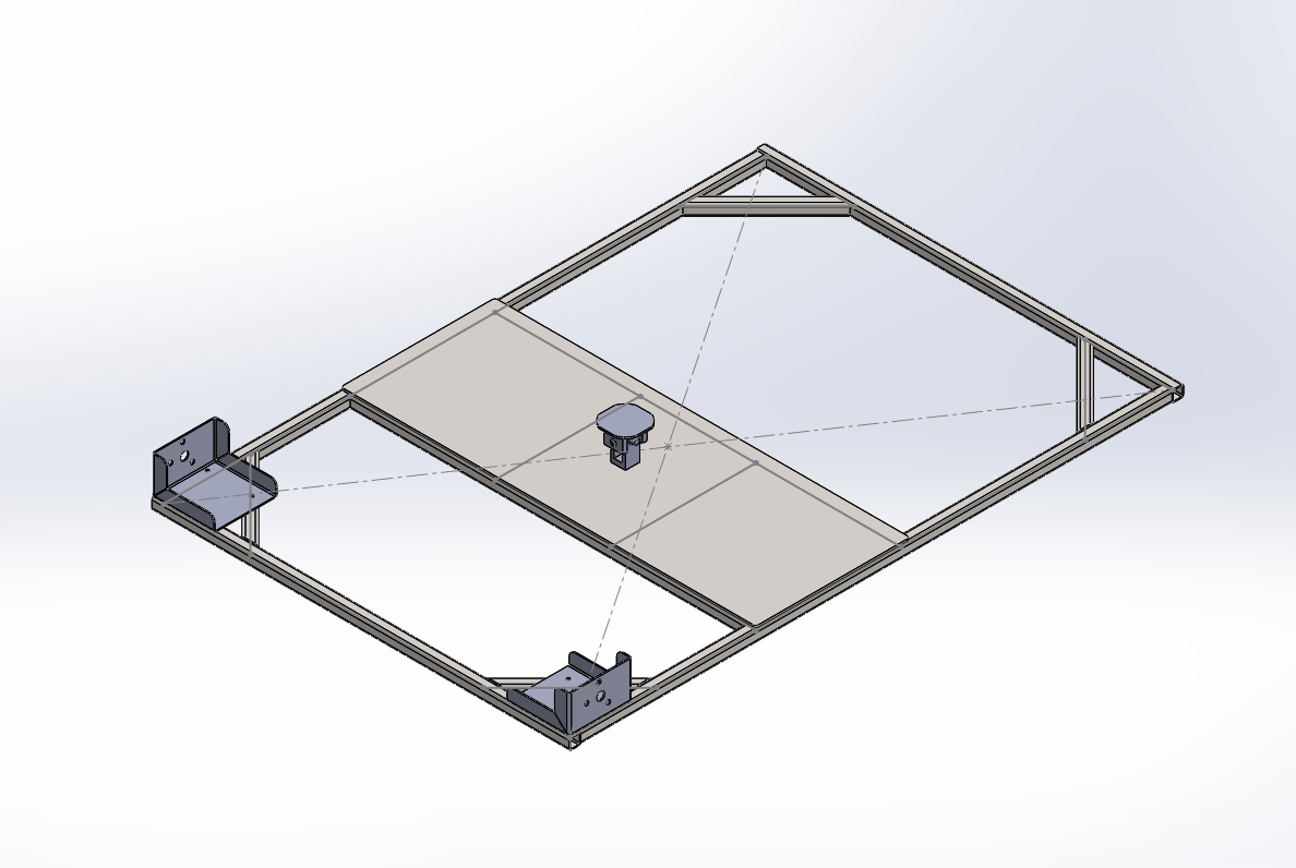

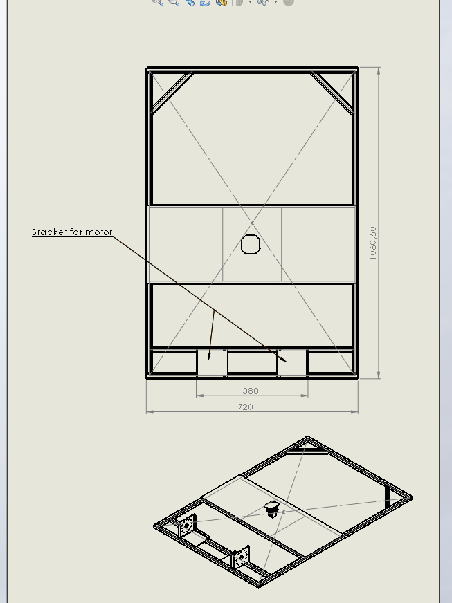

    I made a small upgrade to the frame, I realized that I had placed too far apart engines

    the length of the connecting rod by which the motion of the auction should be long ?

    I am not yet certain of your full design ideas @asdfgg so can you explain why you thought the engines needed to be closer together and what part of the chair frame do you plan on attaching the engines to for movement?

    I approached the brackets of the engines just because I have a seating position to use and I have taken as a reference to its width, the frame I'm doing it to get wider stability
  13. Nick Moxley
    17,056Coins
    +2,506 / 30 / -2
    the Wider and Further back the motor's are spaced, the less work on the motor's.......Just because you have a seating position as reference, means absolutely nothing in regards to motor placement. We really need more details on your project to advise you properly asdfgg.

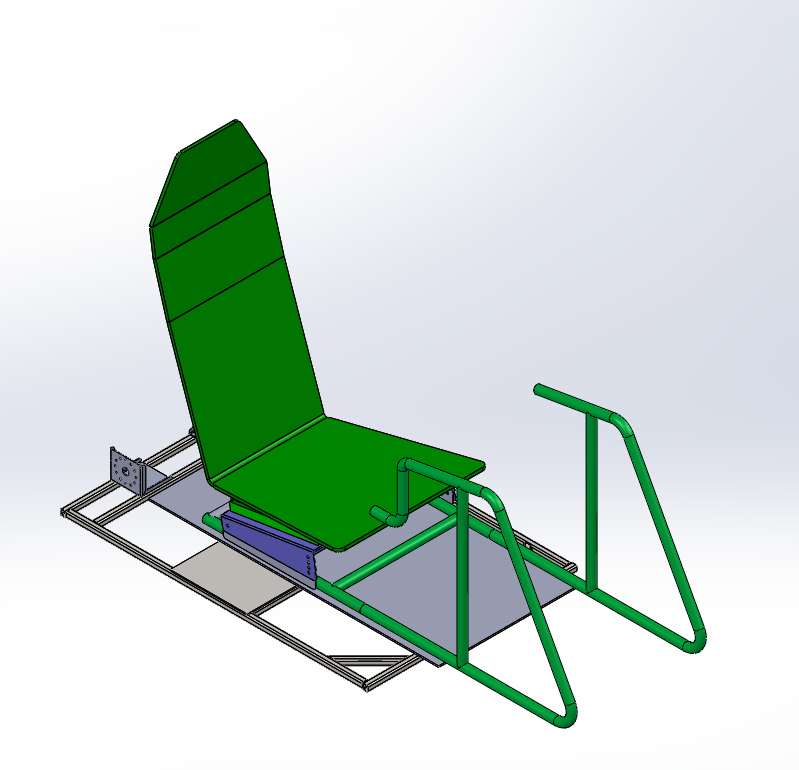

    I am following the guide of racing mat whit little changes,
    I put a pic wit dimension of my 3d model :)

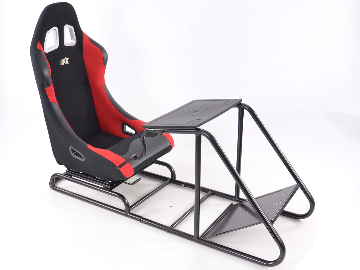

    I place above a seating position like this:
    I will create the bracket to fix the rods that will give the motion
    and thought I should bring the engines so that the rods are vertical

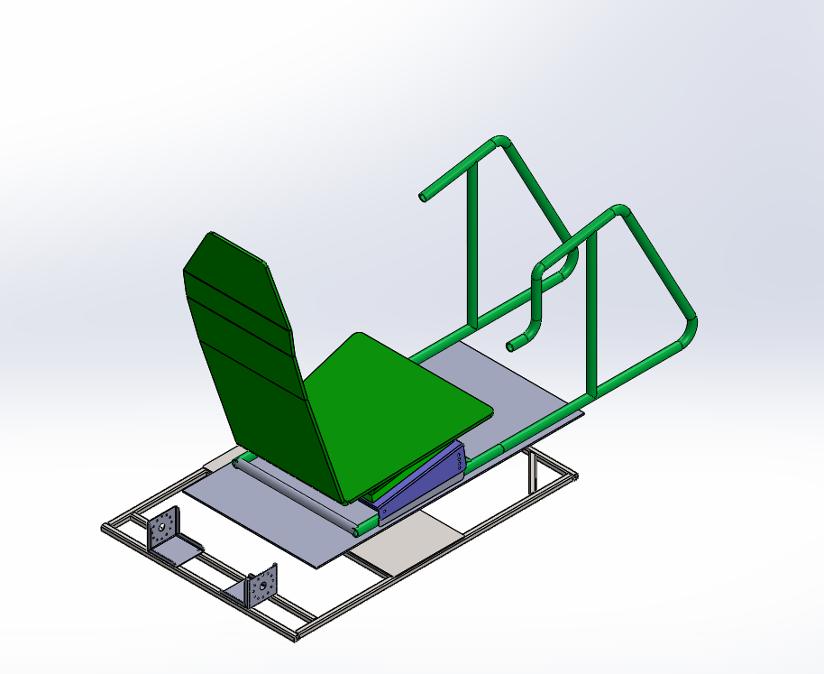

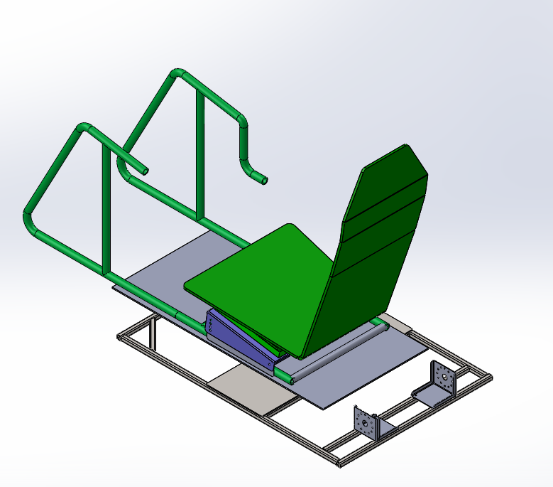

    some pic of 3d model (WIP)

    The MORE angle the MORE leverage the motor's have, Vertical arms will only hurt you in the end.
    you want it to look like this at minimum imo, YES it will work with less angle, but all your doing is stressing the motor's more.

    Thank you, so I have to put the engines where I had planned before?

    Yes it would have more leverage where you originally had placed the engines @asdfgg. Also take care to balance the upper frame with all gear and yourself on it.

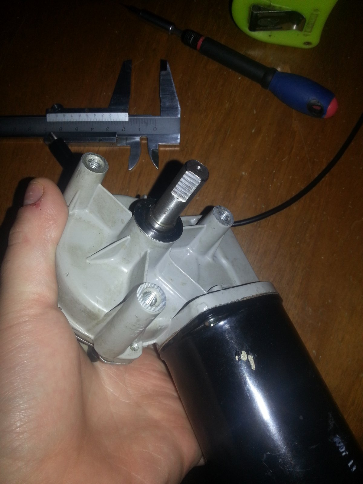

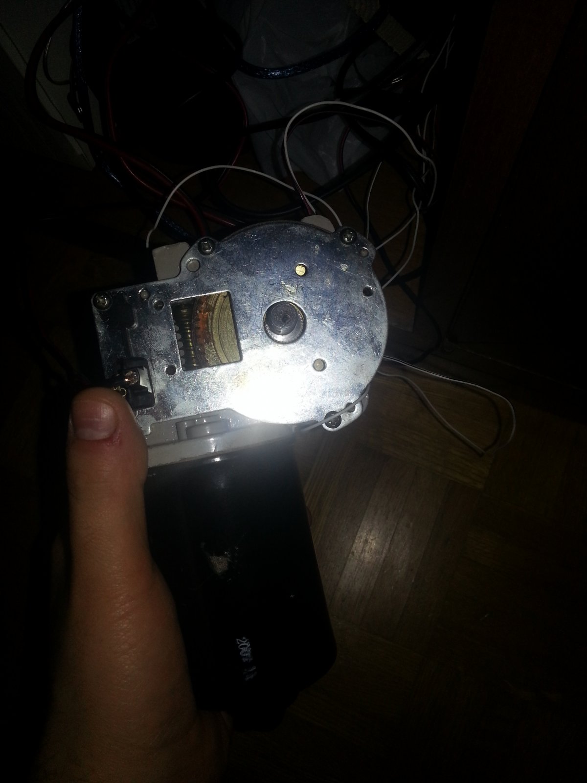

    I have a little question,I have these engines with this axle how would set the potentiometer ?
