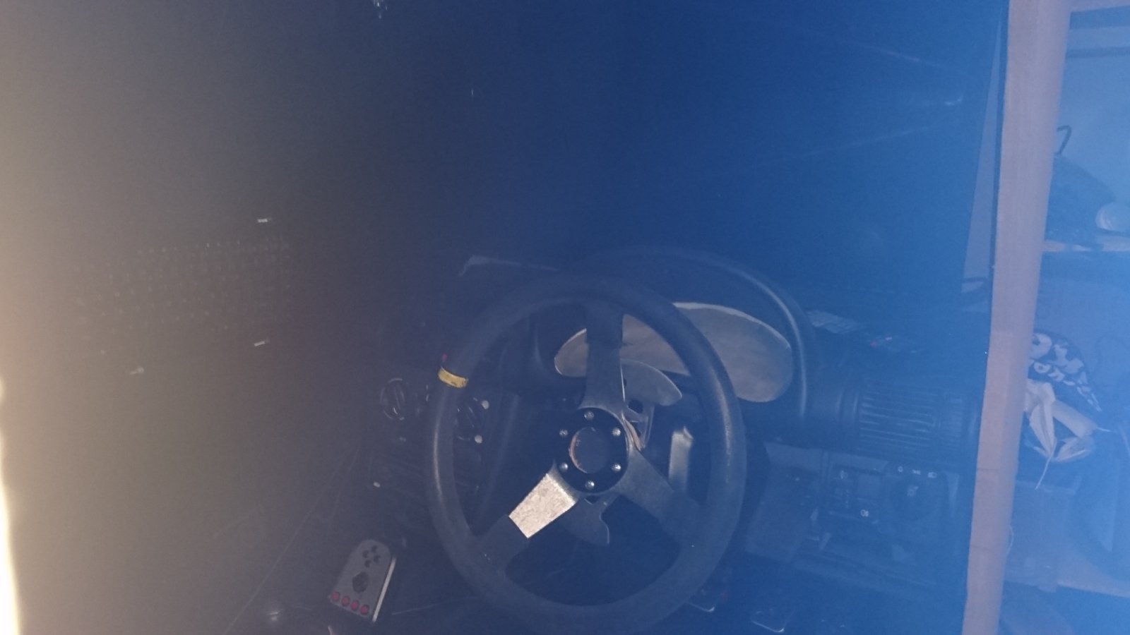

    I'm only going for a very basic build as it's my first motion sim I've got this at the moment but would like a bit more feel

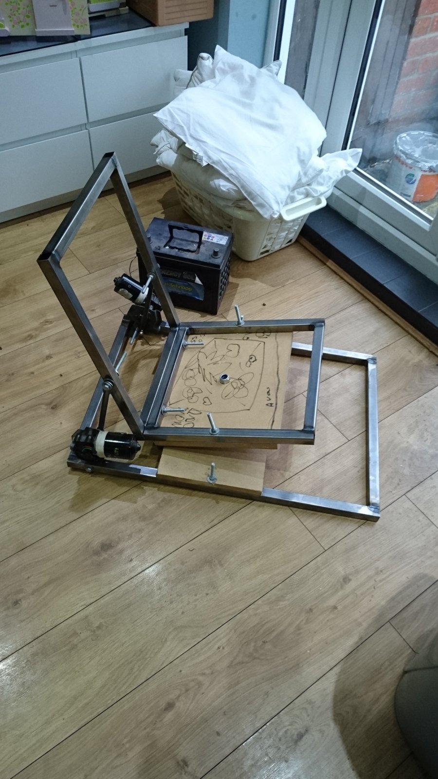

    Frame built now just a bit more tinkering thanks all so far so good I think

    You have a limited amount of leverage with the motors mounted so close to the seat and with the rods attached so low.
    Keep an eye on the motors when loaded, as I expect they will get pretty hot fairly fast and may struggle with the load.
