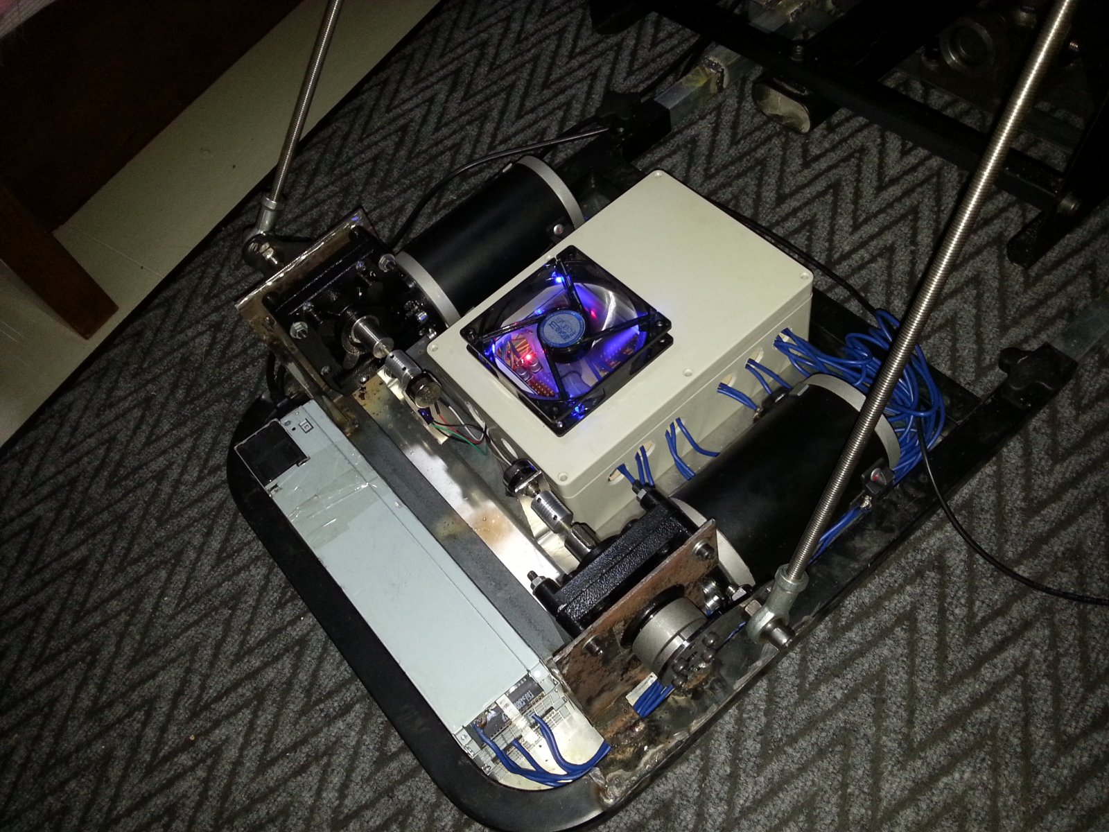

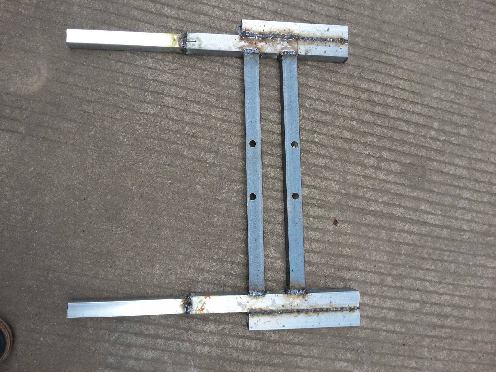

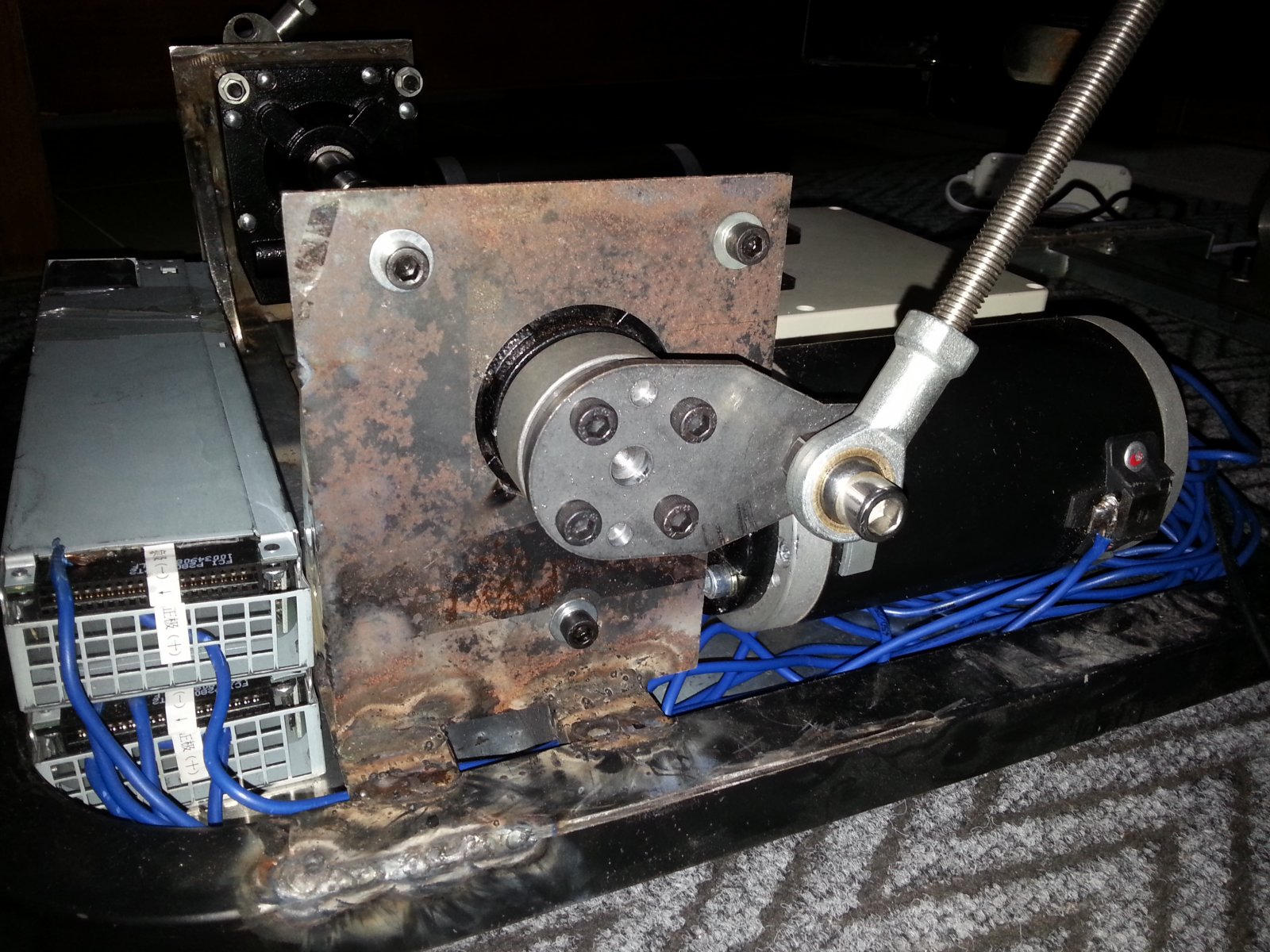

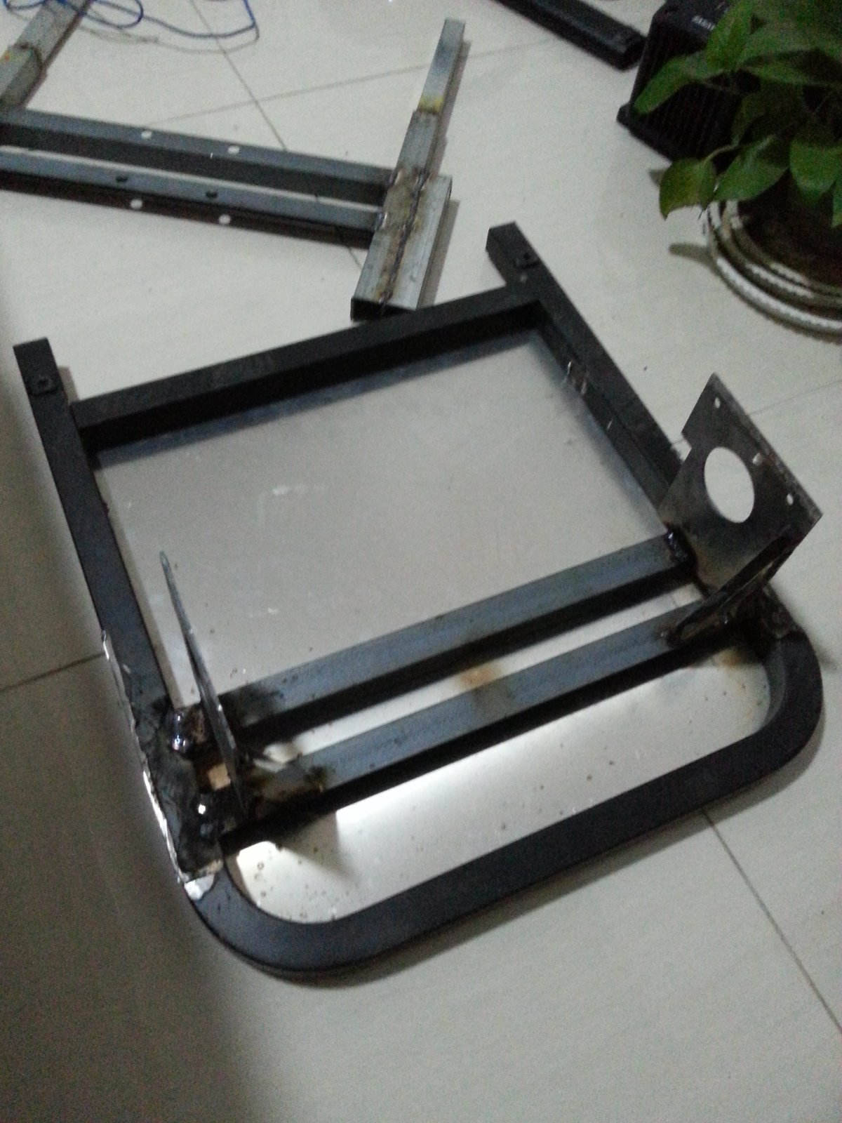

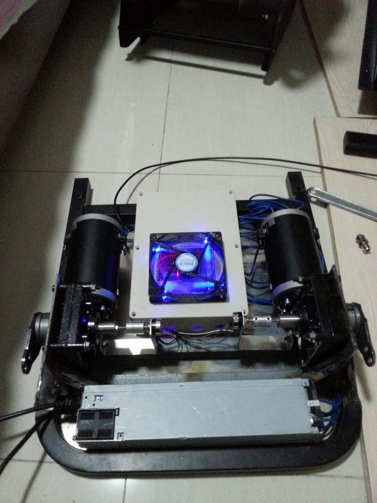

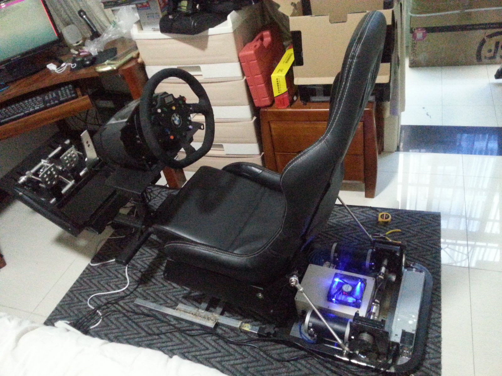

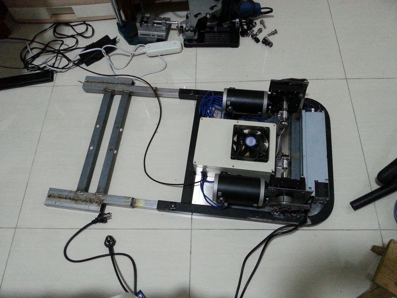

    HI, everybody .Im from China and i would say thankyou to everybody here .one day when i walk into a shop i see a motion platform and i played it ,it made me feel so nice so i began to search information about the simulator .

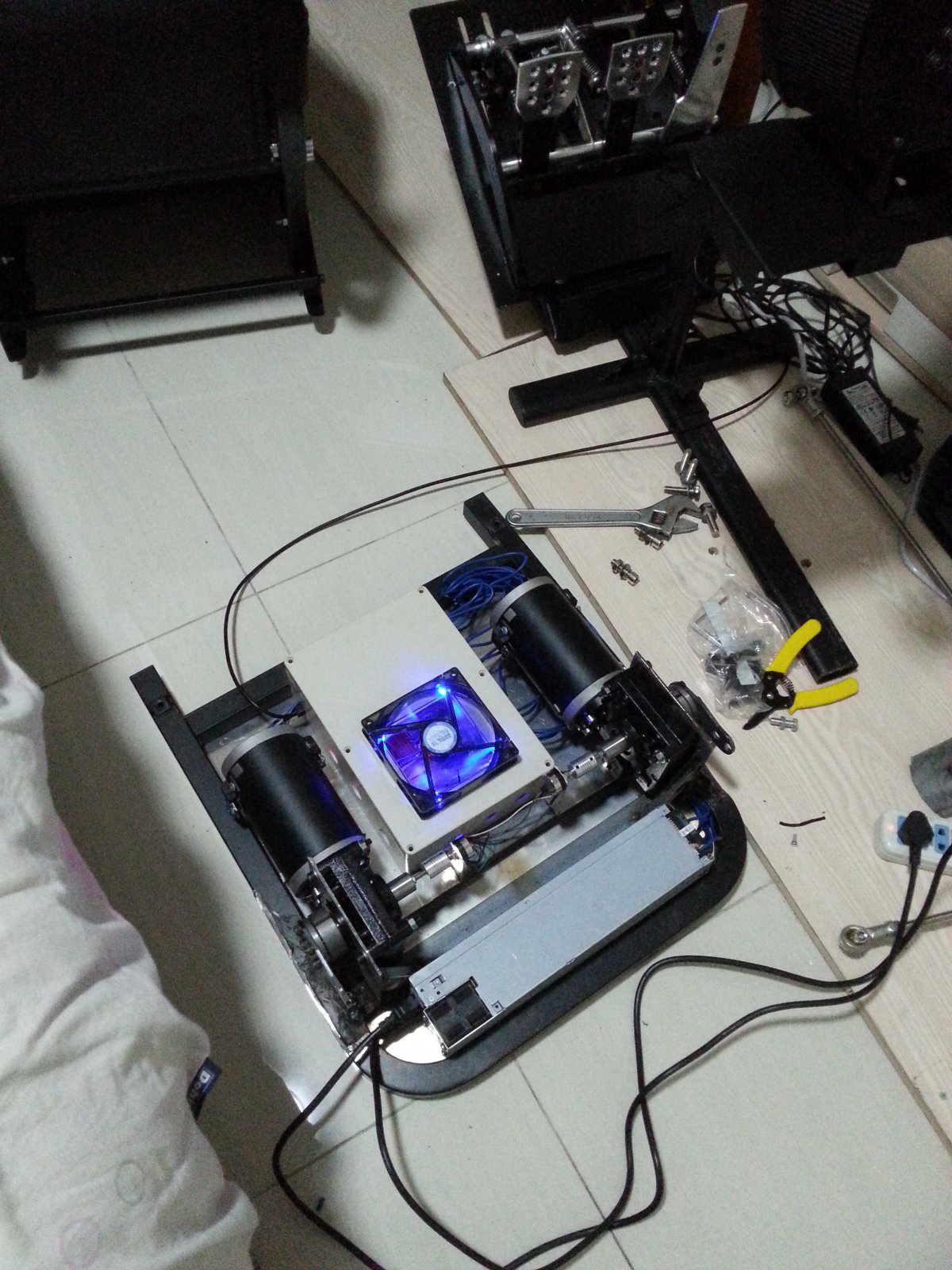

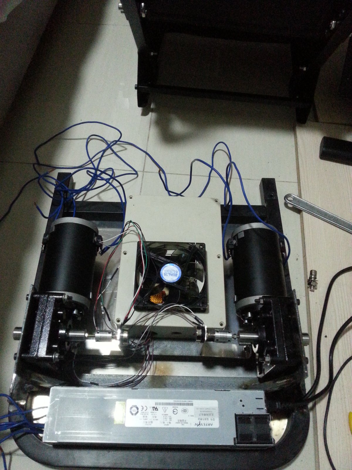

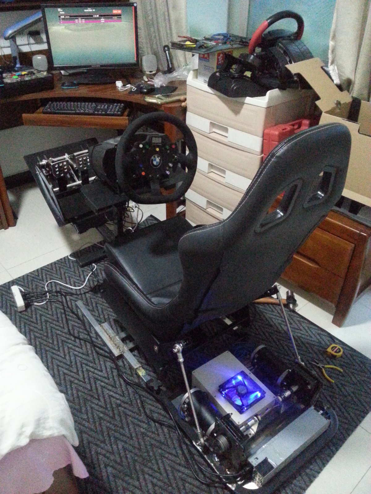

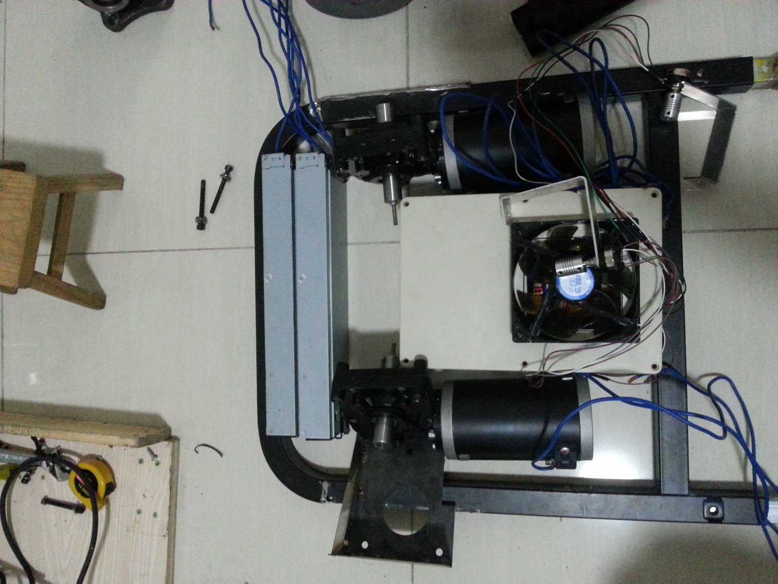

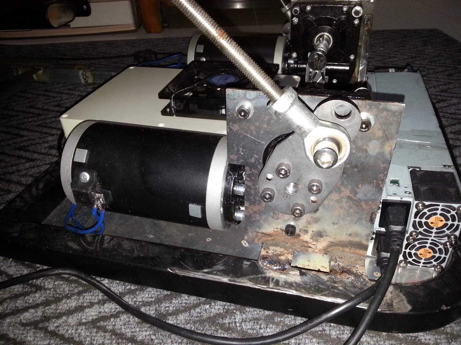

    I found this forum about two months ago,i read a lot of threads and FAQ on the forum,finally i build a 2 dof platform with two 360w worm moto by myself,it works very good but only a little problem ,that is when i crash my car badly in the game ,the right side of my moto will stop moving ,it stops at the largest angle below the normal position. the control part is arduino+2*monstermoto,smc3 codes. could it be the monstermoto works abnormal?

    Nice job, I really like that the design lets is be dissembled easily, yet keeps all the motors, PSU and boards in one part :thumbs
    When you get the chance I and others would really appreciate seeing a video of your rig in action.

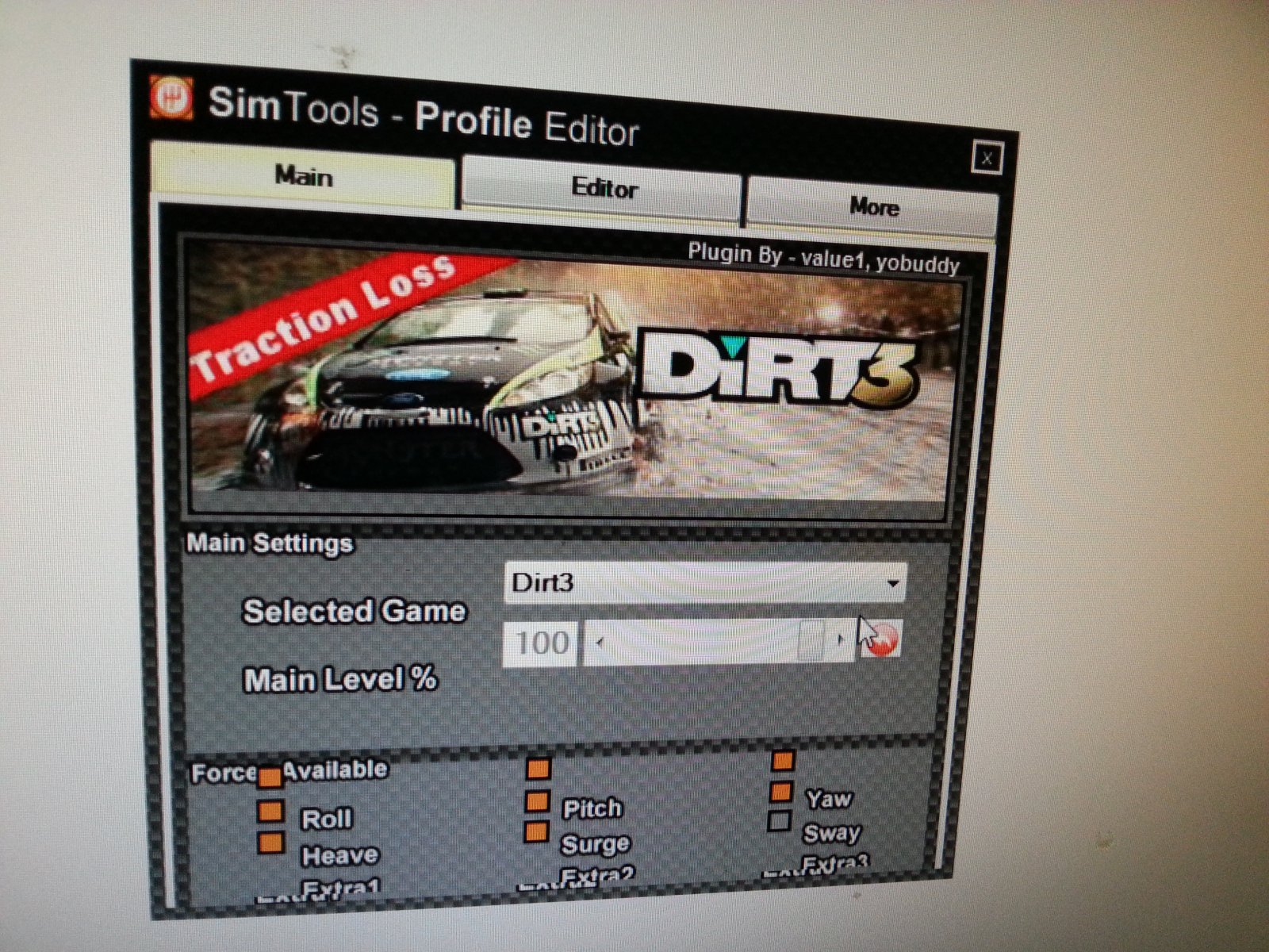

    There can be a number of causes for the right side shutdown but you could try lowering the Main Level % to around 97 in the Profile Editing button of Game Manager.

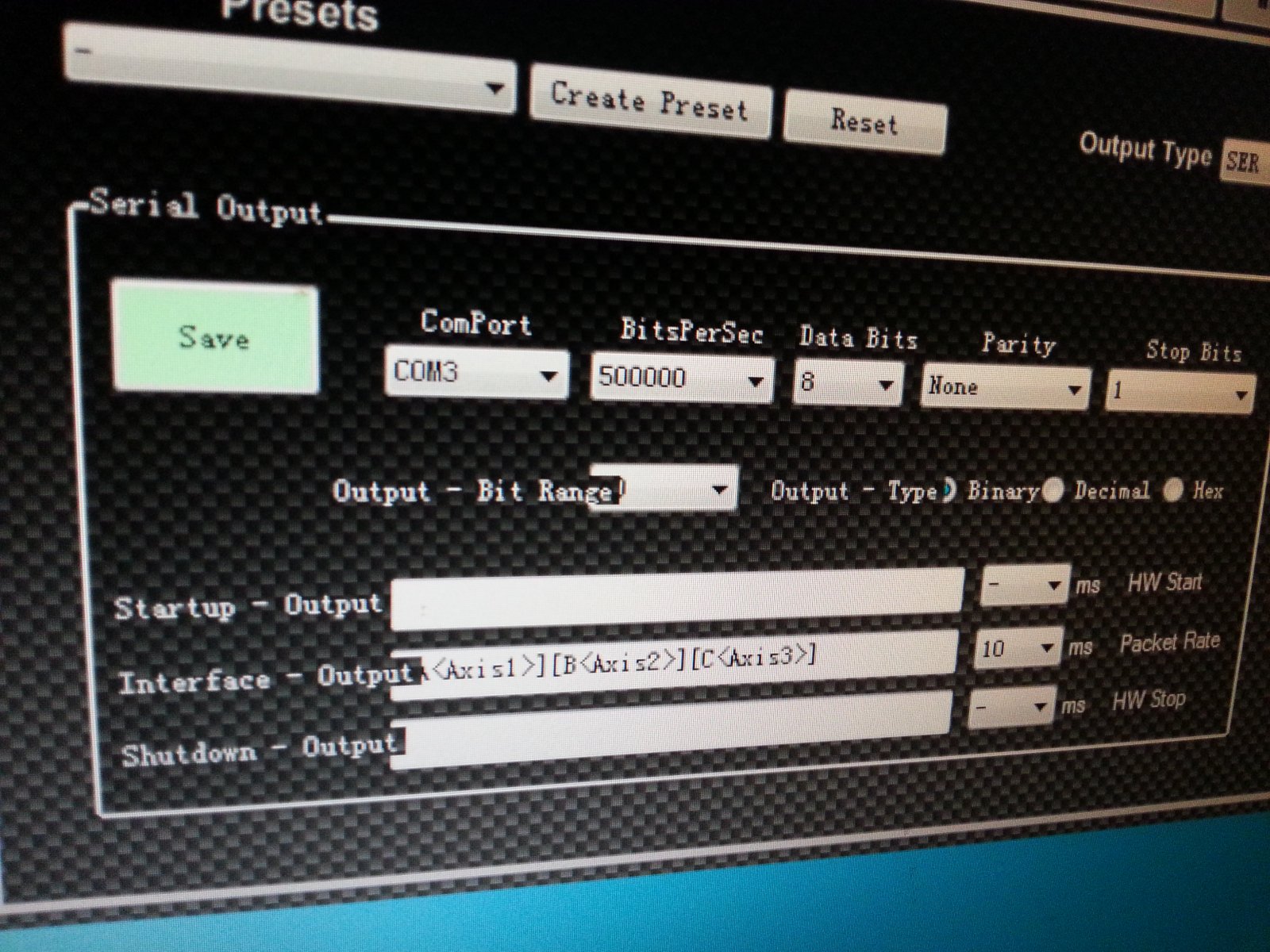

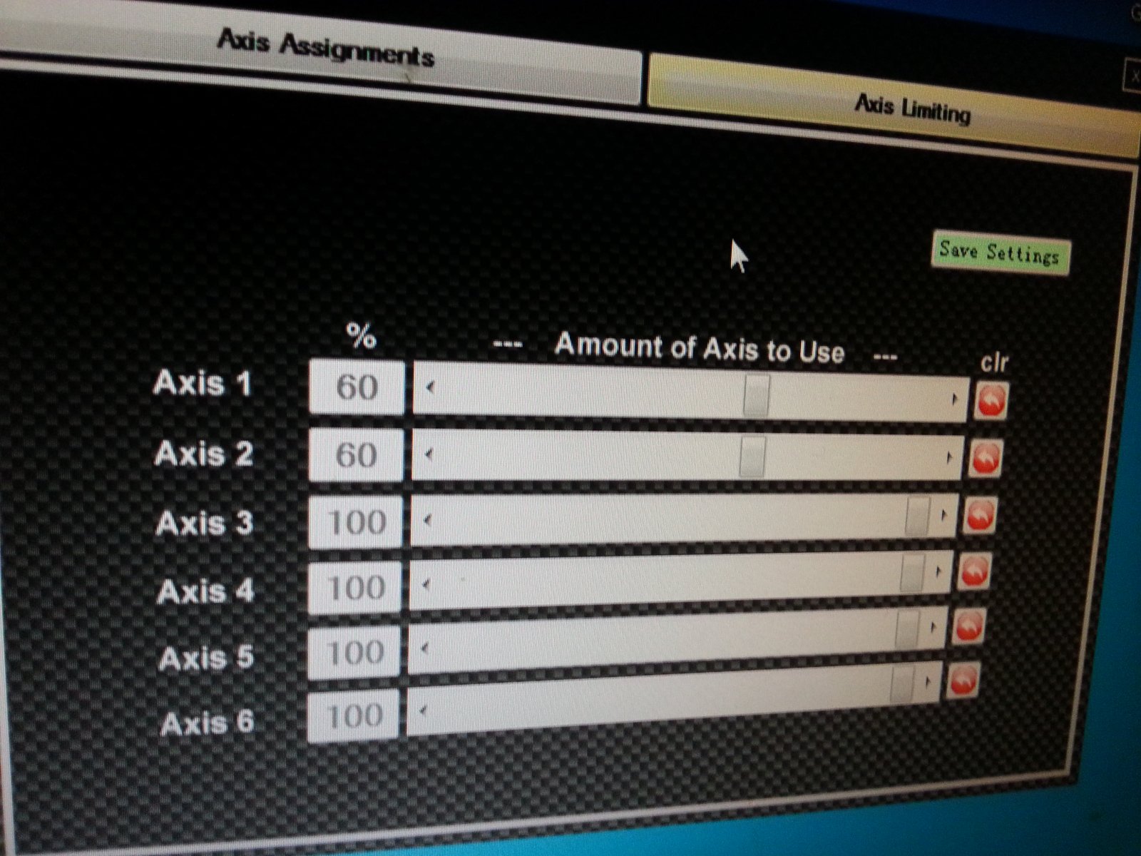

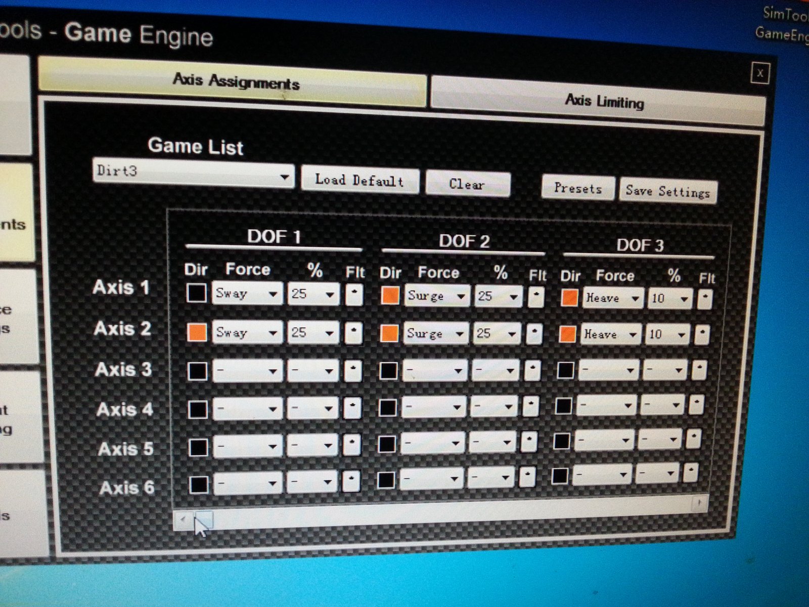

    i tried your surgestion,it works when i turn that value to 90%,but if i increase the axis amount of use in gameengine the same time,the motor will stop again, why?is something wrong with my setting? BTW:i need to correct that the problem is the right motor stops moving and begins to swing without meaning,the left one just stop moving,you can see two motor's position in the photo

    I did not mean lowering the axis limiting in Game engine, what I suggested was changing the Main Level % to around 97 in the Profile Editing button of Game Manager.
    There are many possible causes, PSU with motor spikes loads, configuration of the Arduino code, control boards.

    i understand what you mean,i adjust main level down to 90% in game manager then the motors works normal,but i want more moves,so i increase axis amount of use in game engine up to 70%,then the problem comes back.
    im very sure that the electric part and motors are alright ,because even i remove the wheel and pedal, just let the platform become a seatmover with nobody sit on,it still has that problem unless i adjust main level down to 90% and keep axis amount of use below 60%

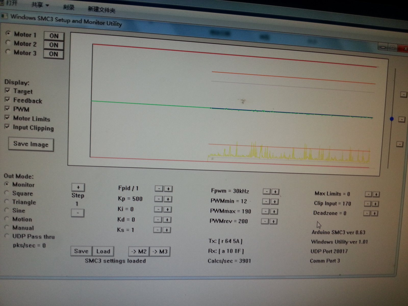

    @Blame73 is motor breaking power means value of pwmrev in smc3? how to reduce smc3 limits? in windows utility or i need reduce it in smc3 codes ? i will try when i reach home tomorow

    Look in the SMC3 thread. The second post.
    Clip Input Used to create a band at either limit of the target range beyond which any values sent to the SMC3 are clipped. In addition to this clipping, if the motor feedback does move beyond this range (typically through inertia), the SMC3 will attempt to brake the motors hard by driving them in reverse until they are back out of this limit zone. The value can be anything from 0-255 (however can’t be less than the current limit setting). Reverse braking is applied in the band between the Clip Input and the Max Limit settings. Reverse braking can be disabled - refer to PWMrev.
    Max Limits Used to create a band at either limit of the feedback range beyond which if the motors move (typically through inertia) the SMC3 will automatically shutdown the drivers and keep them disabled until reset. This is essentially a safety mechanism if something goes wrong. The value can be between 0-255 (however can’t be greater than the current clip setting).
    I bet it's what's happening to you. You're going beyond limits and motor's being shut down.

    @Blame73 oh!i do read that smc3 thread ,but maybe i miss understand its meaning?i already set max limit to 0,so my motor should not be able to stop, should i set clipinput to 0 or more higher?
