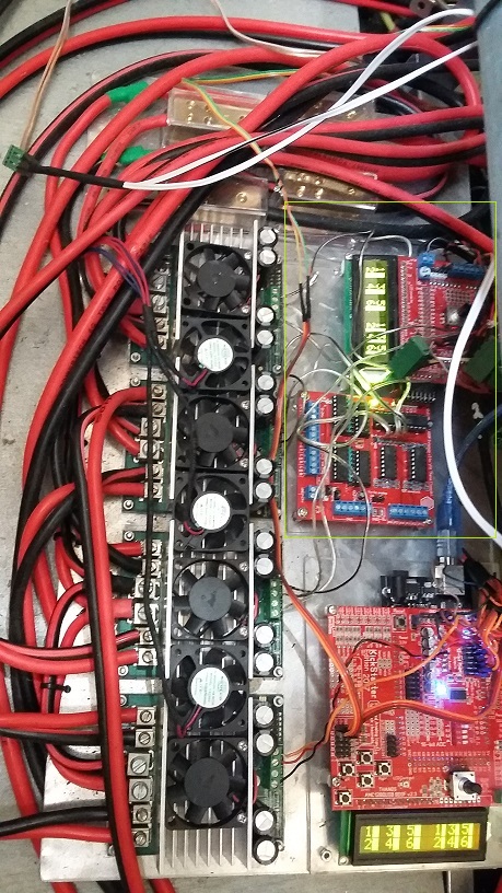

    I have a similar 1280 with the daughter card that drives my 6DOF
    It was doing something similar in game (random pulsing on all actuators), but worked fine the rest of the time using 'output testing etc' When I tried the Hexpod software the issue was fixed. Unfortunately I am not using VFDs, but still don't understand why yours would be operating differently.

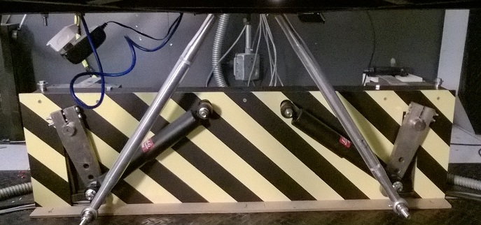

  20. Trip Rodriguez
    Trip Rodriguez VR Pilot
    May 8, 2016
    675
    Lake Ariel, Pennsylvania
    3,920Coins
    +330 / 6 / -0
    @hexpod I am now getting things set up finally with the software. I sent a request a while ago for a new key after windows reset.
    I may need help understanding how to get some of the measurements but I understand most.
    One problem, maybe because it's not yet registered; I can not edit the following fields:
    Platform Joint Spacing (all)
    Base Joint Spacing (all)
    Leg Length
    Servo Arm Length
    The sliders are all grey instead of blue and can not be moved. If this isn't something that's going to go away when I get the registration key put in let me know so we can get it fixed!
    Trip
    Also @hexpod If I understand things correctly I may need you to increase the range of some values. If for "Drive Initial Position: Heave Offset" you mean the "width of arc" as seen on this calculator: https://www.handymath.com/cgi-bin/arc18.cgi I need to be able to set this to -233 mm!
    If that is not the correct dimension please instruct me in how to find it. Here is a photo of my servo arms in center "start" position. I know this is far from ideal but it was necessary to add the shock absorbers that I used to mostly eliminate my major backlash problems.
    The range of motion from this "start" position is +/- 30 degrees for a total of 60 degrees travel so I will need to make sure that HeXpod can handle these dimensions.
    My torque arms are 190 mm now so I still have not too much less travel than before with 100 mm torque arms. I now have 190 mm total travel of the actuators.
