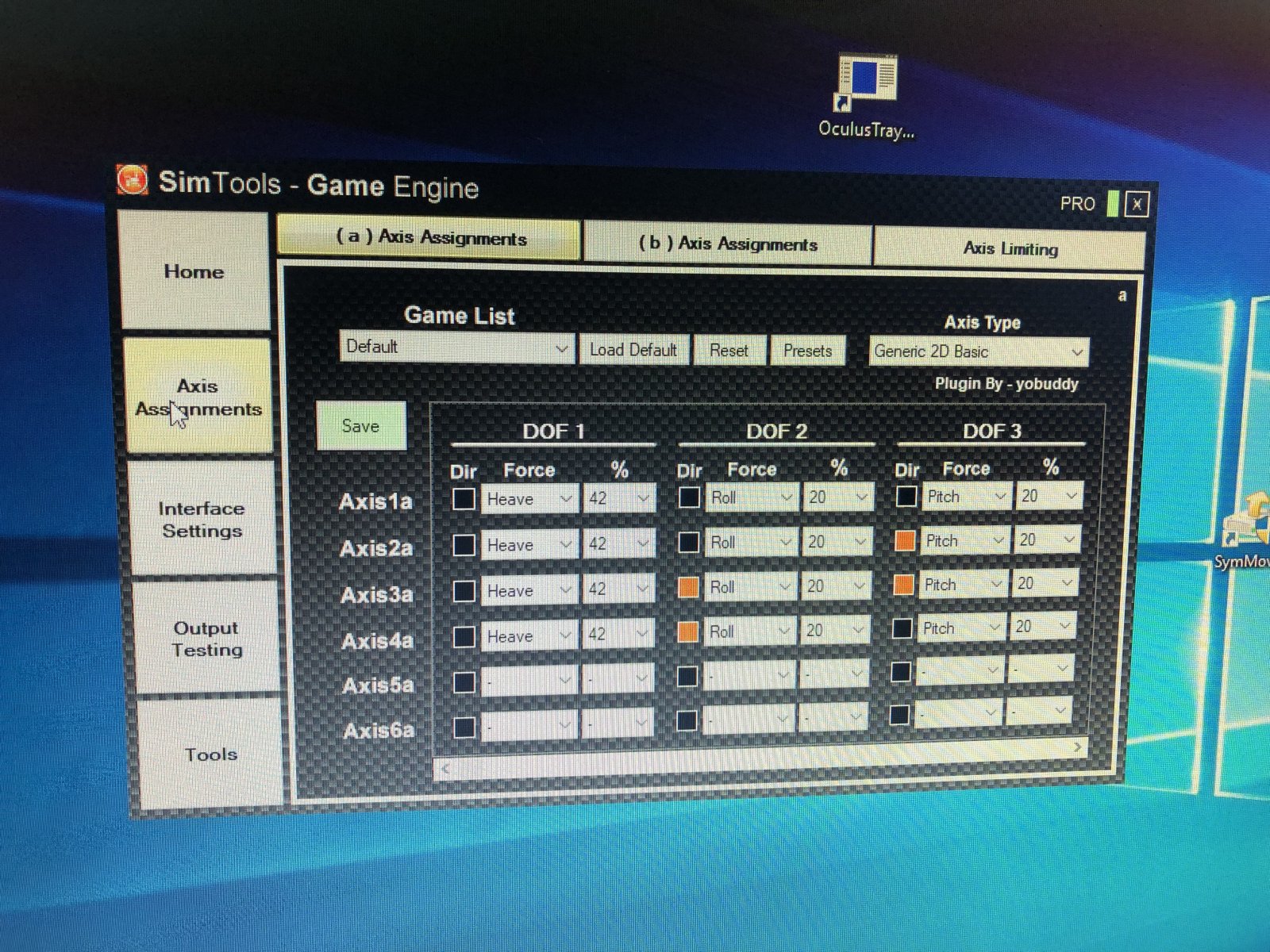

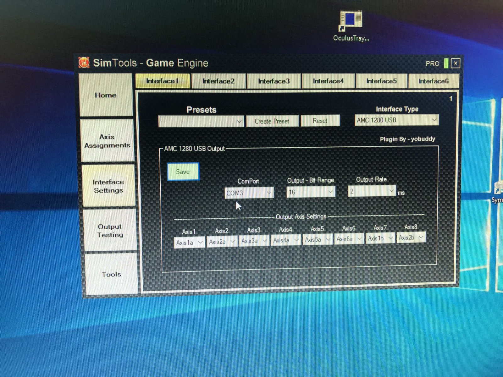

    862865B4-00C1-430E-B5F0-9C3CFB78F955.jpeg 1E50822A-244E-4C26-A841-1398587153CB.jpeg Hi guys

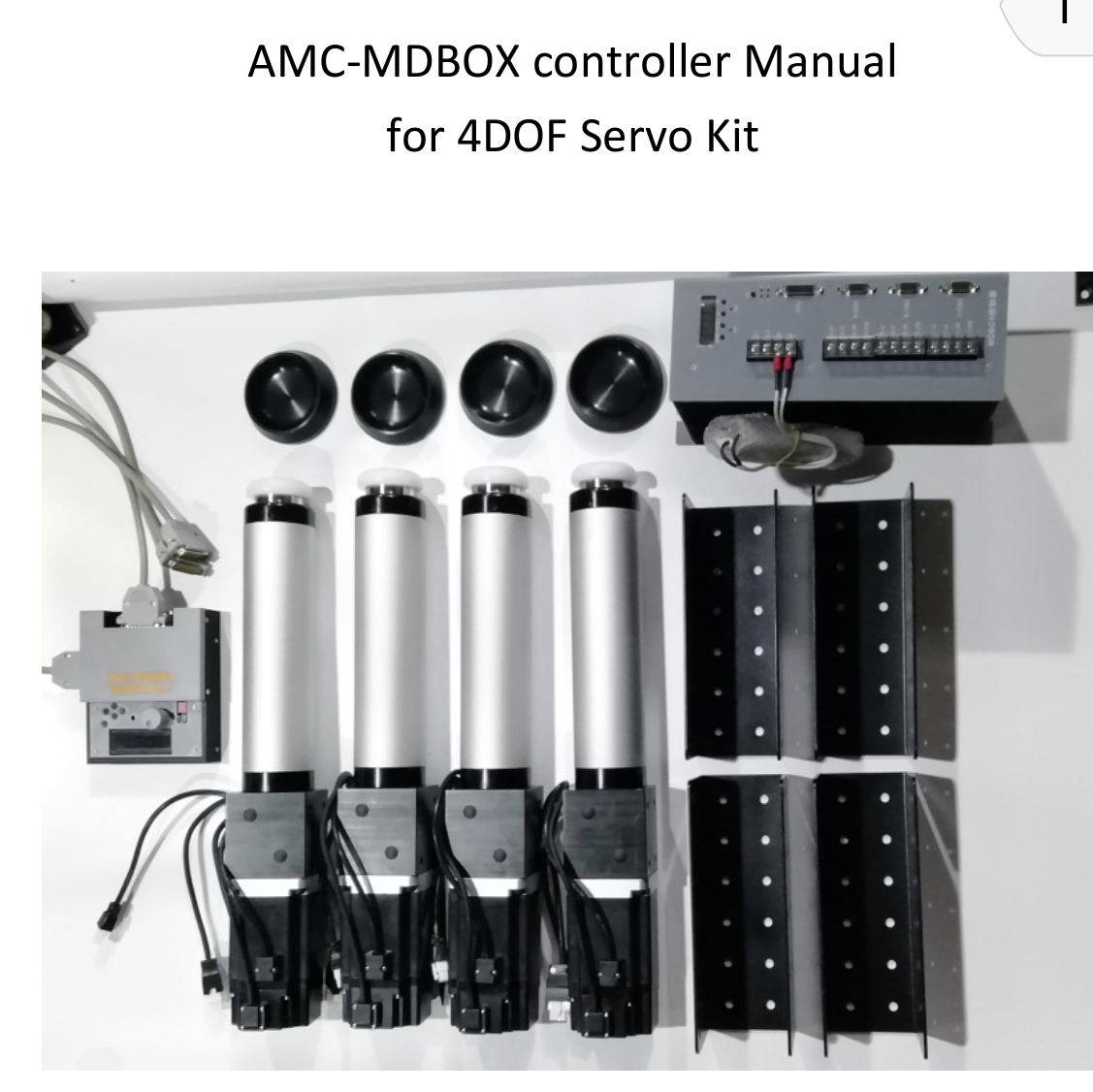

    I really need your help. I have purchased this actuators from China
    I have the new AMC contracts of Thanos.
    I installed SimTools with the license I’m my pc.
    I created a preset in interface setting and Axis setting but when I do the output test nothing is moving.
    When I use Thanos controller they actually move and that means that the wiring is good. I’m really desperate.
    Please help
  2. yobuddy
    5,161
    48,159Coins
    +5,036 / 16 / -0
    @Thanos ,
    Got any ideas buddy, his settings look ok to me.

    I tried every thing. I uninstalled SimTools and reinstalled it and nothing. 9 hours I’m trying and now it’s really frustrating.

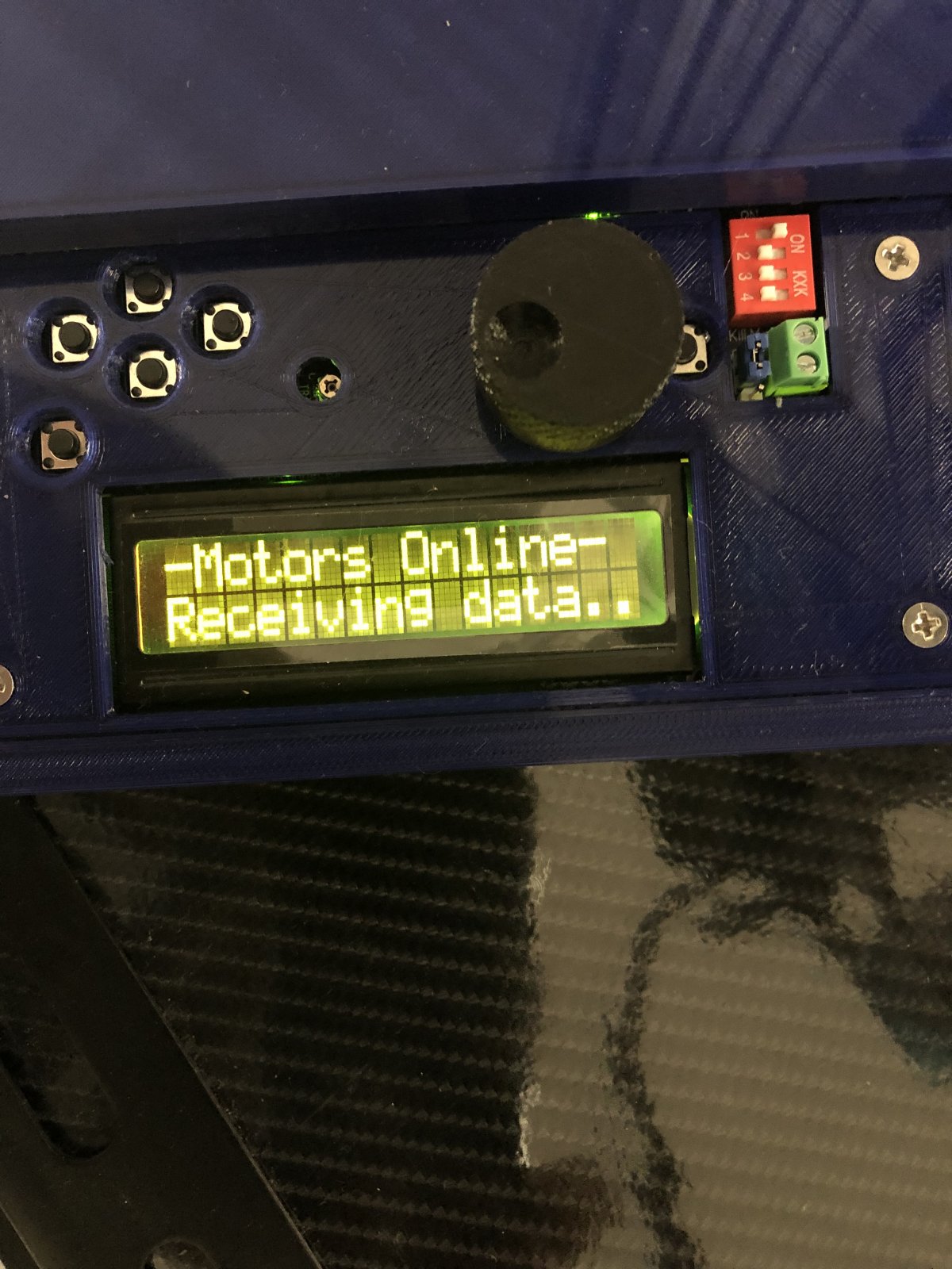

  4. SeatTime
    28,370Coins
    +2,844 / 38 / -0
    I don't have your exact setup, but does the AMC show as 'Motors Online-Receiving data' when you turn on Simtools Output Axis Testing ?

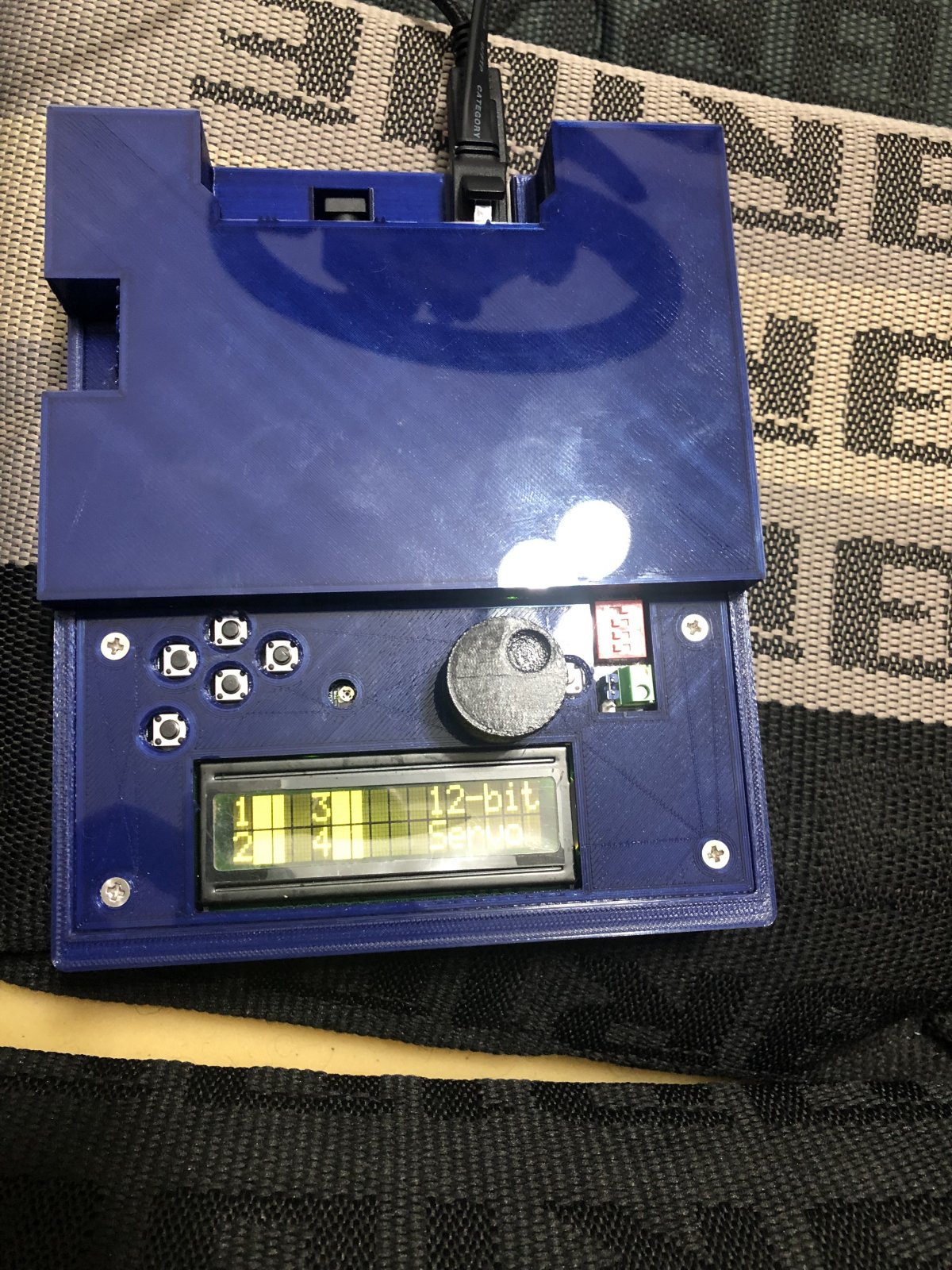

  7. Wajdi
    Wajdi Member
    Aug 13, 2018
    45
    416Coins
    +10 / 1 / -0

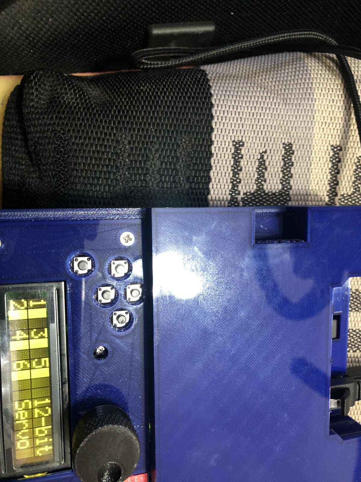

    FF024B79-2AC5-4653-ACA6-7F65D06DFC6C.jpeg It always show this
  8. SeatTime
    28,370Coins
    +2,844 / 38 / -0
    No, if the AMC is setup correctly for your situation it should work automatically. Have you setup the AMC at all?

  13. Wajdi
    Wajdi Member
    Aug 13, 2018
    45
    416Coins
    +10 / 1 / -0
    Hi Thanos. Thanks you and I’m sorry for all these emails.
    I want to thank SeatTime member who tried to help me via teamviewer and he spent 30min last night to check everything in my computer.
    Sadly the problem is still there. Today I will try to disable my antivirus and even firewall. I will try everything and let you know. Im sure that you are the only person that can help me.
  14. Wajdi
    Wajdi Member
    Aug 13, 2018
    45
    416Coins
    +10 / 1 / -0
    Hi
    1- I checked and the firmware is 1.4 rev 1b
    2- I disabled my antivirus and even firewall.
    3- I don’t have many programs in my pc. I use it exclusively for rfactor2 and that’s it.
    3- I tried to plug the AMC directly to the pc without the USB Hub.
    It’s the same thing. There is zero input from SimTools and the AMC.
    SeatTime member with teamviewer tried to see my settings in SimTools and he has more experience than me and nothing.
    I’m waiting to further help from you Thanos.

    7C46A20C-70E1-4AB8-A4D1-745FD49B90A7.jpeg Ok
    I set the AMC to 6 DOF
    Same thing.

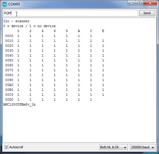

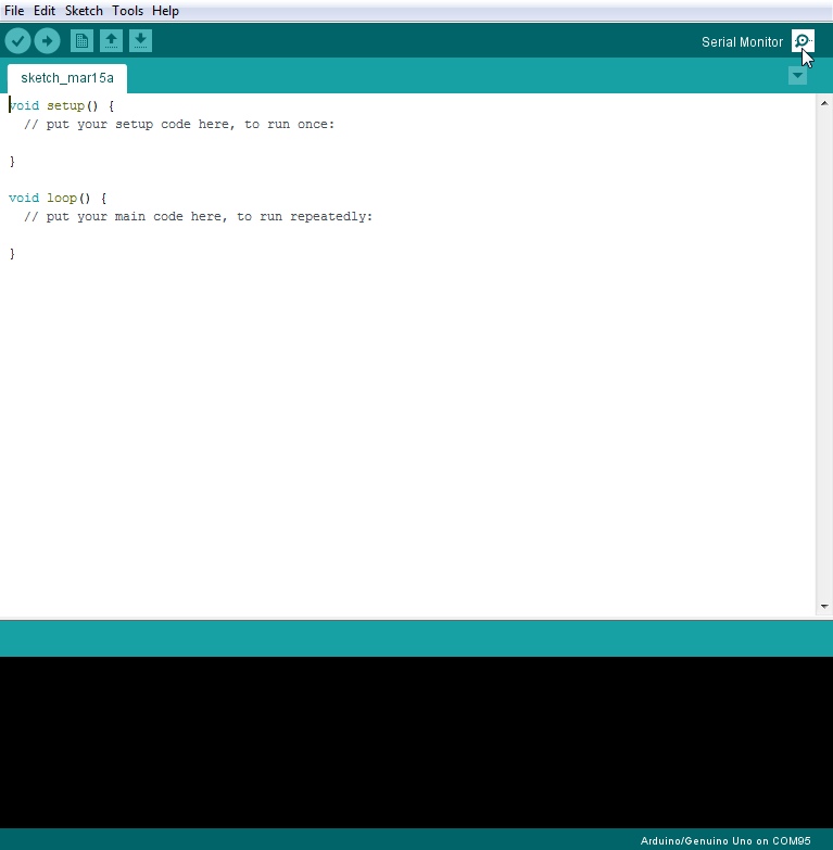

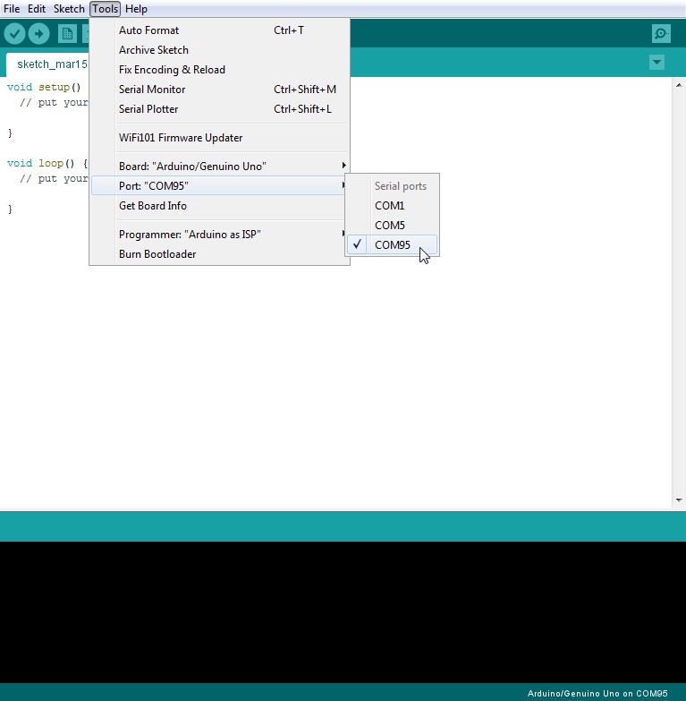

    Now, regarding testing the serial connection, you can use the Arduino IDE with the following steps:
    Dowload the arduino IDE and unzip it to a folder:
    https://www.arduino.cc/download_handler.php?f=/arduino-1.8.8-windows.zip
    Then on TOOLS --> Port, select the COM Port of the AMC:
    The Click on on the button to open the Serial Monitor:
    On the window that appears, set the BAUD rate on the bottom right to 250000, and type "RQM" and click send:
    You should see on the monitor the reply from the AMC for the protocol it uses, the number of motors and its revision:
    "AMC1280USBm8v_1b"
    Thanos
