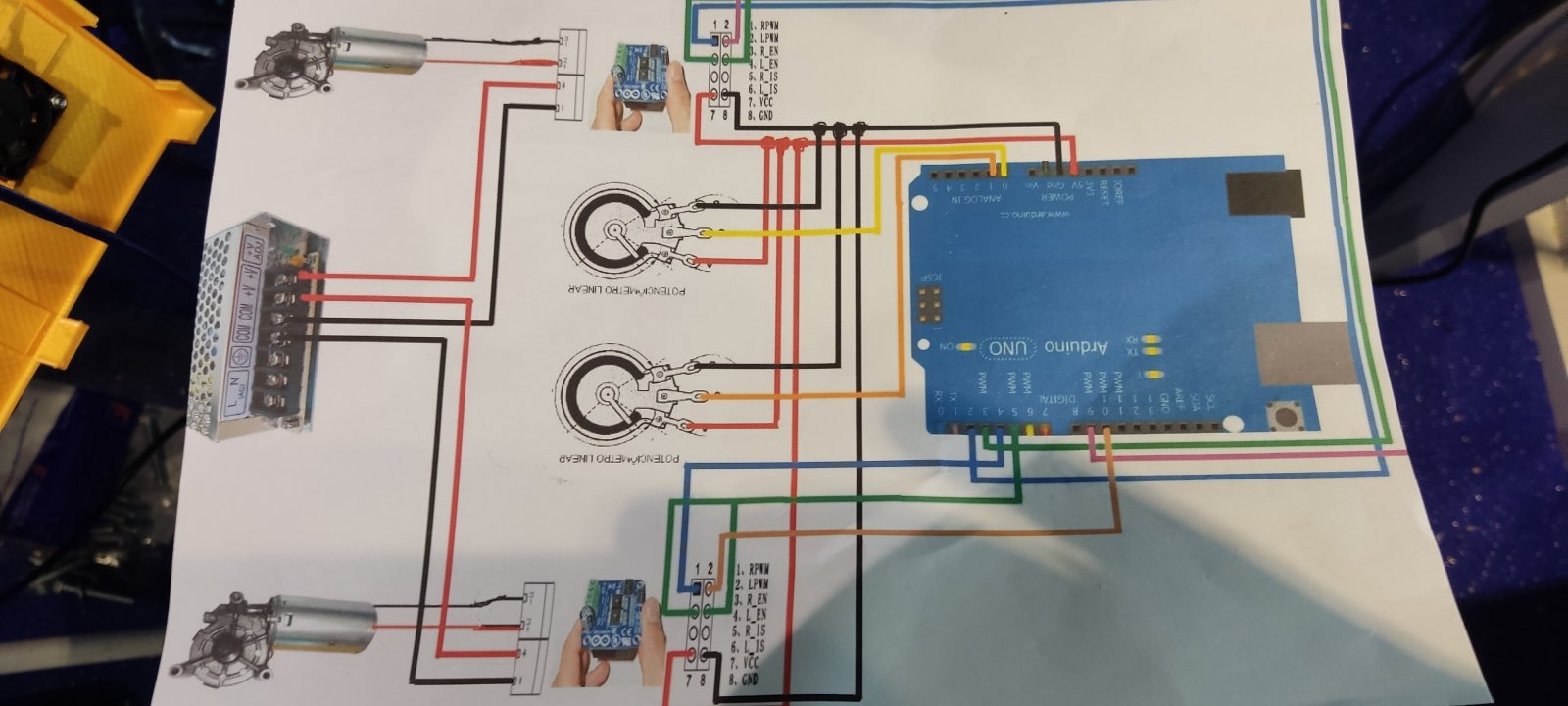

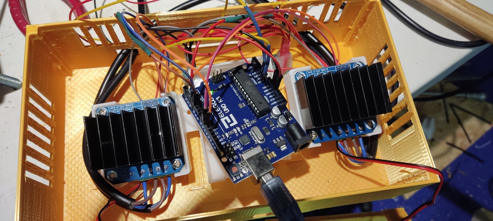

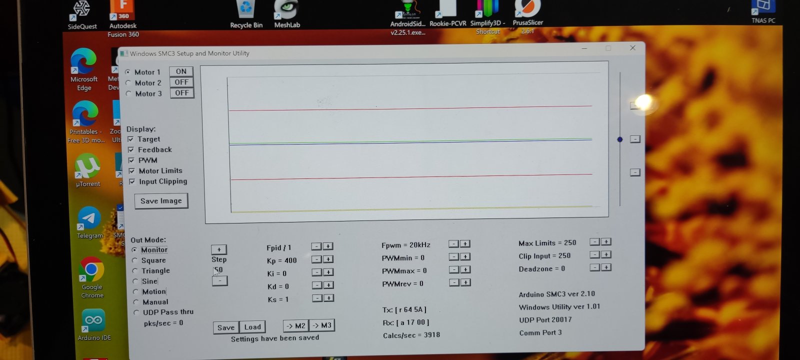

    I'm in the middle of trying to get the motors running correctly but seem to have an issue I just can't resolve. When connected to SMC3 the motors do not do what they are supposed to. No matter what simulation setting I use they just have a mind of there own...
    Just to add a bit more context, was hoping to add a video but doesn't let me, it is obviously communicating as the motors react in SMC3, they just don't react correctly. Triangle, Square, Since, all it does is go round in circles at the same speed, then stops, then goes again.
    Tested in Simtools and oddly enough the motor does respond when I simulate the axis movement, just very abrupt, so Comms is working.

    It does not look like PWMmax has been set. This is the setup steps to determine PWMmax, from 9:
    8. Set Kp to about 400
    10. Do the above for each motor
