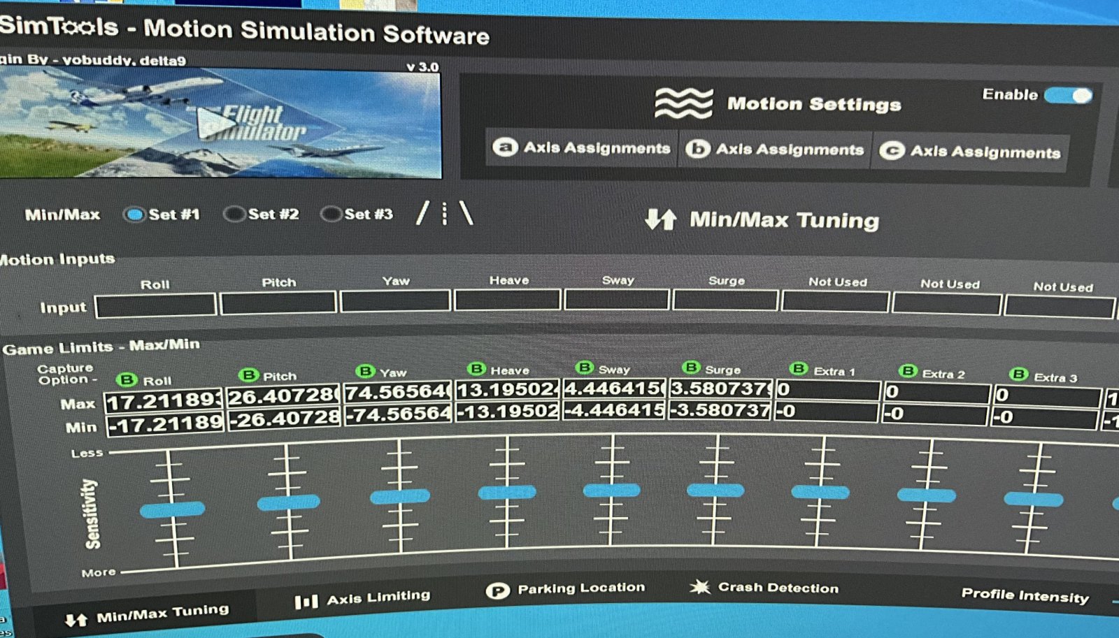

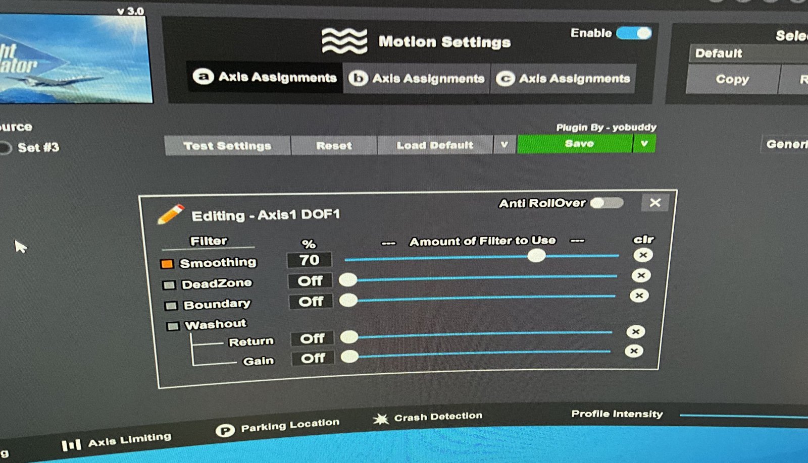

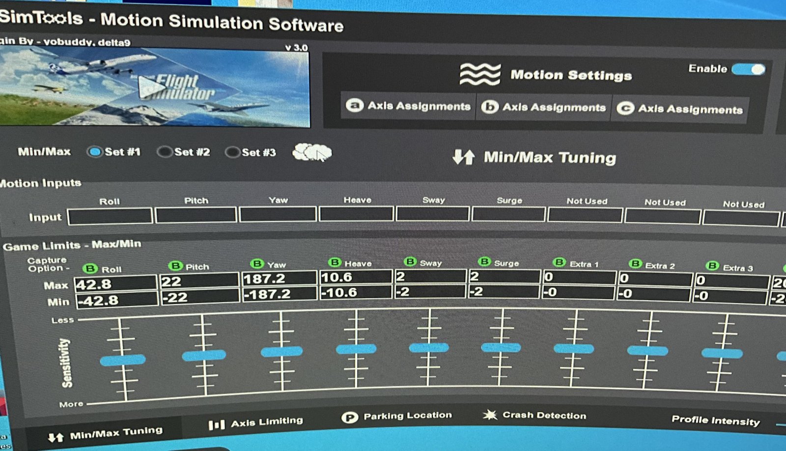

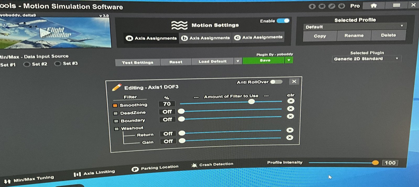

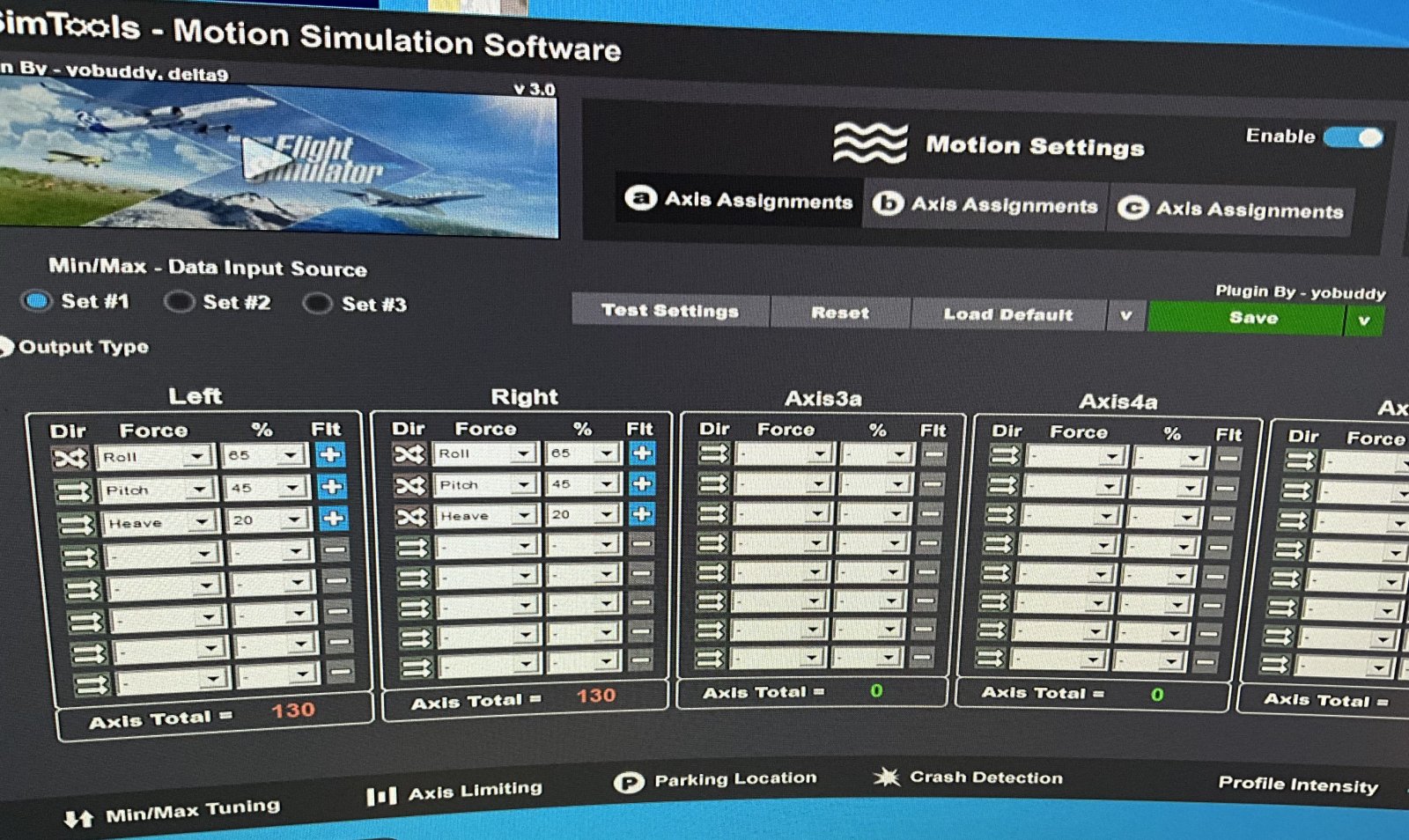

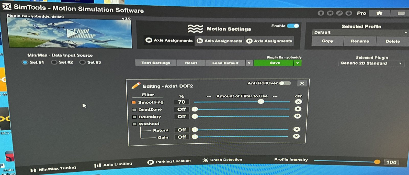

  4. Gerardo Rivera
    Gerardo Rivera New Member Gold Contributor
    Jul 1, 2023
    29
    114Coins
    Nick here are my settings
