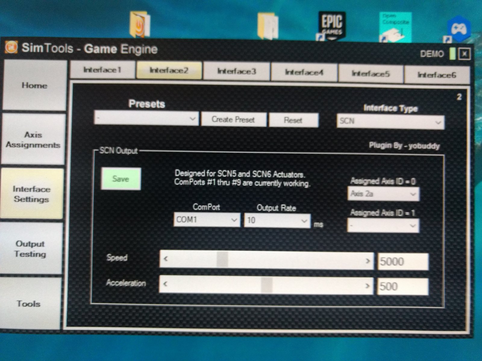

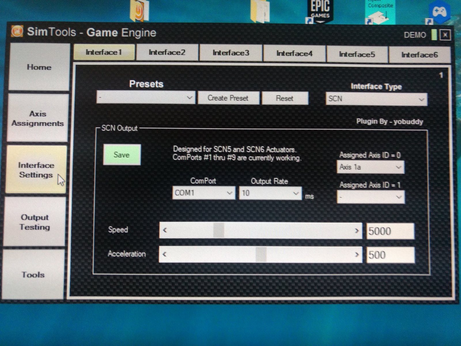

    This is my configuration:

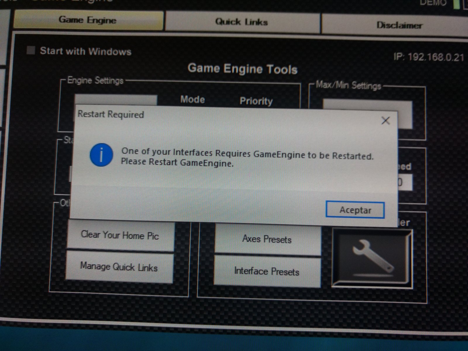

    Whenever I exit LFS I get that message to restart the game engine.

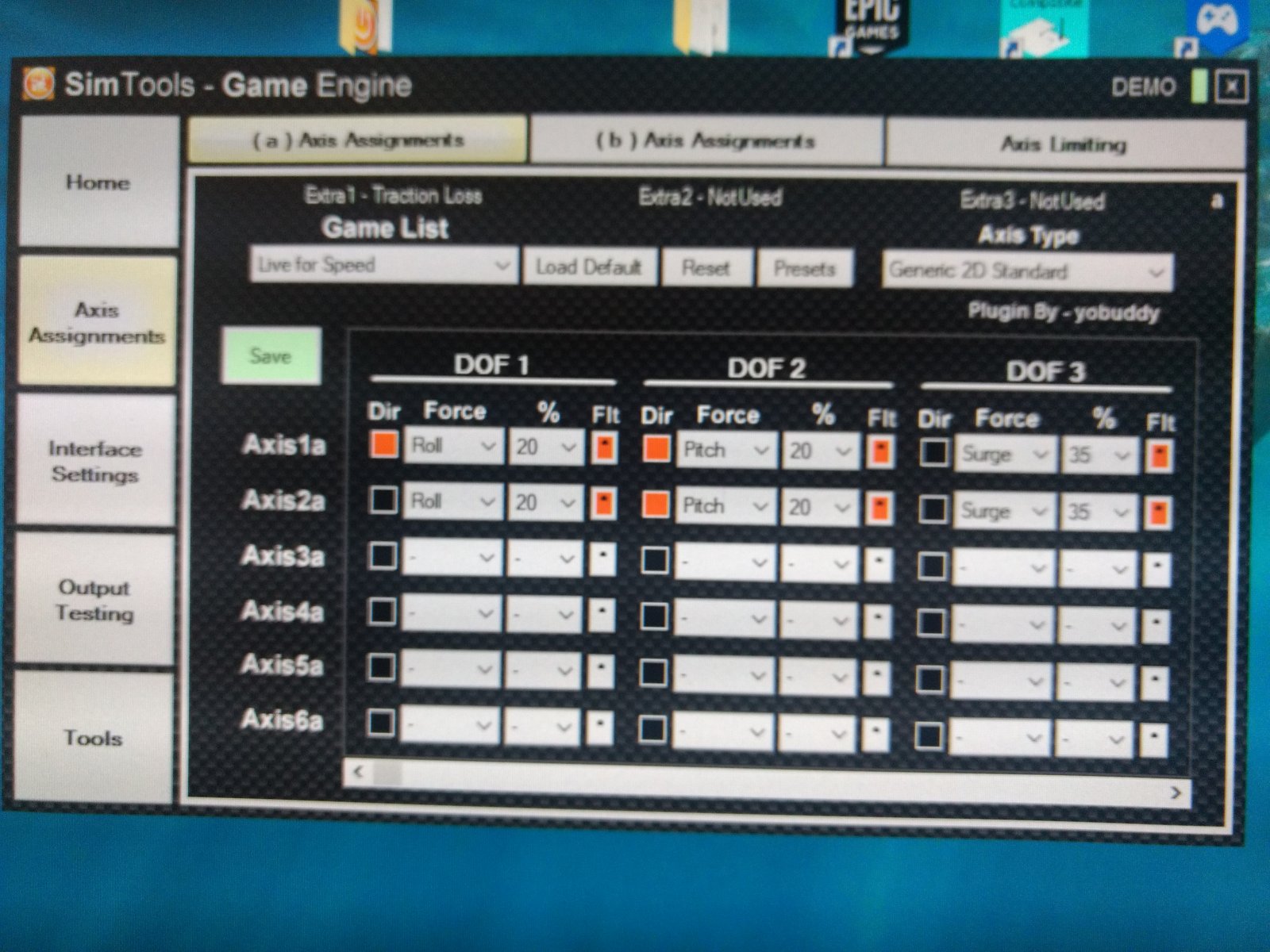

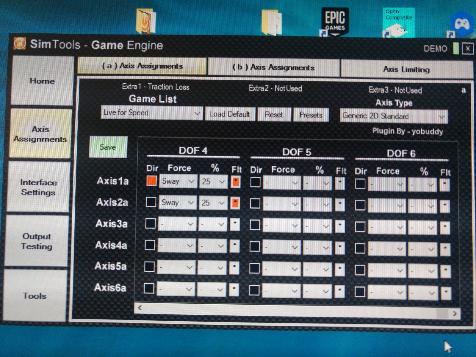

    This configuration I have copied from a forum member.
  12. noorbeast
    20,461
    144,596Coins
    +10,741 / 52 / -2
    Generally that means one or more of the actuators is not configured correctly.
    Restart GameEngine and check the actuators can center correctly.
    Do you have 2 actuators attached to a single com port adapter?
    If you only have one actuator connected does it behave correctly?
    That can sometimes be problematic, you should really grab a copy of the SimTools manual and use it to understand how to configure SimTools: https://www.xsimulator.net/community/faq/rtfm-start-with-the-official-simtools-documentation.117/
    For the moment you should not be using filters in Axis Assignments, but for SCNs do set Axis Limiting to a value of 90%. This is very important to preserve your actuator in the long term. Not doing this can lead to mechanical damage.
    The Dir being checked orange or not determines which way an axis moves, sway should be set the opposite of roll and lean away from a corner, this is how SimTools expects axis to be configured: https://www.xsimulator.net/community/faq/which-way-to-set-simtool-axis-movements.230/
