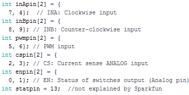

    I've been building my 2DOF simulators frame this weekend and mounted my motors and such, as I'm currently waiting for my arduino and hbridge to arrive in the mail. I came across RacingMats code for arduino that can be used with a H bridge and looked into it, as i would like to have everything ready for when my electronics arrive, and couldnt figure out how i should wire my h bridge up to the arduino. As seen in the code here, it looks like that i should wire 2 directions up for each motor?

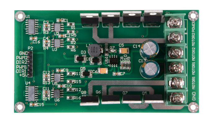

    But my hbridge only supports on direction pin for each motor connectec ( as seen in this picture)
    Sorry if its a bit of a noobish question, but i would hate to come home to my new h-bridge and arduino and be stuck on this for hours :p

    This H-bridge with firmware must be connected in this way:
    7 pin - DIR1; 4 pin - DIR2; 5 pin - PWM1; 6 pin - PWM2;
    8, 9 pin - not used.

    Smc3?
  8. Vladimir
    Vladimir New Member Gold Contributor
    Jul 25, 2015
    12
    Russia
    287Coins
    +31 / 0 / -0
    For Smc3 connection: 2 pin - DIR1; 4 pin - DIR2; 9 pin - PWM1; 10 pin - PWM2.

    Thank you very much for replying, those connections would be in mode 1 of smc3? No need to change anything

    Yes, all connections for mode1, pin 3 and 5 are not used.
