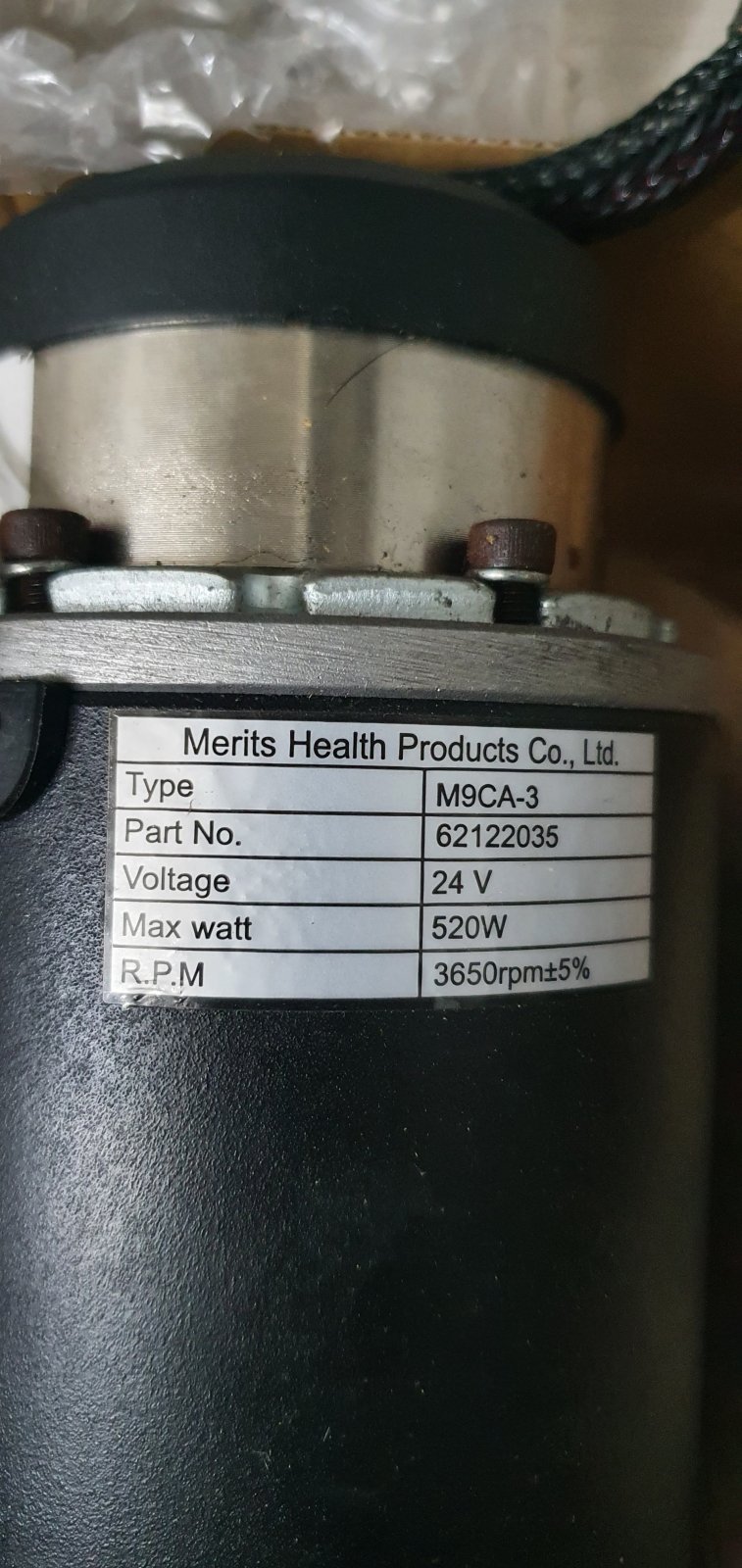

    Hey all.
    I have purchased some motors that I hope will be suitable for my rig that I want to start building. They are 24v electric wheel chair motors.
    The have a data sticker that says max Watts 520 .
    My question is would a 20a power supply be enough per motor or would I need some cushion say a 25 or 30a output.
    Any help would be appreciated
    I have attached a photo of the motor plate.

    The power supply will be subject to regenerative braking and may not like the changes in load
    what i did was very simple - use 2 x 12v batteries to power the motors - then use a smaller 24v power supply to keep the batteries topped up
    I run 6 motors x 800w this way
    a car battery is not expensive and you can buy cheap jump leads to use as high current wires
    the motors look decent - what is the gearbox rating and current ?
    this will help you work out amps

    Hi gadget999
    Thanks for your reply that's a good idea. I am a little limited on space in my final location so was hoping to just run psu's but the batteries I will keep in mind. The gearboxes states 1:19.3.

    hi, worth looking on ebay. i just got a 3 kw psu for £120. normally these things are several hundred pounds new. i am not sure about the regenerative load. i am going to use h bridges so i think the regenerative load probably dissipated as heat though a blocking diode but have not checked that,.

    I am using server power supplies, one per motor to lessen the risk of tripping them. I was advised to get plenty of overhead power to cope with the spikes generated. I went with 750w PSU's but you can find even larger like 1000w or more. For me, these turned out to be the least expensive option. You can find them very cheap on ebay. They are 12v each but with a small modification, you can put 2 in serial to generate 24v. I 3d printed caps to cover the exposed connections in the back for safety.

    Thanks for all the feed back. I've managed to pick up a 1200w 24v psu for now so I will use that for testing and see how I get on from there.
