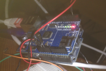

    I am looking for a arduino wizard code person that can help me wright code
    I have an arduino with an Ethernet card on top the reason for this is I am trying to making a 360 deg machine with this in mind i do not wont to run the signal wires through slip rings and maybe later I could use a wi-fi setup

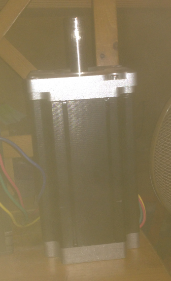

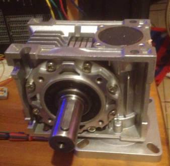

    picture of motor and gearbox 10 to 1 ratio

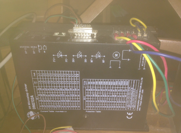

    This is the driver that controls my motor and i have lots of settings i can use It need two pins 1 for direction and 1 for pulse

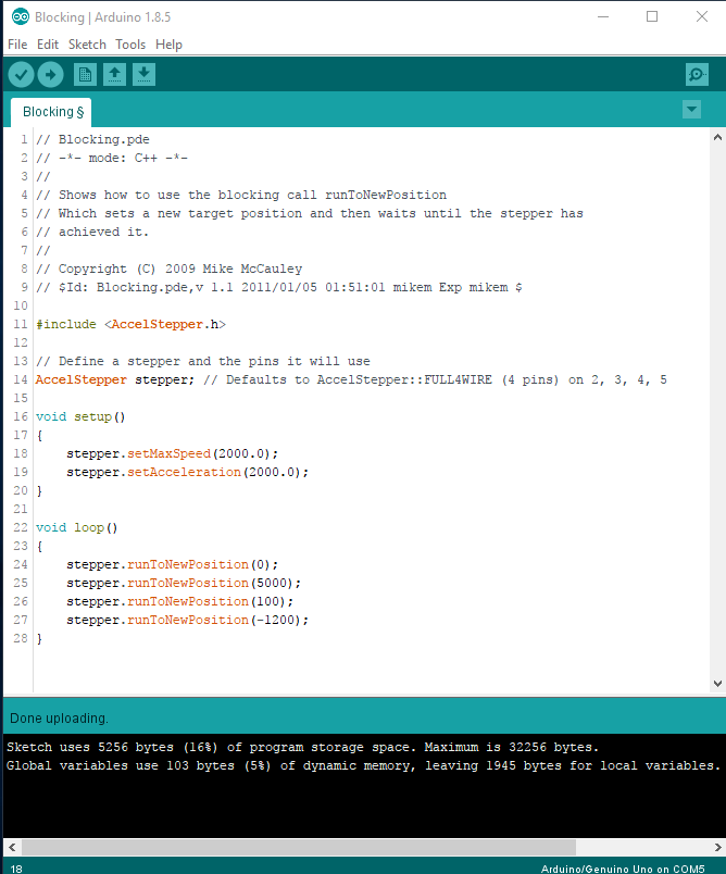

    This example code runs my nema 42 stepper motor very well i can make it ramp up to speed and down again and also change direction
    This code works fine
    On test mode i have a number in the serial monitor which ranges from 0 to 255 as i am on 8 bit
    The picture shows med position

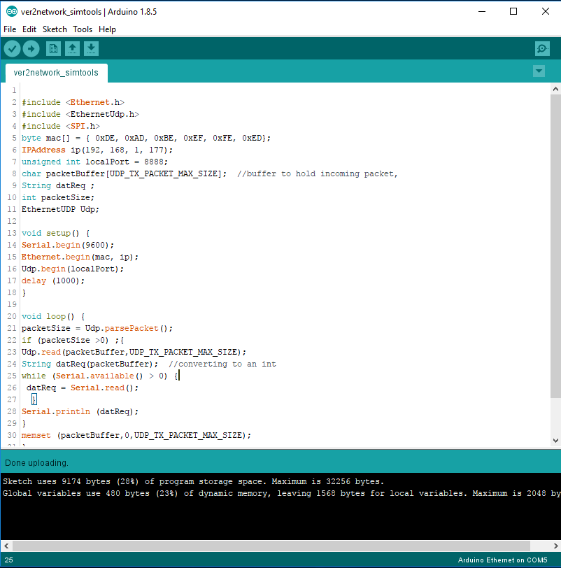

    After about 4 weeks of trying to combine the two programs together i found out that the data coming from simtools is a char number not an int number. I have tried to make it a string and then change it to a int but with no success
    So if any body in sim tool land has any programming help or ideas how i could make this work I would be the happiest man alive and the arduino card will stay where it is and not out the window
    I confess i have only just started to learn code by watching lot's of you tube video and making led's blink and things
    Thank you all in taken the time to look through this post

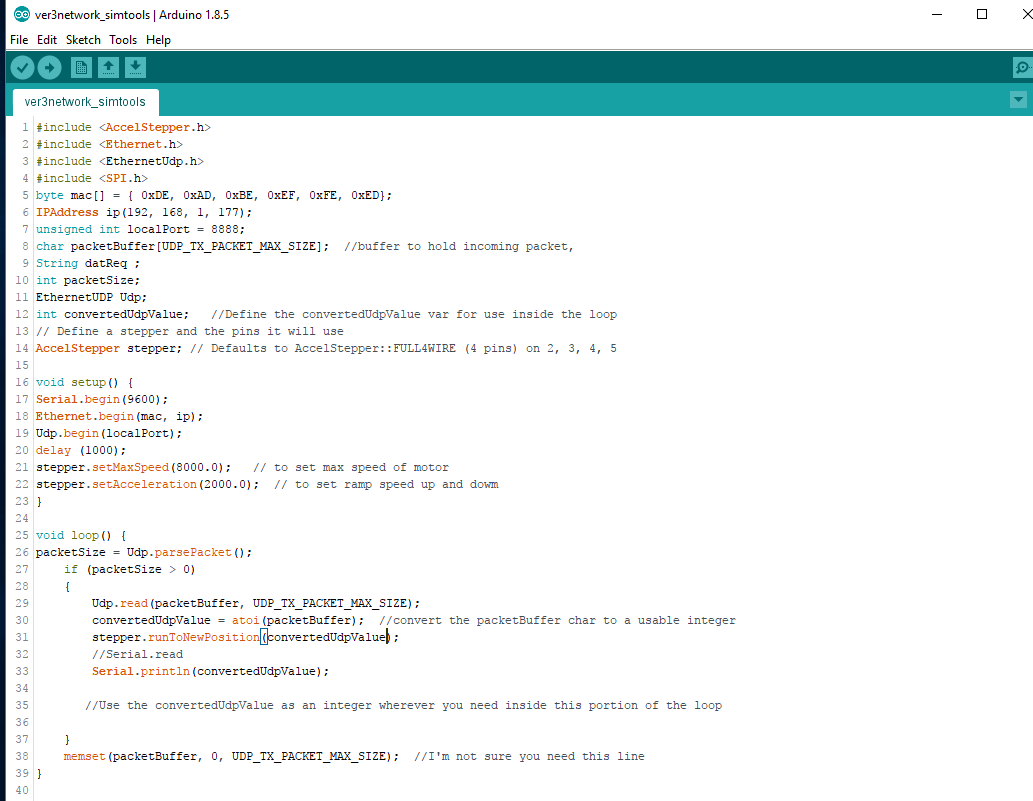

    udp.read() returns a char array value.
    You can easily convert that char array value to an integer by using the atoi function, like this
    int convertedUdpValue = atoi(packetBuffer);
    Then println the convertedUdpValue variable to see if that shows the integer you'd expect now, and use that converted value anywhere you
    You have a few other issues with your code that should be addressed:
    You have an erroneous semicolon after your conditional "if (packetSize > 0)" which prevents the condition from actually restricting the following branch of code
    You have the serial.read loop which will overwrite the string datReq with any value coming in from Serial, which I'm not sure if you are doing intentionally. If I'm understanding your intentions, you can remove lines 25-27 in the last screenshot to avoid issues with your udp.read value getting destroyed. If you are intentionally trying to read a serial value, consider assigning it to a different variable so you can retain the udp.read value.
    Here's what I think your main loop should be replaced with (untested code, I don't have an arduino IDE in front of me right now) :
    Code:
    int convertedUdpValue;   //Define the convertedUdpValue var for use inside the loop
    void loop()
        packetsize = Udp.parsePacket();
        if (packetSize > 0)
            Udp.read(packetBuffer, UDP_TX_PACKET_MAX_SIZE);
            convertedUdpValue = atoi(packetBuffer);  //convert the packetBuffer char to a usable integer
            serial.println(convertedUdpValue);
           //Use the convertedUdpValue as an integer wherever you need inside this portion of the loop
        memset(packetBuffer, 0, UDP_TX_PACKET_MAX_SIZE);  //I'm not sure you need this line
    If this doesn't help, can you upload your code files? I'll take a look at them

    I have two problems
    The first problem is moving the motor to a position which is a long way away and is always updating
    The program (below) is fine for very small movements but if i do a large movement the motor moves to the first position then reads the next position and so on resulting in a motor doing moves which i told it to do 4 - 5 - 6 seconds ago. The data seams to be stuck in the buffer and it reads the data in order rather than taking the newest data and acting on it
    The accelstepper library looks like the one i need to use because it has a ramp up and down function , which i need because i have a gearbox 10 to 1 ratio on it. The stepper needs to increase speed the further it has to travel and all so needs to slow down again.
    The library has lots of functions which i have tried to use but i just cant get the how to wright them in
    like computeNewSpeed()
    The library can be found here http://www.airspayce.com/mikem/ardu...tepper.html#affbee789b5c19165846cf0409860ae79
    My second problem is sim tools sends out a number between 0 and 255 i need to make it say when the next number from 255 is 0 or at the other end 0 the next number 255 because at the moment when i get to say 255 it will return to 0 by reversing the motor direction back to 0
    I know this is a big ask but any help would be most appreciated. If i can get this side of things working how i would like them to work i can then start building my 360 deg sim which i can use with falcon 4 and x sim ect
    I am not a programmer so please can you help in simple man's terms i am good with my hand's but not so good between the ears.
    Thank you all and happy new year

    This first video is of the motor doing a random movement from a example sketch from within the accelstepper libaray
    it shows wot the motor can do in speed and movment.

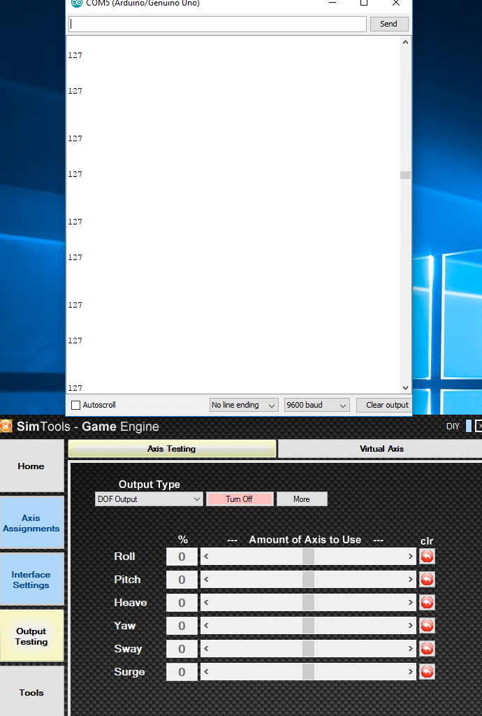

    The next video shows me moving the sliders in simtools to make motor move with the code you sent me.
    I have added a serial.println to see if things are working on the serial monitor.
    I have also added a stepper.run at the bottom to get motors to move
    I have noticed that in the serial monitor the changing numbers are updating all the time because as before when i was using stepper.runToNewPosition the serial was stopping on the number until motor had completed its move
    As you will see in the video below the motor never gets to any great speed it just ticks along i do have forward and back movement and if i do go beyond half way say on the positive side of the scale it will find the closest route to minus side of the scale and not reverse the motor
    this is ok but if the motors are set up as a roll on an aircraft and i have moved beyond half way and a raped move in the other direction beyond half way on the other side of the scale the motor will keep going the same way util position is reached
