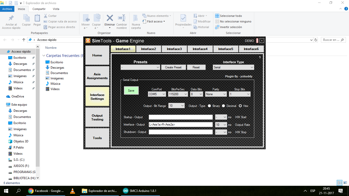

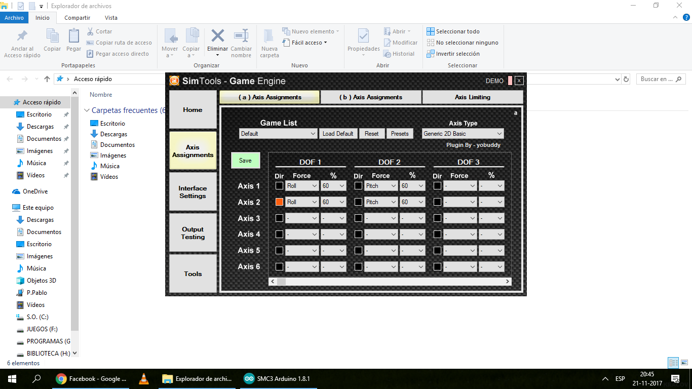

    Well, i was messing around with the guide made by RufusDufus about SMCUtil, at least the motor moves but it's kinda hard to measure correctly if the pots are not mounted to the motors.
    For now I can post the settings of Simtools, keep in mind that is configured based on RacingMat's guide, again, I can't do so much without the motors properly working with the potentiometers.
    I'll keep the tests, I have a friend who can make me the brackets to mount the motors with the pots but it will take his time, for now this is only that i can do :/

    You need to mount your pots before fiddling with SimTools.
    SMC3 Interface Settings for Simtools 2:
    [A<Axis1a>][B<Axis2a>]
    Set for 10bit binary output
    Baud rate 500000 , N , 8 , 1 (10ms delay)
